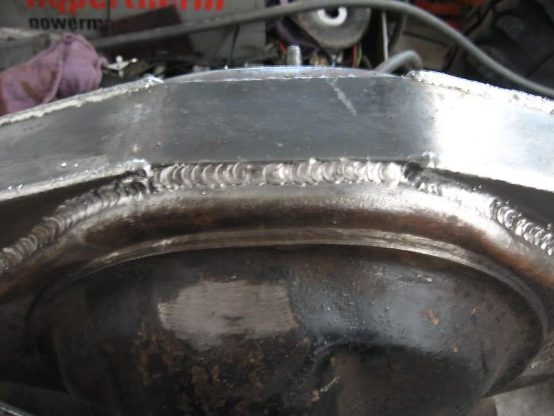

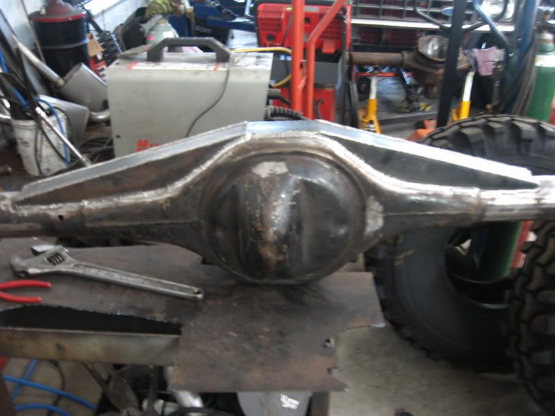

Been working on getting the 9" housing all cleaned up and trussed the last few days. Housing is out of a 79 Bronco.
Made my own truss. The piece that stretches over the top of the housing is 1/4"x2" flat bar and I plated it in with 10 gauge.
A local shop is only charging me $125 to narrow and true up the housing so I'll be dropping it off either tomorrow of the next day for that.
