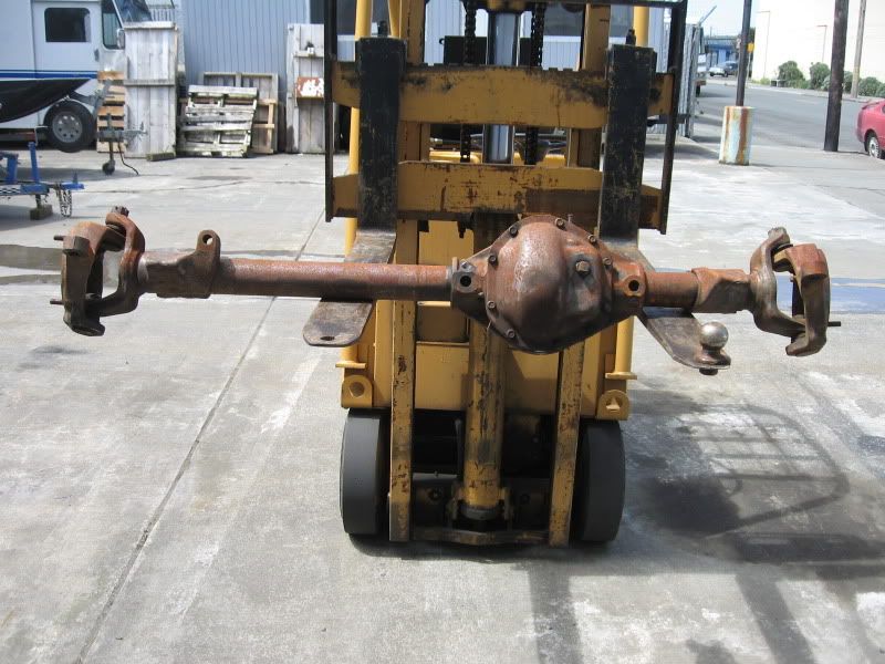

Went and pulled the D44 out of storage, have it mostly stripped down. Plans are gears to match the rear, Grizzly locker, some brand of alloy shafts (probably RCV's), over the knuckle steering, and a good diff cover.
77 F150 housing:

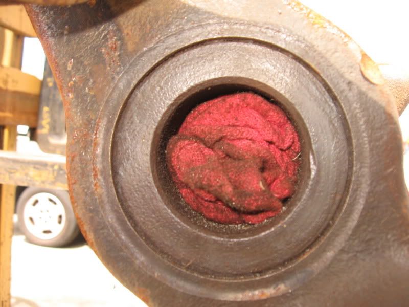

0.5" wall axle tubes :headbang:
