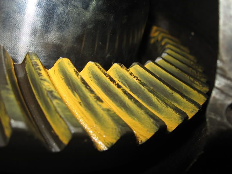

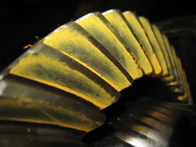

Thanks man I glad to be back at it too. I really want to get this thing done before summer has come and gone again. Here's the final pattern with everything torqued, pinion pre load set and B/L at .009".
Drive:
Coast:

Really good looking build, and as several have said, your fab work looks great.
Gear looks good man. I could live with that. Good work.

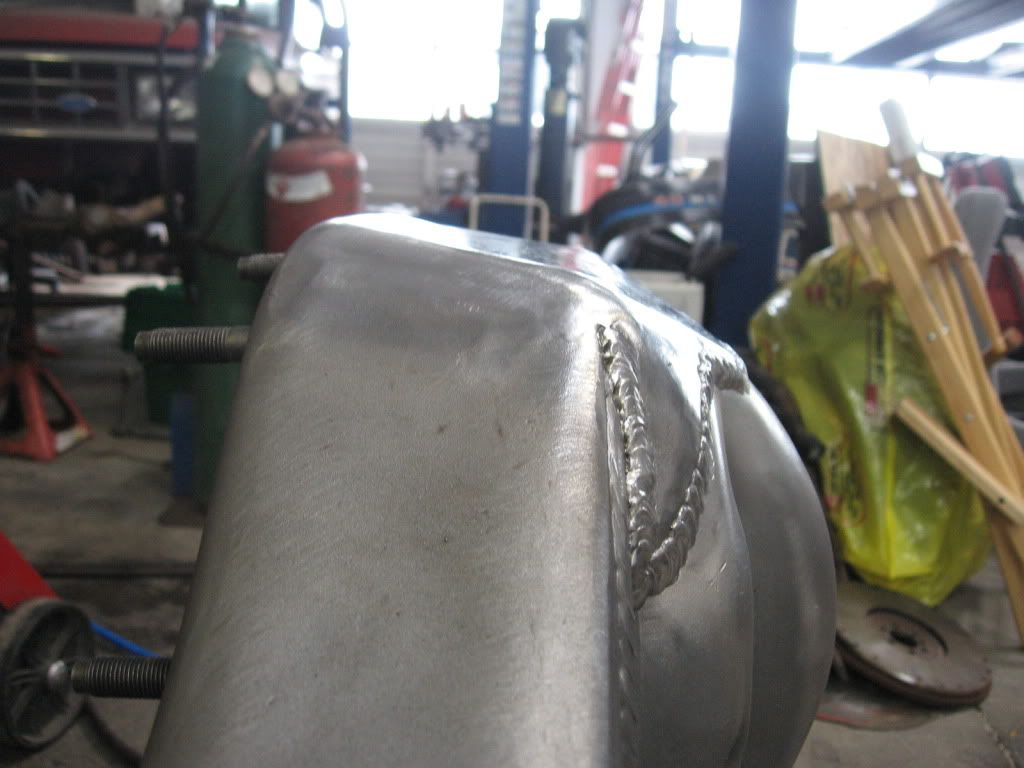

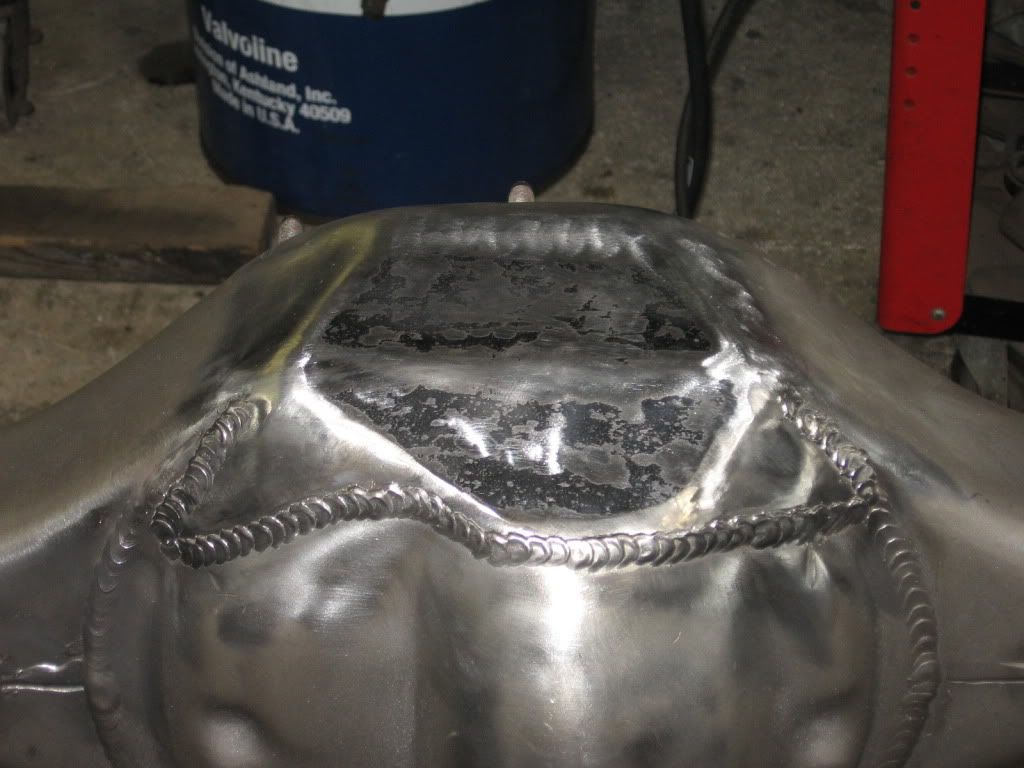

Back at it again after 5 weekends in a row of working on the "adventure ranger". Decided the Currie 9" housing needed some shaving and reinforcement. With the pinion angle as steep as it is (about 22 degrees) the lip on the bottom of the housing was bound to get hung up on stuff and abused. Cut the bottom off, and welded in some 1/4" plate with nice smooth transition to the back of the housing. Should glide up over things a lot easier now, and take a lot more of a beating than the stamped steel housing would have.
