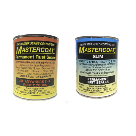

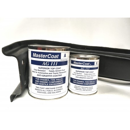

If you can wait for the products to be back in stock, go with Mastercoat rust sealer and then AG-111 topcoat:
If you're wondering why they're out of stock, it's because they outperformed all other products, including Eastwood Rust Encapsulator Platinum and POR-15 by a huge margin in this video:
