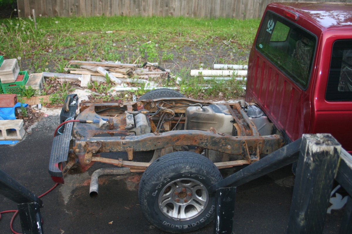

I bought a cheap $80.00 media blaster to remove the scaley rust. The blaster will go faster and get into the corners where the wire brush won't reach.
POR 15 works wonders but it will not penetrate the thicker stuff. They've got a product to apply before you paint.

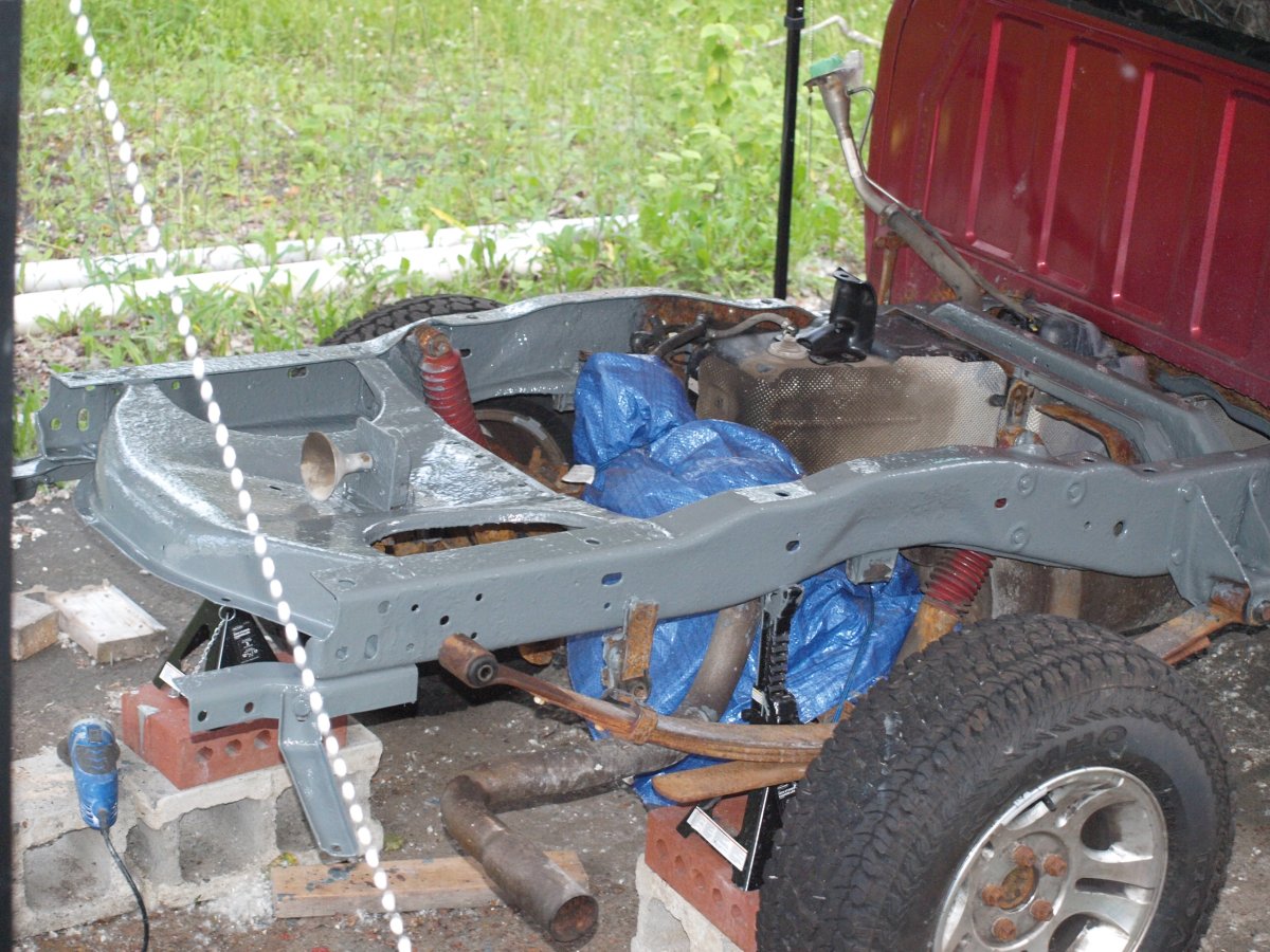

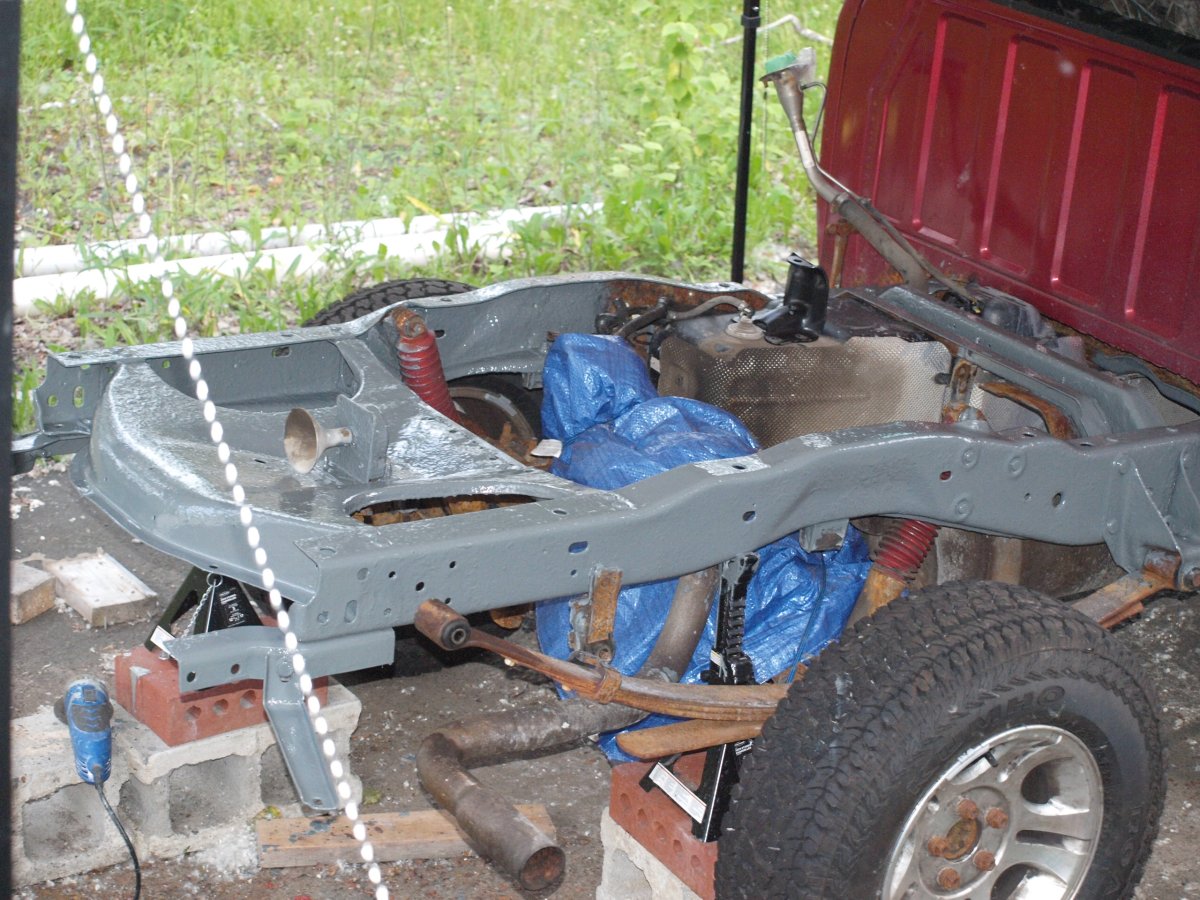

I got it topcoated over the weekend. Picked up a gallon of Amor Coat rust paint and gave it 3 coats.
Started like this Frame Prep for POR 15 coating and ended with this Frame Prep for POR 15 coating
Started like this View attachment 94934 and ended with this View attachment 94935

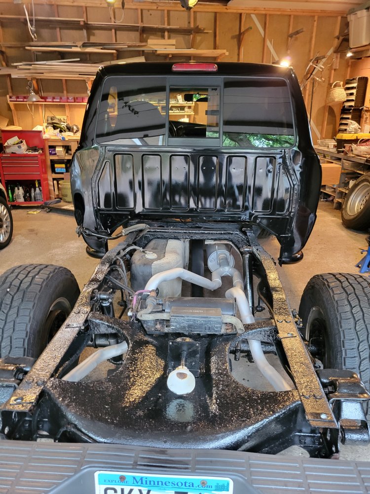

Digging up an old post.... For those of you who have used POR 15 on your ranger frame, how much did it take? I am going to do my son's frame but just what I can reach from a lift. Wont be removing the bed or cab. A freind of mine built a 66 Chevelle over 20 years ago and the stuff held up great. About 5 years later (15 years ago) I used it on my 86 K20 frame and it has done great. I just don't remember what size container I bought.
It took me two days to paint the Ranger frame. I put on two coats. I'm glad I did. There were spots I missed on the first pass. POR 15 is just a primer. So I spent a third day with some spray cans. If you have the time, it's better to remove the bed.

If I remember correctly, it took about a quart and a half. I should have used one or two of those six packs, each of which is like a half pint.
I would imagine that one six pack would do if you choose not to remove the bed and if you apply just one coat.
