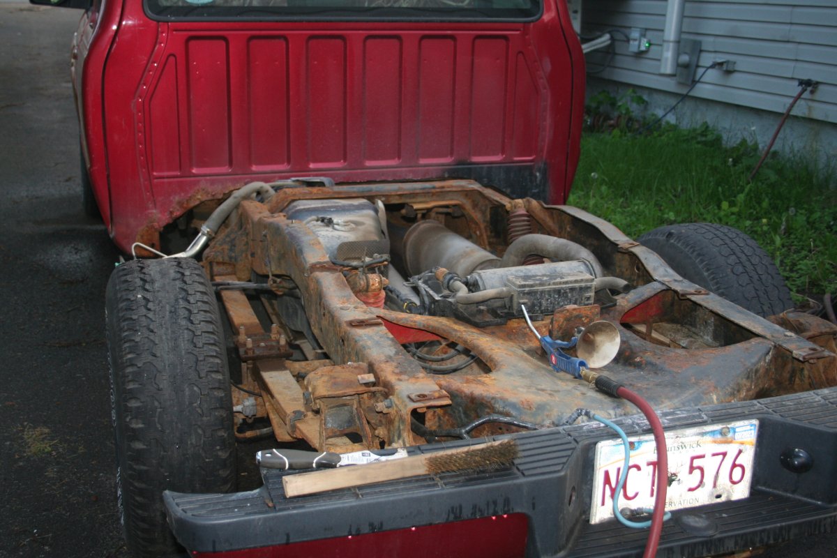

Frame Prep for POR 15 coating
It took me ! quart to do the back half of the frame. I bought a few new empty quart cans and poured what I didn't use in one of them. Just don't get any on the rim and it works to keep it so you can open it in a day or 2 to finish a job.
