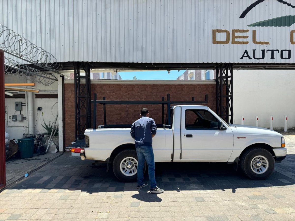

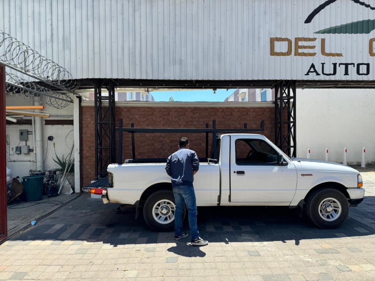

being very honest I don't know how to identify the engine of my car but what I do know is that its origin was from the USA since a relative brought it to my country.
And after all thank you

Since it came from the United States, it would have the 2.5 Lima engine then.
The fuel mileage you are getting, is this from just driving around town or do you drive on highways? It makes a difference and from what you are describing being done to the truck, it sounds like it should running as efficiently as it can.
Based on the fuel mileage my old 1998 Ranger with the same engine got, 16 miles per gallon with only driving around town is within reason. The best mine ever got was 22 mpg with straight highway driving. Supposedly, the truck is able to get something like 25 mpg with that engine on the highway but I never saw that kind of mpg out of the truck even though it was a regular cab, short bed, with a manual transmission and no air conditioning or fancy electronics. It really couldn't get any more basic in configuration.
