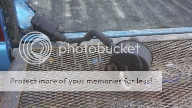

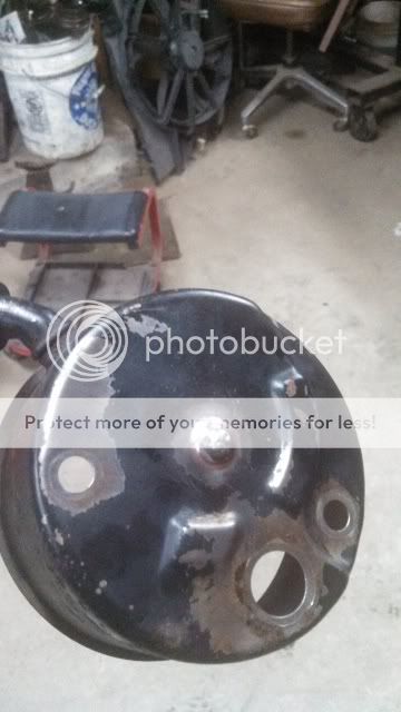

Stopped by my local junkyard yesterday...scored a Saginaw with a remote resi setup for $10. Not sure what its off of...It was laying in a pile of engines. lol The remote resi has a Chrysler logo. I think its from an older Caravan
PlumCrazy's Build
Since the return barb is in the middle, I can still use the Ford banjo fitting with no interference, unlike the Astro setup
I welded the extra return barb closed since I wont be using it.

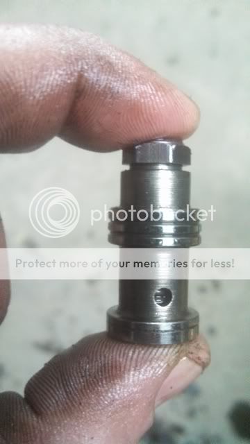

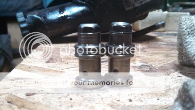

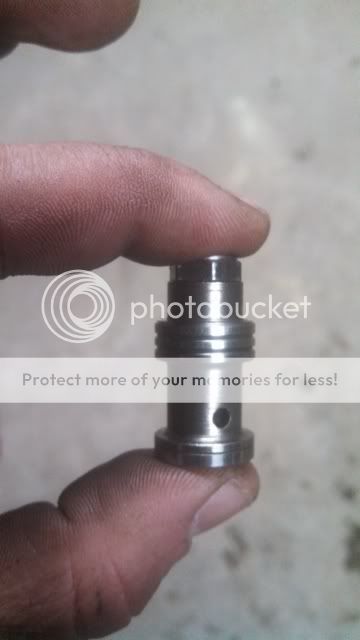

I pulled the flow orifice out and drilled it to 5/32, then turned the relief all the way up.
Before
PlumCrazy's Build
After
PlumCrazy's Build
Stock
PlumCrazy's Build
All da way turnt up...

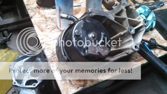

Swapped out reservoirs last night and popped in the larger flow control and bumped up relief..
PlumCrazy's Build
Looks like my T bird relief had a single shim.
Tbird is on the right
PlumCrazy's Build

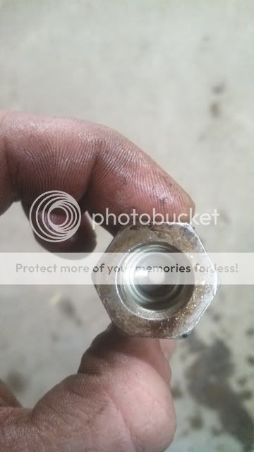

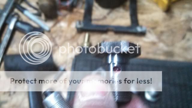

My pump already had a 5/32 orifice, but it had a lot of restrictive drillings through the banjo bolt and fitting block. My camera died, but I drilled out the banjo to .25" and added a second cross drilling 180* from the original, I also opened up the block to .25"
Before I opened anything up.
PlumCrazy's Build
I punched this hole straight through.
PlumCrazy's Build

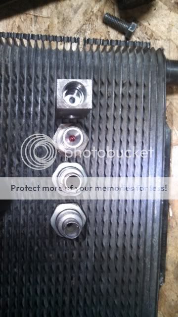

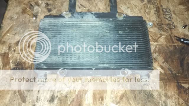

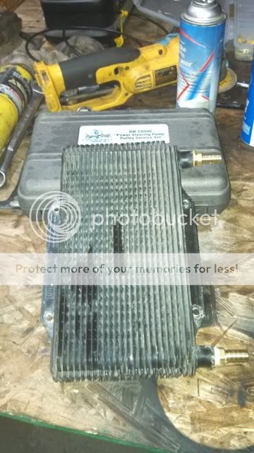

My old cooler was setup for 3/8" hose with non removable barbs, so I went on a hunt for a cooler capable of excepting 1/2" lines.
PlumCrazy's Build
I found this little trans cooler from a 90s Chevy 3/4 ton. It it had goofy quick connect fittings, but the cooler itself has 3/8" NPT. I zipped in a few brass barbs a mocked it up last night, it looks perfect.
I am still waiting on one last fitting for the filter, then I can finish plumbing everything.

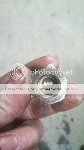

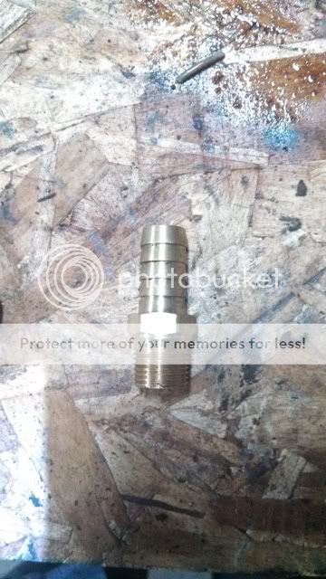

I took a 1/2" barb with 3/8 NPT and ran my 5/8-18 die down it to make it straight thread like inverted 3/8 flare. I used this fitting at the box outlet, no installed pics since my phone died...

Here is the Chevy cooler with 1/2" barbs installed

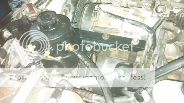

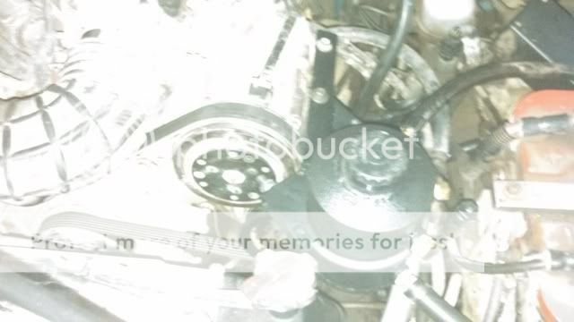

My original plan was to mount the resi over the pump, but here is my issue....
PlumCrazy's Build
PlumCrazy's Build
PlumCrazy's Build

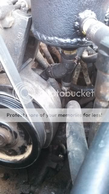

So I ordered a 90* barb so I could move it up ahead of the accessory drive and down a few inches.

Well, if you had the items to remake the res, you could make one that is laying on it's side, that way it would be a little lower.

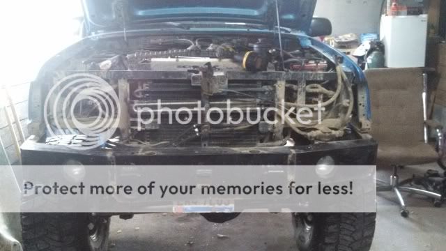

Got a little work done last night.
Pulled the header panel/grille off and pulled the old cooler out and made up a bracket to mount up the Chevy cooler.
PlumCrazy's Build
PlumCrazy's Build

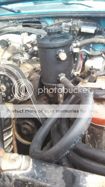

I swapped the fittings on the filter, but Im still waiting on my 90* 1/2x1/2, but I was able to run all my hoses and cut them to length.

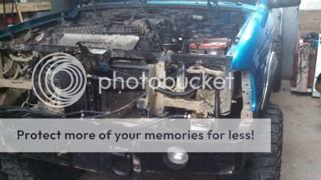

I made a bracket for the reservoir.... that was a TIGHT fit. It is within .125" of the belt, radiator, hood, and AC lines. I am still waiting on a 90* 5/8 barb for the bottom of the resi too. FYI finding 5/8" low pressure hose that can handle ATF was difficult. lol I had to find something local and in stock since I'm out of time lol
PlumCrazy's Build
PlumCrazy's Build
Ill take more pics when it isn't dark.lol Hopefully my stock motor mounts dont give to much and let the motor move around too much.
Hopefully I can button up all the power steering tonight then I have left is the belly skid.
