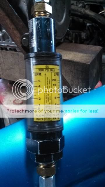

Played with the OBA again last night...
Plumbed it up so the motor was in series with the box and hydroboost. I actually have the motor between hb and box just because its easier, but I will need it to be the first component after the pump if I end up with two pressure settings..
It was flowing just over 2 GPM, so that means the the York was spinning right around 950 RPM(according to my bench test) at an idle, which puts the output around 6.5 CFM at and idle, and 12ish with my high idle kicked on.

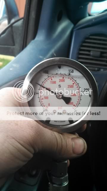

My new issue is pressure.... I don't have enough pressure in the hydraulic system to build more than 70-75 PSI in the tank.
So I threw a gauge port in the pressure line to see just where my Saginaw is set.
Its right around 1000PSI. I am going to pull the relief out and pull a shim out, to bump it up to 1350-1400 PSI, since thats all I feel safe putting to the box and HB.
If I cant build over 100PSI air pressure, then I will bump the Saginaw relief setting to 1600-1700, and then add a relief after the OBA motor to limit the rest of the system to 1000-1200PSI.
Im fine with speed/flow numbers, so I don't think I will need port the HB unit or increase line size much, although I know it would probably help reduce back pressure on the return side that I am sure is driving my pressure side up 100-150PSI.
So I should be able to tweak things in enough to work eventually.lol Then I have figure out where to mount everything and start hard lining the hydro lines and control valve, etc.

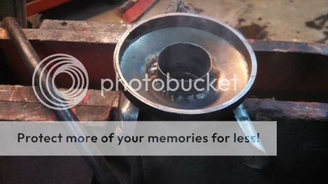

With the hydro assist cylinder I have been fighting to keep fluid in the reservoir. When I turn to the left the amount of fluid coming out of the cylinder is more than the attached Saginaw resi can hold.
So I started scrounging around for external resi candidates.
I picked up an external resi from an Astro van a while back, but it seemed a little small still.

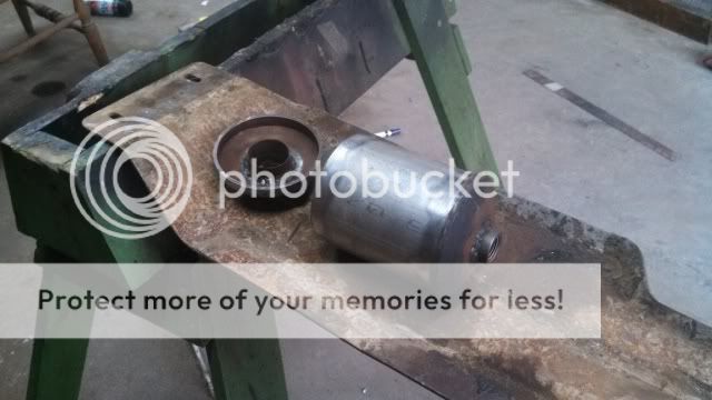

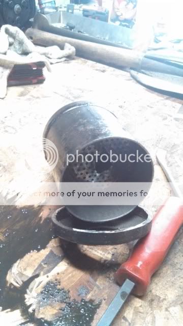

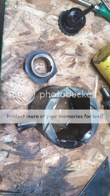

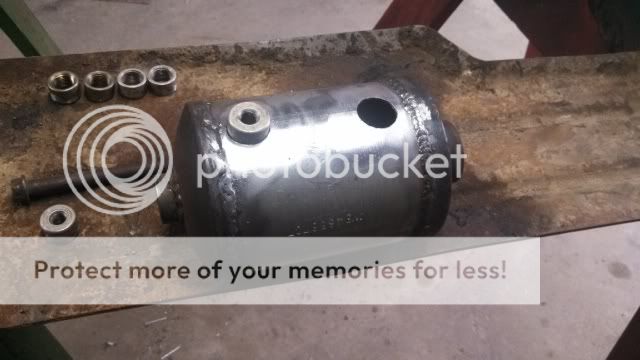

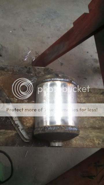

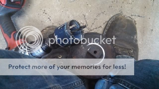

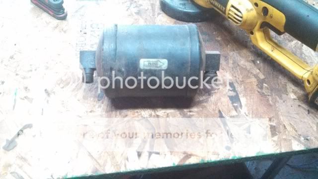

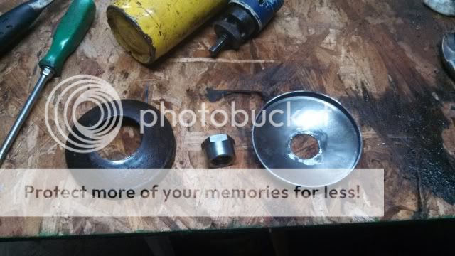

I came across an old AC filter/ drier from our combine that I had replaced. I thought I could just punch holes in it, gut the desiccant junk and screen out and weld in bungs.
Turns out its in there pretty good.lol

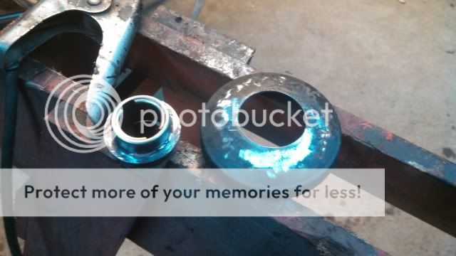

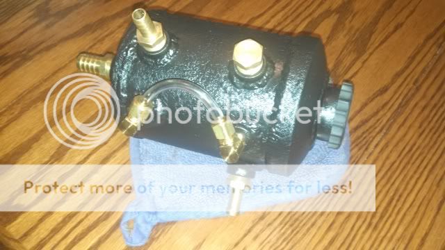

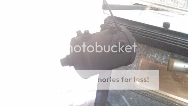

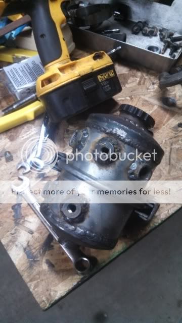

I ended up salvaging the end caps and welding them to a piece of 4" exhaust pipe. I cut the fill cap out of the Astro resi and welded it into the top, then welded in a 1/2 NPT bung in the bottom.

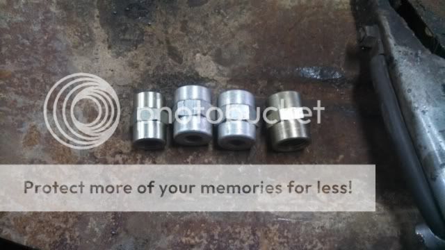

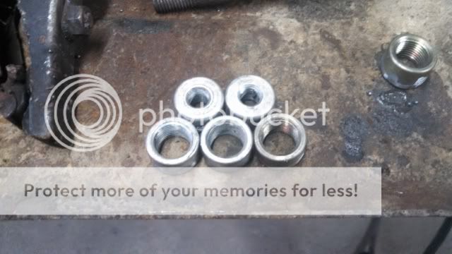

I am too cheap to buy real bungs, so I cut a bunch of couplers in half.lol

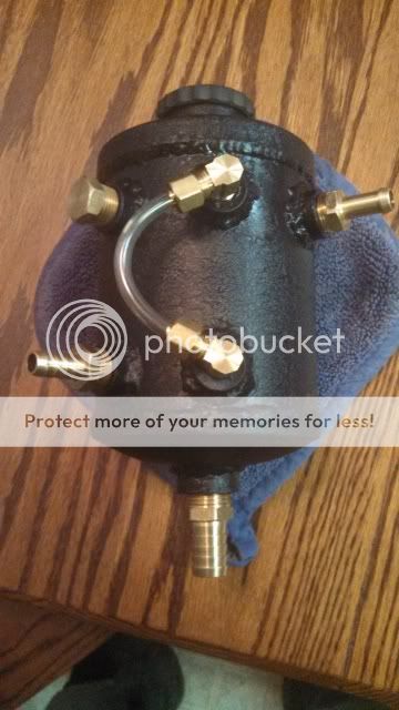

I put in enough for a sight glass, box return, hydroboost return, and a extra for a possible external relief valve later.

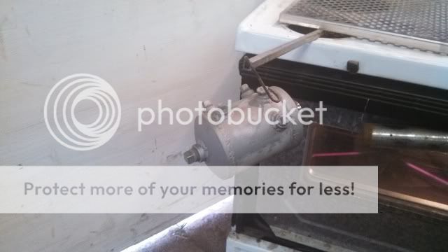

The welds look wayyy better in person. lol
I blasted it and powder coated it wrinkle black.
I am also going to bump all the low pressure return lines to 1/2 to reduce back pressure.
I still need a few fittings and a bigger cooler though.
I plan on running an Astro Saginaw pump resi and drilling my flow orifice to 5/32 as well as removing the shims on the relief. I am making a spool clamp to hold the relief with out marring or distorting it as we speak.
