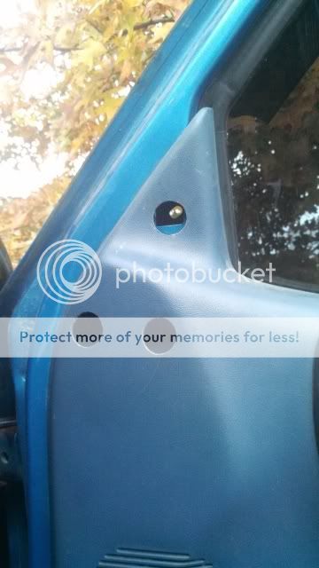

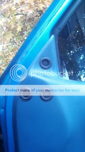

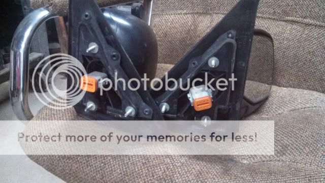

I guess I never posted my removable mirror setup...
I got some 8 pin Deutsch connectors from work a cut my mirror harness right at the door to add them in.
I punched 1" holes through the door panel for access to the studs. I used rubber plugs from any old RBV floor pan for removable covers
Now I swap out my good mirrors for some cheapo "flag" mirrors when I am wheeling.

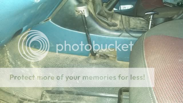

Pic of bigger notch I cut for the new shifter location.

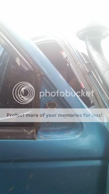

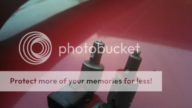

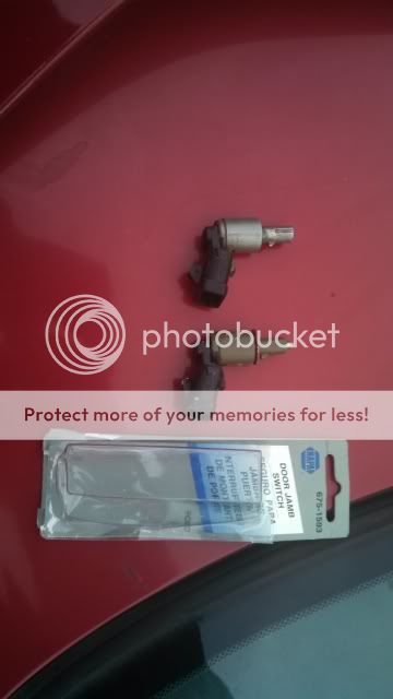

I finally got pissed enough at my door ajar/dome light switch that gets stuck on every other week and required me to pull the door panel and clean it/unstick it. Turns out, NAPA stocks them and it was 6 bucks.lol

i need one of those door ajar switches for my explorer. dome light will come on for all the doors except the driver door. i've been putting off fixing it for years lol

I've been wondering about those door jambs too. I can't decide on how to quickly/easily disable/enable them for when I take my doors on and off lol
