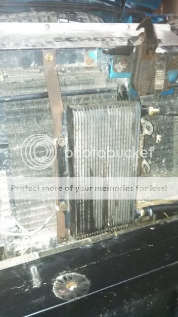

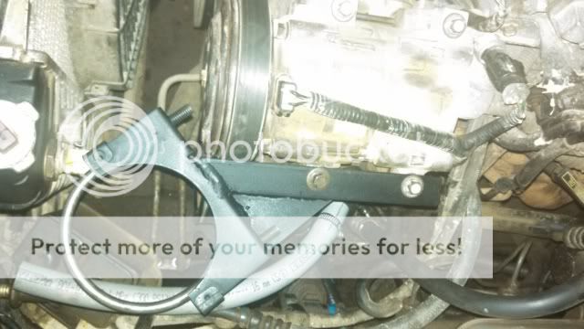

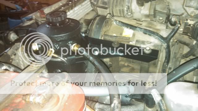

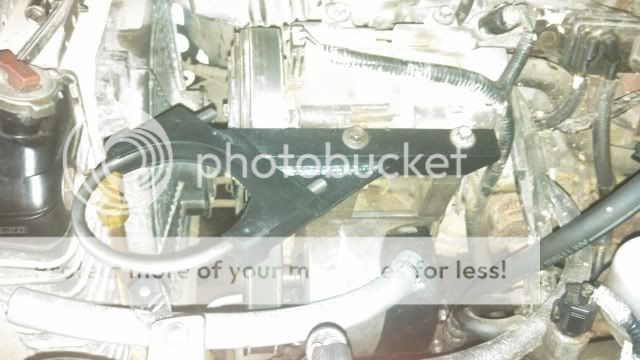

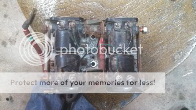

Better pics of the bracket...
Cooler bracket.

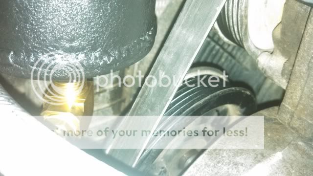

Its close to the belt for sure...

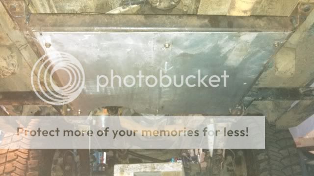

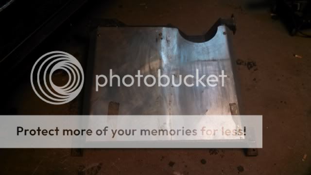

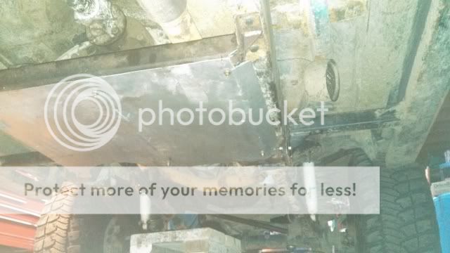

Last fitting will be here today, so I get the resi mounted and filled and move on to the belly skid.

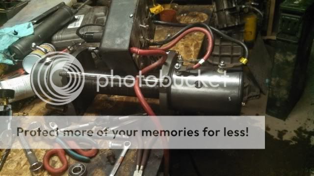

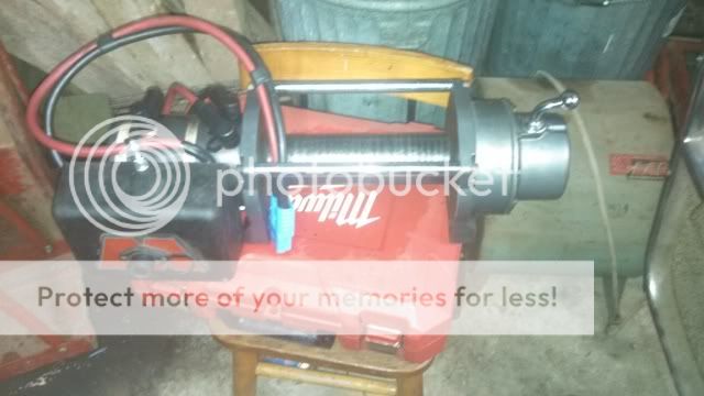

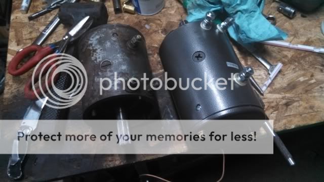

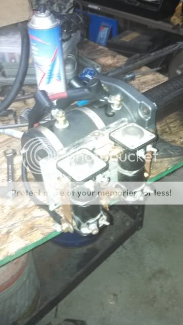

This little guy showed up yesterday too.
I put it all together only to find the brake is not working right. When I power in or out it sounds like a box of rocks, but the motor sounds fine if I run it separate, and if i drive just the planetary set with a drill, it sounds fine. But when its all together the brake assembly is constantly ratcheting.
Sent from my XT907 using Tapatalk
