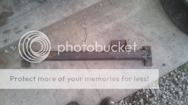

Boogered together a rear cross member with a new tcase mount since my old one was lighter weight, bent, and the mount was too low since I pushed everything up an inch when I made the new trans support.

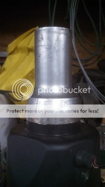

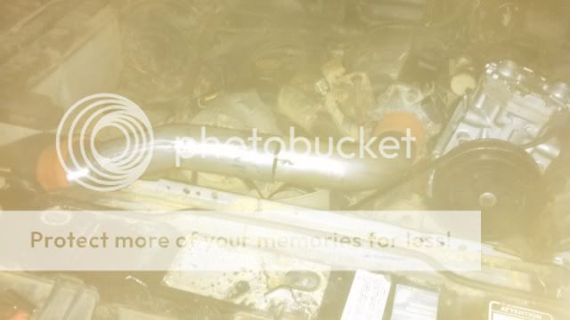

After mocking up the OBA on the B2 we found intake/belt interference, so we decided to make a steel intake tube to clear, we also are swapping to the 95+ air box so we can build a snorkel setup like mine.
Our neighbor is an old school muffler man who still has a few benders and expanders to tinker with, so we had him make an adaptor to get the 2.5" tube up to 4" to mate up to the box. He reduced some 4" down to 3.5ish and flared out the 2.5 to match, then we welded it up. Looks perfect.
So I had him do the same for my larger 4.5" inlet and a 3" tube that I will use when I build my new intake for the boosted motor.
Its not as seamless as the one we did for the B2, but it will work better than anything I would have tried. lol

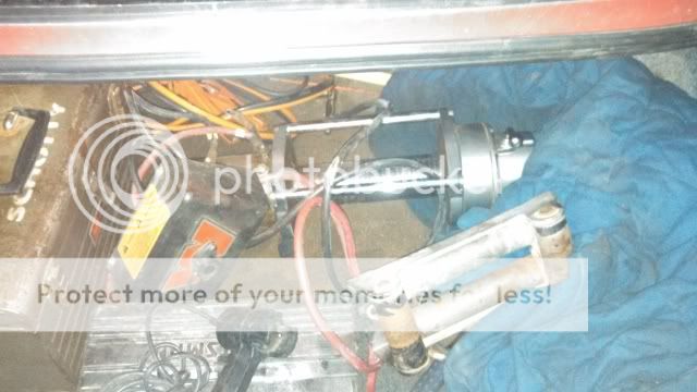

Picked up this little fella last night..
It bought it from a buddy who thought it had solenoid issues, but from my quick diagnosis its shorting out in the motor somewhere.
Gear box was gone through and resealed in then it sat on a shelf for 5+ years.
I pulled the motor apart and found three brushes had no tension on the springs, but they looked to be in good shape as did the armature. It turns by hand fine, but acts like a dead short when try to power it.
Im getting a quote for having it rebuilt. I would rather spend $50-100 to have an old motor rebuilt by a Mom and Pop shop than spend $80 on new Chinese junk on Ebay.lol

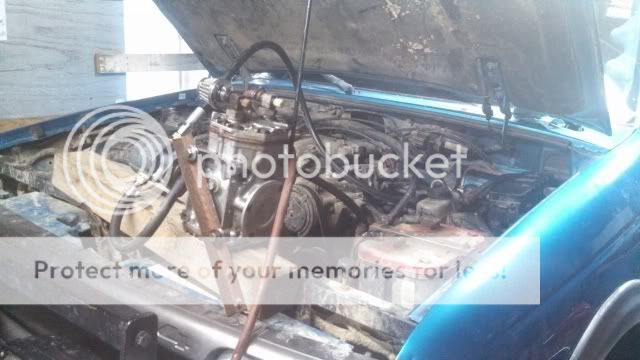

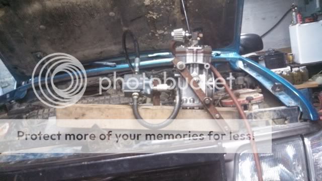

Played around last Thursday with my OBA idea...

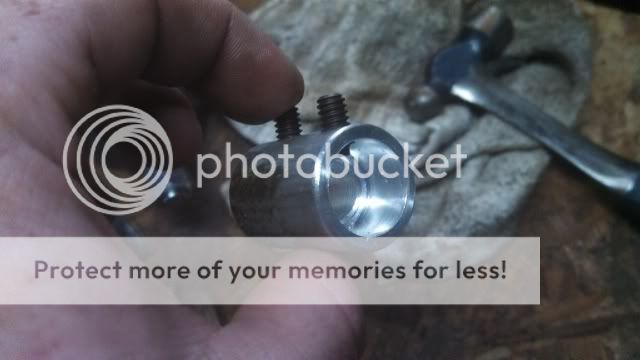

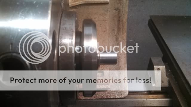

I made a temporary coupler and mounted the motor and compressor up to a piece of wood just to test the concept. When I make everything legit, I will use a small LoveJoy coupler...
It fits the 1/2" motor shaft and the 3/4" York shaft.

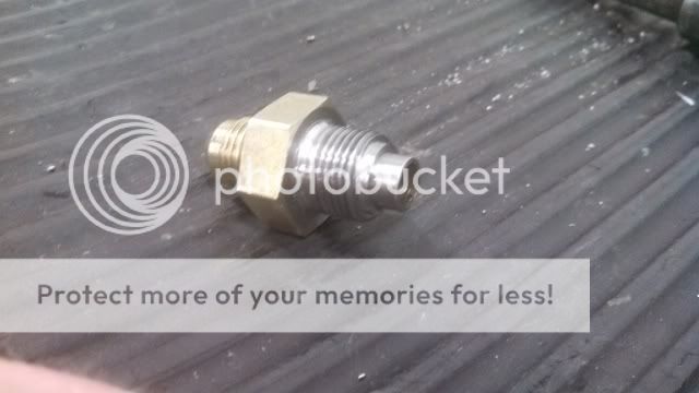

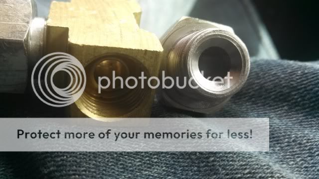

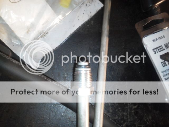

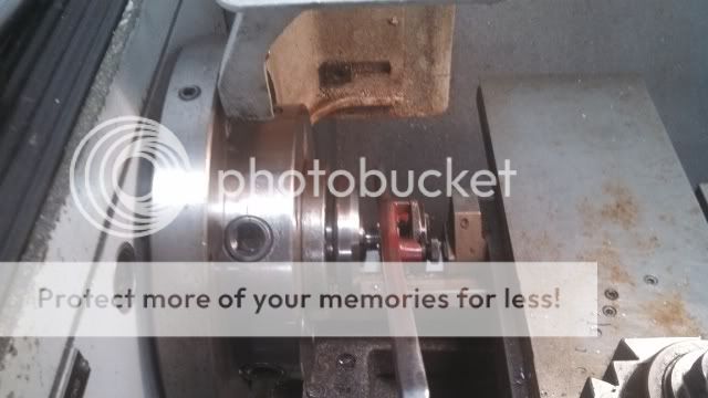

I made a fitting at work to adapt 3/8 inverted flare to -6 JIC (aka AN).

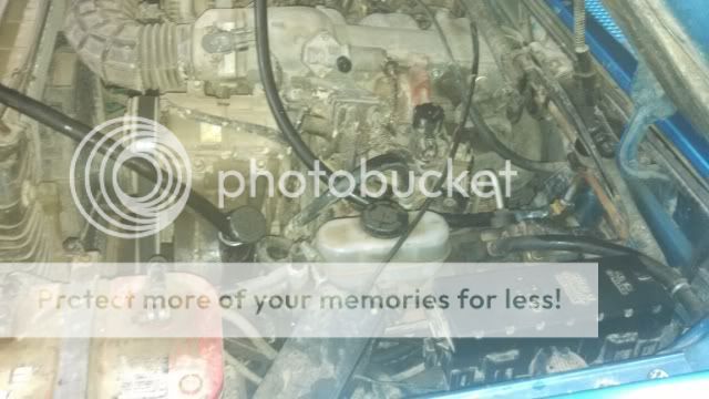

I swapped out a union for a T and ran it to my motor, and just threw a barb on the other side and dumped the hose back into the resi.
I quickly realized that a steering box is open center... lol I thought the pump sat at pressure and box was closed center....
It worked, but only if I turned the wheels a little to induce a load and raise the pressure/ block the open path and direct it to the OBA motor. lol

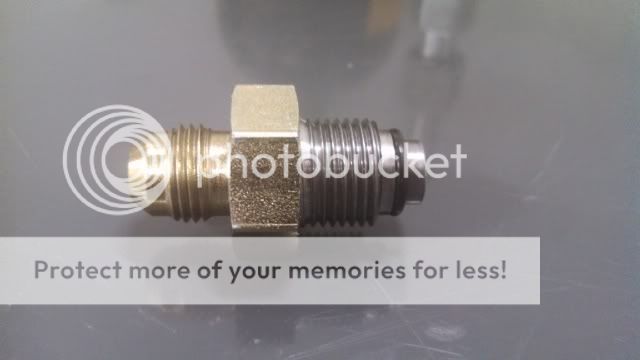

So I made another fitting to adapt the oring port on the Hydroboost to JIC this way I can put the motor in series with the box and use an open center switching valve to either bypass the motor or direct oil through it.

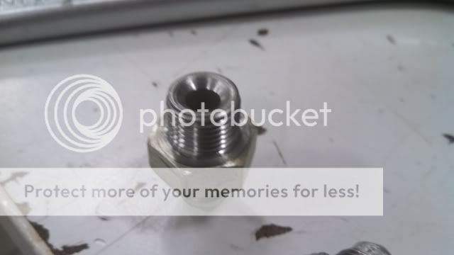

FYI..here is what the original hydroboost fitting looks like...

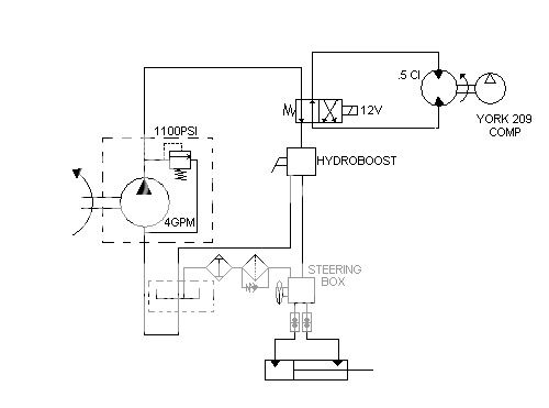

Here is a quick schematic of the hydro portion of the setup.
