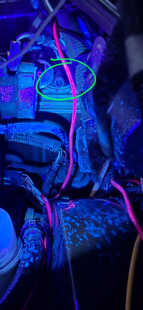

After my test drive: Nothing changed. Still getting oil blowing out of the valve cover, even when the PCV can't be providing that boost. Must be blow by then? That seems like an insane amount of blow by to cause this much pressure and this much oil to shoot out. I tried multiple slow runs ramping up to help break in the rings but there doesn't seem to be any improvement. It is during these slow runs that at higher RPM's the oil shoots out. Really at a loss. At the rate this oil is coming out I'll need to empty the catch can every few miles and top off the engine oil to avoid it running dry.
Pictures below of a UV light showing the oil shot out of the valve cover adapter and onto my brake booster, though it is getting all over the engine bay.

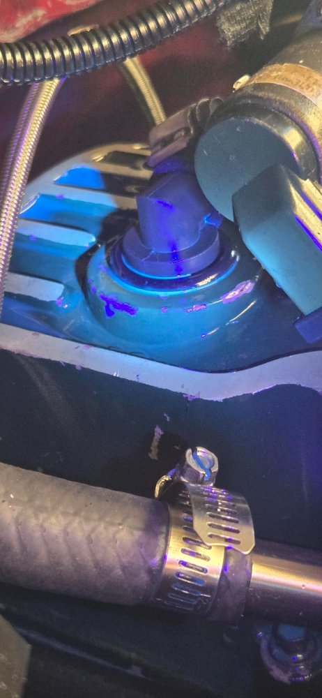

Update after getting the rest of the hose/adapters for the valve cover to catch can line - oil is still being blown out of the valve cover through that hole. I purchased and installed the stock replacement elbow and rubber gasket for this engine, yet oil is being forced out from between the two. I'm sure some is making its way to the catch can, but enough is escaping that I have noticed no significant decrease in smoke from oil being burned on the exhaust, so it appears that the check valve and catch can setup was unsuccessful, with no notable difference. In the image below you can see oil between the elbow and gasket, as well as between the gasket and valve cover.
