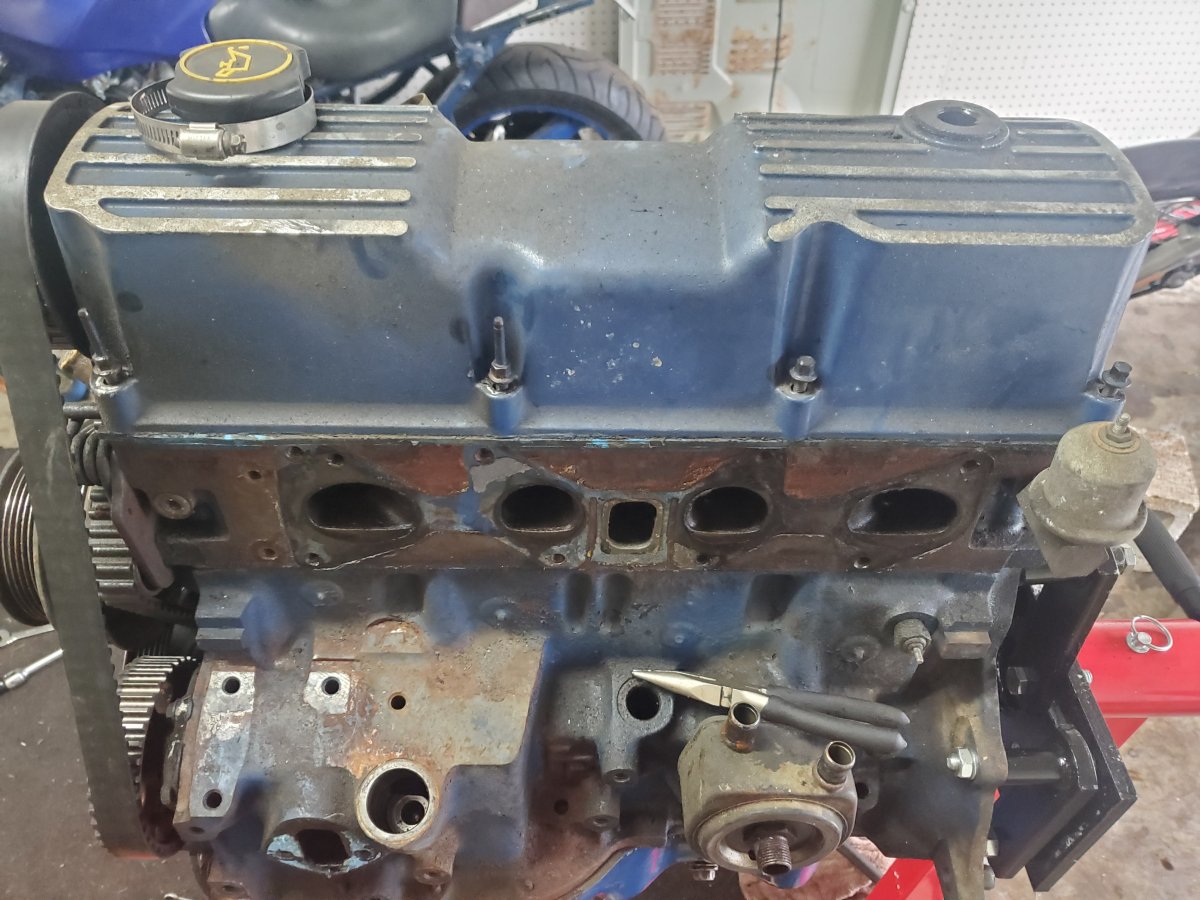

I do have the stock turbo valve cover, but I think there's a simple baffle to help deal with oil splatter. Just a sheet of metal to make the oil have to go around. Picture of the engine when I first picked it up is attached to show the style of valve cover. I don't think I have any pictures of the inside of the valve cover.

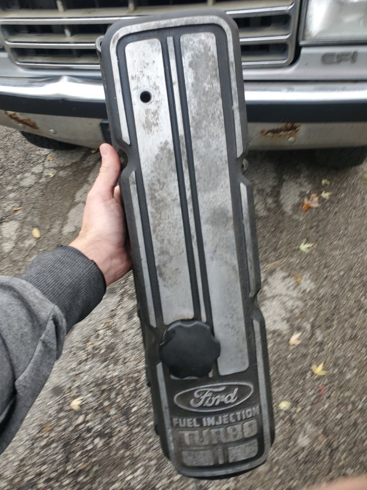

I have a spare "fuel injection turbo" valve cover that I may try swapping on after I get it painted, I just need an intake riser. This one definitely has a baffle along with a smaller size of vent hole so it may help.
