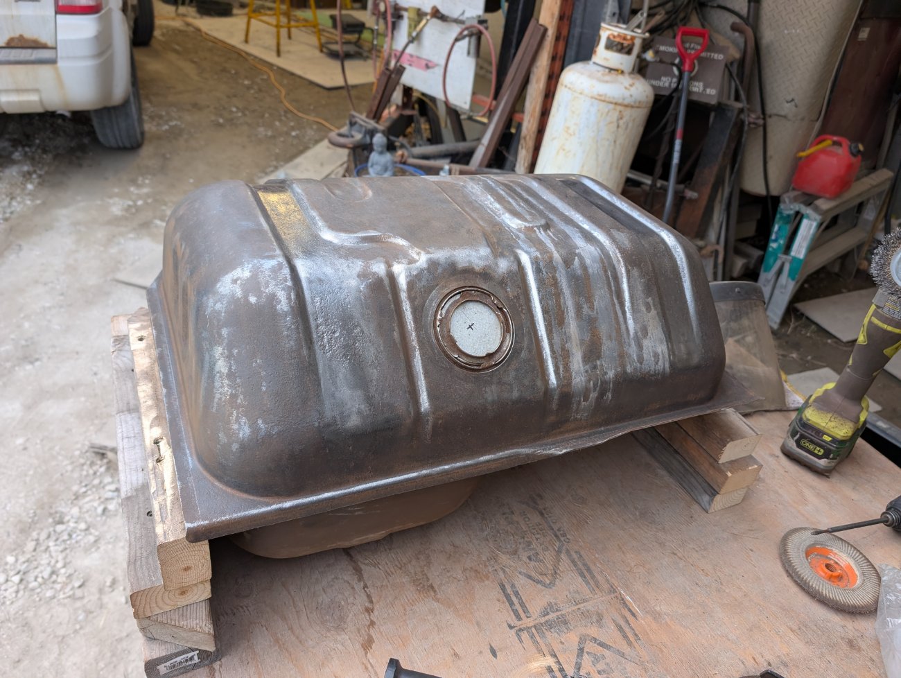

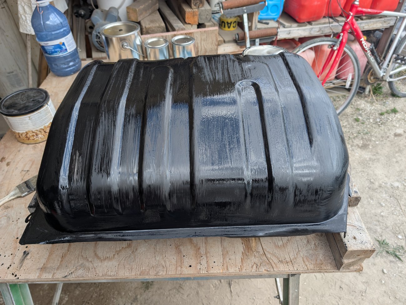

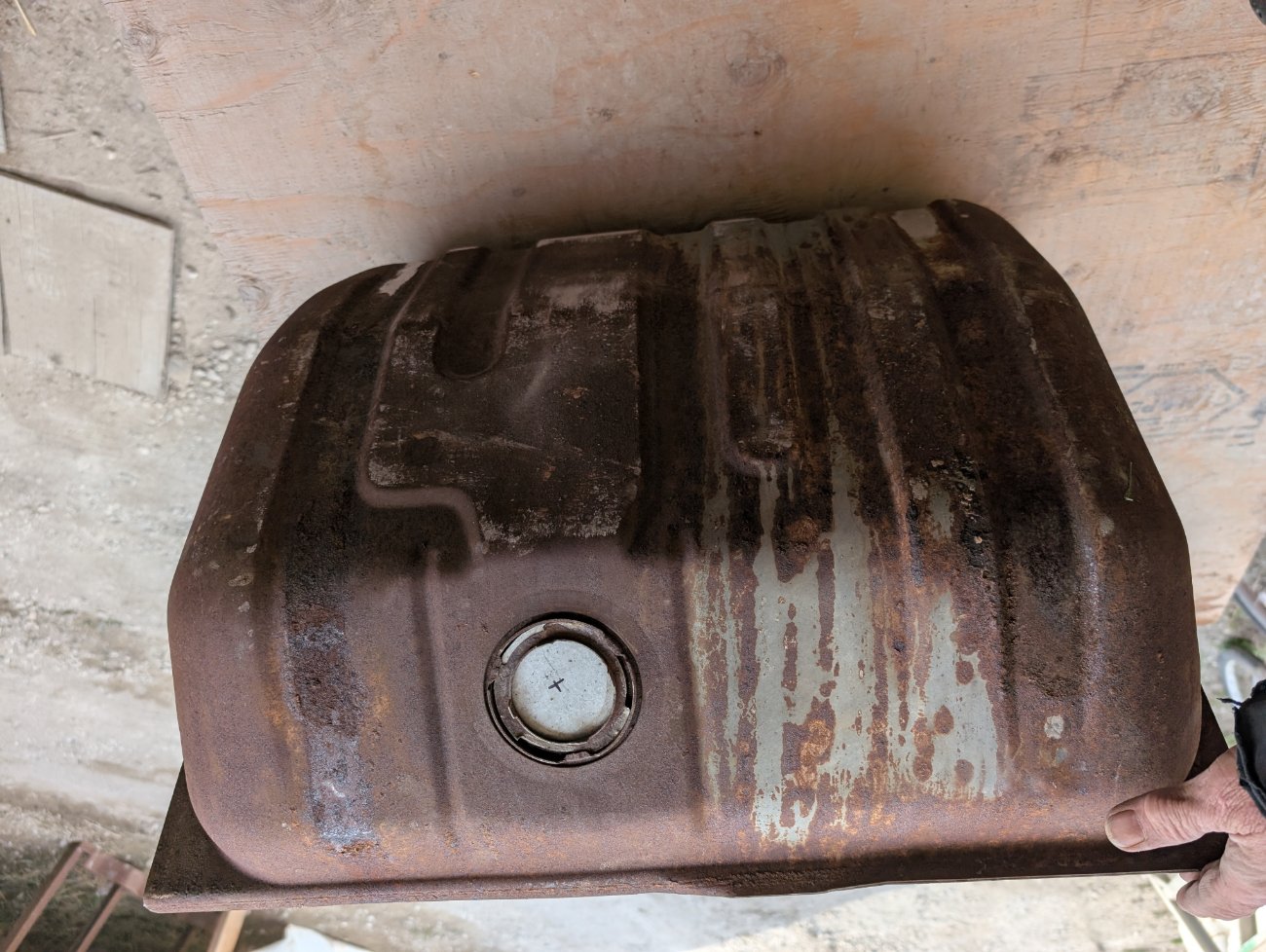

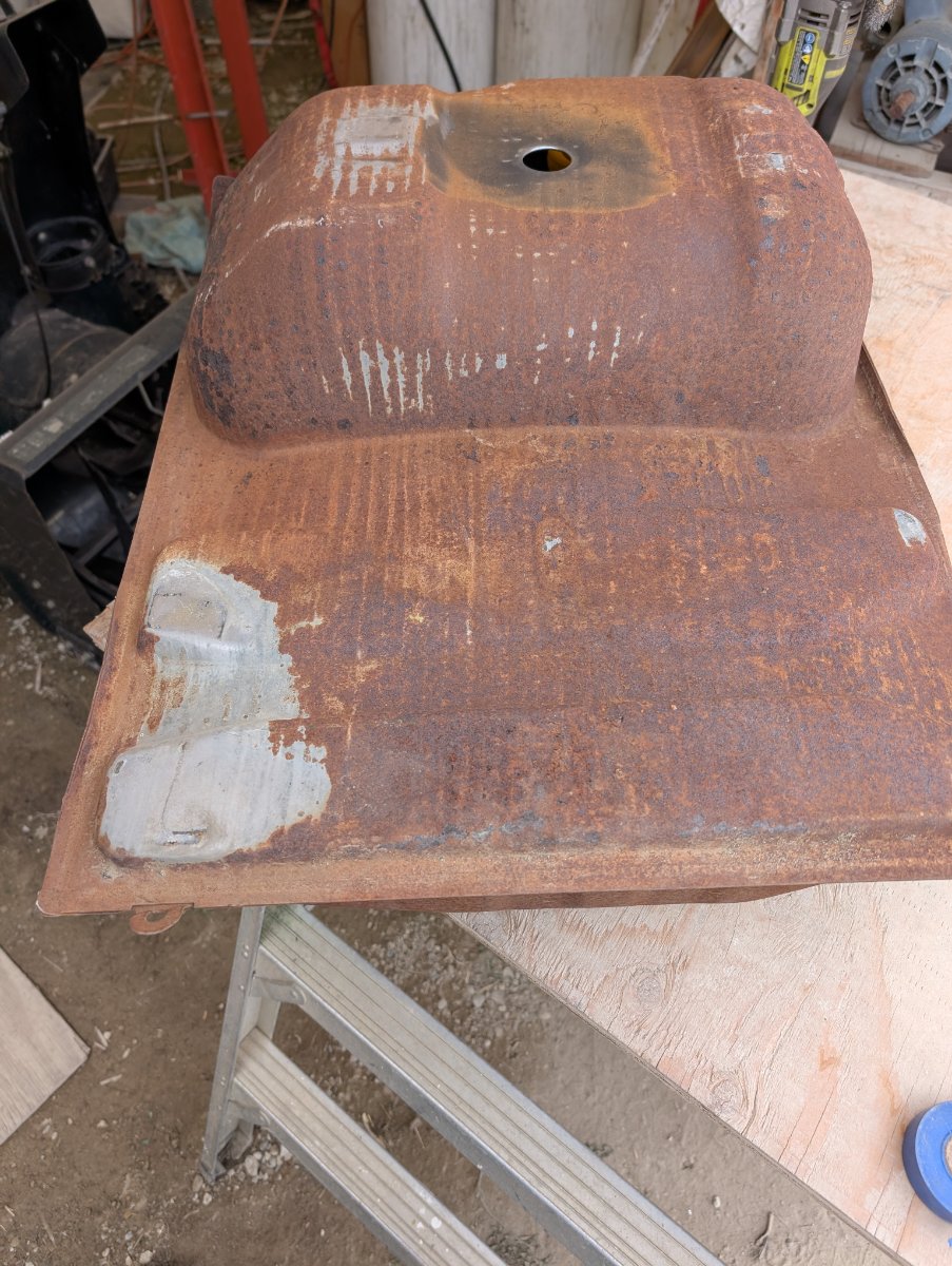

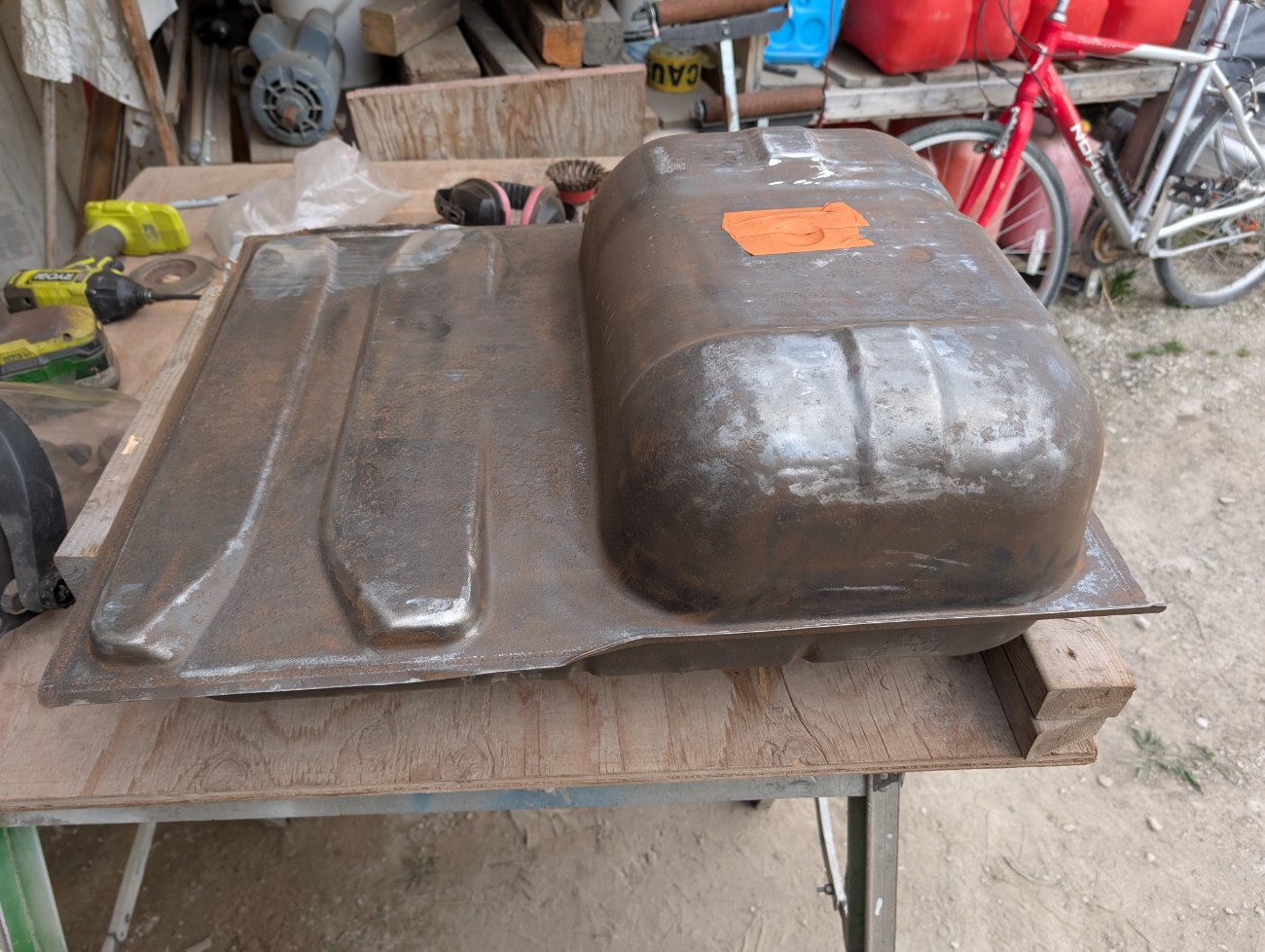

Got the tank down. Going to take it to a friends that has a hotsy pressure washer. It's rusted inside so will try tumbling with rocks inside, then coat with either zinc paint or por15. Depends on the gas resistance of the cured paint. May use some muriatic acid to clean out rust. Also looking at a 45 gal drum of acetic acid if cheap enough.
