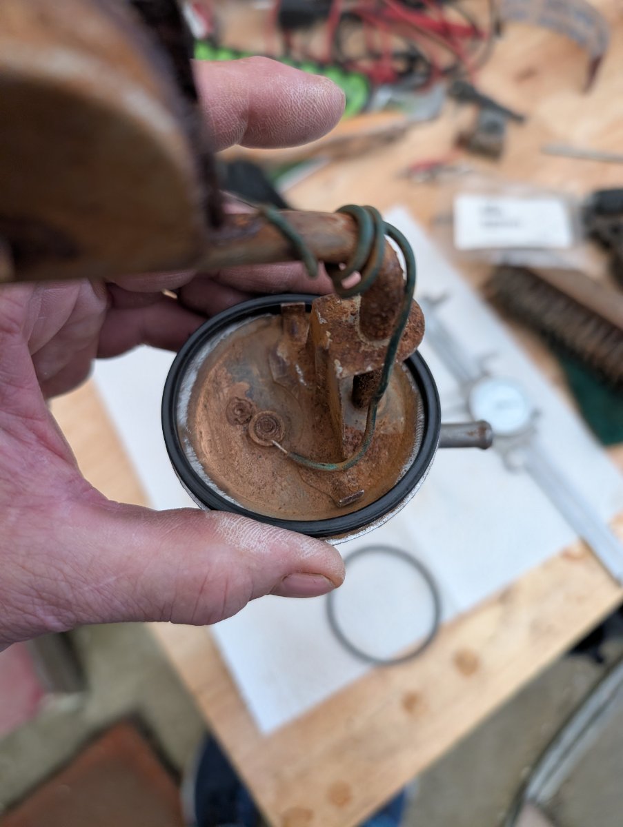

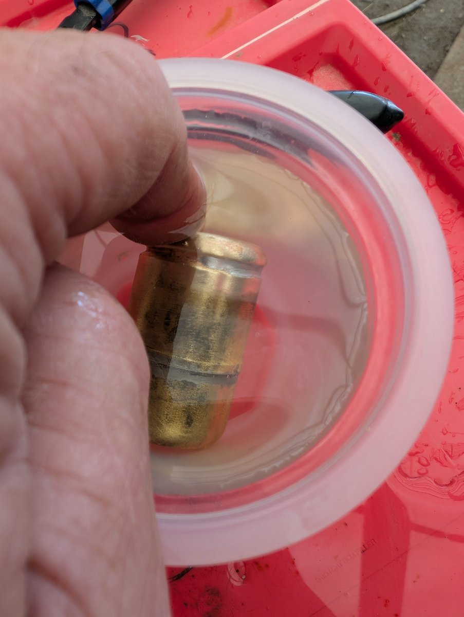

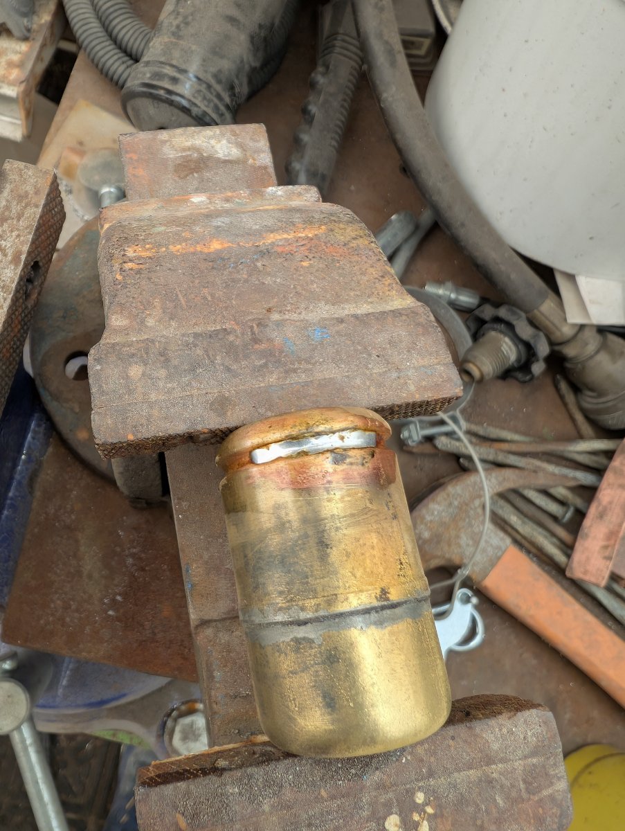

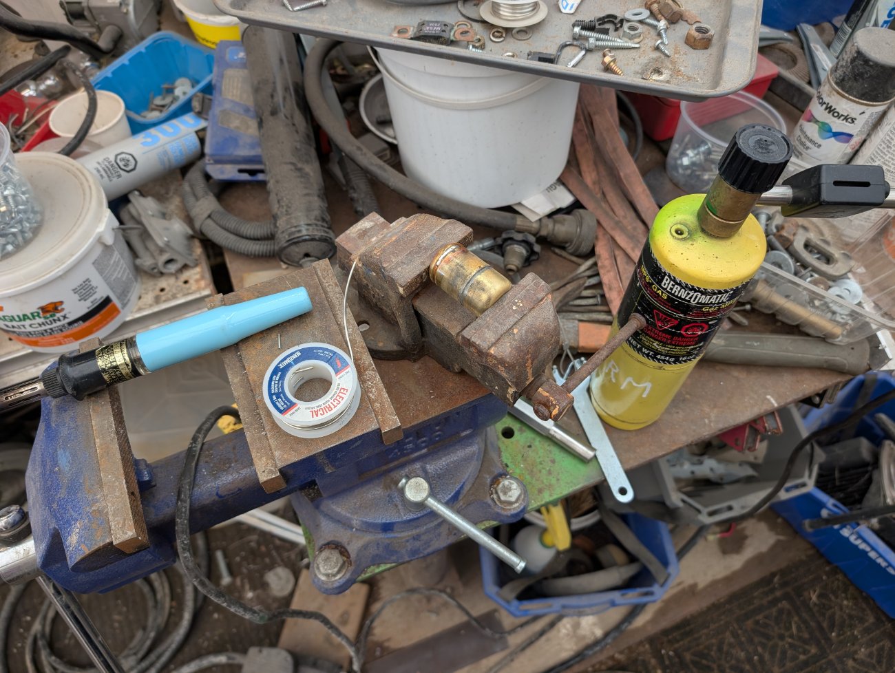

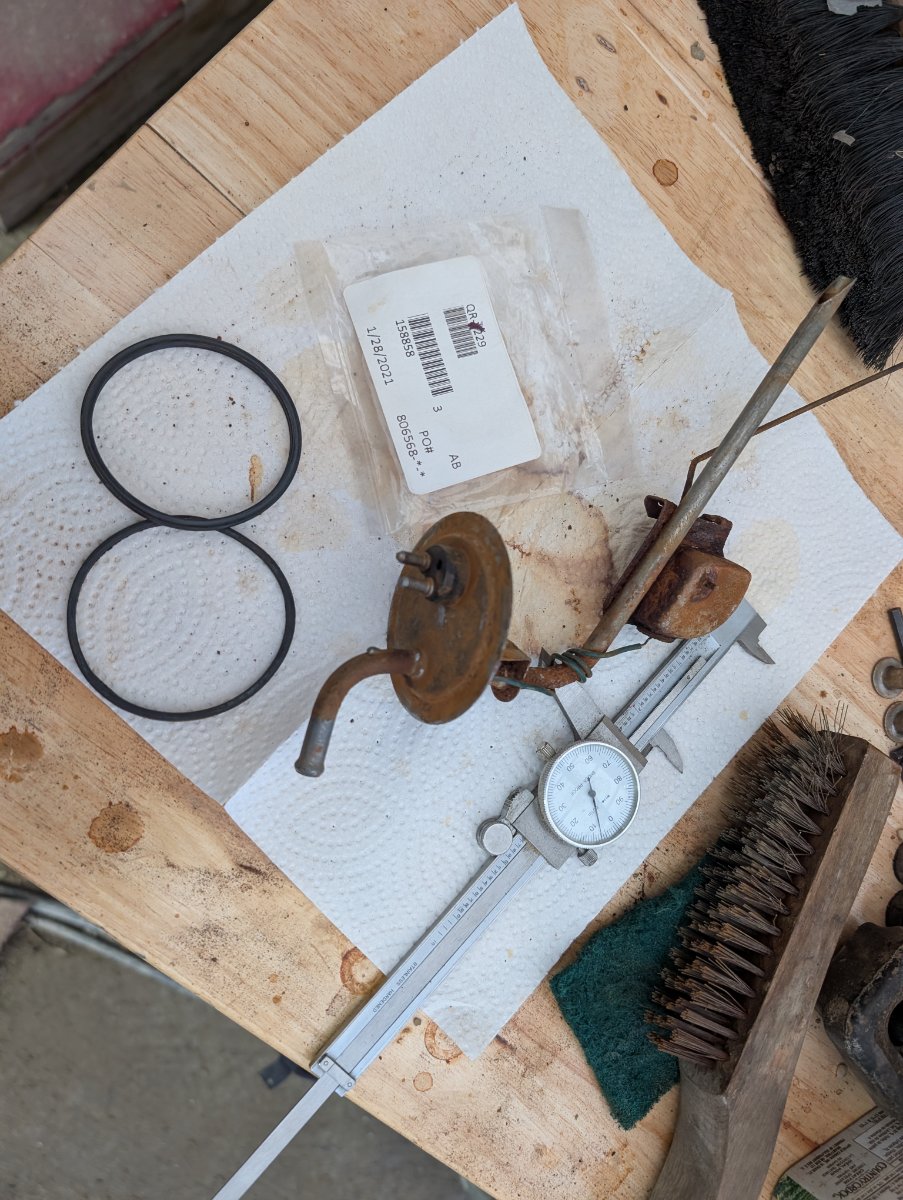

Yes I know. But they couldn't find ANYTHING to do with a sending unit, including individual pieces. But I was able to solder the float and there is no bubbles showing when immersed in water. I have the sending unit submersed in vinegar to get rid of the rust. I only the gauge sender and its working, so that's good news too. The sock I think I can find a generic one that will work. Only maybe problem is the square o-ring gasket. The old one is swollen too big to use again.

McMaster is great for oddball o-rings
not the cheapest but the best source
