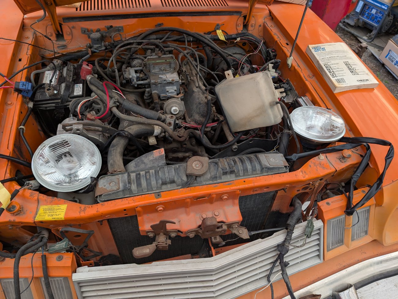

Today I removed, cleaned, and replaced the other signal light housing. It looked pretty grungy across from my new to me drivers side signal. Looks good but the color isn't quite the same. Maybe uv damage...

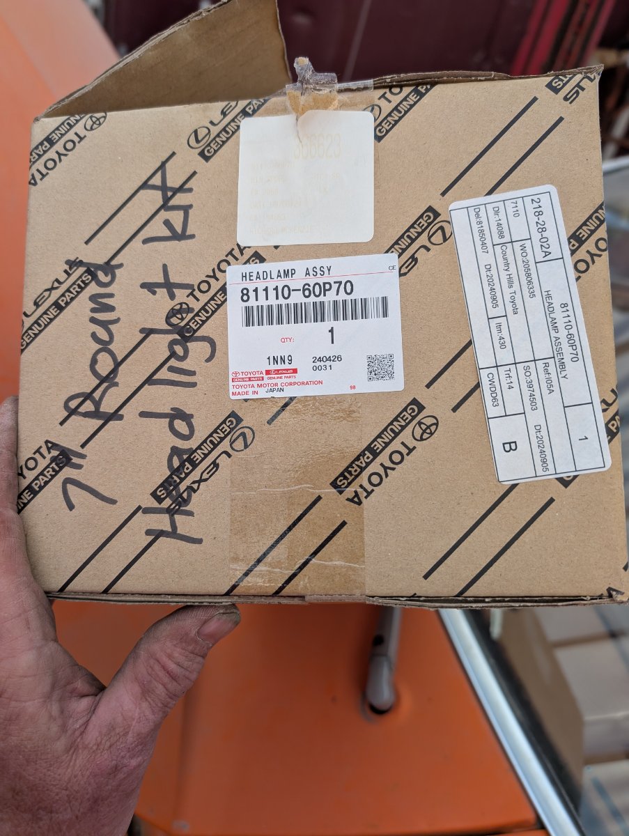

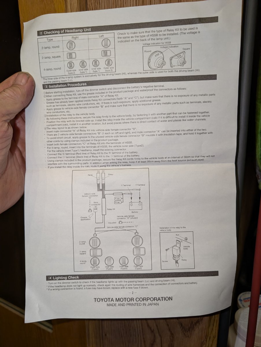

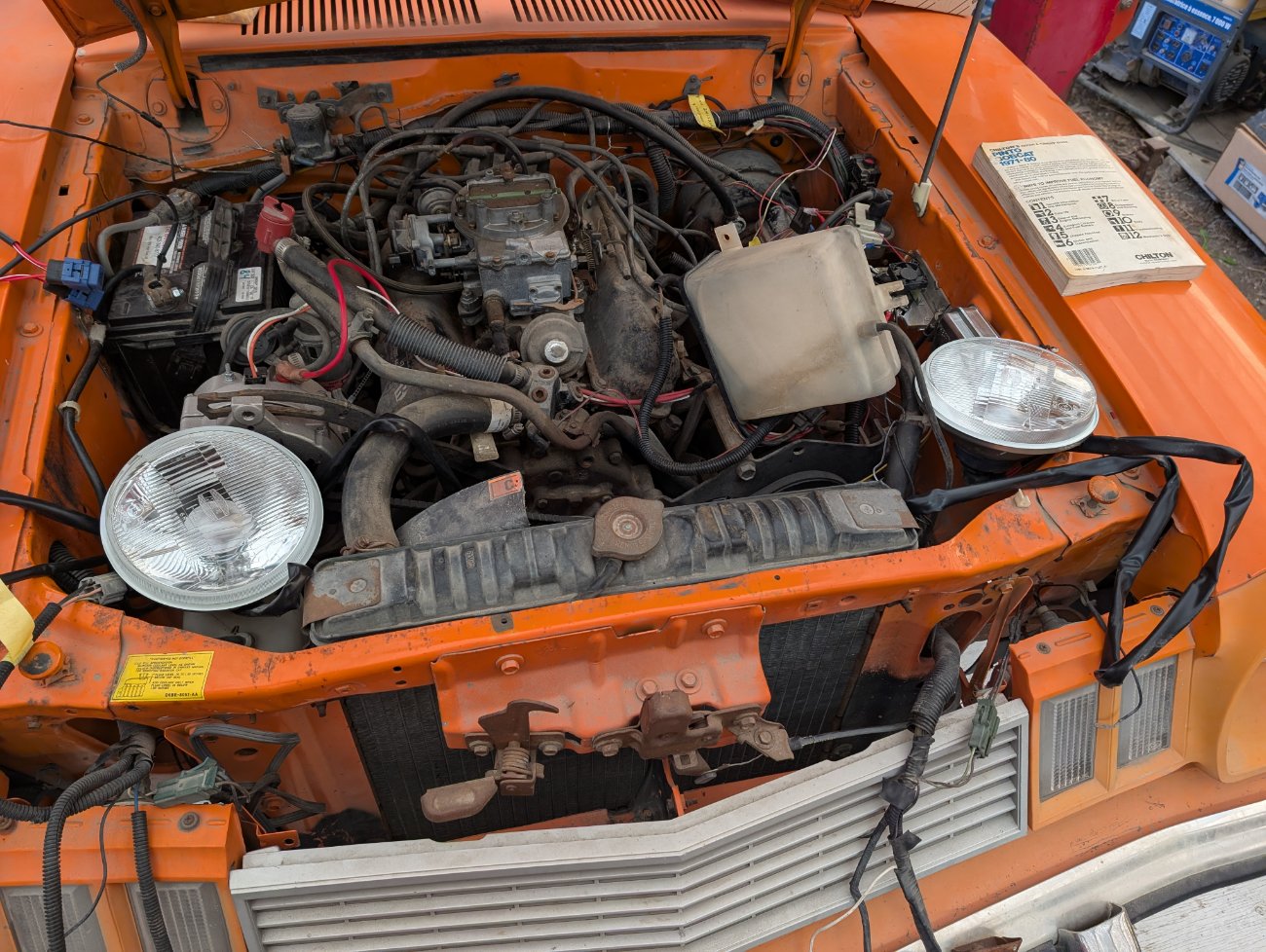

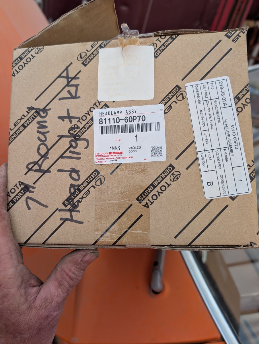

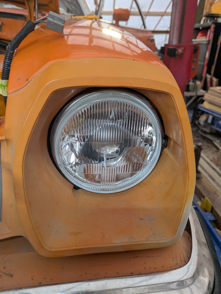

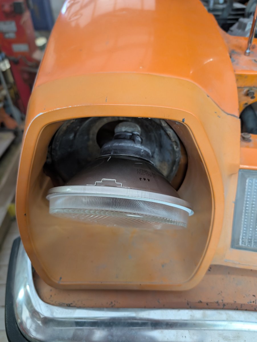

And I tested some semi-sealed halogen light bulbs that I picked up cheap from Toyota dealer. Up here I paid $50, but I heard in US prices around $20-25. This is for 2 glass halogen bulb and housing, and include fuses and relay wiring kit. It's been talked about for quite awhile so may not be available anymore. I bought mine last year, 2 sets. I have an old Grumman box van that could use better lighting.
