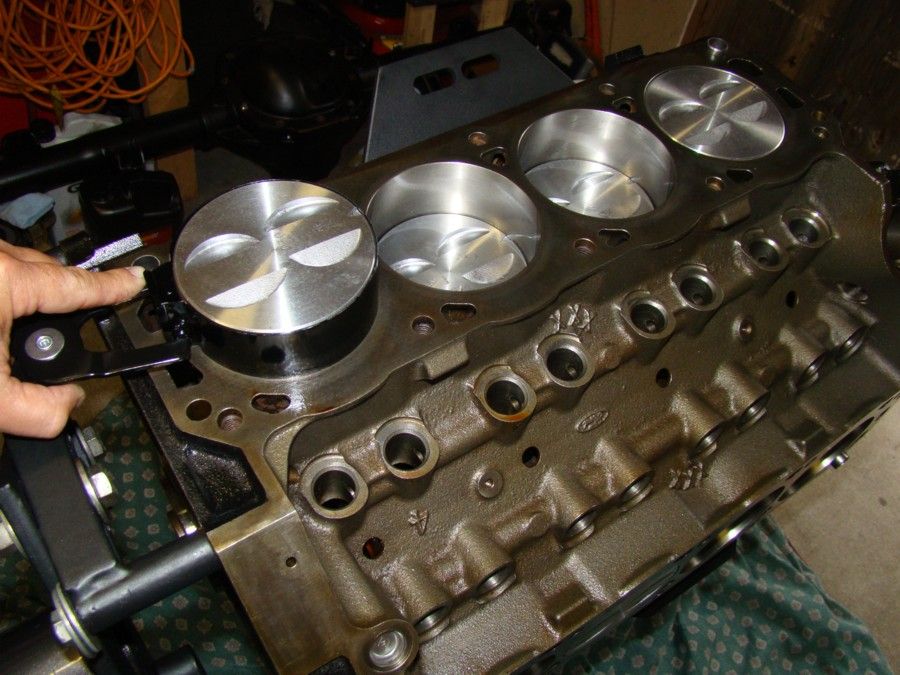

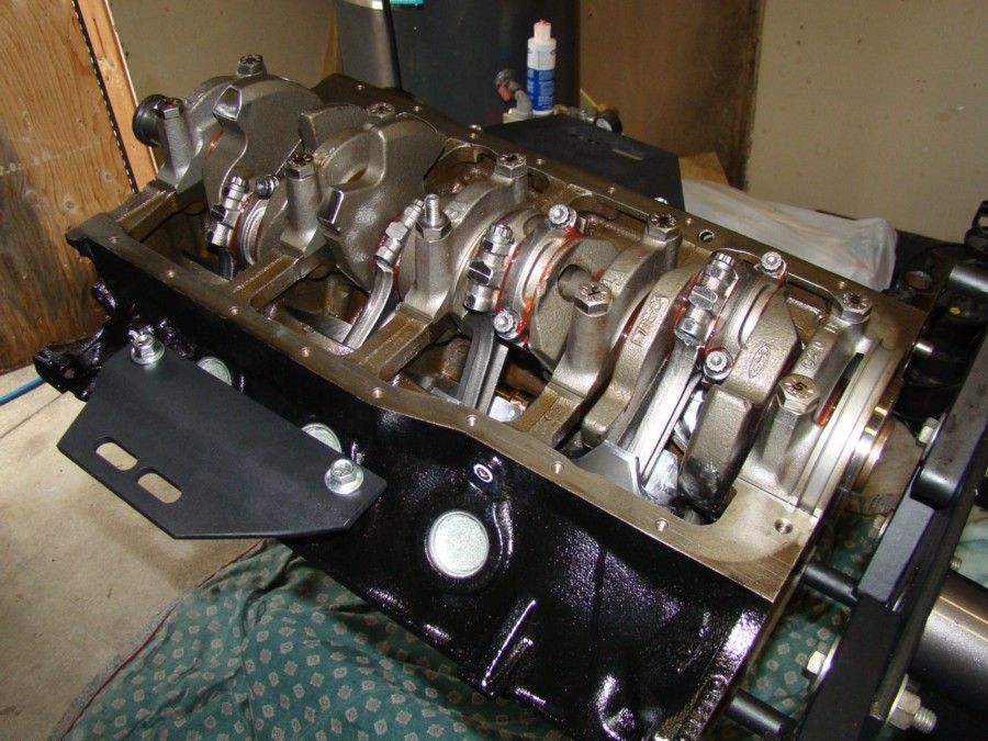

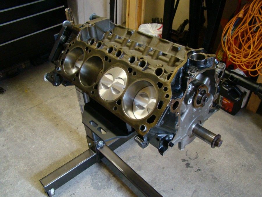

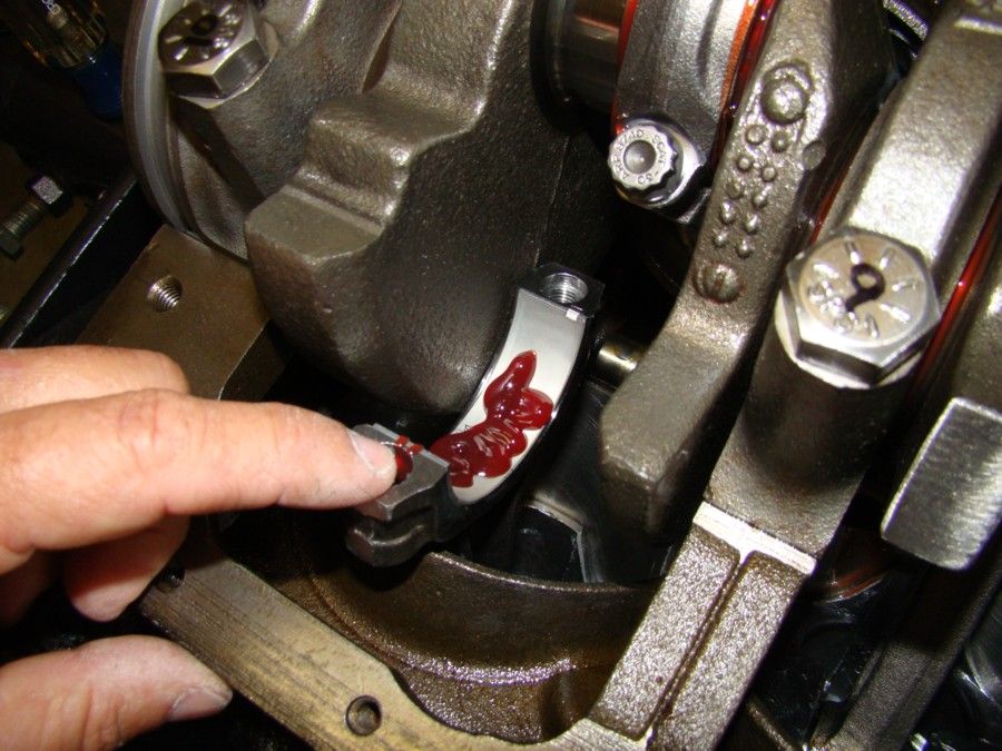

I had to take a week or two off from the 306 V8 and replace the 2.5 in my 98 Ranger. After a quick trip to NC to pick up a new 2.5 engine package from a forum member, then back to Florida for the install, and now the 98 is back in business. It sure runs good with that brand new engine. Now I am back on track with the final touches of the rotating assembly. Here are a few shots of the last piston/rod assembly going in and the bearing shells being set into place for the last time.
One more 2wd 98 coil spring 5.0 swap.
Now just a quick wipe down of the excess assembly lube and the short block will be ready to be stored away until the timing set can be installed and the cam timing verified with a cam degree wheel.

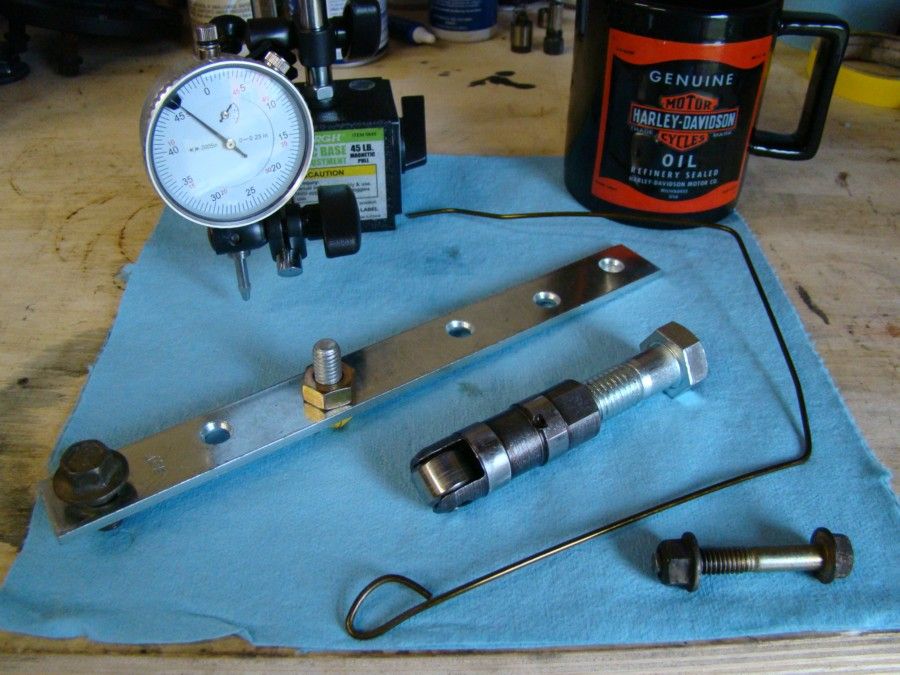

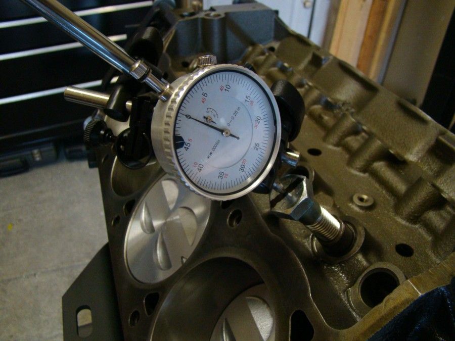

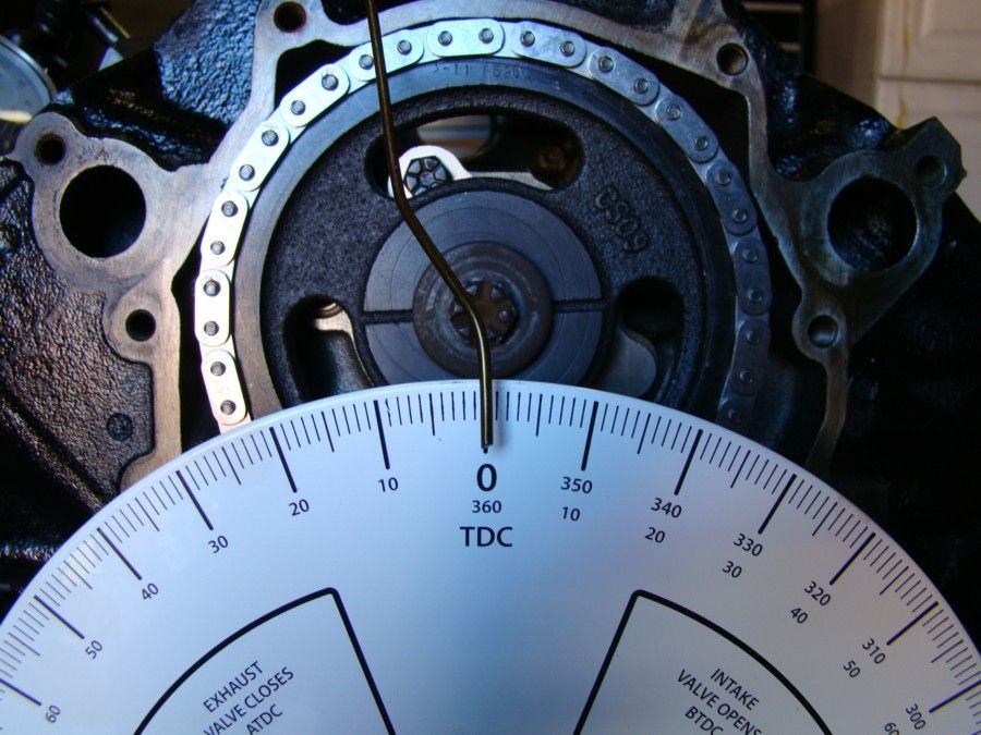

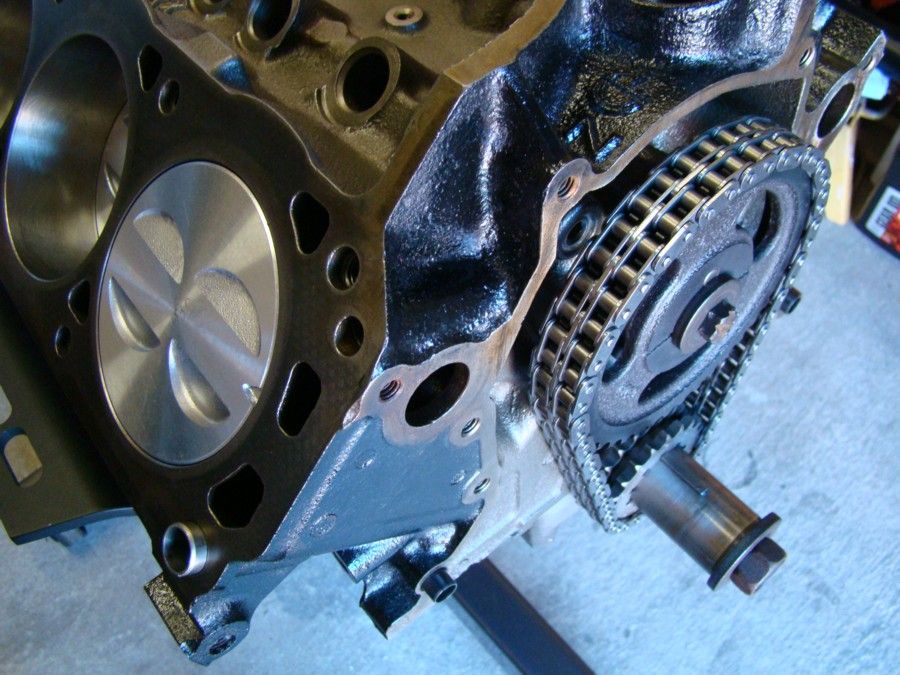

Today I checked the connecting rod side clearance and it came in at .017 across the board. I also got the timing chain installed and went ahead and degreed the cam. Everything checked out to spec using the "O" keyway on the crank gear, 22 degrees BTDC on the intake side.

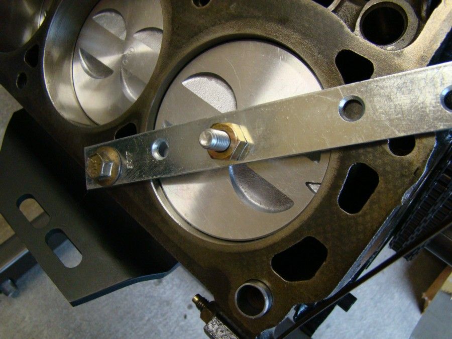

I made an extension for an old lifter so I could reach it with the dial indicator. I disassembled the lifter and threaded a bolt down the bore until it was tight. I also bought a piece of steel to use as a piston stop to find TDC. Most of the information I found on line recommended using a piston stop but I ended up going back to a dial indicator, it just seemed a little more accurate finding TDC.
(second lifter bore was used for better photo angle only, not to measure intake opening.)

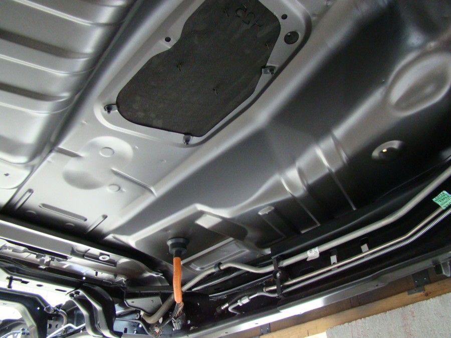

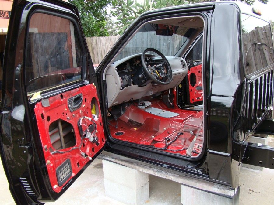

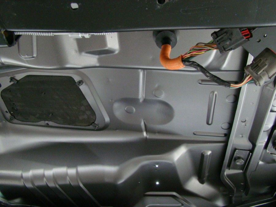

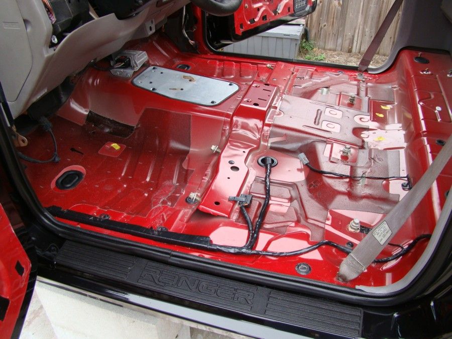

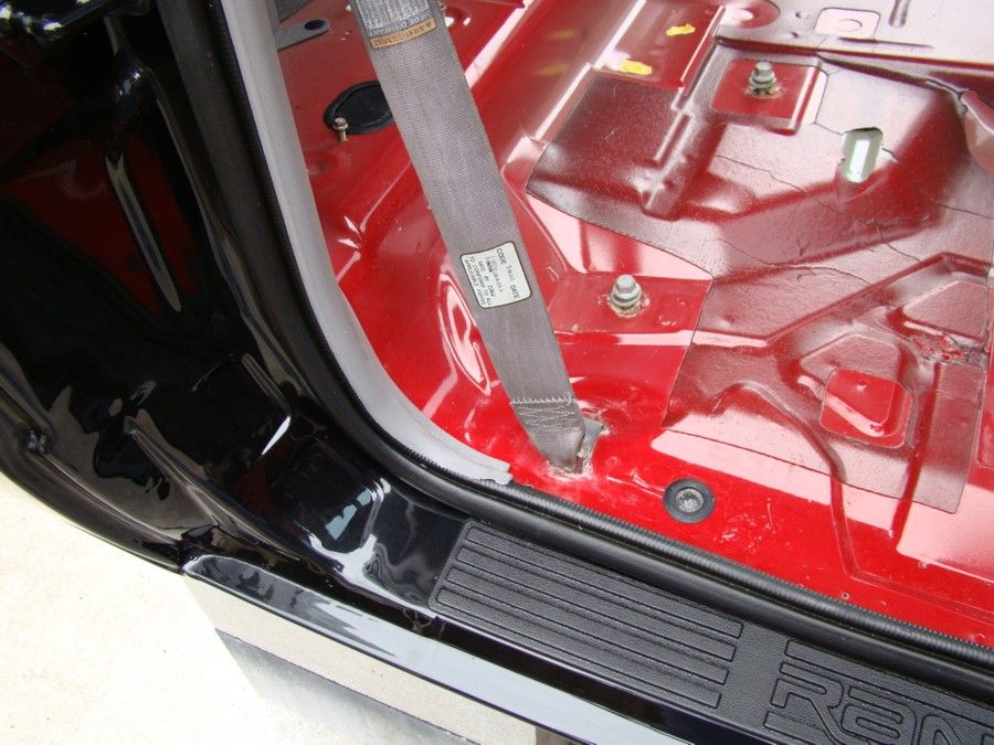

I know I was going to wait until after the holidays to start back on the V8 Ranger but I just couldn’t avoid working on it today. The weather was nice and I managed to leave work earlier than expected. I had a couple of hours to take care of a few “busy” items. I washed the interior floor pan along with the in cab harness and then reinstalled the harness inside the vehicle.
Once that was done I went ahead and dropped it through the floor and back into its original position.

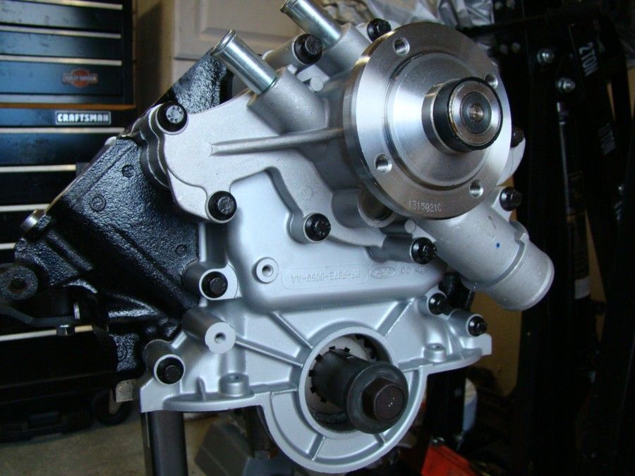

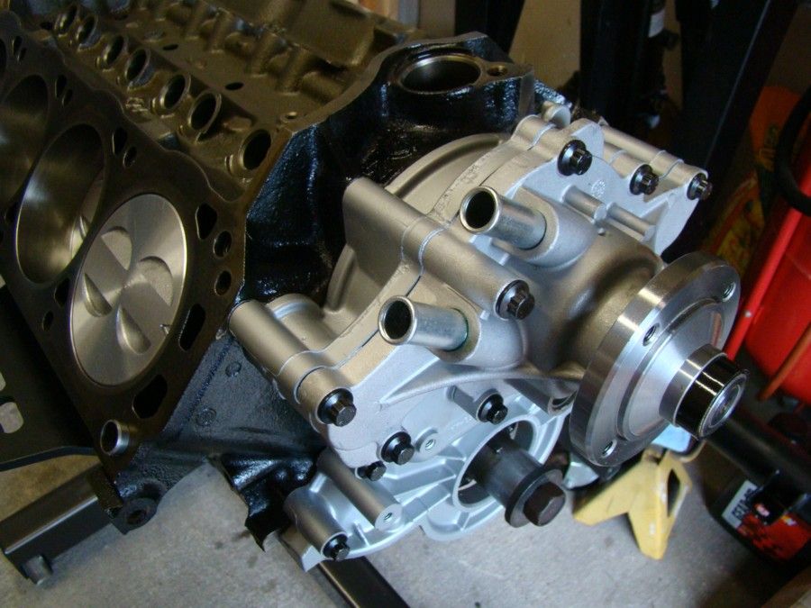

I test fit the timing cover and water pump to make sure the new fasteners were correct and I had everything I needed. Just need to pick up gaskets and a seal.

Ok, you got me curious, what did the water pump bolts cost, and do they have a stud kit for them? As always, lookin great :icon_thumby:
SVT
SVT
With shipping I think it was about $26.00. ARP doesn't have studs but they can be found from other sources. I will probably just paint a stock set black to match so I can attach the wiring in the OE locations.
Allens Fasteners is where I pieced the set together. Let me know if you need the sizes.
