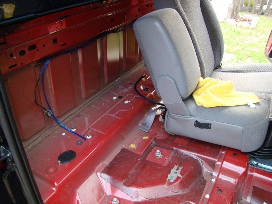

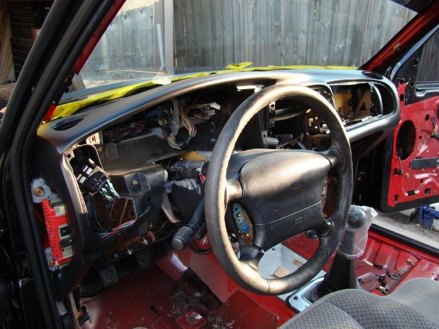

I removed the last few pieces of the interior and started pulling the Stinger audio cable for the rear speakers and the Pioneer Amp that will be going behind the driver seat. I decided to leave the OEM speaker wire in place for now but may, or may not; remove it before the interior goes back in.

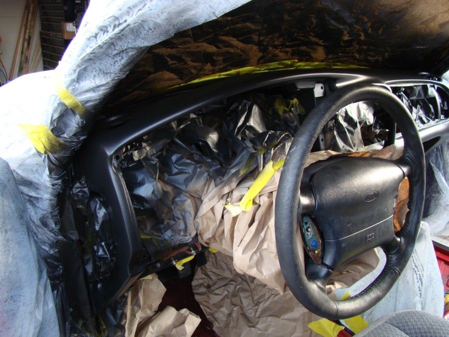

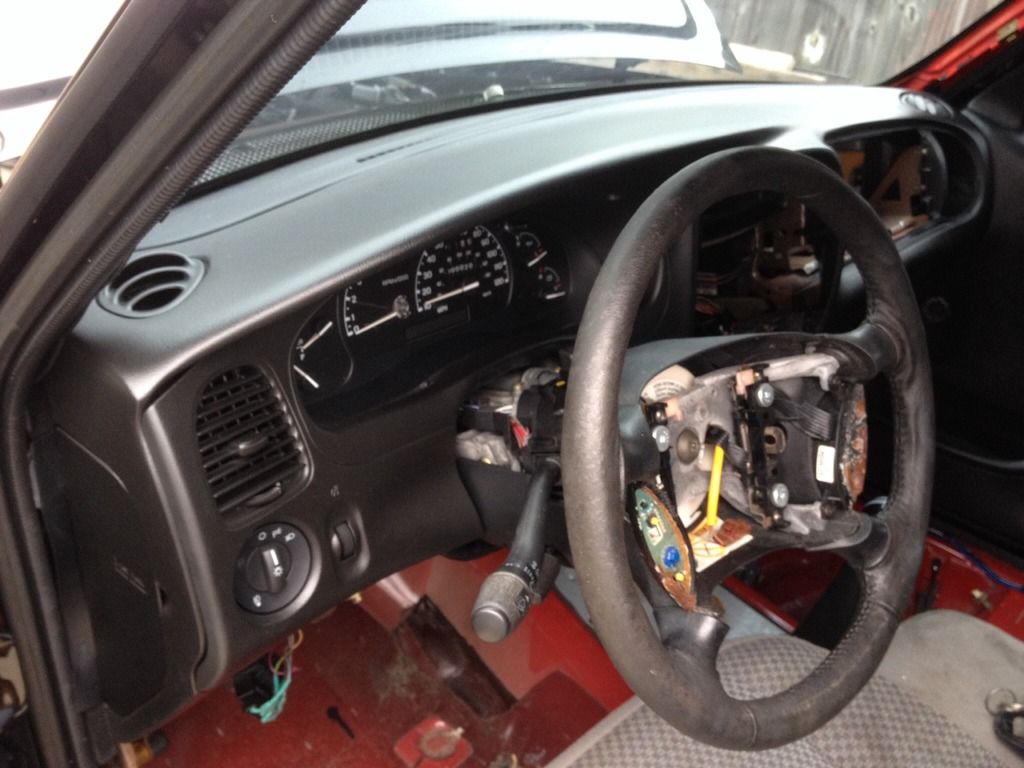

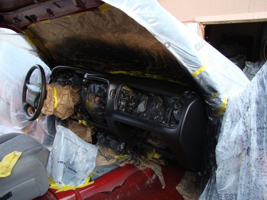

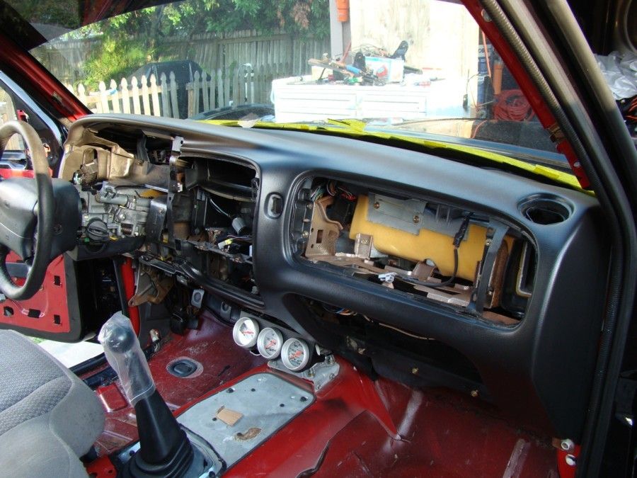

At the last minute I made the final decision to leave the 99 dash in place and spray it with the windshield installed. I considered two other options, removing the windshield and spraying the dash installed, or removing the 99 dash and swapping it with the one from my 98 Ranger.
One more 2wd 98 coil spring 5.0 swap.
First I swept the recessed/reversed areas of the defrost surround and the side vent surround with a sponge coated with SEM Landau Black color as these areas would not be hit well with the paint gun. Then I went ahead and sprayed two medium coats followed by a “light” dust coat on the entire dashboard. The "light" dust coat helped dull the shine and made the finished product look a little more authentic.

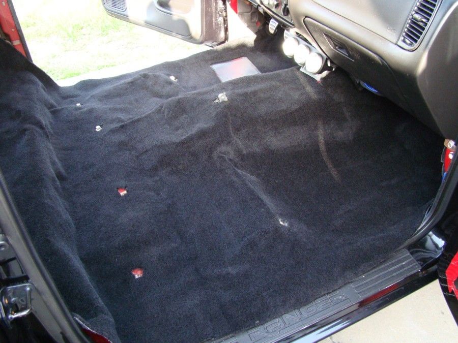

The new carpet has been sitting on the floor “relaxing” to help smooth out some of the wrinkles from the shipping process.

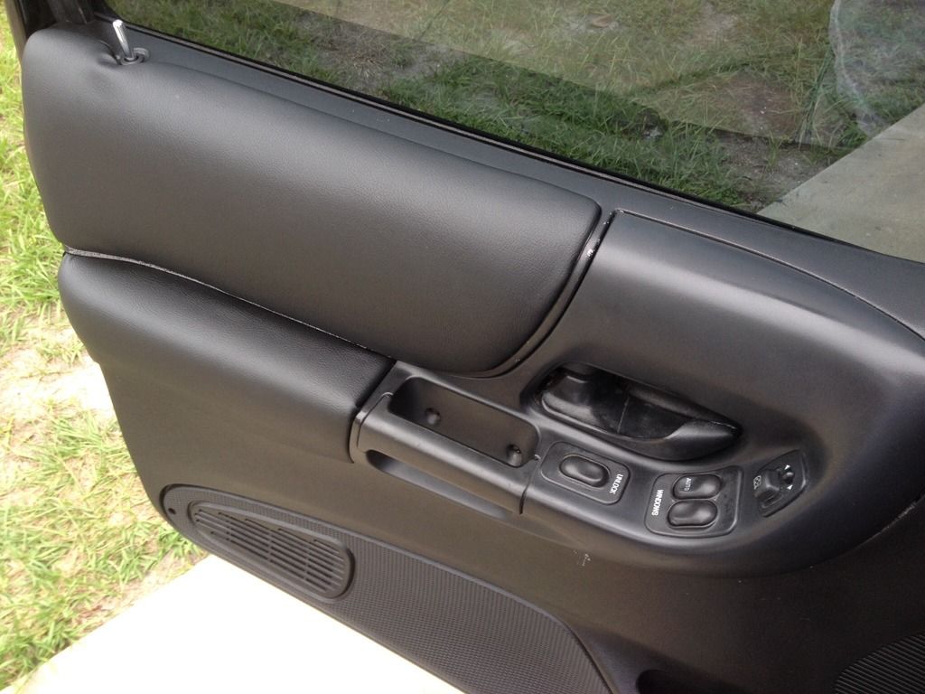

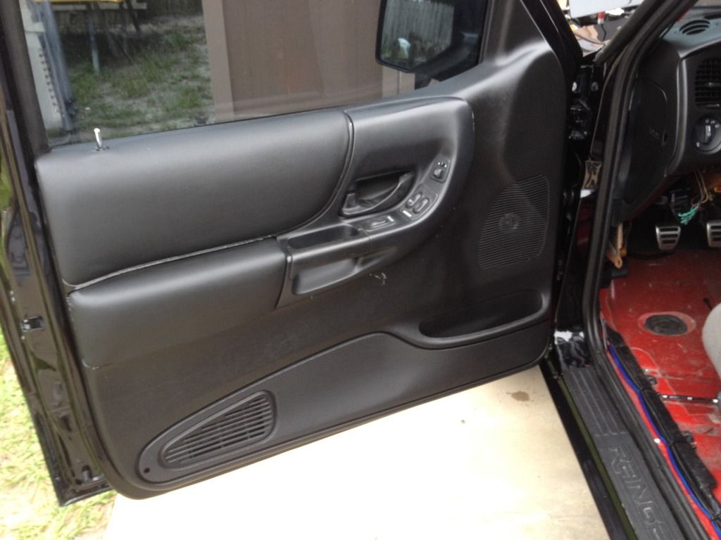

When I shot the dash I also went ahead and wrapped the armrest and top section of the door panel with the same Katzkins Leather that covered the seats. Then I sprayed the door panels to match the dash.

While installing the leather on the arm rest I scratched the door panel in a few places so it will need to be touched up. I am really starting to like the new black interior color. I am getting pretty stoked about moving forward with the rest of the interior work. I just need a little more time away from my job to finish it up. Next week will be balls to the wall on the inside of the truck.

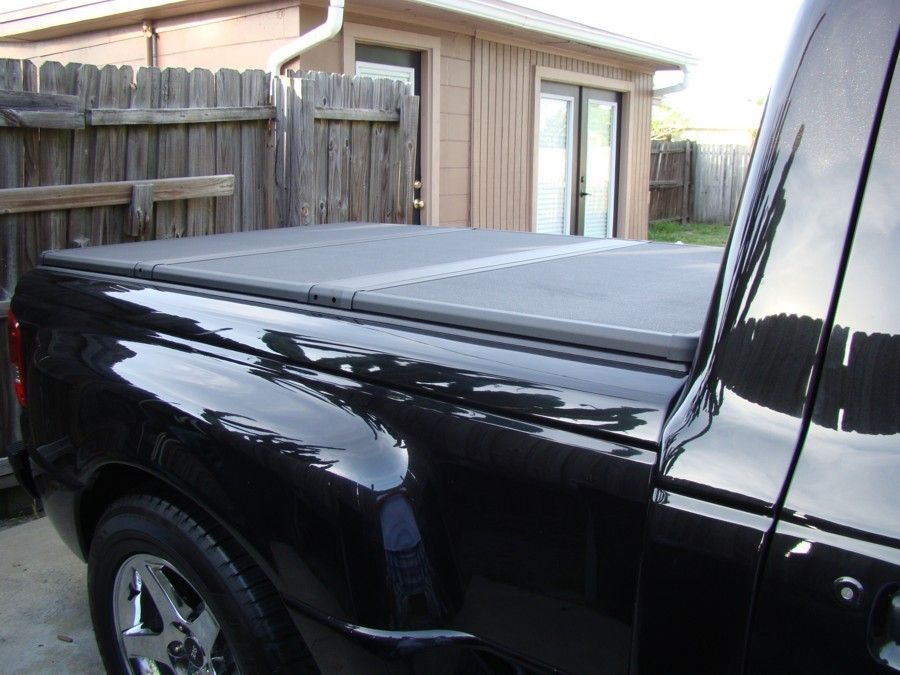

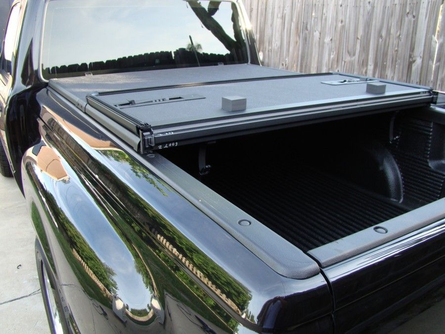

I wanted a flush mount bed cover for the Ranger but the options are limited for the obsolete Flareside bed. I even considered at one point switching to a regular bed just to open the door for more options. I have always liked the Flareside version and just couldn’t bring myself to let it go. After searching high and low I found basically the only option was the Extang Solid Fold Hard Cover. It isn’t flush mount but it will serve the purpose for work and can be removed very easily if needed.
It unlatches easily and folds pretty nice. After a few days it is starting to grow on me and I don’t mind the raised edge as much as I did at first.

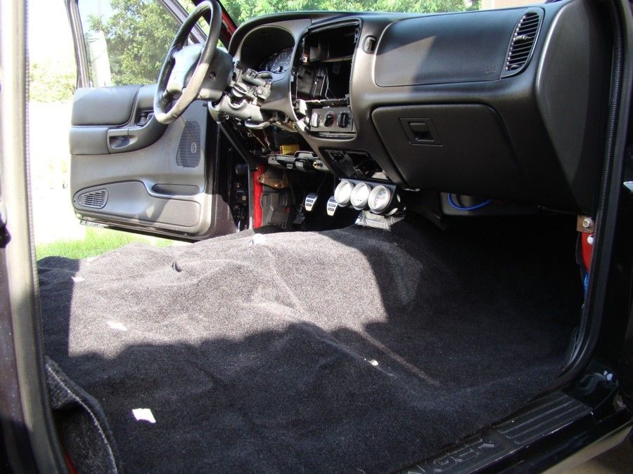

I set the carpet out in the sun for 90 minutes so it would relax a bit before I started forming it to the floor pan of the Ranger. Once it had warmed up I set it in place and started cutting holes for the shifter and the seats.

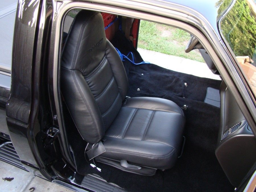

I decided to wait to cut the front, back, and sides of the carpet until the seats and shifter are installed. I wanted to have a little wiggle room to work with if the carpet gets pulled one way or the other while attaching various pieces.
I am still assembling the driver seat but let's see how the passenger seat looks in the truck.

With a little luck I will finish putting the driver seat together tomorrow and get both of the seats in place permanently.

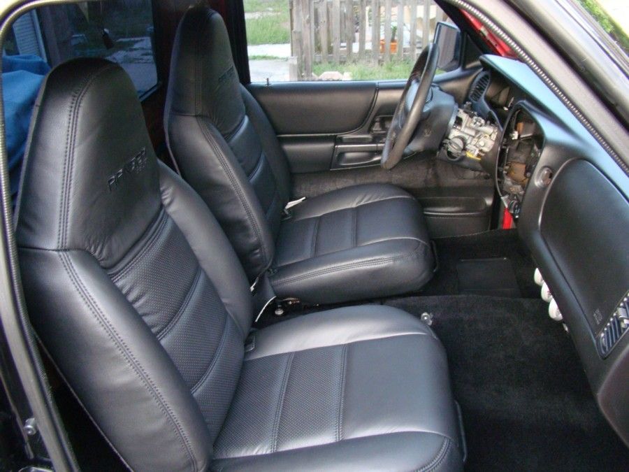

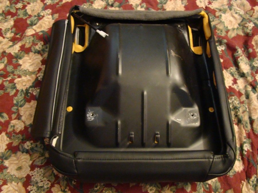

I pulled the passenger seat out of the 98 Ranger, which is not only the daily driver but has also become the daily donor for the 99 Ranger. I have swiped more parts from it lately then the salvage yard. Every time I need a fastener, a light, a switch, etc, it comes from the 98 Ranger. That thing is starting to feel like Swiss cheese!
Ok back to the story, once the seat was removed I quickly pulled the bottom seat pan and the seat foam.

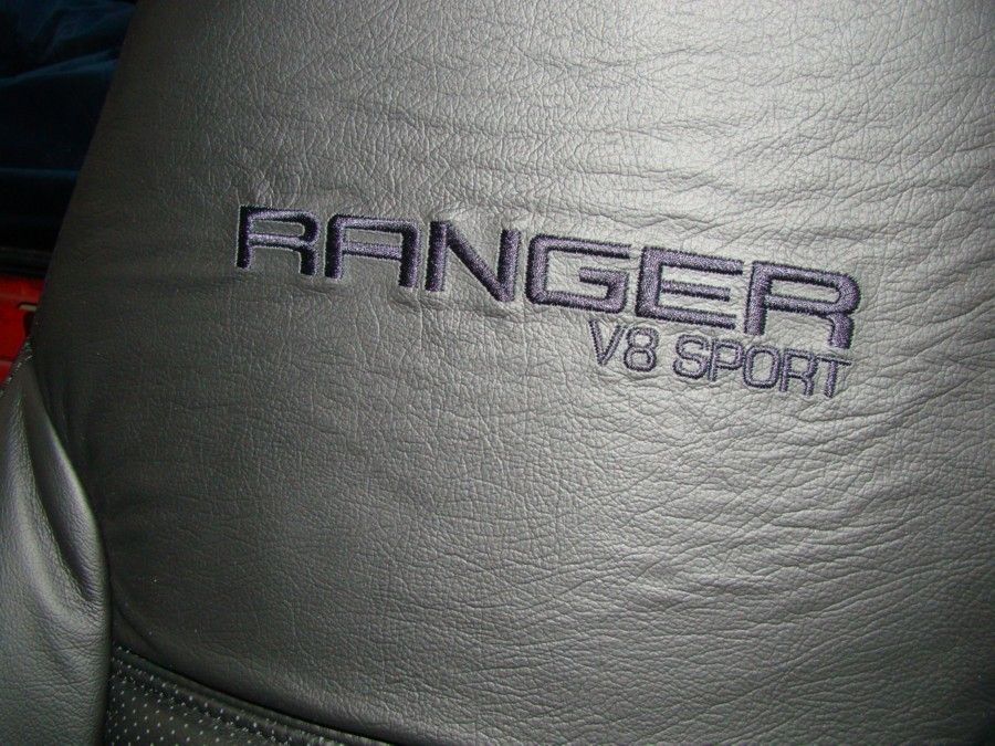

Then I stretched the new Katzkin Leather over the seat pan and seat foam and secured it in place.
Once the leather was in place I went ahead and attached the driver side seat frame from the 99 Ranger.

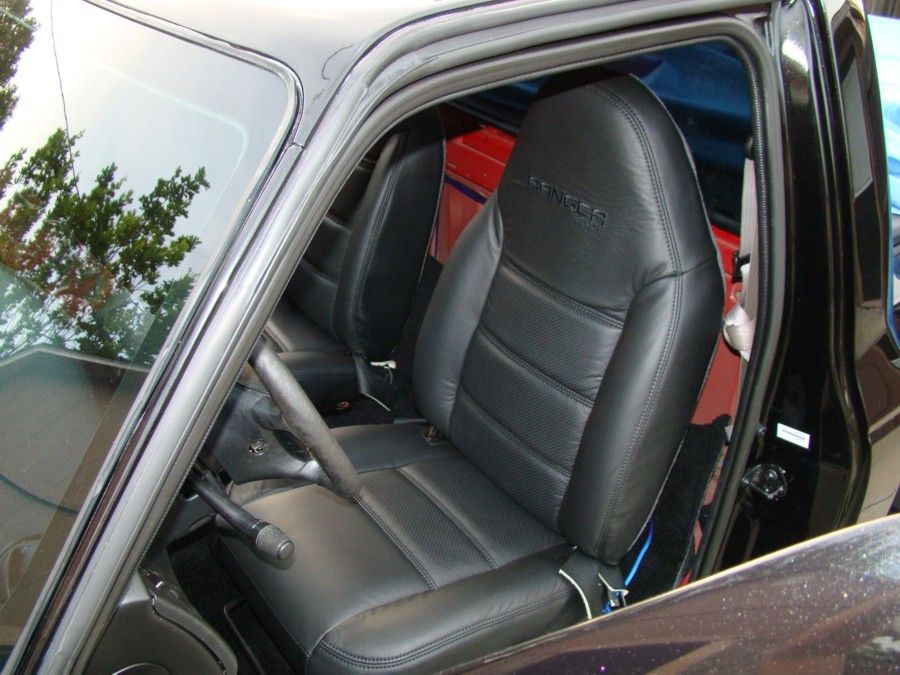

After the seat frame was attached I assembled the rest of the new driver seat using the 99 Ranger driver side upper frame and foam. Once comfortable with the fit I installed it in the vehicle.

These last two photos were taken today after I installed the new 2004 Lightning Steering Wheel. I had planned to do that last but I wanted to check the cruise control on the next test drive.
