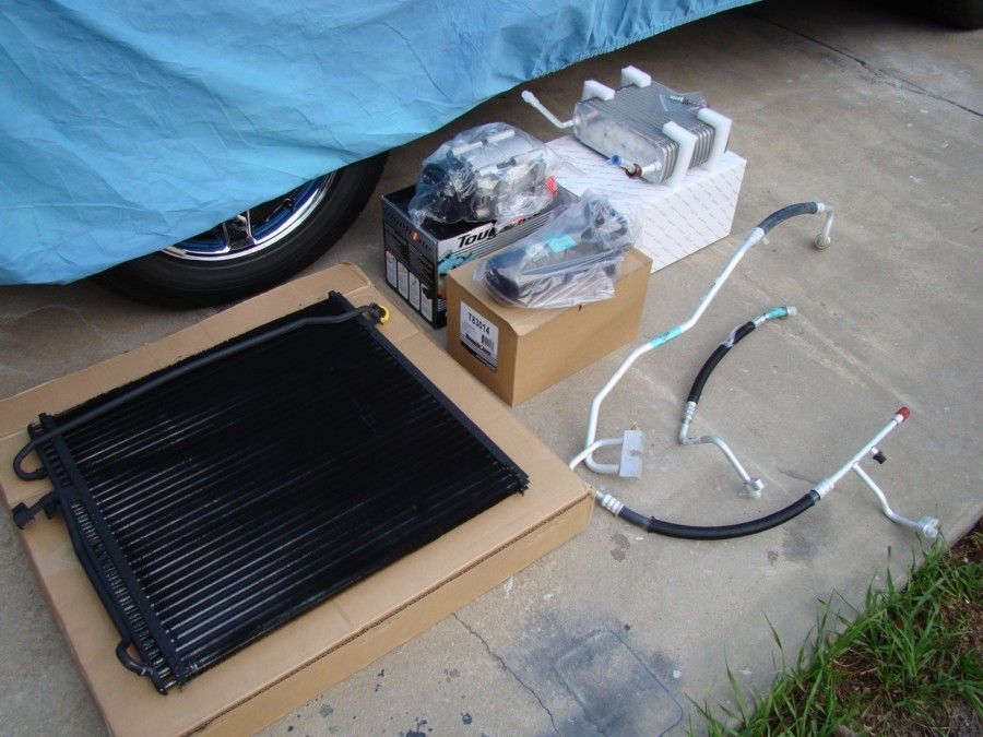

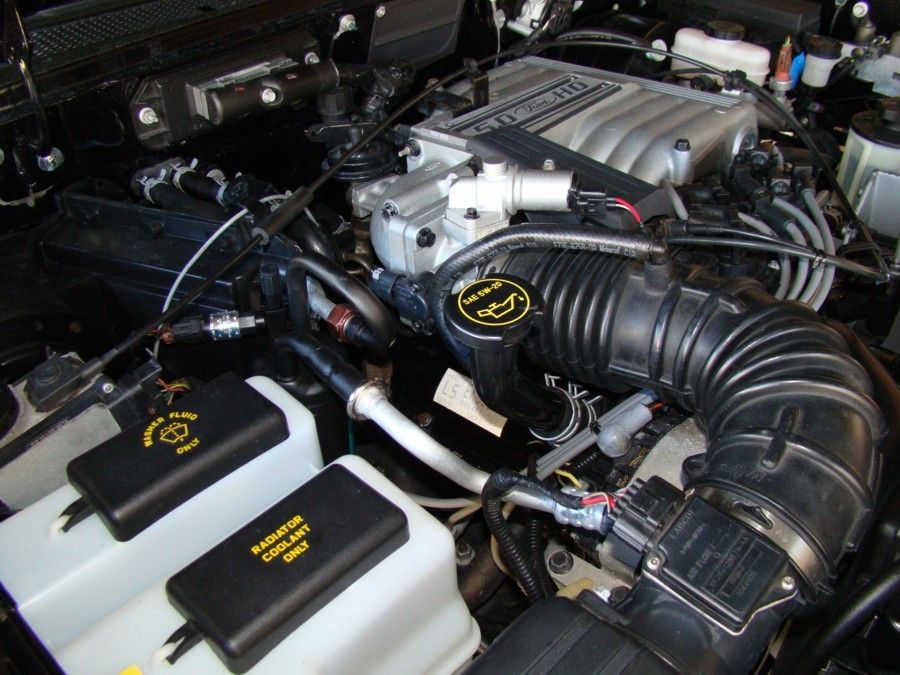

I don’t have much to report this week or many new photos to add. I did purchase the new AC related items and did get them installed on the Ranger. I spent several days sorting out a few glitches on that system but finally did get the AC evacuated and charged with new refrigerant.

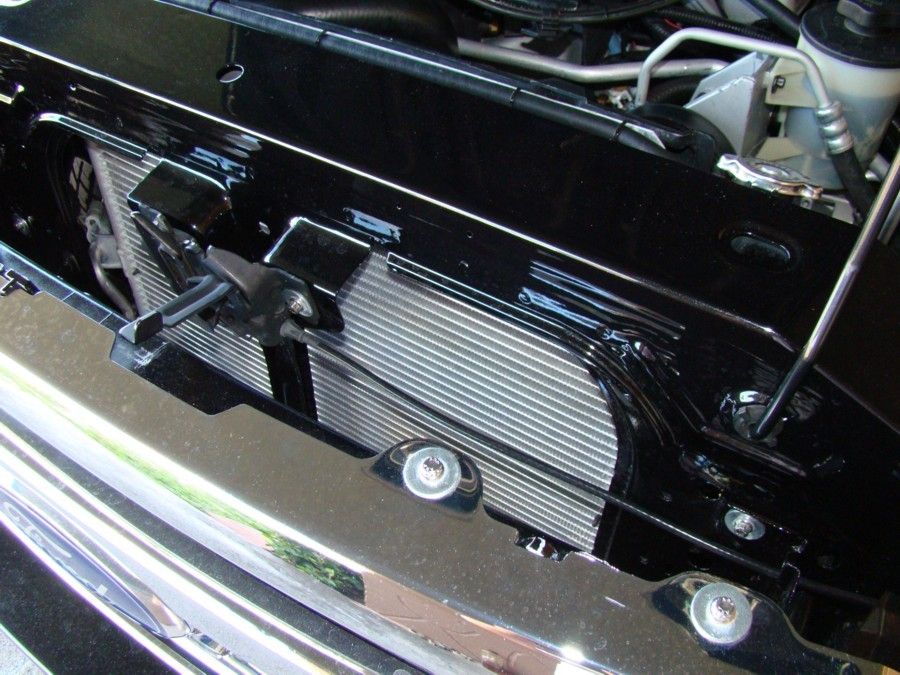

After I installed the Ranger condenser pictured above with the Explorer 5.0 hoses, Evaporator, Compressor, and Accumulator I found that the connections were slightly different on the Ranger condenser although they looked identical to the Explorer piece. A quick trip to Advance Auto Parts and the correct piece was secured.

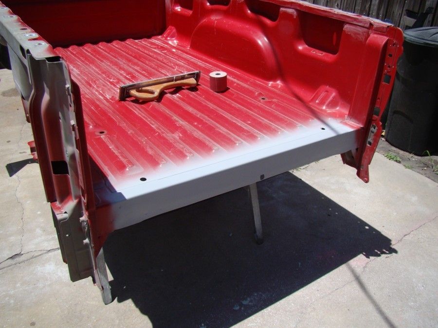

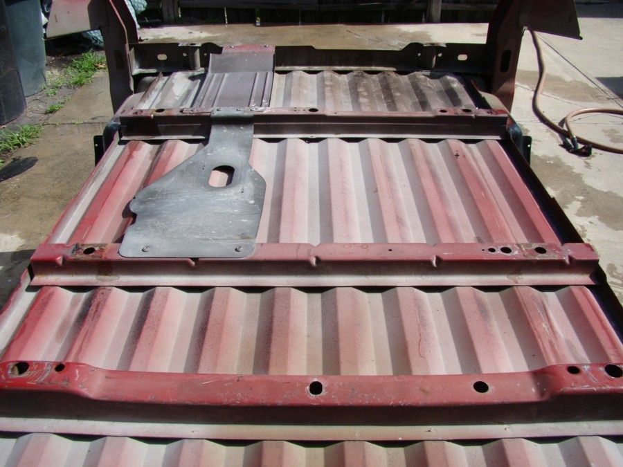

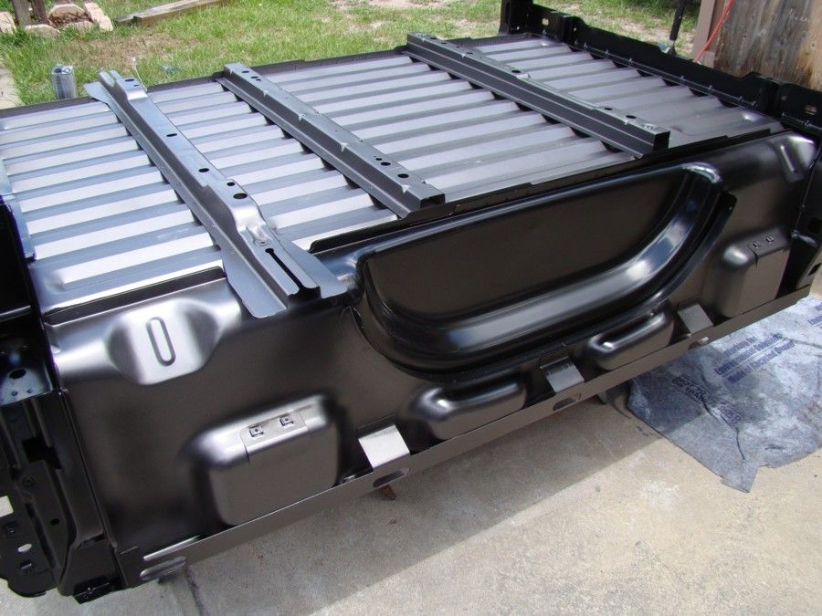

I got an early start this morning taking advantage of my two days off from work. I removed the bed from the truck and set it up on saw horses to begin the paint work. The first step was positioning it right side up so the top surfaces could be washed with soap and water. Once that step was complete the top surfaces were wet sanded with 400 grit paper and then followed by a scotchbrite pad.

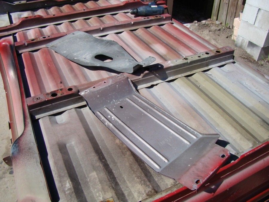

I flipped the bed over on the saw horses and proceeded with drilling out the rivets on the two heat shields that will be removed.
After that task was complete I washed the underside of the bed with soap and water and followed up with wet sanding with 400 grit paper and chasing the panel with a scotchbrite pad. The scotchbrite pad helps hit all of the hard to reach places much better than standard sand paper.

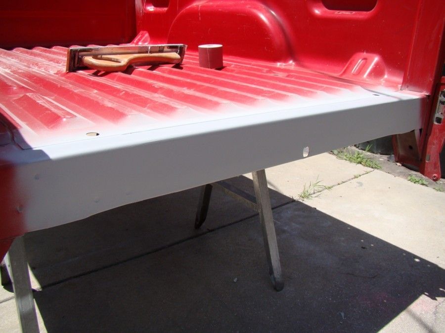

The bottom edge of the tailgate jamb had a little bit of damage and needed to be slightly straightened. Part of this damage was related to years of wear and tear from “truck use” and some of it was created by myself when I removed the spare tire lock assembly. At the time I didn’t have a key for the lock and it needed to be removed at the last minute when the truck went out for exhaust work.

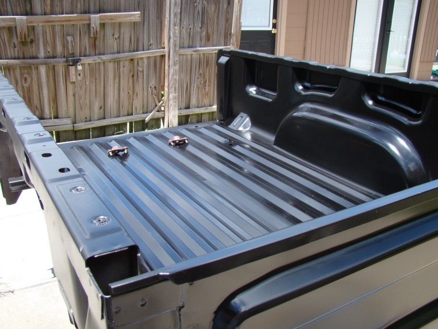

Once the tailgate jamb area was straight I flipped the bed over and sprayed the entire bottom of the bed with Dark Shadow Grey basecoat I had left over from my 03 Cobra. This is the same color I used on the underside of the Ranger cab a couple years ago. I also sprayed the sides with the same DSG color before trimming the wheel wells and the corners of the box with Tuxedo Black Metallic basecoat.
The bed was turned over once again, right side up, and the inside of the box and corners were sprayed with Tuxedo Black Metallic basecoat.
Tomorrow I will final sand the tailgate jamb section and lay down two fresh coats of Tuxedo Black Metallic basecoat before top coating that area with two coats of clear. The remainder of the bed will be left in basecoat as it is all covered by quarter panels and a bed liner.
Another early morning, up about 6:00am and outside around 7:00am getting ready to finish up the Ranger flareside bed. I wet sanded the repaired area with 400 grit paper and feathered the blended edge out on to yesterdays fresh paint. Because the bed was painted yesterday, less than 24 hours ago, it is not necessary to scuff the fresh paint with 400 grit paper. The paint sprayed today can go right over the top with little preparation.
I mixed up some Tuxedo Black Metallic basecoat and shot the tailgate jamb, covering the repaired section. Once the two coats of color were down I followed up with two coats of Shopline 630 Urethane Clear.

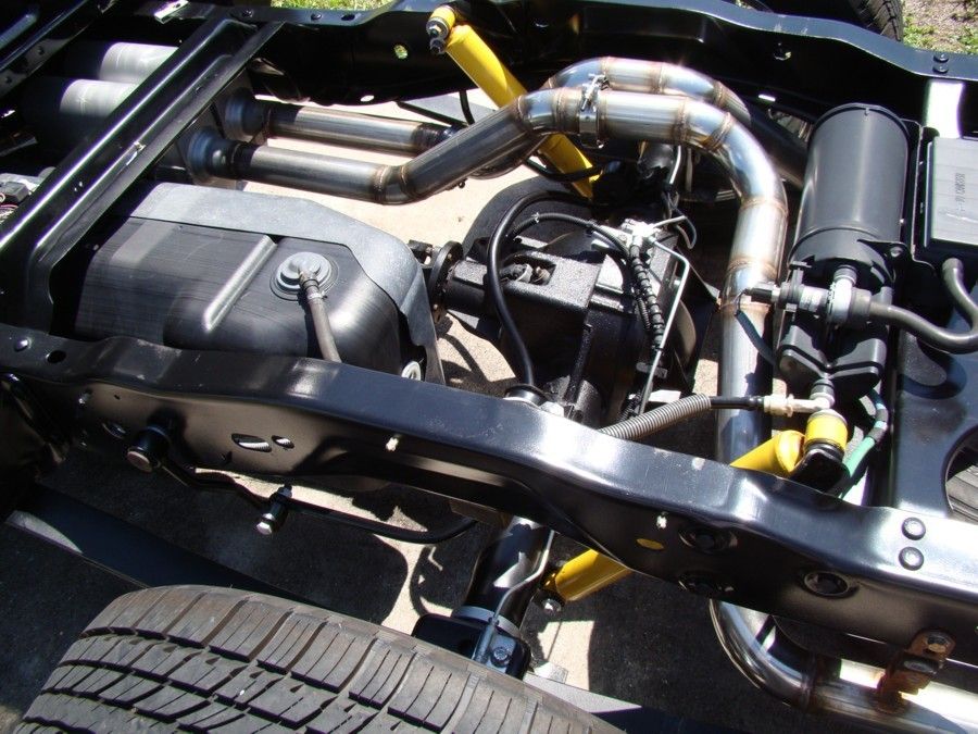

While the fresh paint was drying in the hot Florida sunshine I washed the rear half of the Ranger preparing it to accept the bed for the last time. I also finished a few tasks that could be easier accomplished while the bed is removed. I attempted to chase down a non-functioning fuel gauge issue but was unsuccessful; the wiring appears to be intact and complete. It will probably turn out to be a float problem inside the tank. I also pulled the rear harness through the frame and completed the connections for the tail lights and tag lights. Finally I hung the full size 17 inch spare tire in the stock location.
This is the first chance I have had to look at the exhaust system closely from the top. I thought I better grab a few photos as it will probably be covered for a long time. That is unless I have to get back into the fuel tank to fix that damn gauge down the road. I am still hoping it turns out to be a ground splice that is still unplugged somewhere along the harness.

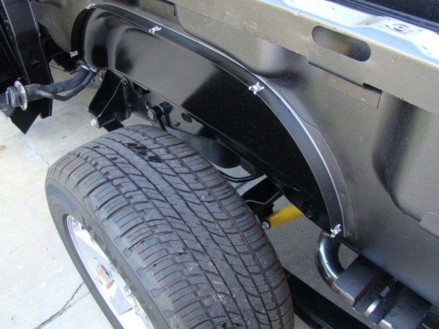

I spent every night this week working on the truck, sorting out a few issues here and there and moving forward with installing the bed. Once all of the wiring was pulled and set aside, I carefully moved the bed into its final resting position.
I wish I could say I replaced all of the quarter panel clips with new pieces but the fact is I simply dusted them with a little aluminum spray paint and left it at that.
The same trick worked just as well on the bed/frame bolts. Even though they will be covered by the bed liner I couldn’t help touching them up a bit.

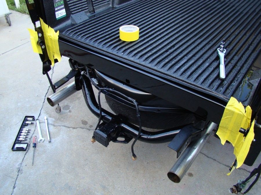

Once all the initial work was complete I went ahead and set the bed liner in place and taped up the jamb so the tailgate hinges could be installed.

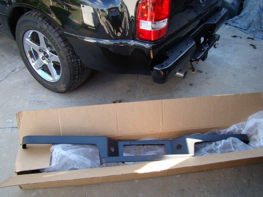

I installed the inner fender liners, quarter panels, tailgate, tail lights, and rear bumper before digging out the new rear bumper step pad I had purchased a while back.

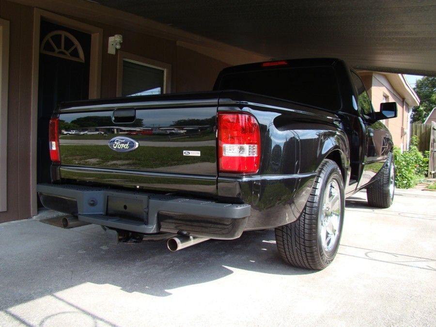

Finally the rear of the truck is complete. The only thing missing now is that new Florida License Plate!
