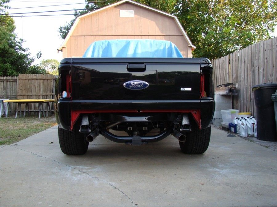

After work today I touched up the color sanding process on the tailgate with a few light passes with 2000 grit wet. Then went ahead and buffed it out with Norton Liquid Ice. Once that was finished I installed it on the truck where hopefully it will be safe and sound.

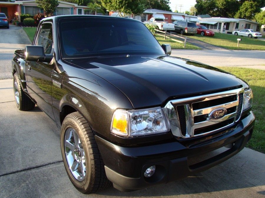

I couldn’t pass up the chance to include a few close up shots of the late afternoon reflection.

I also attached the hardware and aligned the hinges using the divots I drilled a few weeks ago as a guide.

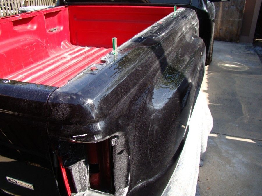

Monday night I finished polishing the two rear quarter panels with the Norton Liquid Ice pads. First the Blue foam pad and then finally the white foam pad, I had done the initial work with the white wool pad a few days ago. I did most of the polishing with the pieces off the vehicle and set up on saw horses but did complete the final step with the panels mounted. Polishing them off the vehicle allows for more access to recessed areas but also increases the risk of throwing the work if the wheel catches hard on an edge.
After setting the panels in place I inserted the alignment pins and then tightened the fasteners. Then I went ahead and cleaned up the panels with some warm water to check the progress.

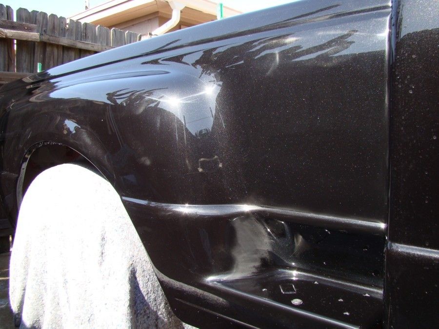

I finished the side step portion of the panel with a 3 inch polishing wheel and the three smaller Norton Liquid Ice pads as the full size wheel would only reach so far.

The last step of the day was a quick wash with the hose, a soft cloth, and a dry towel.

Now the focus will turn to removing the bed for the last time so the underside can be painted along with the top sections. I wanted to do this last so the bed could be used as a temporary jig for holding the quarter panels during the sanding and polishing work on those pieces.

I thought about going with a Flex Fuel tag or a Eco Boost tag but decided on the Ford Racing Performance Parts one instead. If you look closely at the tailgate photos you can make it out. I think it fits well since 90% of the parts I used can be sourced directly from Ford Racing.

I plan on using the stock rear bumper but painted to match the body color. It has been painted and color sanded but I still need to buff if. I just don't need it for another week or so while the bed is being removed/painted/installed.

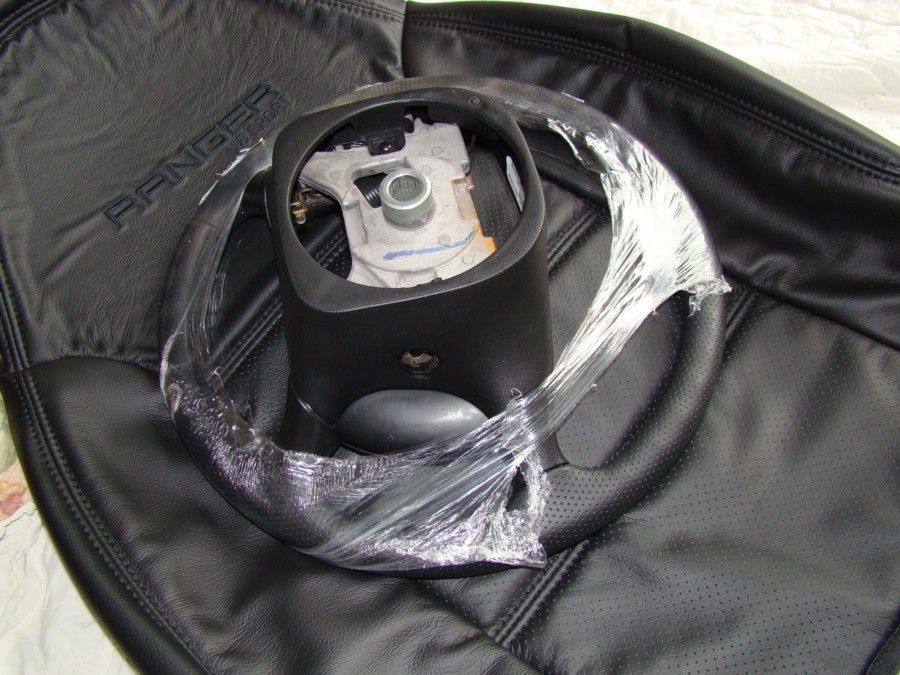

I was working today on my way back from Oxford Florida when my vender called to inform me that the Katzkin Leather Kit had arrived for the Ranger. At first I wasn’t sure I had time to stop by and pick it up but realized with the holiday it would be several days before I could get it in my hot hands. A quick adjustment to the GPS and I was in route headed towards Lutz to collect the new interior pieces. Once home I quickly opened the box to inspect the contents.

There was some question initially if the custom embroidery could be duplicated as requested. To be honest I was worried it might not match the fender emblems as closely as I would like. I was pleased the company got it correct and it was exactly how I requested right down to the exact measurement, stitch pattern, and font.

I set the new 2004 Lightning steering wheel against the Katzkin leather to compare the color and texture of the two pieces. I was surprised how close the two pieces were. Up to this point I had only compared pictures of the two, I had not requested samples of the leather.
