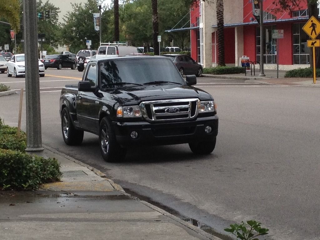

I left the house with 26 miles on the odometer and drove it another 223 miles, I now have 249 miles racked up. I averaged 17.6 MPG up and down US19 from St. Pete Beach to Homosassa and back with the AC running the entire time. I think the engine should loosen up as the odometer creeps up into the 2000-5000 mile range. I feel pretty confident that with a little more tuning and drive time I should be close to 20-22 MPG. Here is a photo of the truck at the end of a very rain filled work day in down town St Pete at the very last stop.

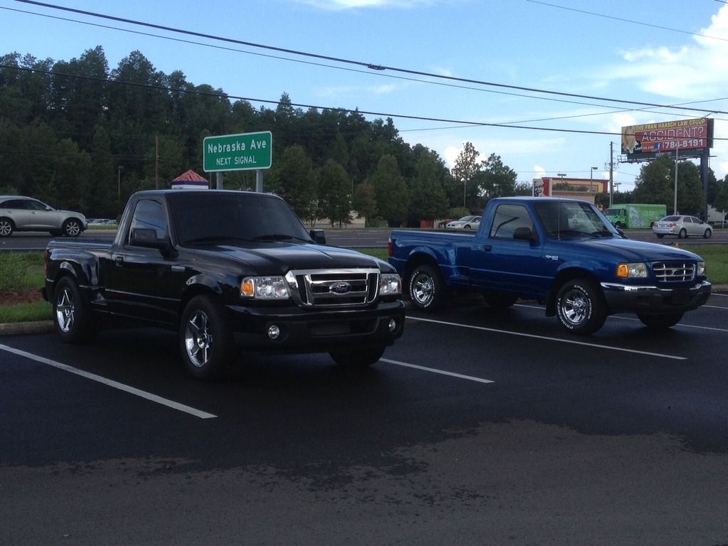

Almost every week day while working for the past three years I have driven by this Ranger in Palm Harbor. I always look at it and appreciate the hard work the owner puts forth keeping it clean. It is always there, never dirty, backed into the same spot day after day, week after week. I have told myself for several years, "some day when mine is done I am going to park next to it and snap a photo."
