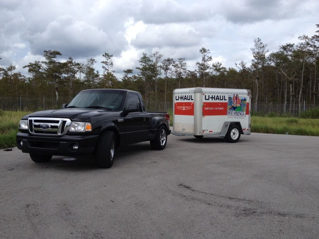

Snake Road, halfway through the Glades and time to stretch the legs. At this point I am starting to think my wife was right.

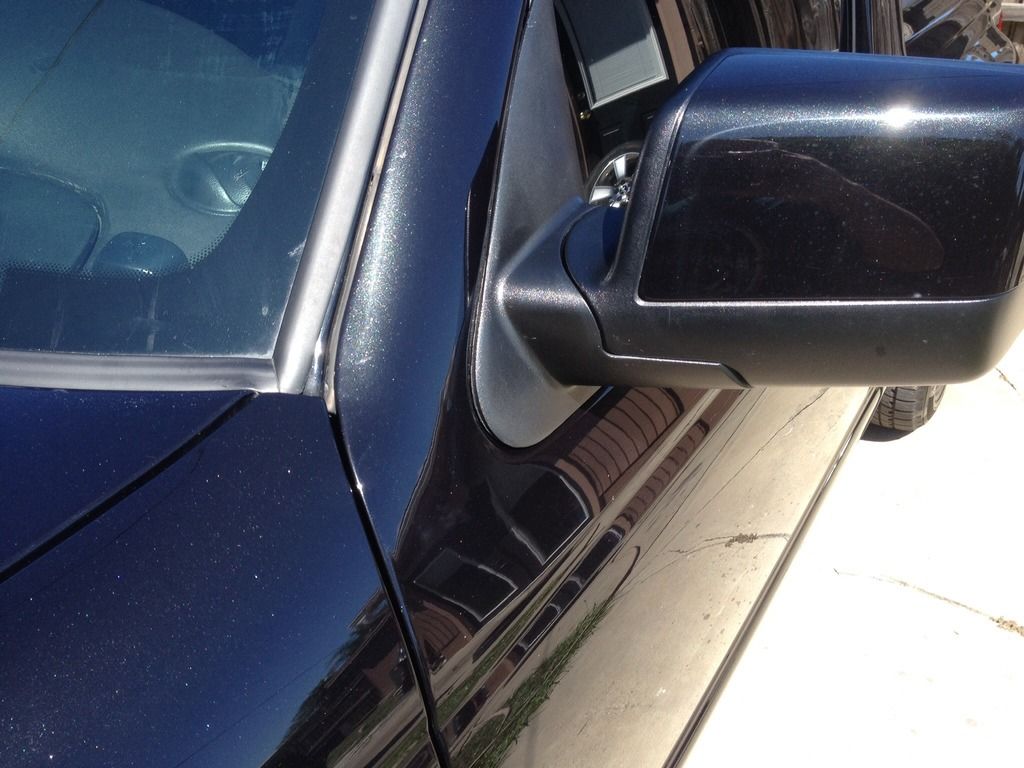

I had the new windshield installed a week or so ago and then went ahead and painted the mirror inserts and small roof trim pieces. You know how it goes, never really done, always a few things still on the list.
