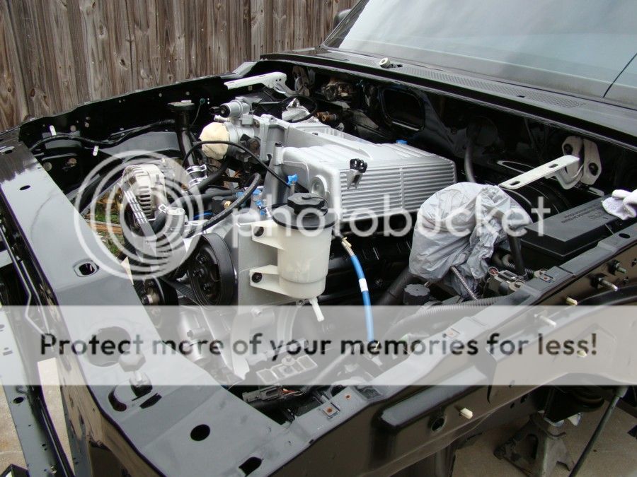

I dunno about your hood or firewall clearance, but the fit between the oil pan and steering rack looks a bit tight, even with the washers.
Kinda like a $10 bill will just slide in there, but a $20 won't fit.
Yes, still a little closer than I would like. I ended up with about 3/8 of an inch give or take. I am going see what I have once the transmission is tied in and the engine is sitting in its permanent position. If it needs a little more attention I will make final adjustments then.

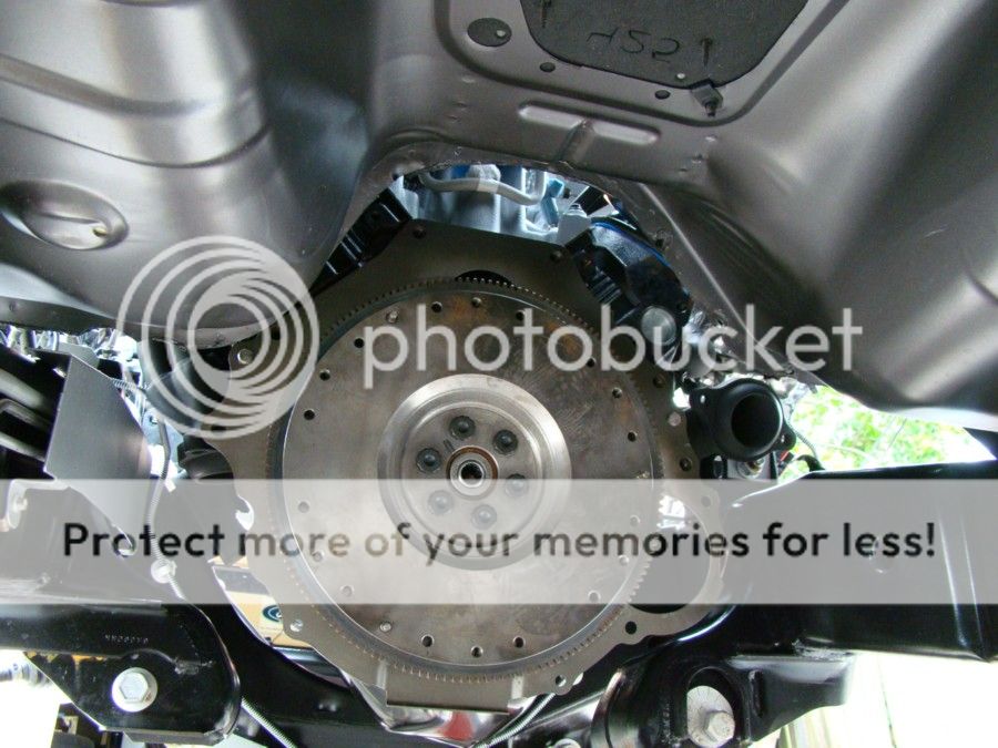

I ended up taking yesterday off from working on the Ranger. I figured since I spent so much time on it over the weekend I deserved some R&R. But today I was right back at it. I tucked a few shop rags between the engine and the firewall and then tilted it back as far as I could while it was tied into the motor mounts. That gave me plenty of clearance when working below. Then I moved under the truck and installed the pilot bearing, bell housing spacer, and flywheel.

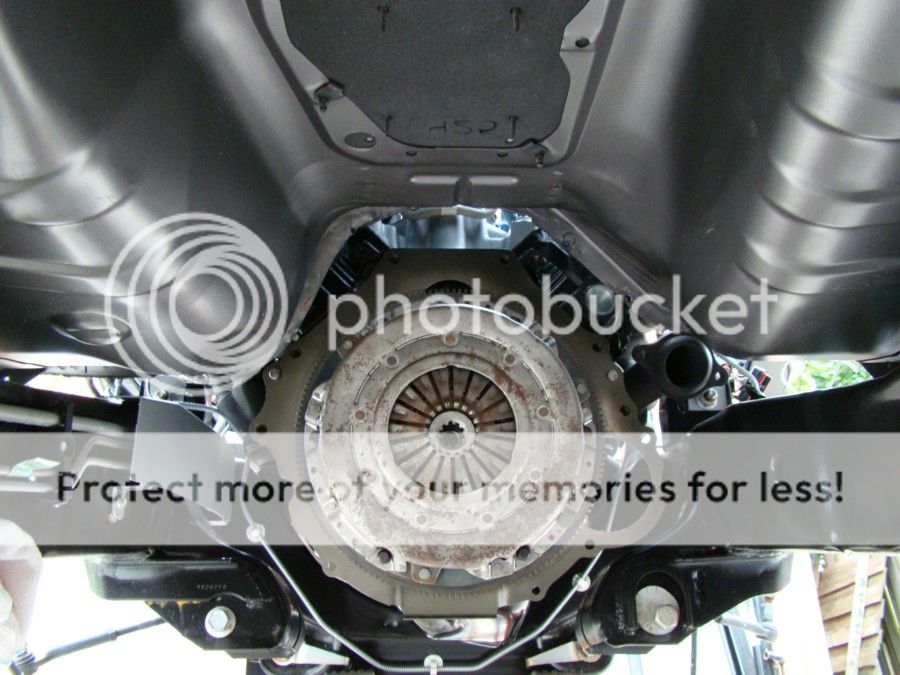

Once the flywheel was torqued down to 82 ft/lbs I moved forward with the clutch disc and pressure plate. After centering the clutch disc with an alignment tool I torqued the pressure plate to 22 ft/lbs and then removed the alignment tool.

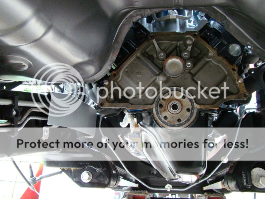

Then I positioned the bell housing and snugged up the ARP fasteners for a test fit.

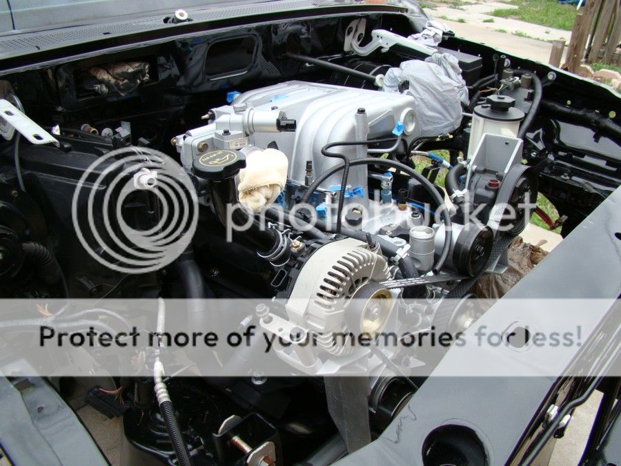

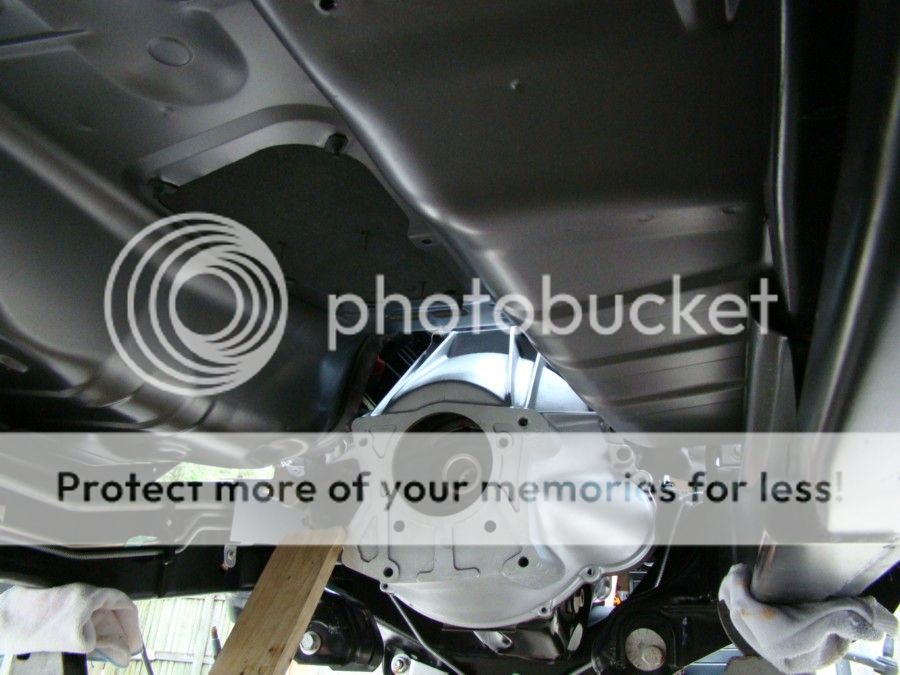

After sliding a piece of wood into place under the bell housing to help support the engine assembly at the desired angel I moved back up top to check my clearance on all four sides.
One more 2wd 98 coil spring 5.0 swap.
Everything looks good so far and the engine should be very close to its final resting spot. I hope to cut the hole for the shifter tomorrow and tighten down the bell housing bolts then slide the transmission and cross member into place. Once this has been completed I should be able to dial in the exact position for the engine/transmission and lock everything into place.

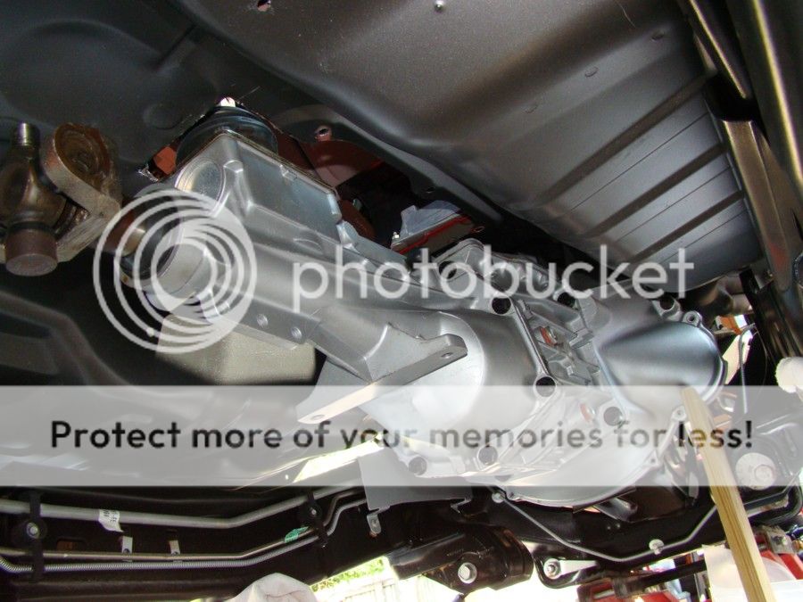

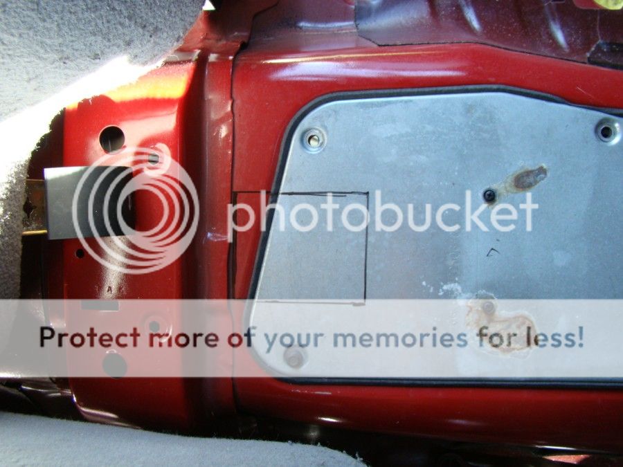

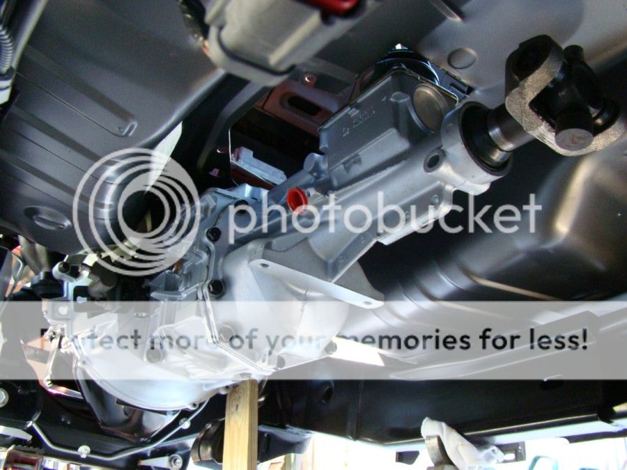

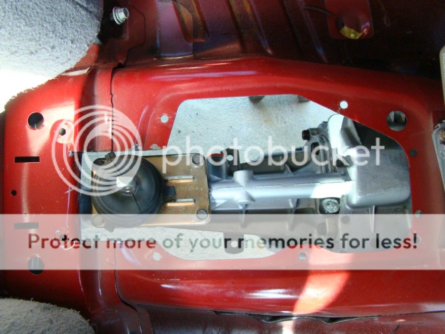

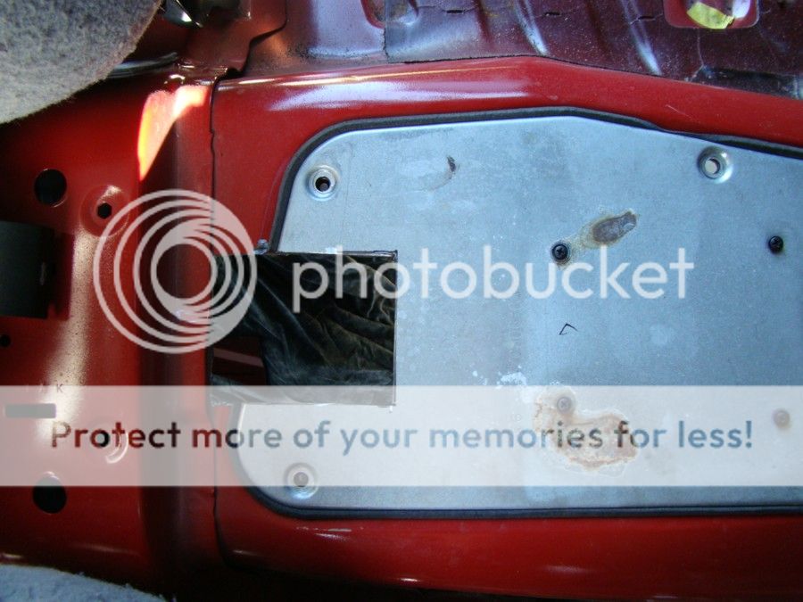

The hole for the shifter was outlined and then cut with a grinder after careful measurements were collected. Then the transmission was raised into place and torqued to spec.

Now focus turns to adapting the cross member, transmission mount, and transmission plate to fit the new application. Everything lined up very close so the process should be fairly straight forward. I am pretty sure minor modification to the custom plate will be all that is required for a perfect fit.
