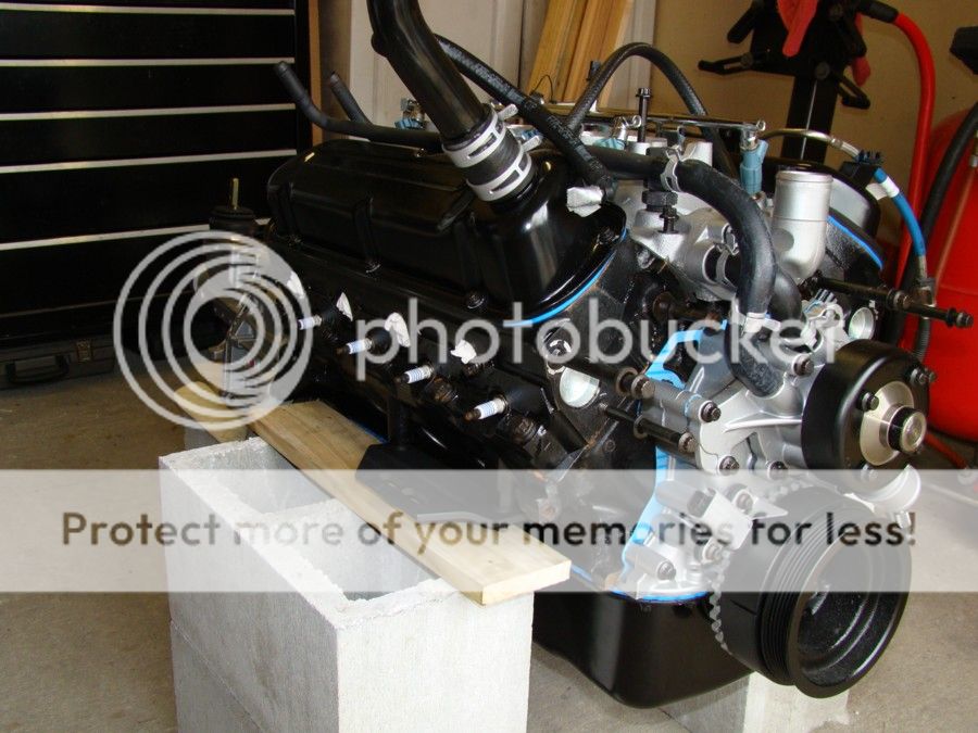

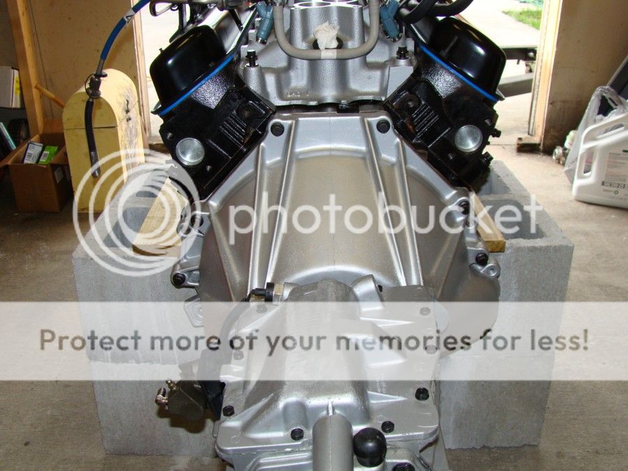

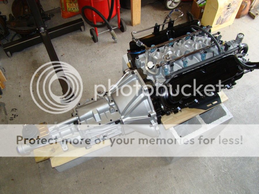

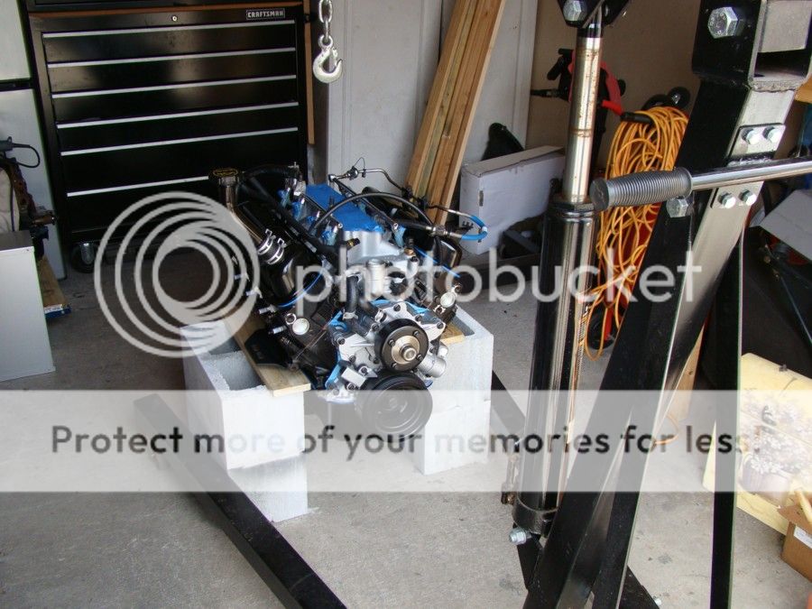

The first of the month is rolling around quickly and I really wanted to get the engine installed during the first part of June. I have been knocking down the items on my task list and feel pretty comfortable with the progress. Although most of the line items consisted of small boring steps I thought I would post a few photos of the engine/transmission setup prior to the installation. This is really just an attempt to try and keep the thread alive during a slow time.

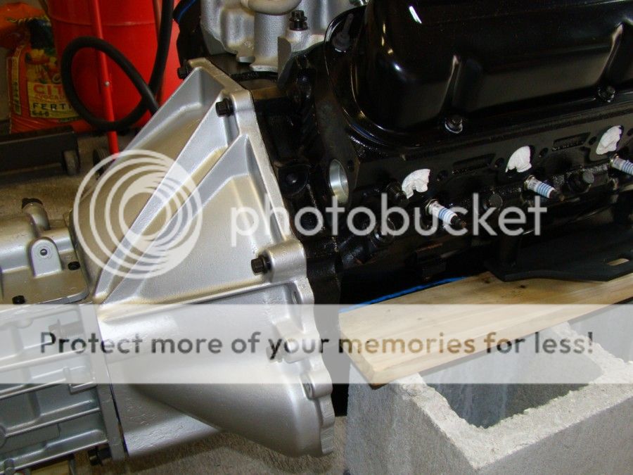

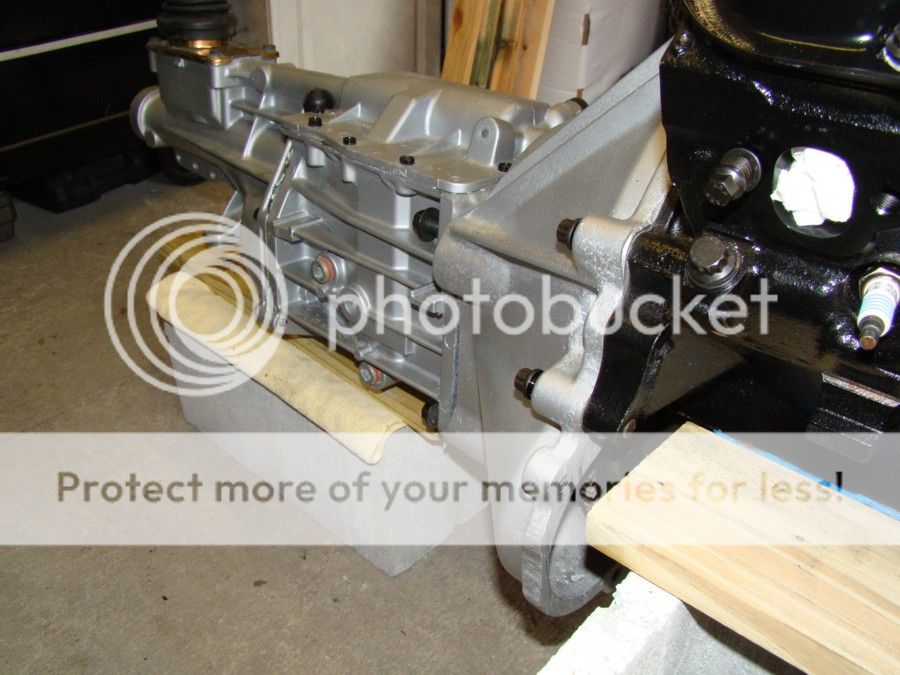

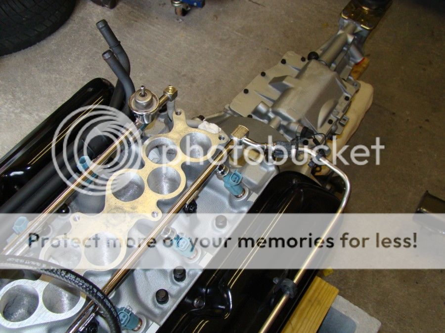

I set the engine up on blocks and then mocked up the flywheel, clutch assembly, bell housing, hydraulic clutch slave cylinder, and transmission. I thought I had collected all the fasteners but did find a couple that had either been overlooked or measured incorrectly. Those were quickly ordered and temporarily placed in their correct location.

The new Tremec World Class T5 looks good attached to the engine. I am starting to get excited about seeing the assembly in place and up against the new paint of the engine compartment and floor pan.

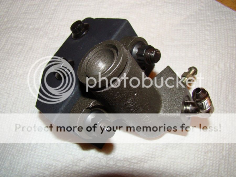

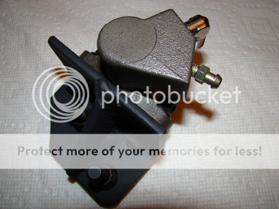

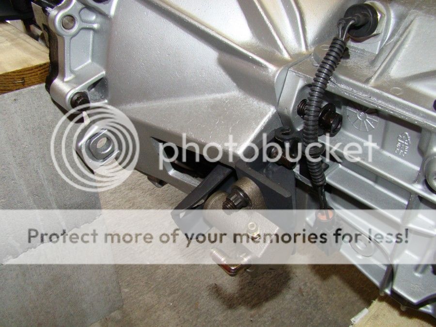

A week or so ago I had a little custom work done to my hydraulic clutch slave cylinder bracket. I thought it would be nice to have the exterior bolts that hold the slave cylinder welded to the bracket so I don’t need to tool both sides when I service the slave cylinder. I also decided to have a gusset welded to the back side of the bracket so it would not flex when the clutch pedal is depressed. This was a problem with the first V8 Ranger I had and contributed to a slight issue with clutch disengagement. During the engine/trans mock up I found that the gusset interfered with the housing as the transmission was brought into alignment. A quick visit from the grinder cured that and the transmission now fits correctly.

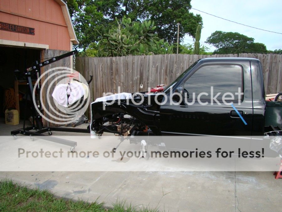

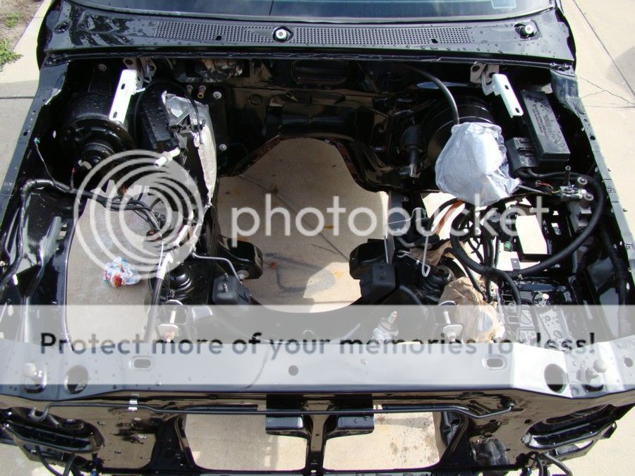

Today started with pulling the front fenders off and setting them aside so they won’t be damaged while installing the engine. Finally after several years of hard work the truck is now ready to receive the 306 cubic inch motor.
One more 2wd 98 coil spring 5.0 swap.
After being mocked up on the engine a few days ago the transmission, bell housing, clutch assembly, and flywheel have all been removed and the engine is ready to be hooked up to the hoist and lowered into place.

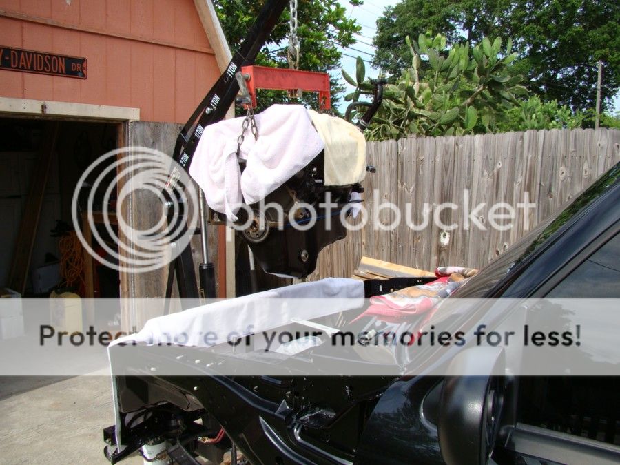

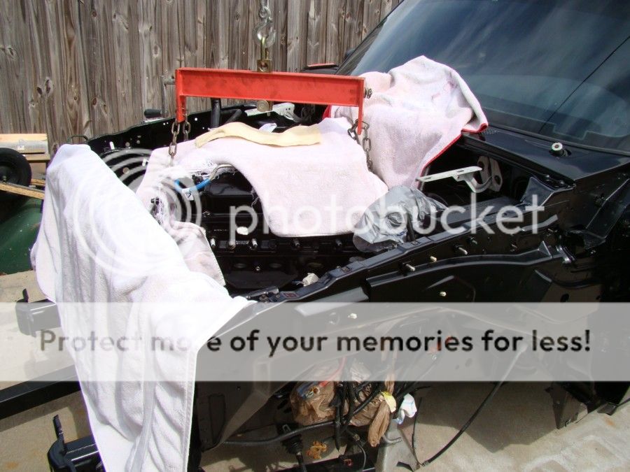

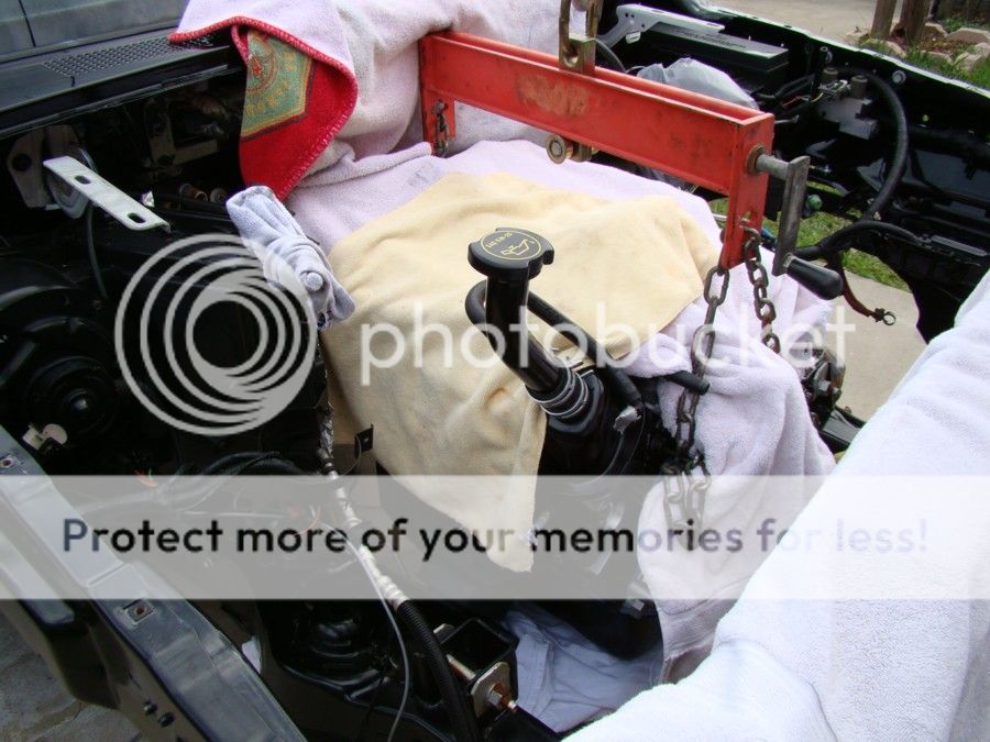

I wrapped the engine up with a few towels as well as the firewall and core support. I am going to do my best not to scratch the new paint as today’s process moves forward.
Ok, here we go!
So far so good, it cleared the core support.

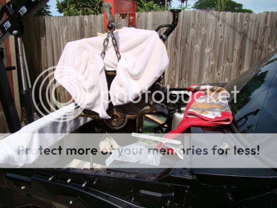

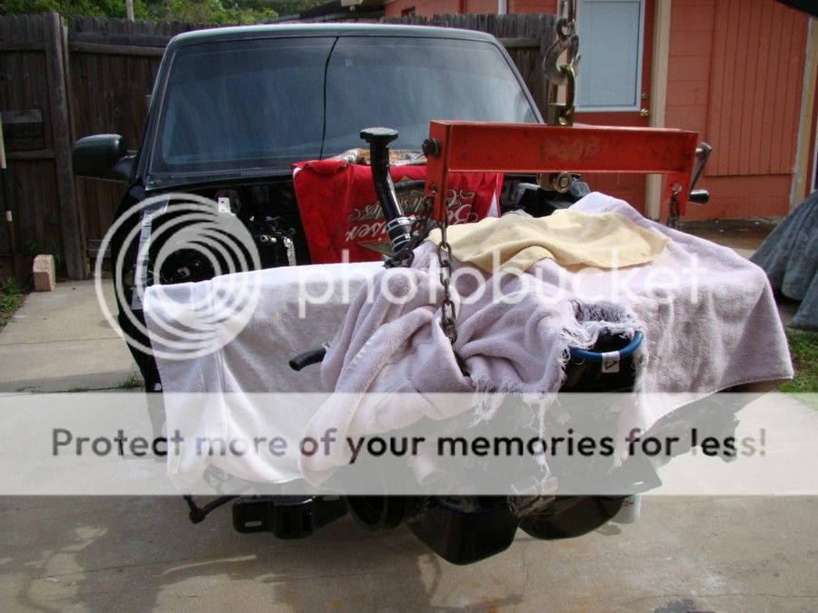

Now I start to lower it into place as it is turned at a 90 degree angle to clear various obstacles.
Once the crankshaft pulley and water pump pulley has cleared the core support the engine will be turned back 90 degrees to the correct position and lowered a little more.
Oops! I have the crank handle above the engine on the hoist attached toward the rear of the engine. That will never clear the cowl panel without being turned around and attached on the front side of the motor.
Hang on while I fix that small issue!

All looks clear, and it slides right into place!

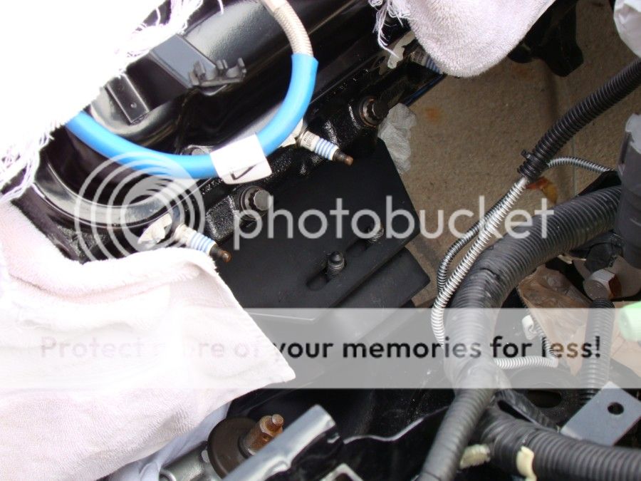

Both engine plates drop on to the motor mount bolts and the assembly is in position.

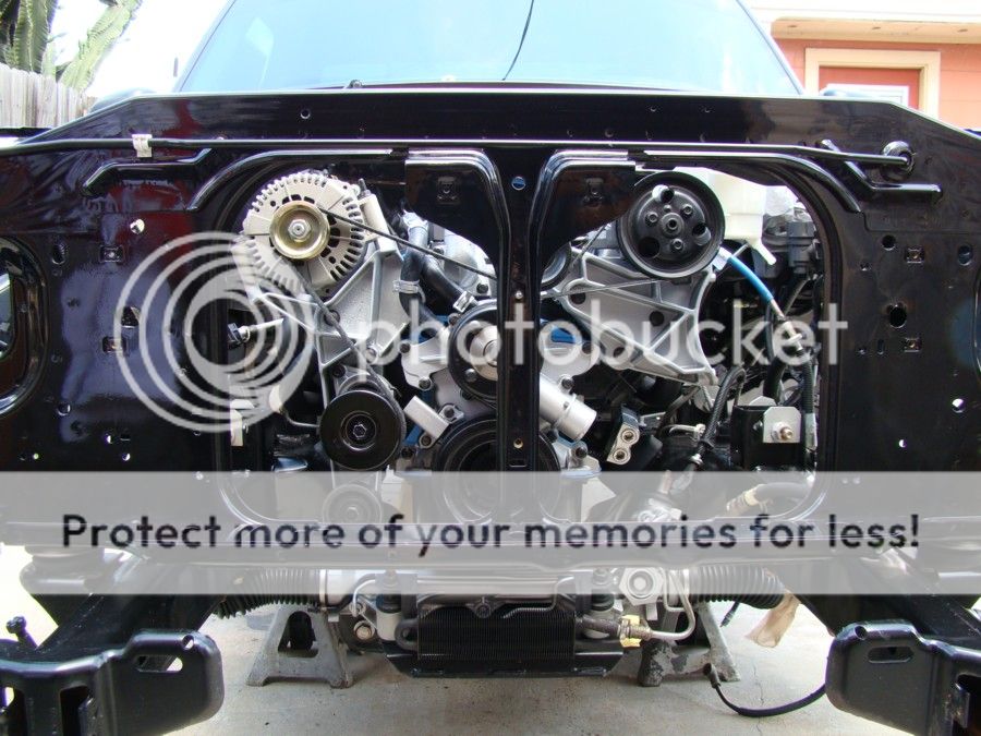

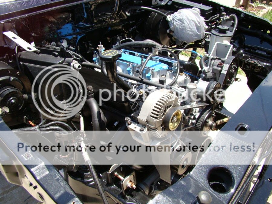

Now let’s take a quick look at oil pan clearance on the steering rack. Several other people have expressed problems in this area and I expect I will run into the same concern. It looks a little tight. Yep, the tee shirt is stuck in place.
So here is the plan, I am going to add a few washers as temporary spacers on both sides to raise the engine slightly. Once the desired clearance has been achieved the washers will be removed and permanent spacers will be cut to the exact thickness and welded directly to the engine plates.
With a little luck I will be able to slip a piece of card board completely under the oil pan between the steering rack.
With the correct combination of spacers on each side the engine sits level just like it belongs in the Ranger.

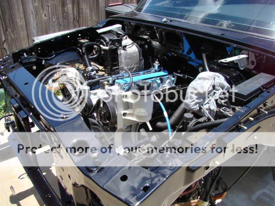

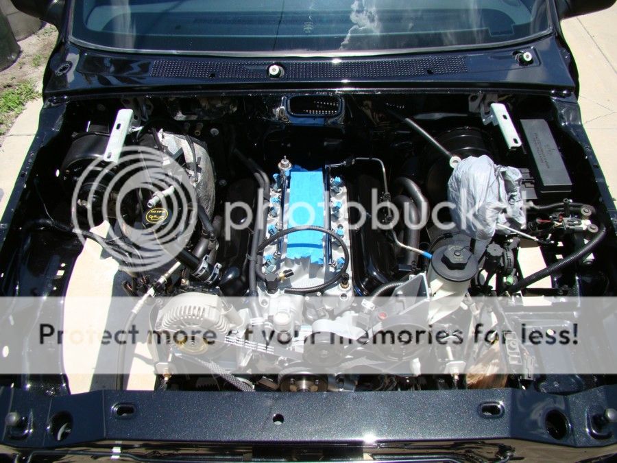

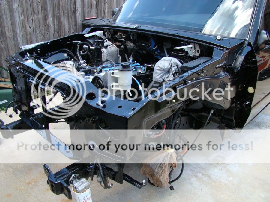

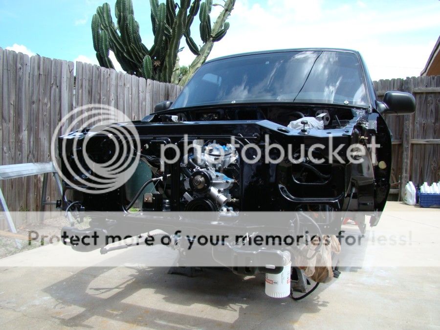

Since it was still early in the day I went ahead and added the front accessories and headers.

NICE JOB! That motor looks right at home!!
I dunno about your hood or firewall clearance, but the fit between the oil pan and steering rack looks a bit tight, even with the washers.
Kinda like a $10 bill will just slide in there, but a $20 won't fit.
Yes, you can delete the pats via SCT. Im running a 99 ecu (EQE2) with pats, rear O2's, and EGR deleted using excal2 SCT tuner. Looks great. Your engine should be right up against the firewall for rad clearance...
