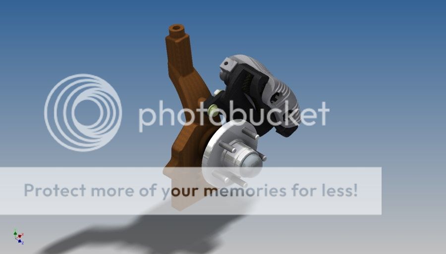

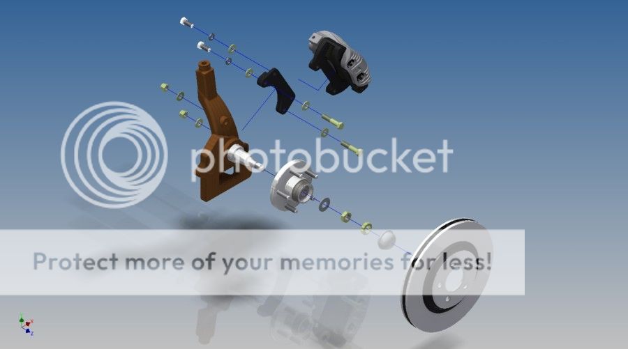

After several e-mails back and forth with Adam’s friend, Chris, the deal was set. Almost immediately the new parts were under construction. Right from the very beginning I could tell Chris was very knowledgeable and enthusiastic about his work. He was kind enough to share some of his CAD drawings, final design plans, and photos as the custom parts started to take shape. He not only had the plans for the brackets and hubs to mount 13 inch 2003 Cobra front brakes but also the data required to mount the 15 inch rotors and four piston Brembo calipers from the 2007 up GT500 on the 1999 Ranger. That was very tempting but I really didn’t want to jump up to 18 inch wheels and tires at this time. I asked Chris if it would be alright to post some of the information he shared with me. He agreed and forwarded some revised information designed to protect his intellectual property yet still share some of the technical information with the novice such as myself. The following information is being shared with his permission.

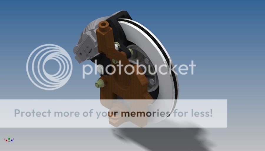

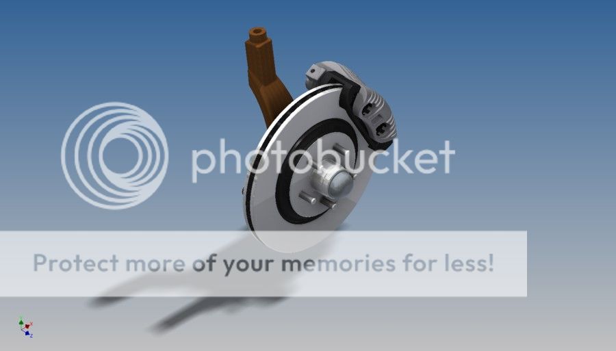

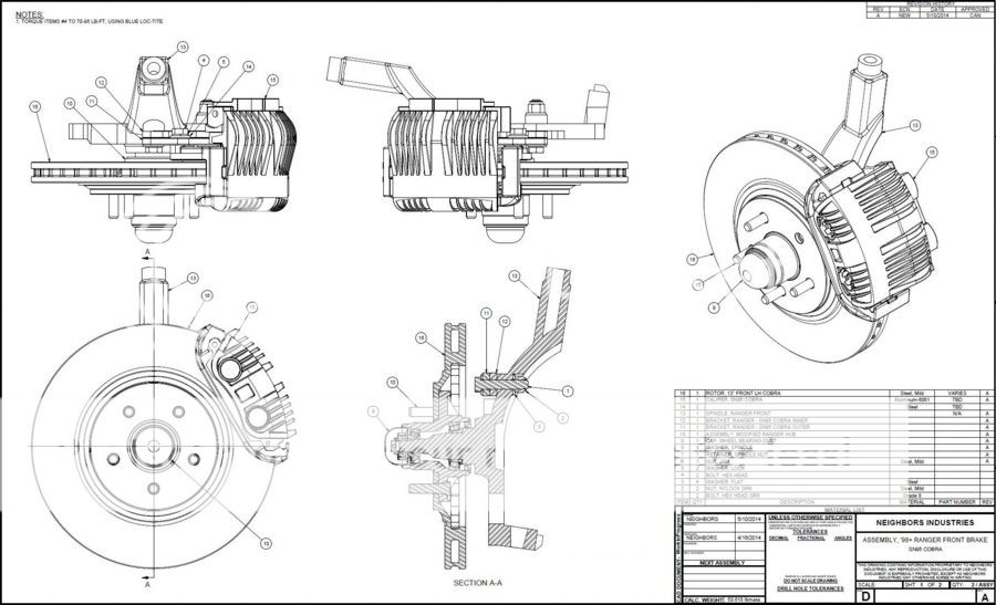

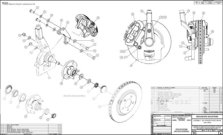

Here are some of the CAD drawings showing the 13 inch Cobra front brakes and the Ranger spindle.

The technical knowledge and craftsmanship that goes into a project like this is fascinating to me. The plans show how critical exact measurements and tolerances need to be. The upgrade is pure custom, definitely not a handful of off the shelf parts thrown together with the help of a pry bar and a grinder.

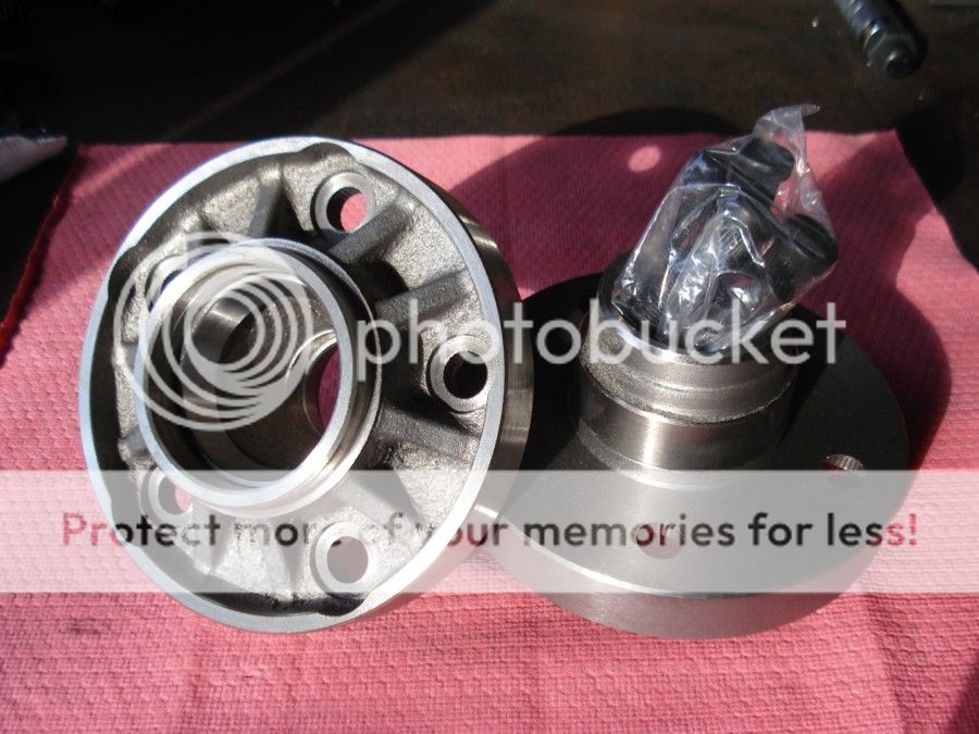

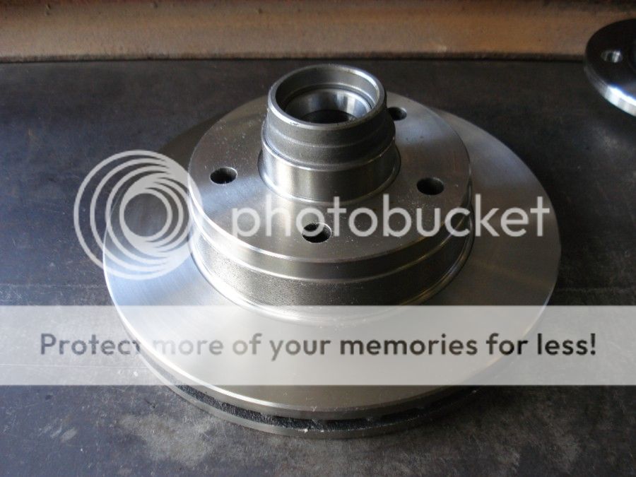

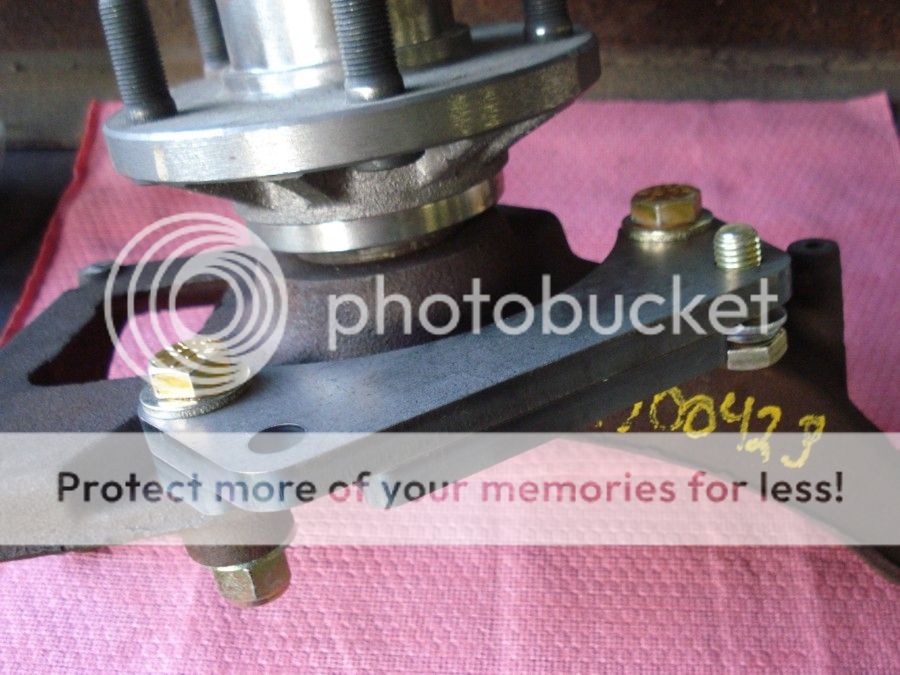

Here is one of my brand new 1999 Ranger front hub/rotor that was purchased and is now ready to go under the “knife”.
One more 2wd 98 coil spring 5.0 swap.

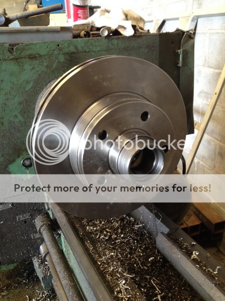

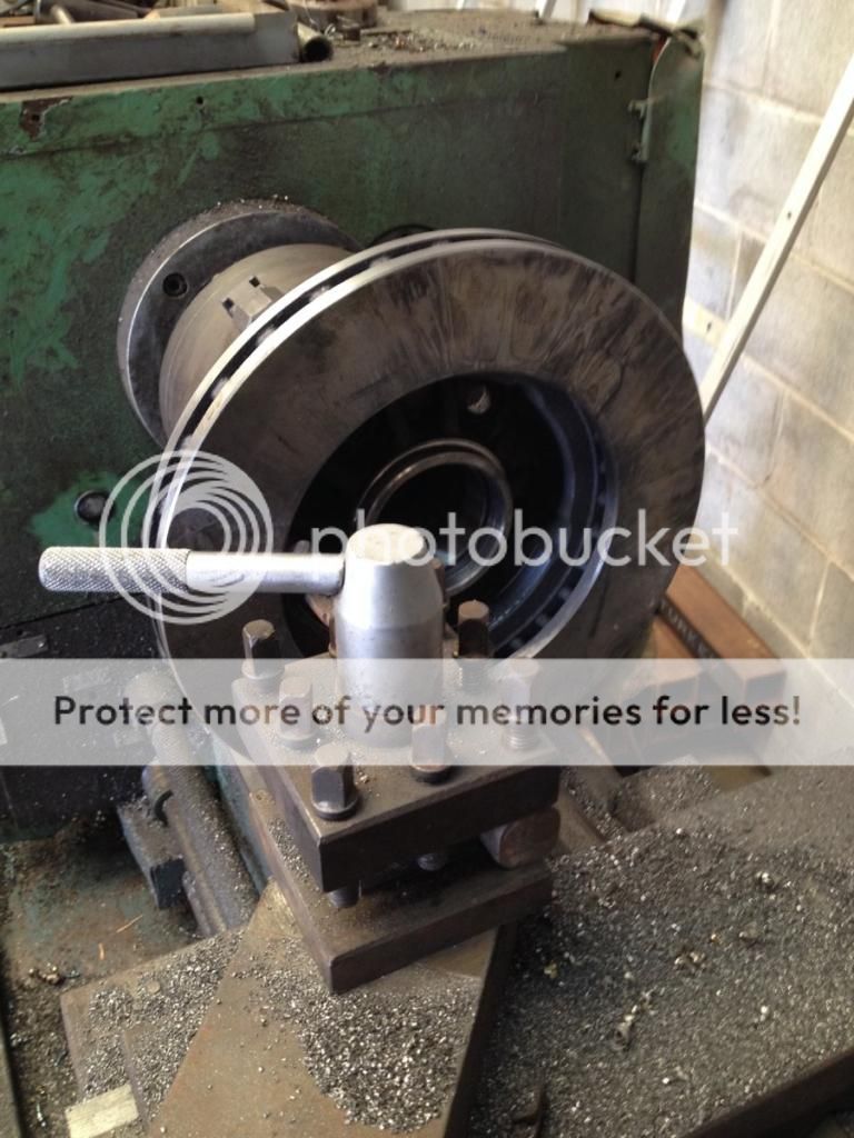

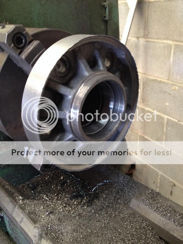

Here is the1999 Ranger hub/rotor chucked up and ready for the first cut.

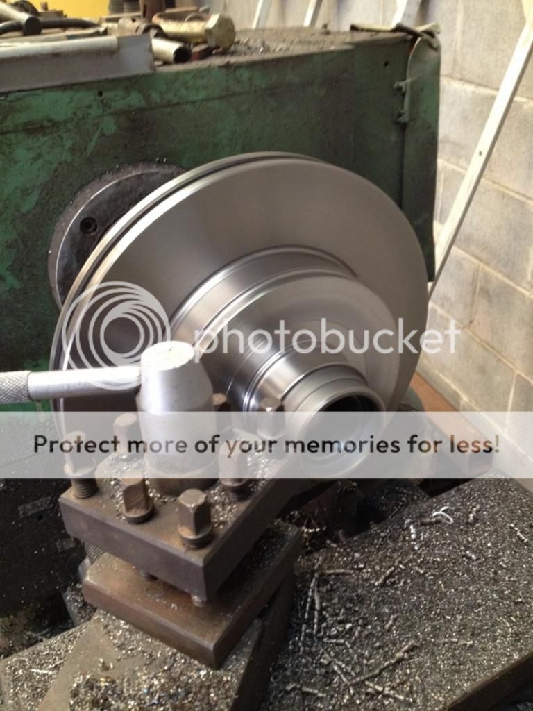

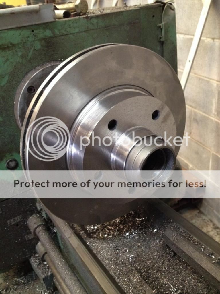

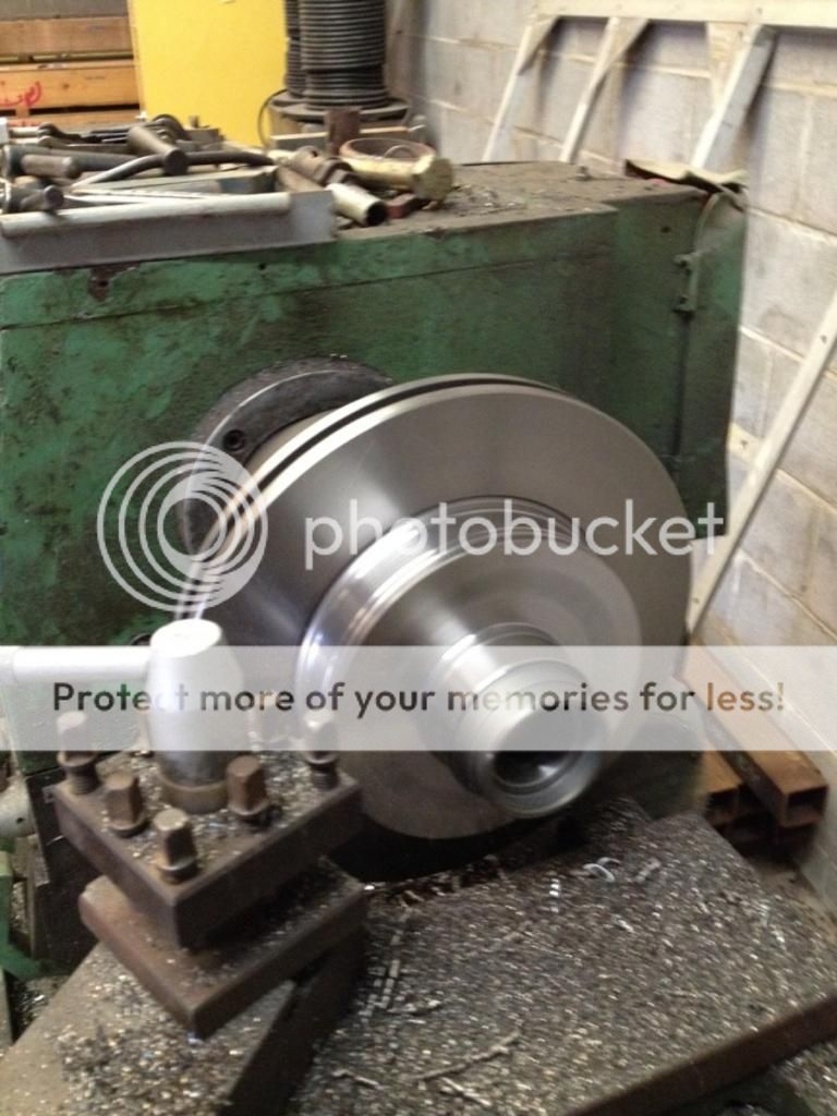

The process starts with milling down the outside diameter and then moves on to cutting in the other dimensions.

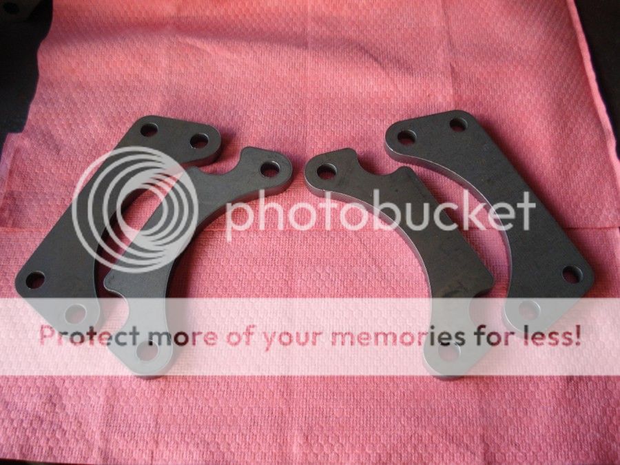

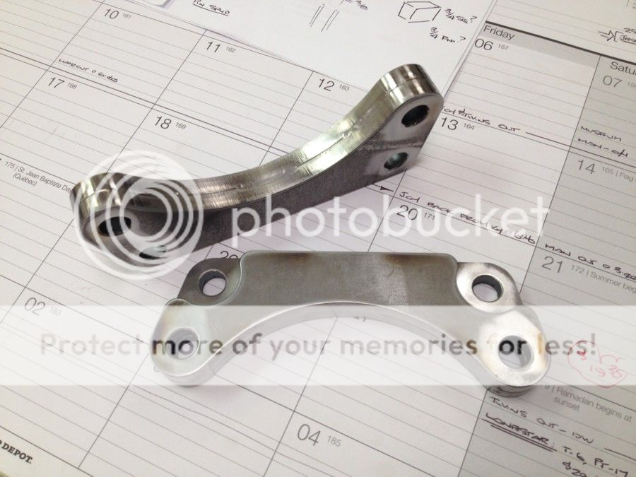

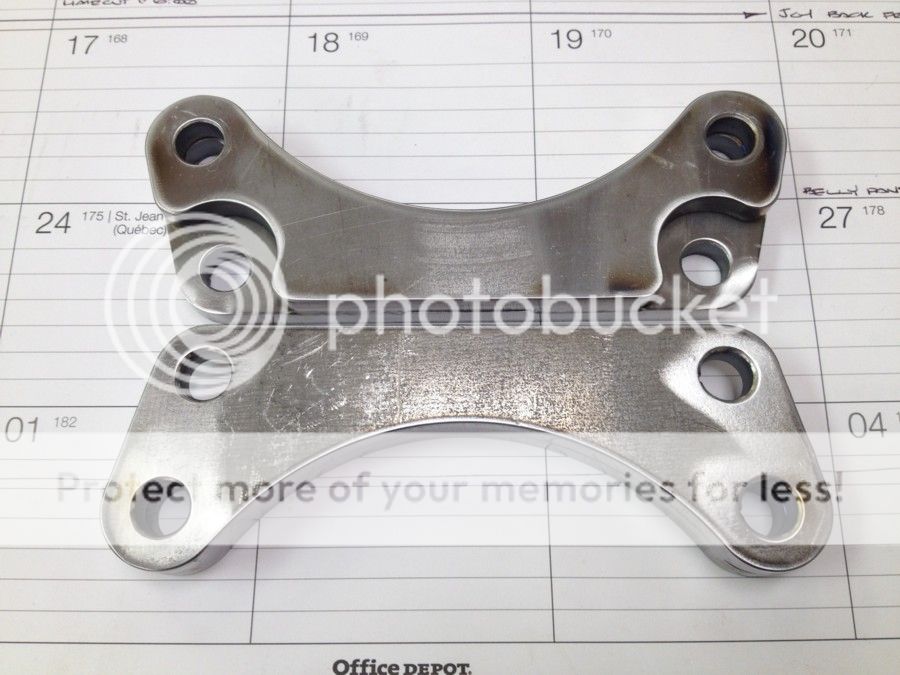

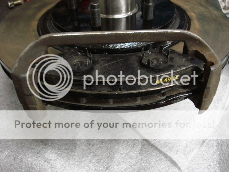

At this point the brackets have been cut from the appropriate material. The pieces are ready to be test fit and all of the tolerances double checked. Chris is very thorough in this area and won’t ship anything out until he is sure all of the parts fit perfectly.

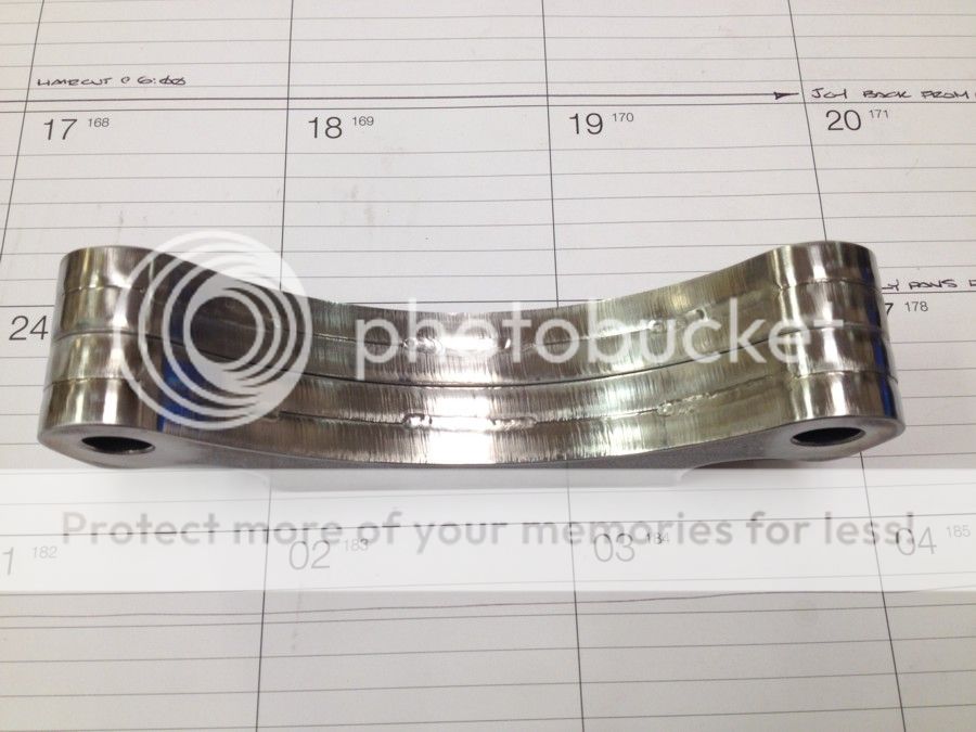

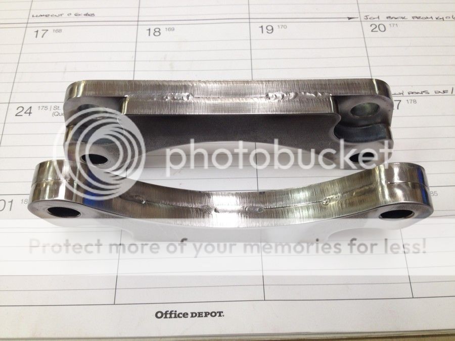

Once the fit and finish is perfect Chris tig welds each of the two corresponding pieces together and the one pair of completed brackets is ready for shipping.

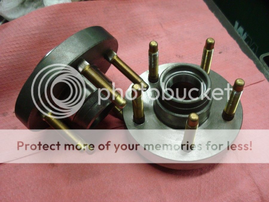

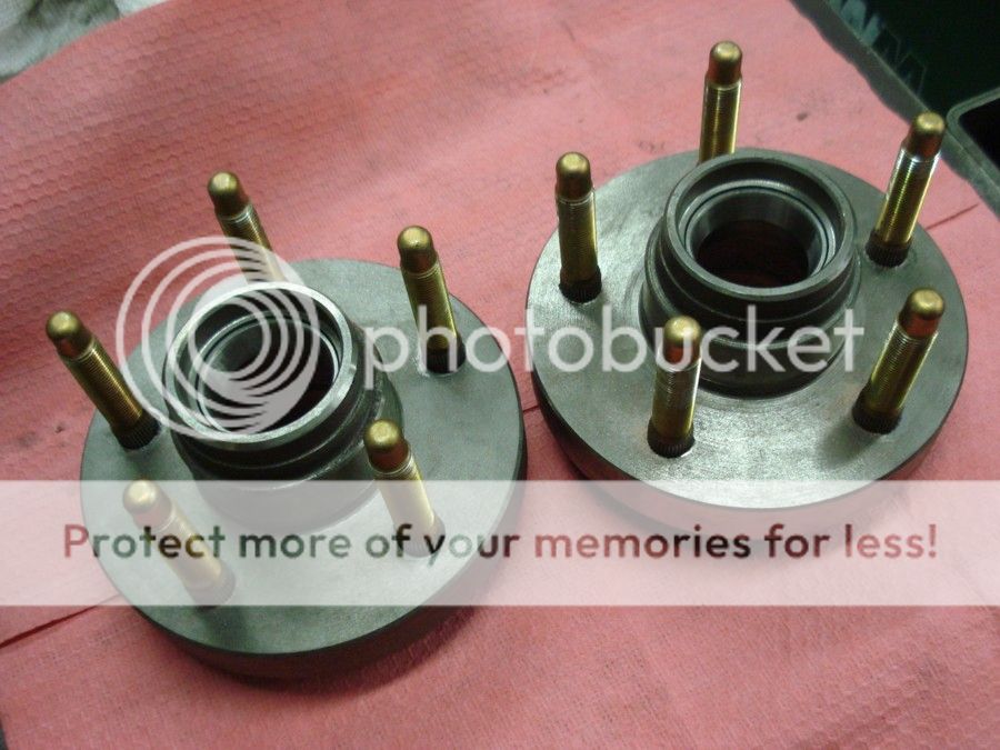

Before the hubs are packaged up and shipped Chris pressed and fit 3 inch wheel studs in each of the hubs. These are installed so a ½ inch spacer can be used in conjunction with the 17x9 Chrome 03 Cobra wheels and 275 series tires.

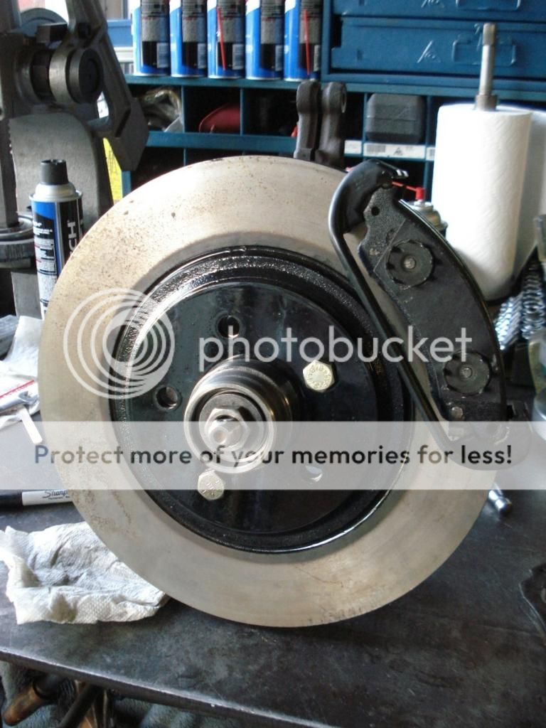

I had a few extras like longer studs, special fasteners, and he moved the bracket location slightly from his main design. I can tell you with all of that it was still less than others I have seen. I will get a to the penny price for you over the next couple days.

Great work, wonder if that would apply to us unit bearing guys, then I'd only need the brackets. Are the caliper brackets OEM?
