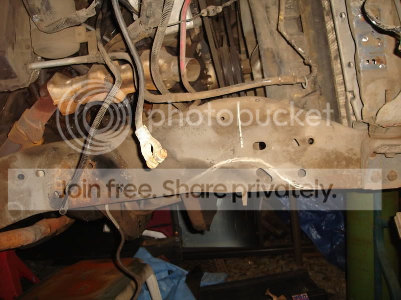

I did look at the front axle though. With the height of the truss, theres only about 3" between it and the frame rail. That means that this thing will pretty much be riding on the bump stops and not really have any uptravel. Obviously this wont be enough. To address this problem i plan on raising the truck up about 1.5". Still isnt going to be too tall. Also, i think i am going to notch the frame about 2.5". Here is what im thinking:

The vertical line is my approximate axle center line. The other line is the cut im thinking of making. This is going to give me another 2.5" of clearance above the truss, increasing the overall clearance from 3" to 7". Of course the front portion of the frame will be boxed also to make up for any lost strength. Thats about it, hopefully i will have more to update tomorrow. Thanks guys!

That seems like a good idea to me if your going to box the front of the frame. I dont think it would hurt having more clearance.:icon_cheers:
Thanks alot guys :icon_thumby:

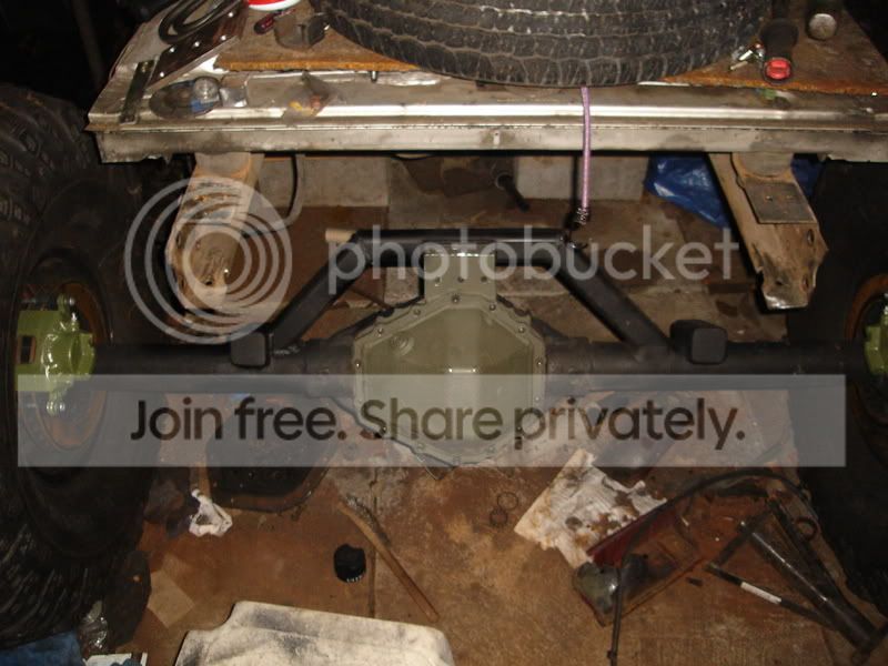

The rear axle is all done. Moved the spring perches in so that now they sit directly under the frame rails and shortened the truss to fit.
Heres how it started:
New guy, new project: 1988 BII wheeler
And here it is after the change:
By being shorter its less effective in keeping the housing straight but still will do its job in keeping the tubes from spinning. Leaf springs are ready to bolt up so whenever the weather around here permits (we've had 50% of our average ANNUAL rainfall in about 2 weeks). Hopefully this week/weekend i can get the springs bolted up and figure out the hangers. Thanks guys
