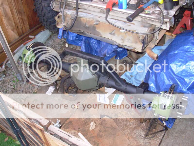

Back again haha. All the beadlocks are done and it seems like they all hold air but im keeping an eye on em to make sure there are no slow leaks. The 14 bolt has brakes and has been painted so i figure i would throw the pic on here:
Thats it :D Thanks guys

This is some great work! SUBSCRIBED! I like the colors that you choose for the axle/calipers/beadlocks :D My only question is what is the truss for i have seen them before but don't understand what their purpose is. does it have to do with the one link? or does it just prevent some type of axle movement?
Thanks, the whole truck will eventually be olive drag and flat black. The axle truss is basically there to strengthen the axle housing itself. By tying it into the differential cover/housing, it helps prevent spinning the tubes. The tubes of the axle are simply pressed into the housing then plug welded and if they take too much abuse they could break those welds. If those welds break, the tube could turn in the housing and lead to very bad things haha. So by tying the truss to the housing and tubes, the overall strength is increased ALOT :icon_thumby: It also makes an easy place to attach a steering ram or panhard bar (if i was to run some kind of link suspension)
