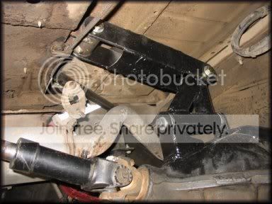

Oh did i forget to post that thing up? Here it is:
New guy, new project: 1988 BII wheeler
Its from http://www.jeepaholics.com/tech/bambar/, not my picture. The link explains everything about it as well as how to build it. Its pretty cool, doesnt interfere with ground clearance or axle articulation like most anit-wrap systems do. Plus since i already have all the materials for it except for bolts, this thing is gonna cost me next to nothin :icon_thumby:

:headbang:that is the best solution that i have seen for an antiwrap bar props to who ever desgined that :headbang: yea not to many materials to build that are you gonna go with the solid bushings or the 2 seprate ones? if i where to do it i would mostlikly use the soild one that way seems like the easier route to fabing it up.:icon_welder:
I have lots of extra bushings in DOM tube so im doing 2 separate ones on the bottom but yeah, one long one would be best
Could you run that on the front too? That would be nice so your front axel won't slide around as you flex it like it would with a track bar...it would stay centered.
you are going leaf springs right, why do you need that at all?
You could use it on the front but i dont have the room and wont need it with the radius arm setup because the radius arms are solid mounted to the frame and cannot bend.
Devices like this and other anti-wrap systems are used to combat axle wrap which is a common problem maintly with leaf springs because they are a large spring, and therefore flexible. When torque is applied to the axle the axle will try and turn, therefore bending the leaf springs. Heres a good video of what im talking about:
http://www.youtube.com/watch?v=Hv6HZVv4GUo
This device keeps the axle housing from turning and keeps the springs from bending. This doesnt help keep the axle centered under the truck, that will be the work of the panhard bar which i only need for the front since leaf springs hold the axle centered in the rear.

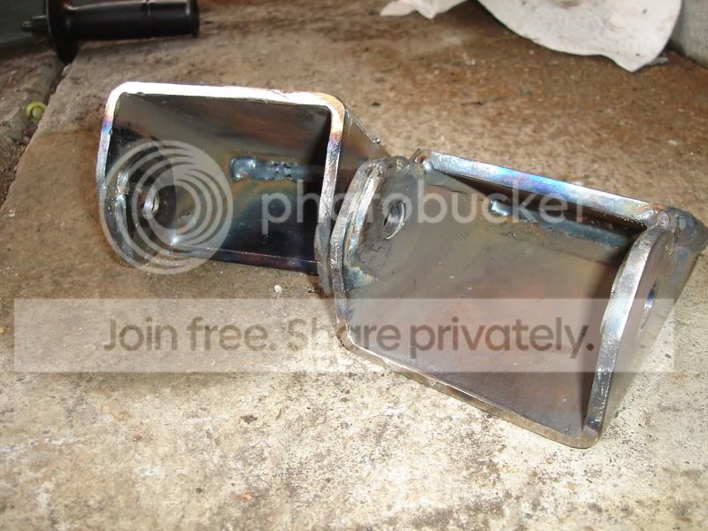

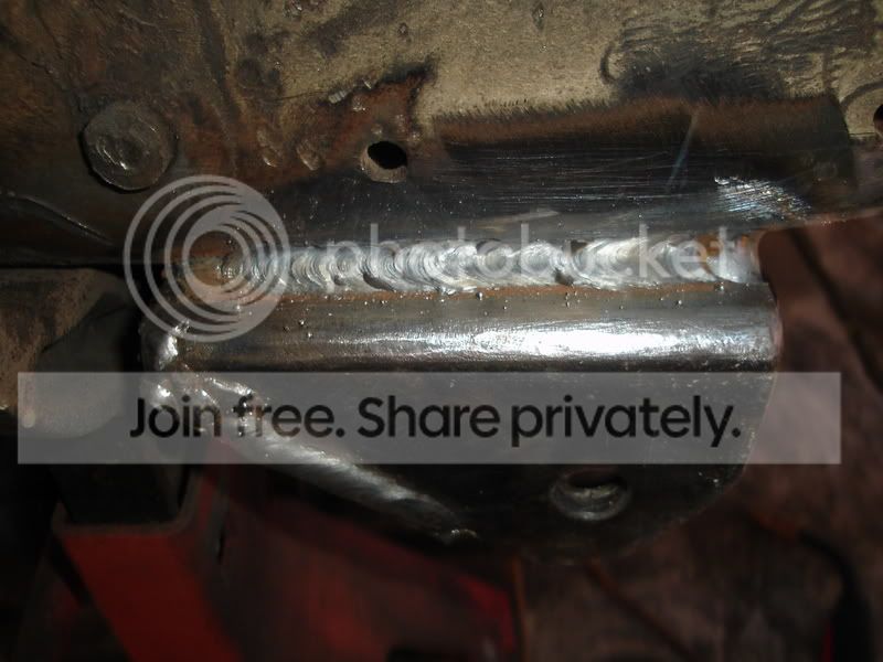

Got the front spring hangers in today. The hangers were cut from square tubing and i used some .25" plate to beef em up a bit. Also welded a washer to the inside so that they fit the springs tighter.
Here they are:

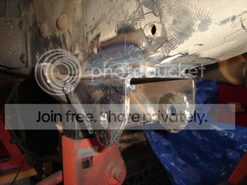

Welded on the frame:

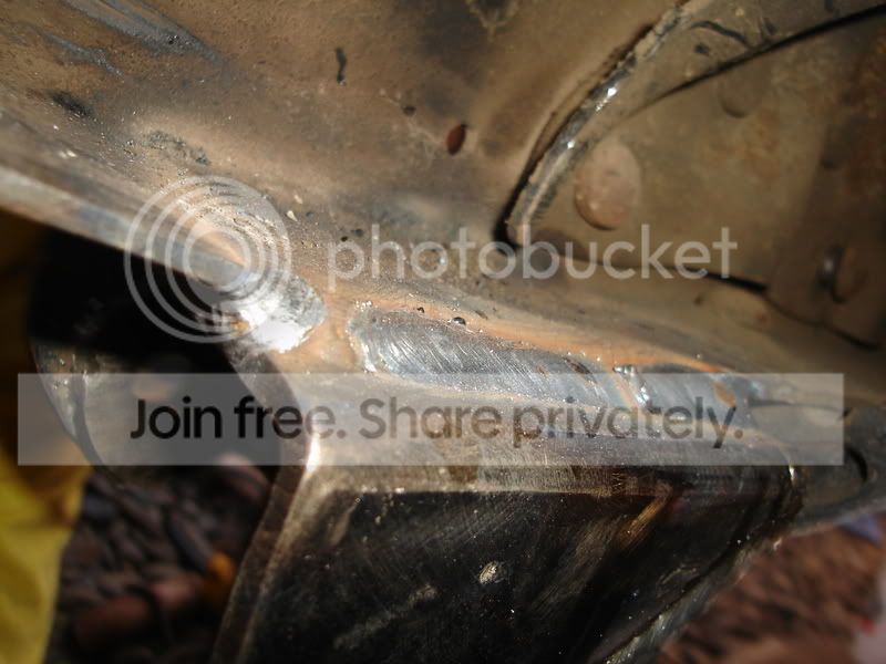

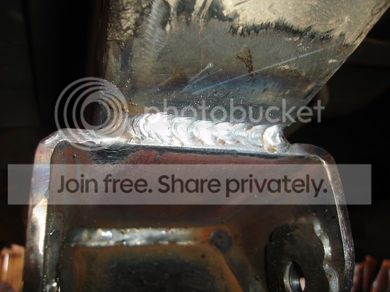

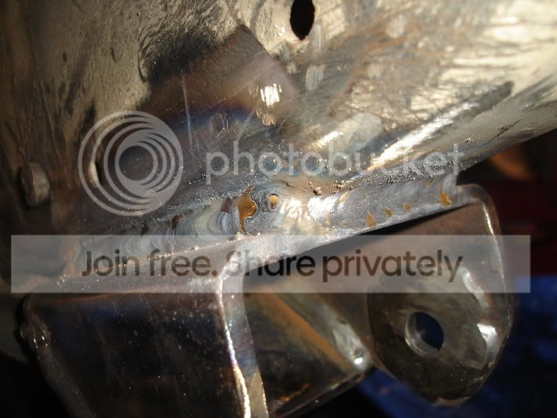

Weld shots :icon_welder::

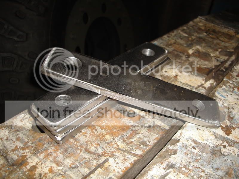

Also made the shackles. $5 of scrap metal and 1 hour of machining and they are ready to go. 3/8 plate, 5" center to center. And yes the holes are different sizes, 5/8" at the frame and 1/2" at the leaves.
