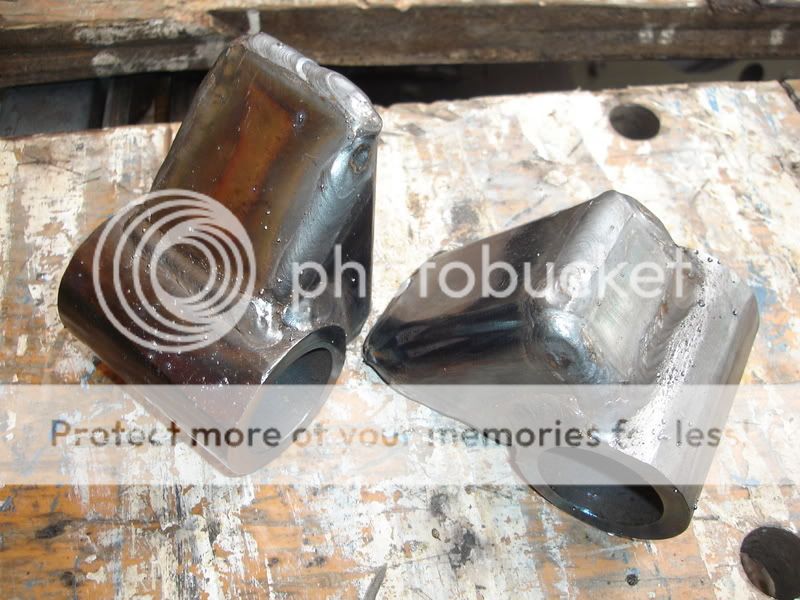

nice welds. it took you an hour to drill 8 holes? Did u do it your self becuase i have drilled into some thick metal before but not for an hour.
One hour was: cutting the 4 shackles out of a single 6"x1.5' piece of plate with a dull band saw, drilling all 8 holes, deburring the holes, grinding down the corners, then sanding the all the edges down to a nice smooth radius to keep from damaging the bushings. I actually made pretty good time :D

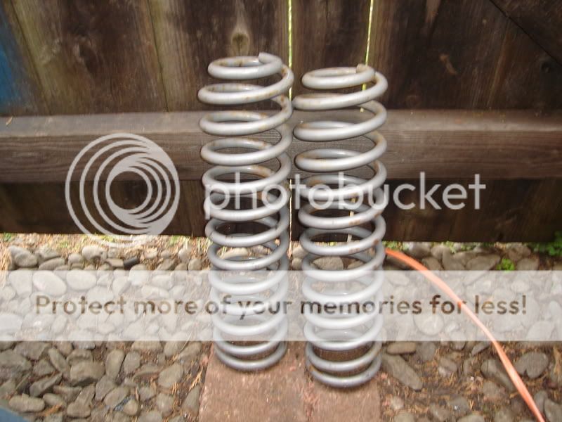

Got some used 4.5" lift coil springs from an xj for $50:
New guy, new project: 1988 BII wheeler

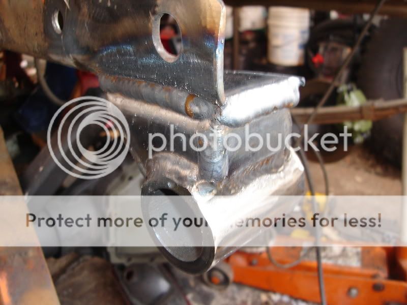

I also got the rear hangers in. They are .25" wall square tubing cut up and welded to some 1.75"x.25" wall DOM and then plated up with .25" plate. Here they are:
And welded to the frame:

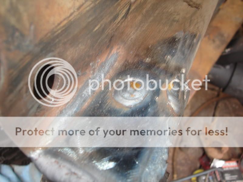

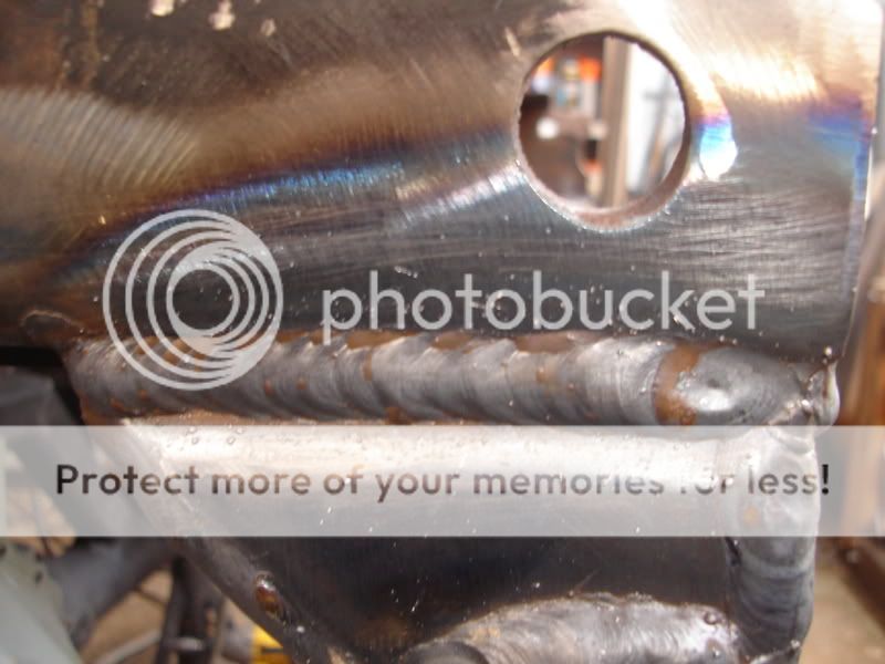

Weld shot:

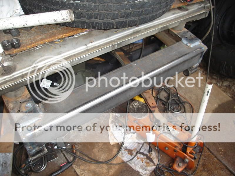

Now since i removed the rear crossmember the frame was pretty flimsy back there and if i flexed the leaf spring with it like that, my frame would probably turn in to a pretzel so i fixed that:

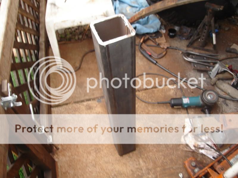

4"x4"x5/16 wall square tubing, i think that should do it :headbang:
Thick stuff!

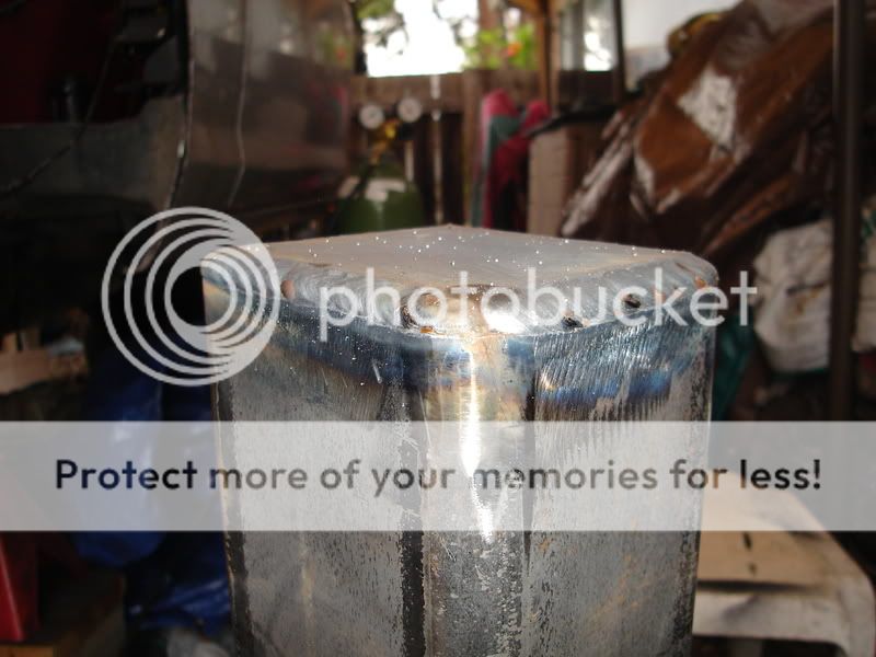

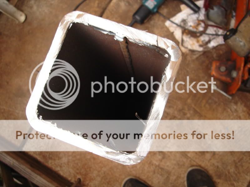

Capped the ends off with more .25" plate:

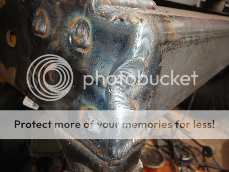

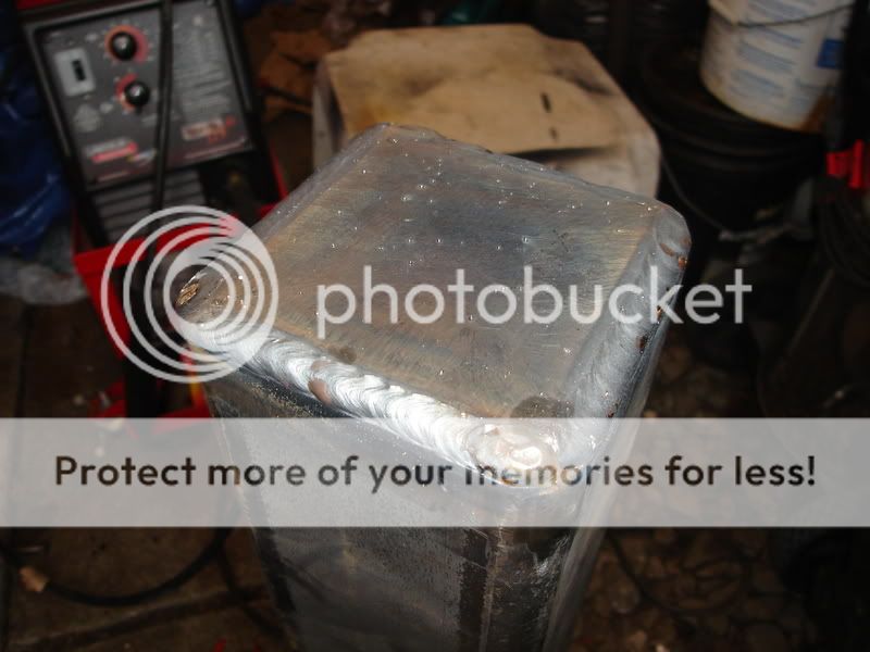

Welded in (more plug welds!):
I also have a good strong mount for some d-ring shackles now.
