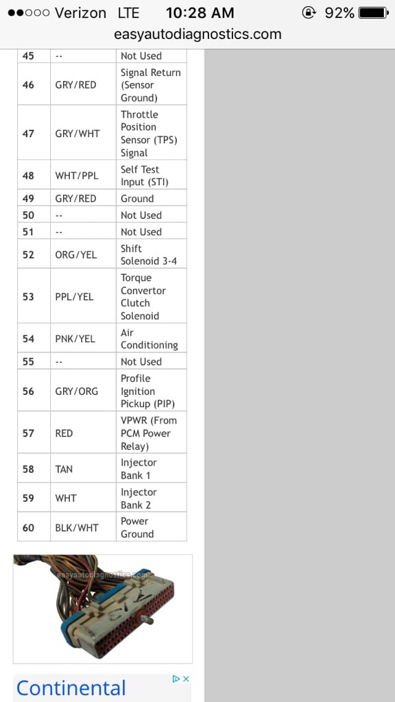

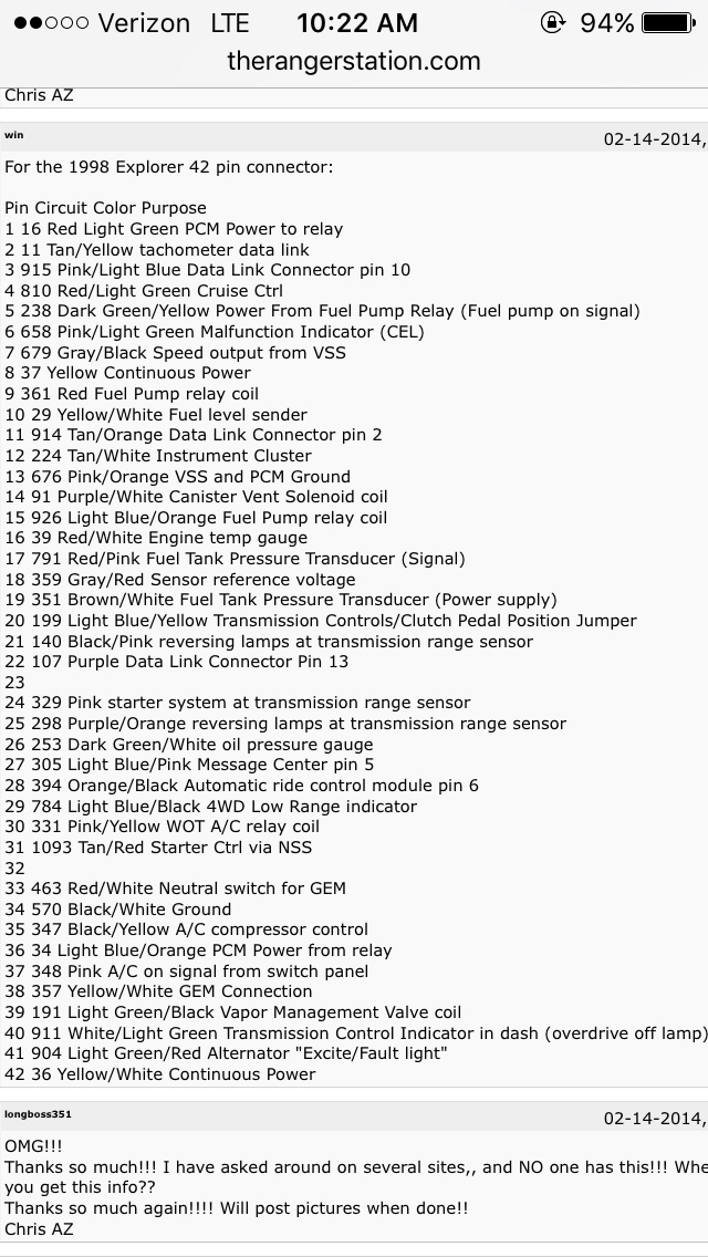

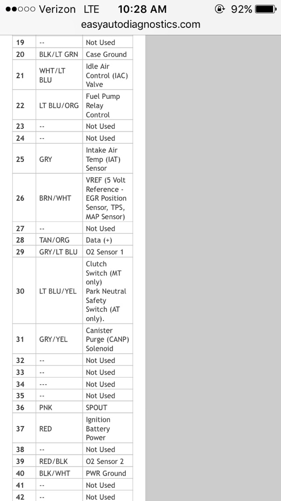

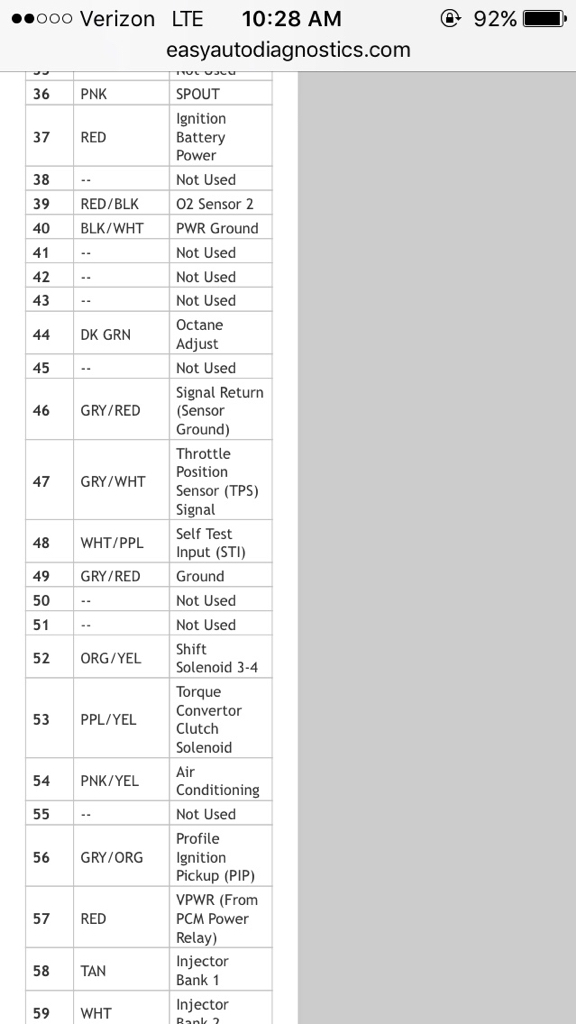

Okay, everything on this swap is complete except for the wiring. I searched for hours to find a 42 pin connnector diagram off a 98 explorer and I sure hope the one I found is correct. I labeled all the wires and have a few that are "Data link" I read somewhere that these are the wires that run pats.
how do I splice the pats into the connector to get the truck to fire?
And can anyone point me to a wiring diagram for a 93 4.0 ranger for splicing
Okay I found some wiring I info. I plan on pulling the wires from the back of the ranger 60 pin and then splicing into the 42 pin off the explorer.

Can someone help me with what needs to be spliced where? This will be day 3 of me trying to figure it out. Obviously I won't need all of the 42 connector hooked up. Just the essentials plus what I need for A/C.

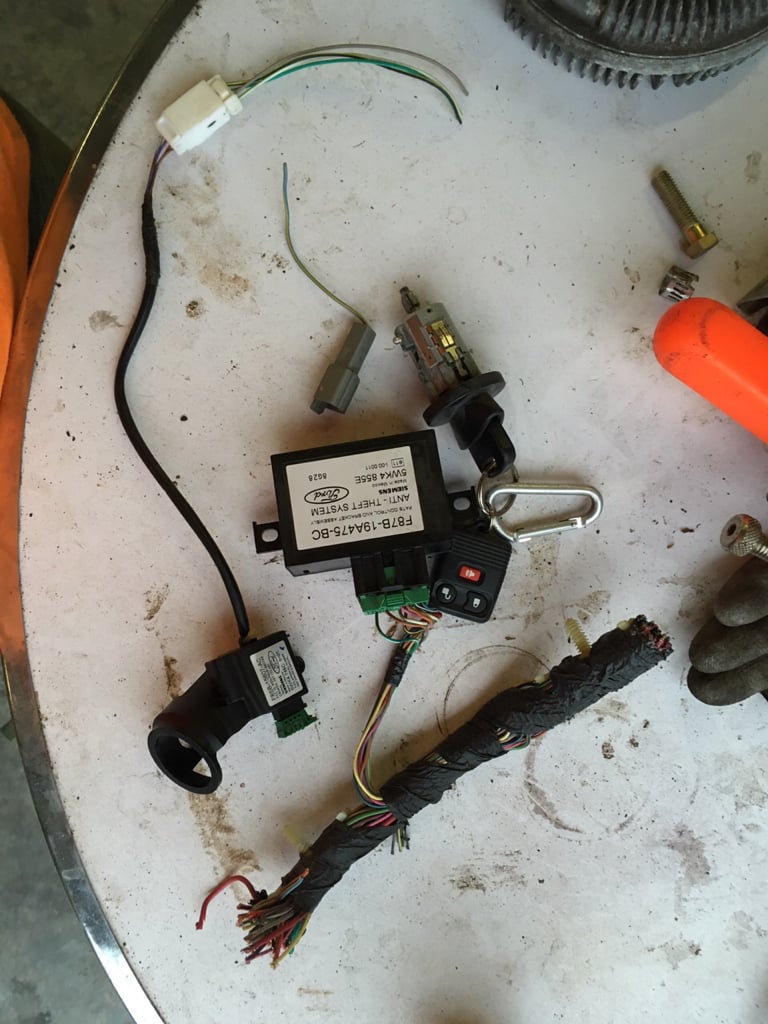

PATS seemed to be integrated into the main dash harness. So I just cut Some wiring out with the two pieces
This is all the PATS stuff I removed from the donor
-key ring/transceiver with some wiring
-key
-control module with some wiring

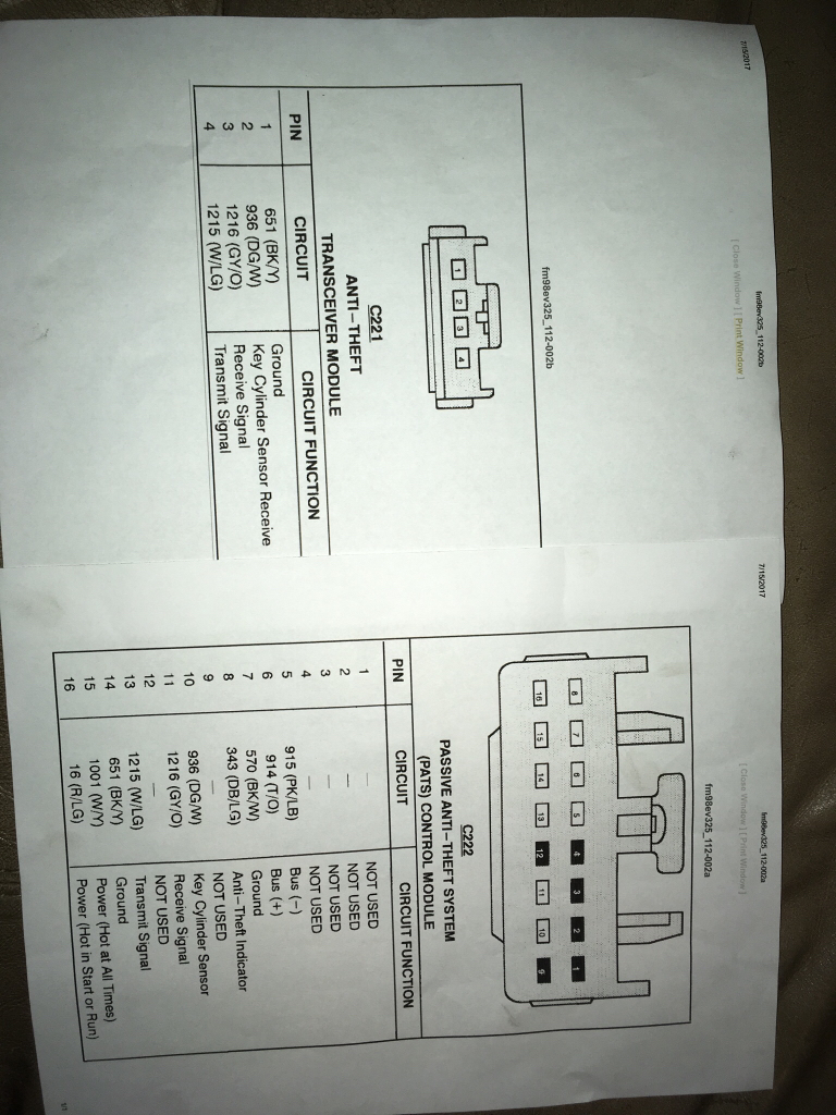

These are the diagrams for the two. Three wires all from the transceiver I wired directly to the corresponding colors on the control module. Grounded all grounds. Put the hot wires to B+. Removed the indicator wire as I don't have one. Then wired in the remaining two "Bus" connectors to the corresponding "data link" wires from the PCM
