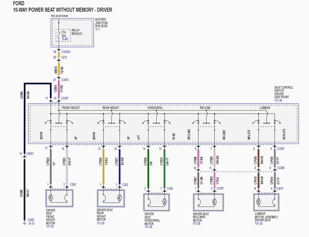

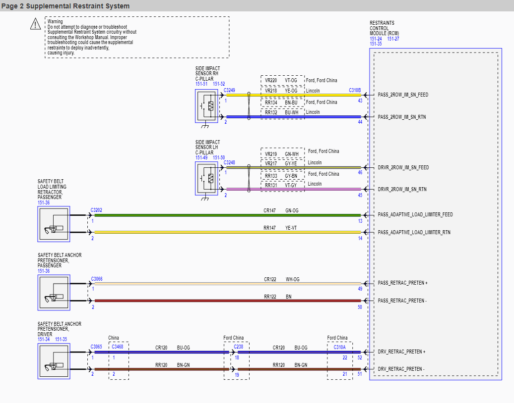

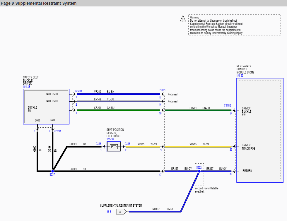

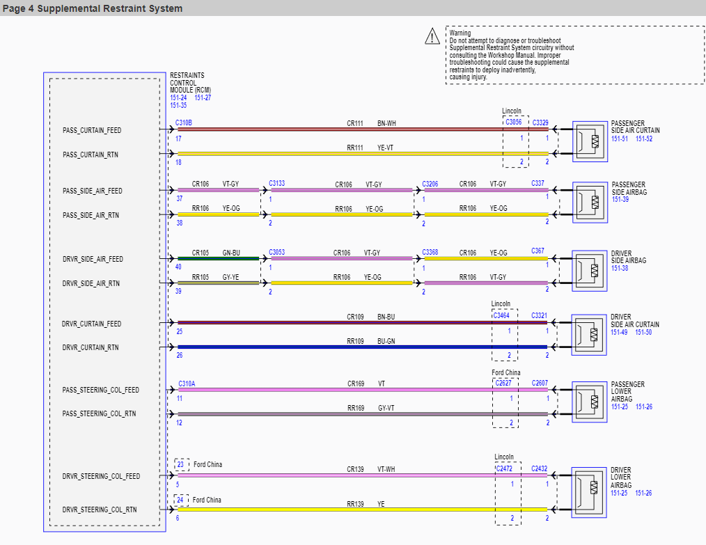

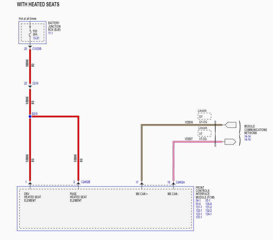

Anyone here have access to the adjustable heated seat wiring diagrams for a 2018 Ford Fusion? I have a set of power front heated seats. Trying to figure out the wiring for the heated/cool seats. I also want to make sure I don't accidently put 12-volts to the airbags.
I think this should give you what you need. Capture-221204E.PNGCapture-221204D.PNGCapture-221204C.PNGCapture-221204B.PNGCapture-221204A.PNG

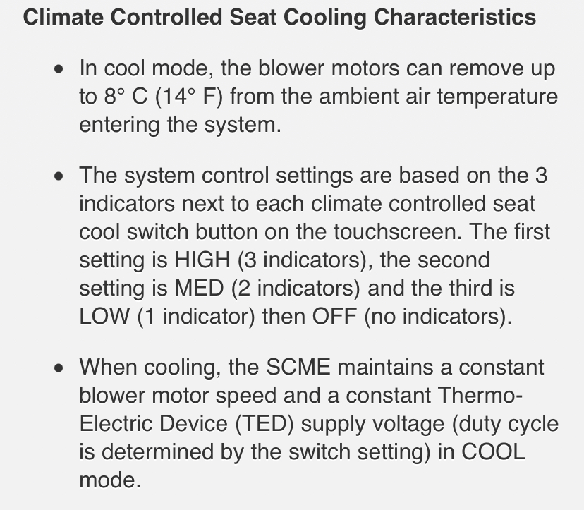

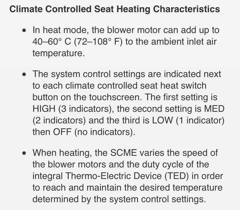

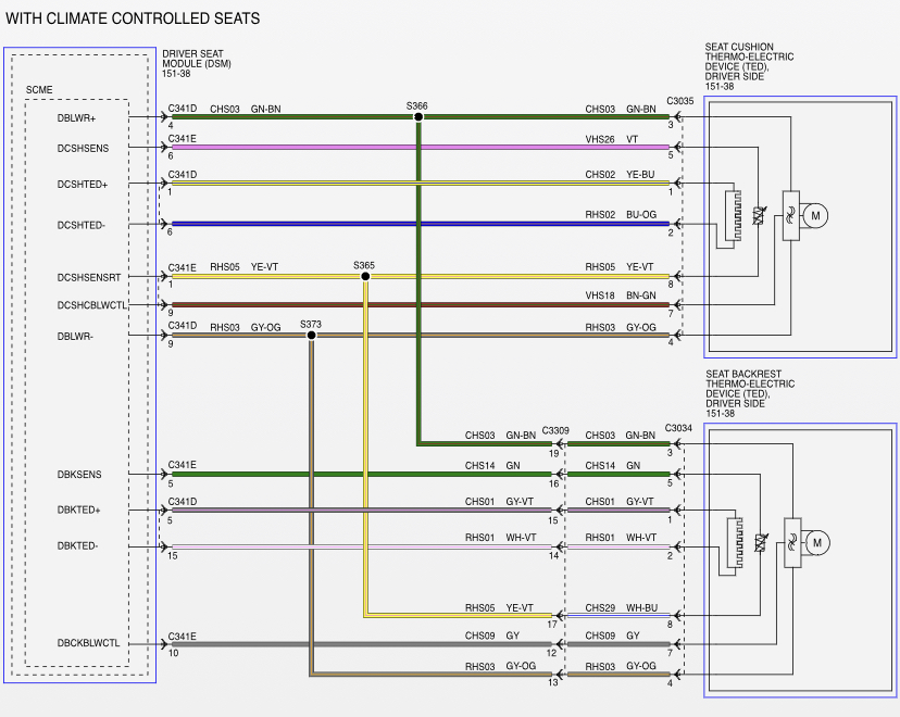

I see the diagram for the heat element, is there a diagram for just the cool seat setting?

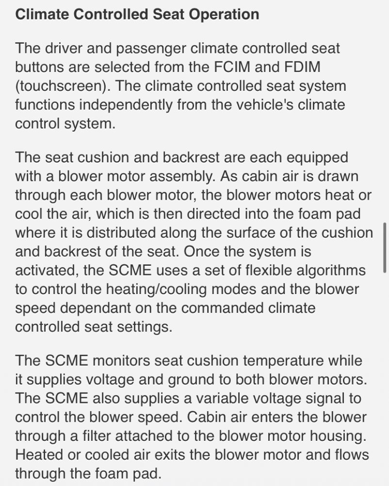

There’smore to it then just hooking up a few wires.
I had hoped that the needed module was under the seat and I could just trigger it with a switch.
Looks like the GN-BN wire sends power to the blower.
The YE-BE wire sends power to the heater in the seat cusion.
And the VT or YE-VT wire is sending power to a variable resistor that I guess is sensing the heat and controlling the temperature.

Hey @rubydist can you find a diagram for the switches? I want to see how they connect to the seats
I'm concerned about the 'variable voltage signal' required. Iv had wondeted if I could install a resistor to control the voltage to control the seat to have only one temperature setting.
