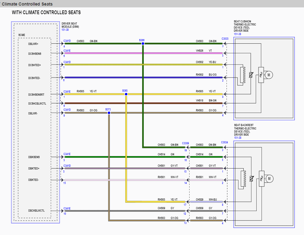

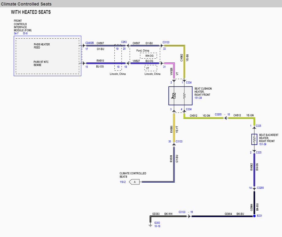

Need 2018 Ford Fusion power seat wiring diagram
Hey @rubydist can you find a diagram for the switches? I want to see how they connect to the seats
The switches are built into the FCIM or FDIM (touchscreen). The Front Control Interface Module or Front Display Interface Module sends a signal on the CAN system to the DSM (Drivers Seat Module) to turn on the heated or cooled seats. There’s no point to point wiring from the switches.
Capture-221205E.PNGCapture-221205D.PNGCapture-221205C.PNGCapture-221205B.PNGCapture-221205A.PNG
As snoranger suggested, they are not real helpful. Basically, the center stack touchscreen communicates through the CanBus to the seat controller and tells it to turn on or off, and then it has a sensor built in the seats to apparently adjust the amount of heat or cooling.
