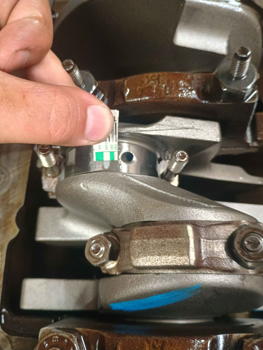

Long story short I had to put a reman crankshaft in my 4.0. When I started it back up it was knocking! I have it back apart now and I'm properly stumped. The rods all measure perfect 0.0015 clearance with my 10 under bearings. It sounded like it was coming from the bottom when it happened. I'm going to pull the first three main caps tomorrow.

Bearings came out looking brand new. Plastigagued to 0.0015. All flywheel bolts seemed tight. I recall oil pressure being fine.

The rod and main bearings all measured within spec. Timing chain seems ok? I took the valve covers off and most of them are soft. The motor sat for a while before I pulled so it won't provide useful information until I pump them up. Does anyone know what socket fits on the oil pump driveshaft? It's not E10...
