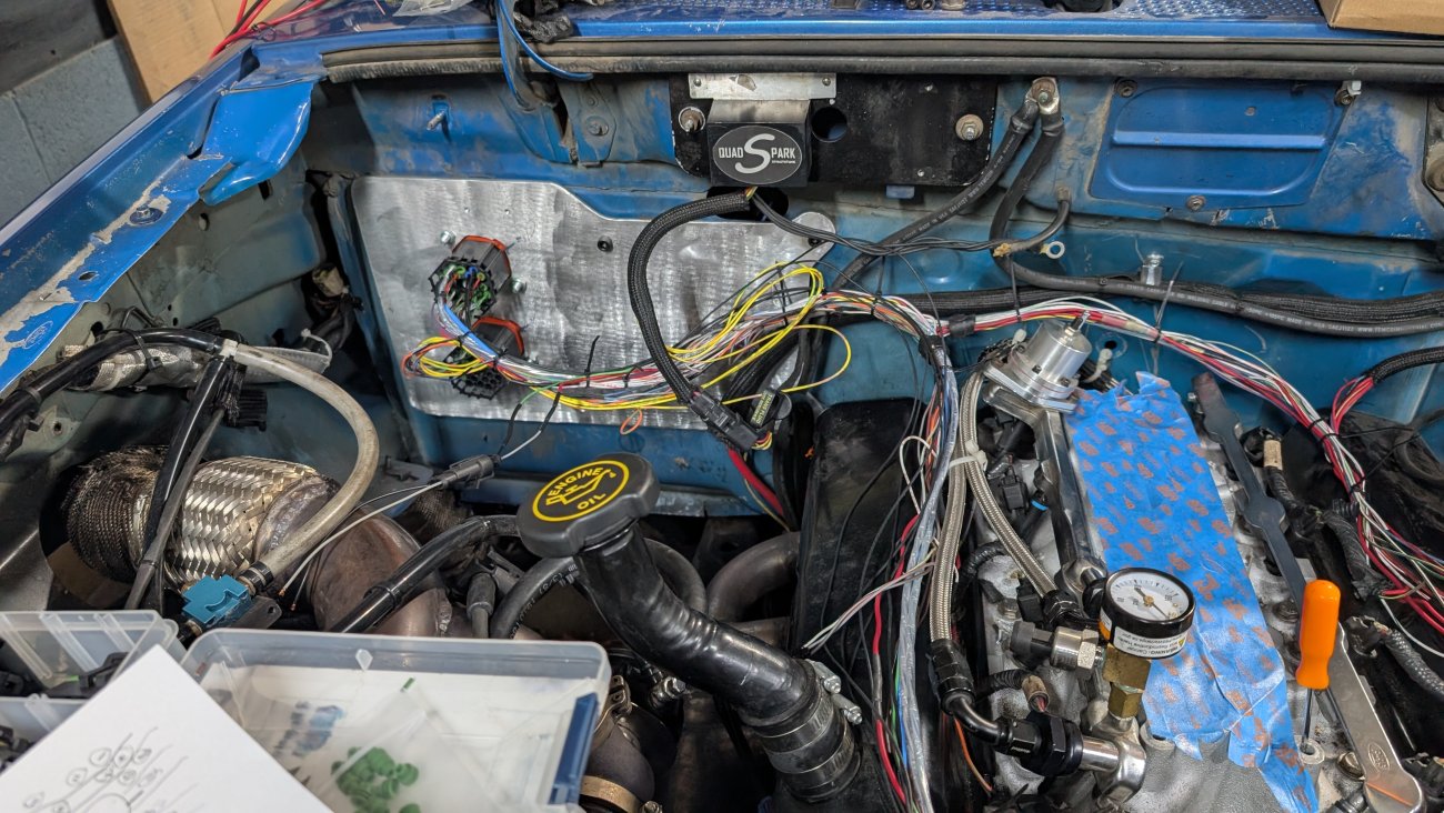

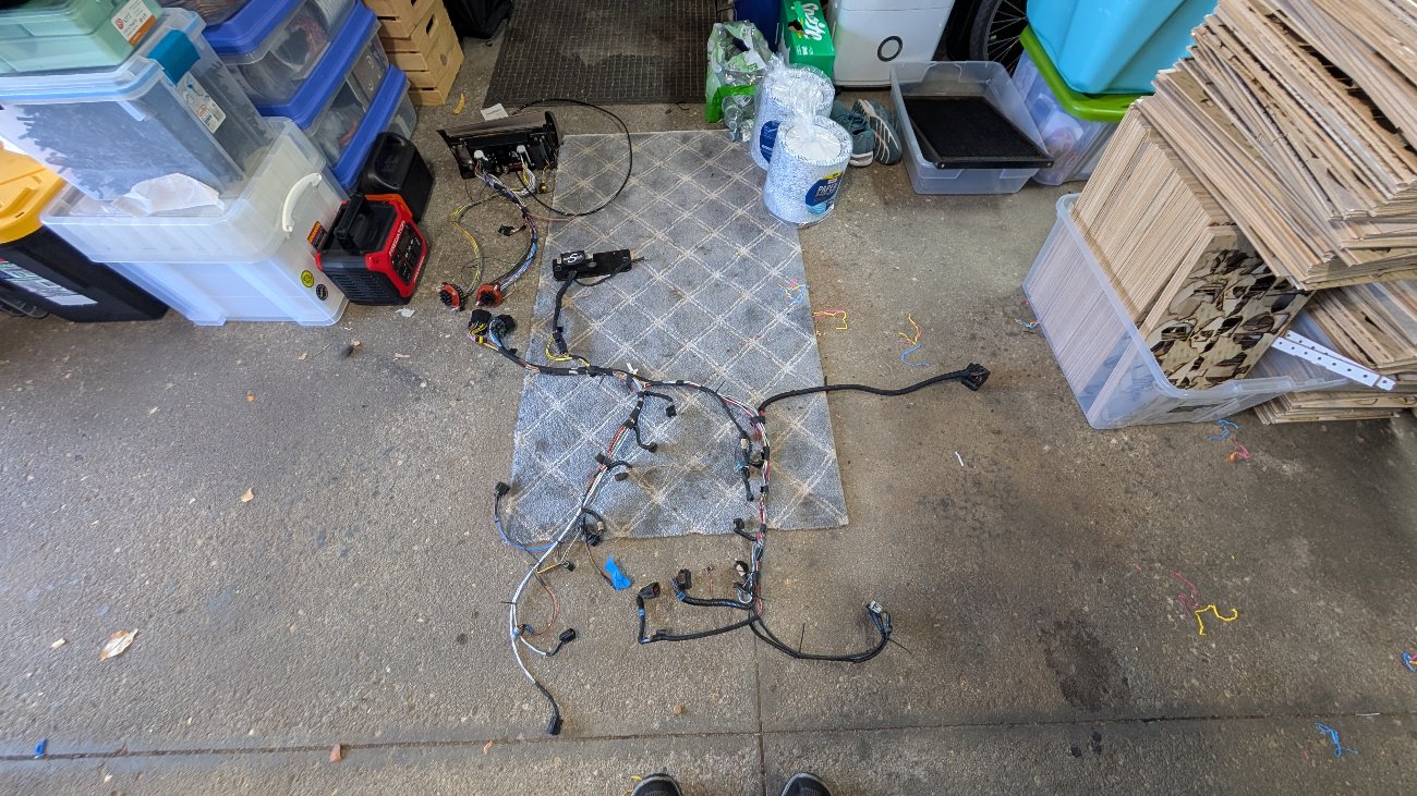

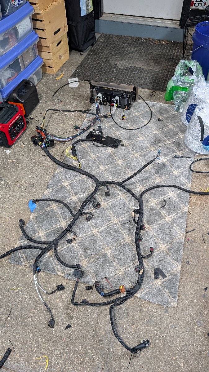

Christmas. + a new pre-labled wiring bundle.
Went with RCI 20gal, Aeromotive Phantom 435. Still have the voltage booster if needed, but I don't think it will.

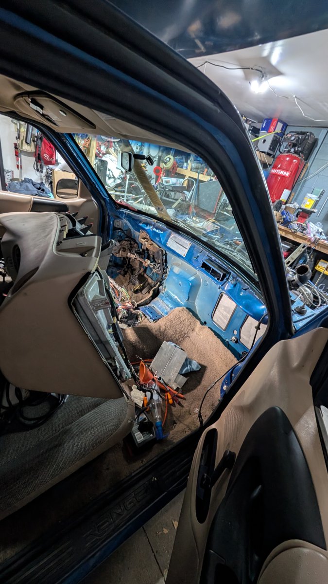

I can't get over how heavy this thing is!

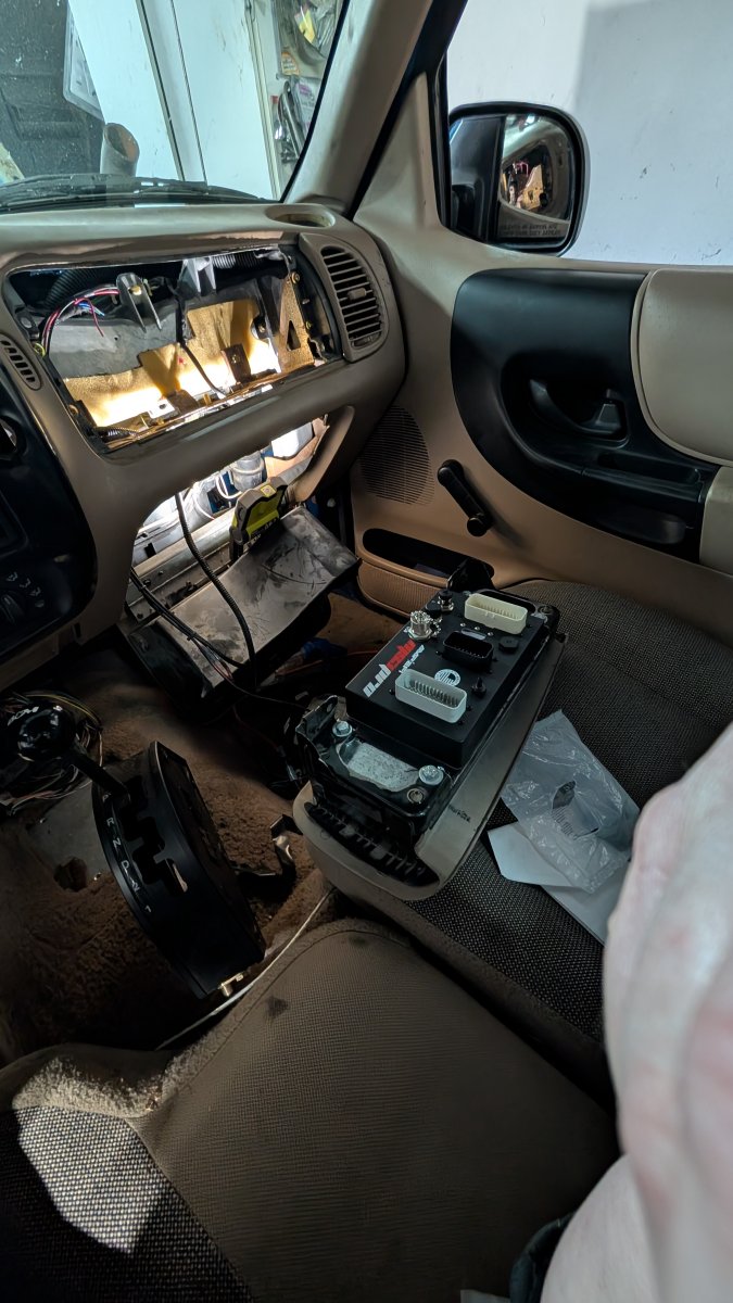

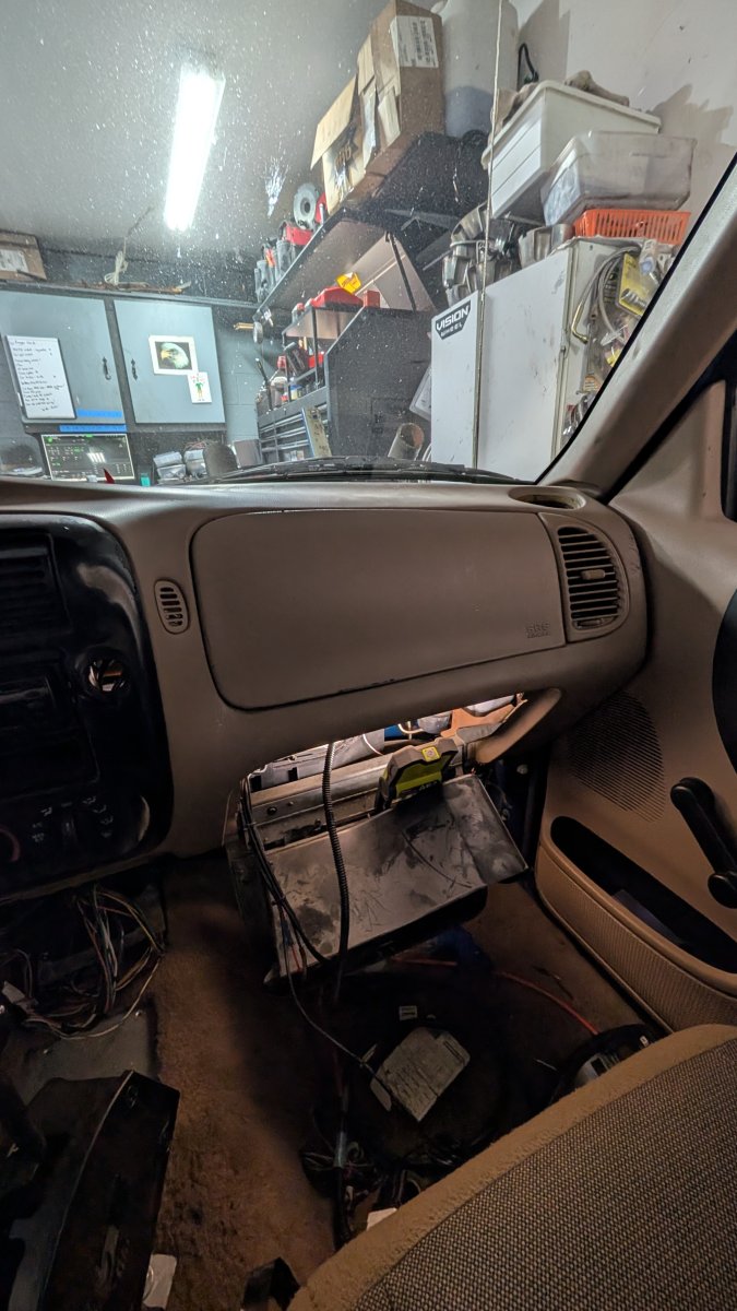

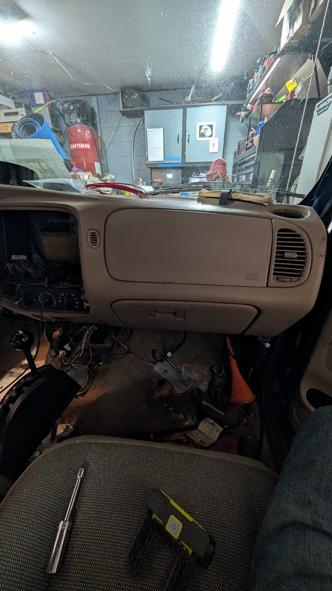

I was starting to fit the new ECU and just happened to see right into the heater core box. Someone was in it at some point and I guess broke every attachment point. They wrapped it in electrical tape to hold it together :unsure:
Since I already removed the blower/evap box, I figured I may as well rip that thing out too.
Also, the Ford service manual SUCKS. So many errors and incomplete processes, and completely missing steps.

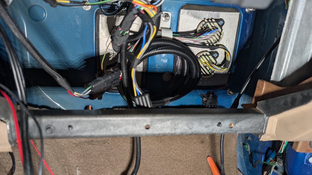

Oh, small ECU update. I sold the ms3x setup I was going to use as it was a PNP style, and I was going to have to fight wiring more than I wanted to.. since some of the wires came out of the eec connector, and tons of them came out the back, and some of the i/o was either not brought out to a pin anywhere or was tied together permanently in a way that was not conducive for my uses (drawbacks of PNP when you get beyond certain things)
I ended up buying a ms3pro Evo + during their tax sale. A little bit overkill but I shouldn't have many further needs beyond what this can do.

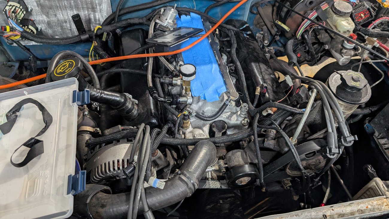

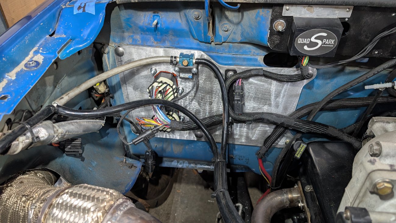

Anyways, all I've really done is the ECU swap. It is in, it's running, but the harness was just a work in progress. I put it all together properly and have been plugging along putting everything back together.
Transmission cooler is installed (I got lazy and used the radiator zip strips... I'll fix it when I upgrade the radiator), but the fuel pump and cell has not been installed, nor have I bothered with the cal-tracks yet.

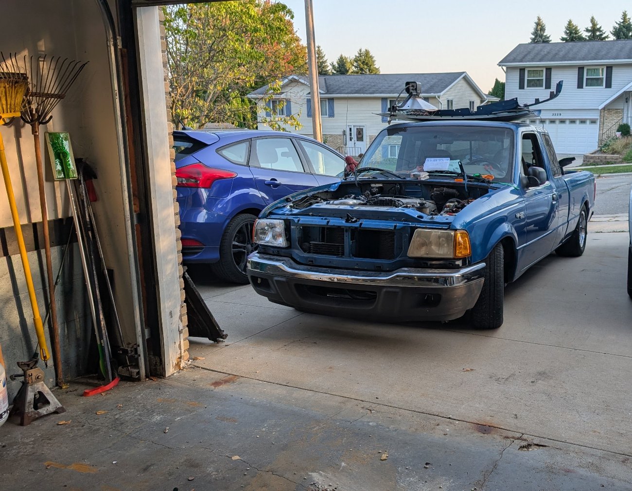

Its out of the garage! Little but of work before it's first test block left.
Test drive went well
For some reason I lost speedo and o/d cancel, not sure why as I didn't touch the trans wiring. Looks like project for future me
