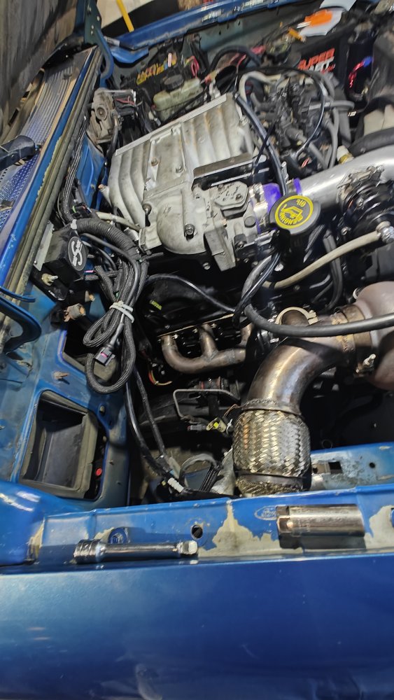

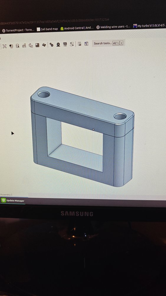

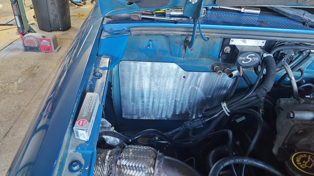

About this time, I got absolutely fed up with the hvac box.. I realized a while back that the ac wasn't going back in this thing, so, I ripped that mofo off a few days ago. I'm currently working on blocking all that off. 3d printing some mounts for things right now, like the Mac valve for the boost control and a big wire hanger for that mess of wires now dangling there.
On the bright side, with the hvac box out of the way, my bad tick was nothing more than a huge exhaust leak at #3.. I would have sworn my first born that there was no way, and it was definitely a mechanical tick.

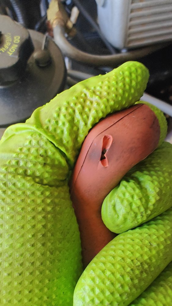

I bought Kevlar socks for my wires. They work good.
I have dei heat wrap stuff on them already, still burning through. Only thing that has worked well is ceramic boots. Still slowly deteriorates the inner silicone grommet though.
Maybe I should try a different heat wrap though.

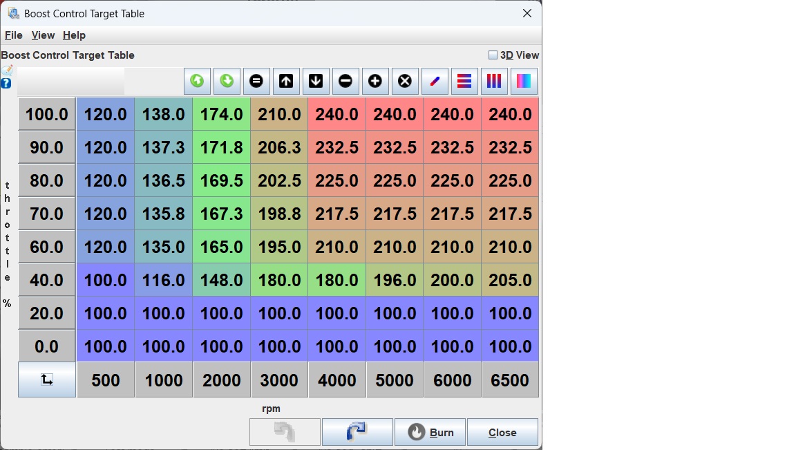

and i don't put 20psi to it at 3k rpm, it ramps in.. I'm not smert, but I ain't dumb lol. I'll post my boost control table next time i get a chance. heck i can post whatever anybody wants to see.
it's whatever it is at 200k miles, lol. didn't do anything to the short block... well, i needle scaled off the rust and painted it.
impressed. you dont have the common 200000 outof 205000 great engine..... you have the super awesome 200000 out of 400000 engine....
Boost target map.
so that's only ~16psi at 3k.... It doesn't spool quite that quick though. Especially without a trans brake.
