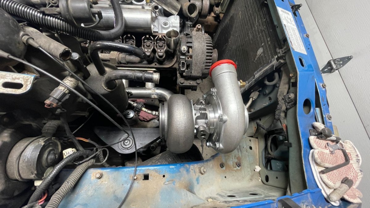

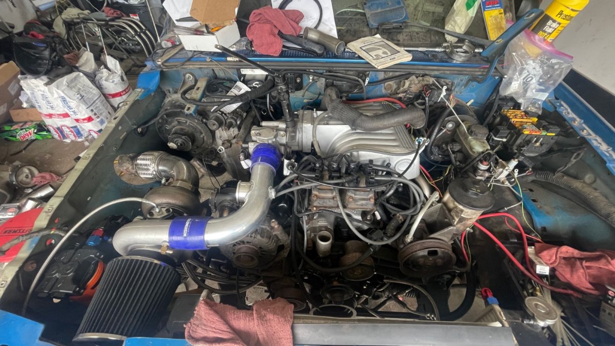

I got the 5.0L installed using Rickz plates. Then, I started mocking up the turbo, and that's where it stalled for 5 years. I didn't realize how much it was going to absolutely SUCK to deal with the hotside. About a year ago, I finally got the bug in me after years of looking at it in the garage that whole time, so I said F it, and just started doing things. Right or wrong, at least it was progress. After the initial hesitation, I ended up actually having fun making the headers. Yes, they're ugly, no, they're not perfect. Yes, they work great!

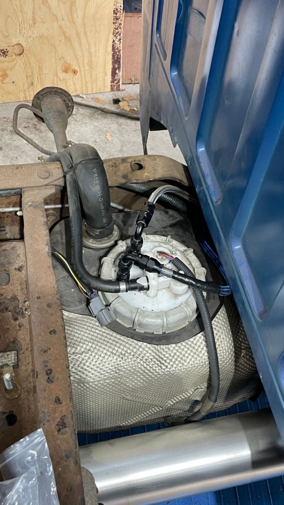

Fuel system is:
-aeromotive stealth 340lph pump in the stock module
-aeromotive #12345 10 micron post filter, for e85
-(dash)6 PTFE lines from the tank to the engine
-sn95 fuel rails
- 202? GT500 62# fuel injectors
-ethanol sensor
-10GA power wire to the module
-new upgrade for this year is a Kirban FPR

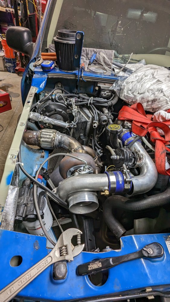

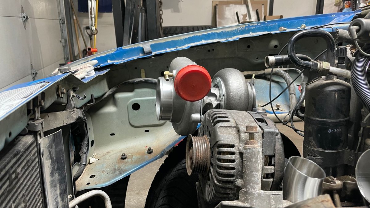

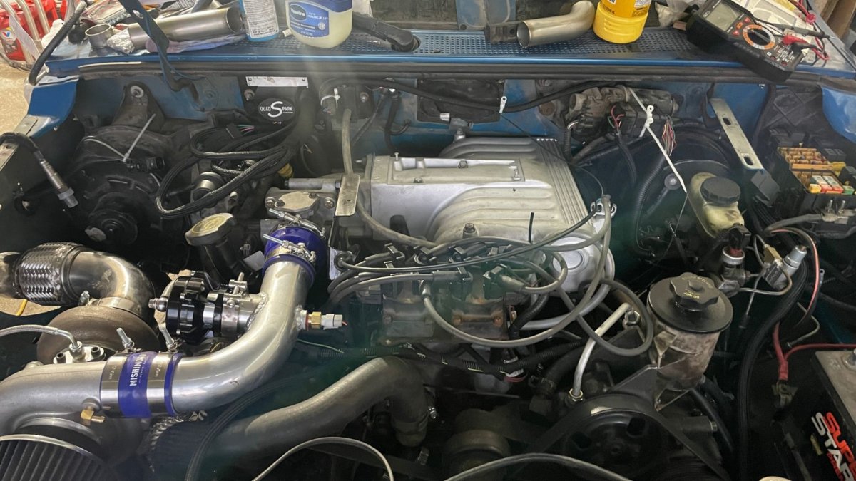

Turbo is a chinese job. Rev9 t72/68. T4 flange. If (when) I destroy it, they're $300. NBD. I hurt it within a couple days of having the truck running, so I say good call. Pro tip, if you see anyone say to run a restrictor with a journal bearing turbo, DON'T! After some consulting, I was told to put all the oil to it, and if it's not leaking, run it! So I did, it doesn't leak and it hasn't crashed yet. It's got a 3/16" feed now.
VSR blow off and wastegate.

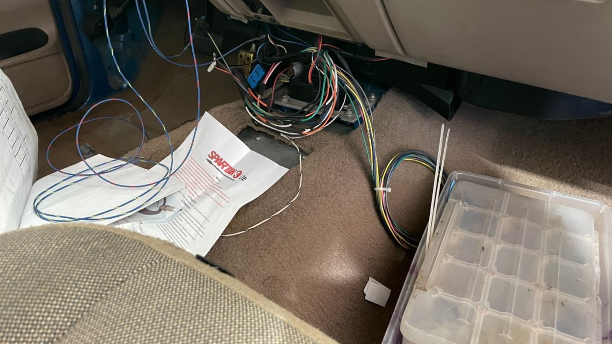

Electronics are
-microsquirt (megasquirt, basically a condensed MS2)
-quadspark
-batch fire, wasted spark
-Ford EDIS coils
-Mac 3-port valve for boost control
-14Point7 Spartan3 lite wideband
Trans
-microsquirt again, linked to engine management via CAN.

I'm running this exclusively on pump E85, which is why I haven't put in an intercooler. And I kind of went e85 because I didn't want to put one in anyways.

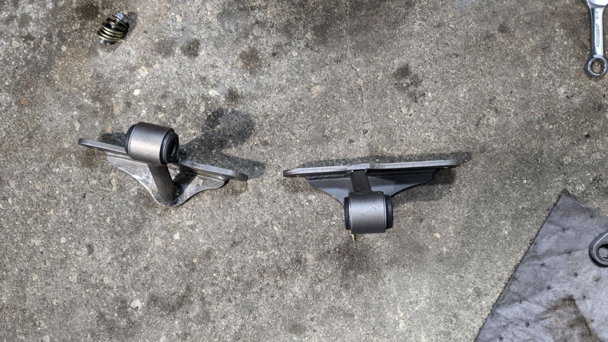

-Ranger motor mounts do not like this at all, WAY too much engine movement

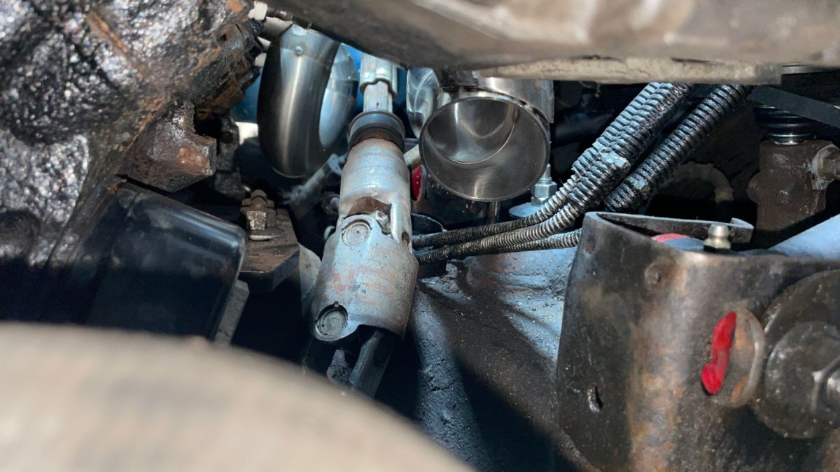

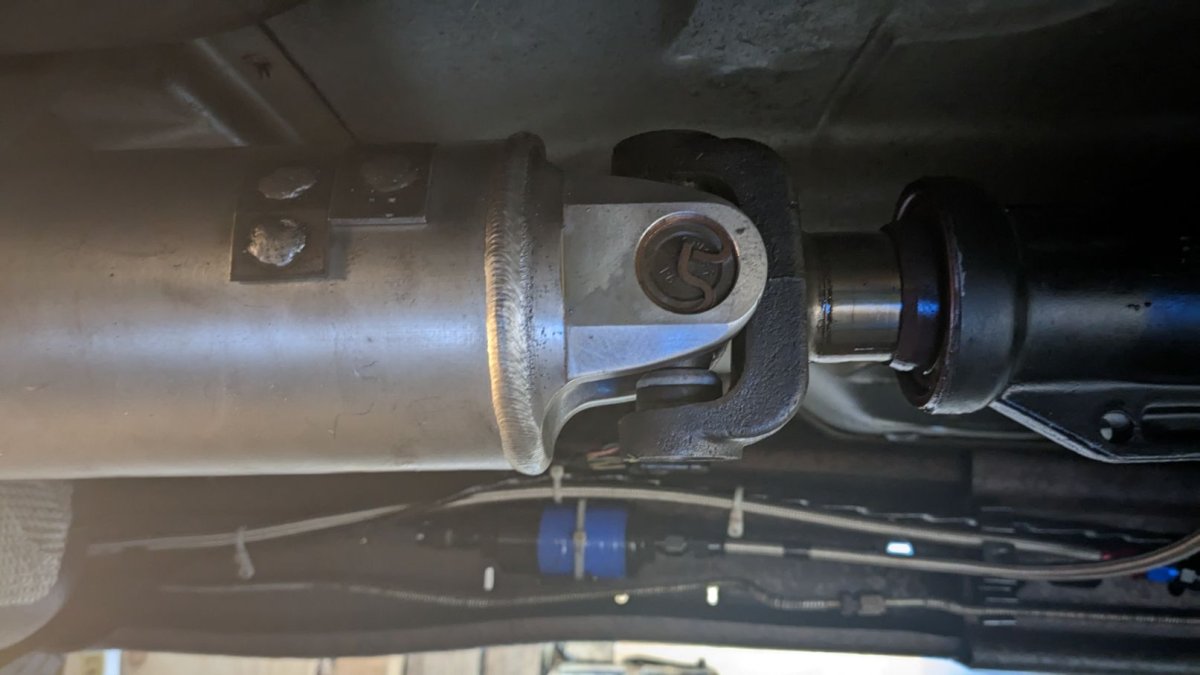

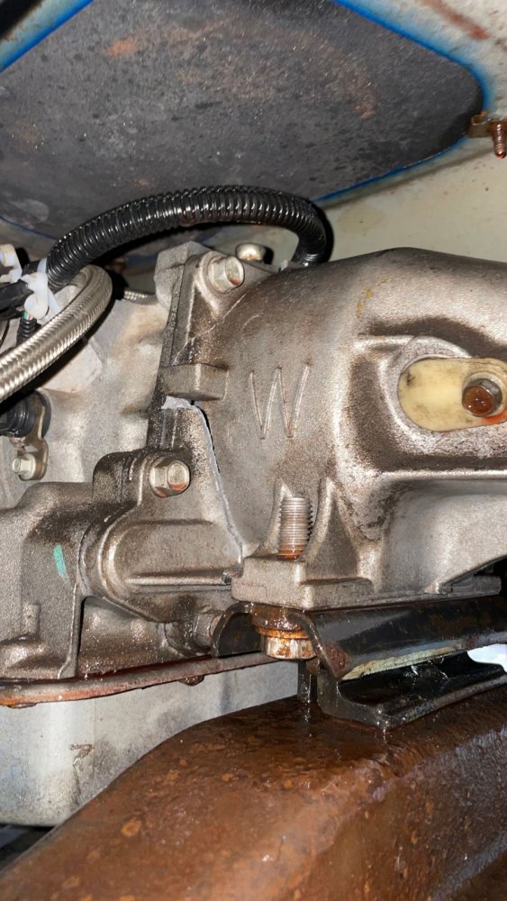

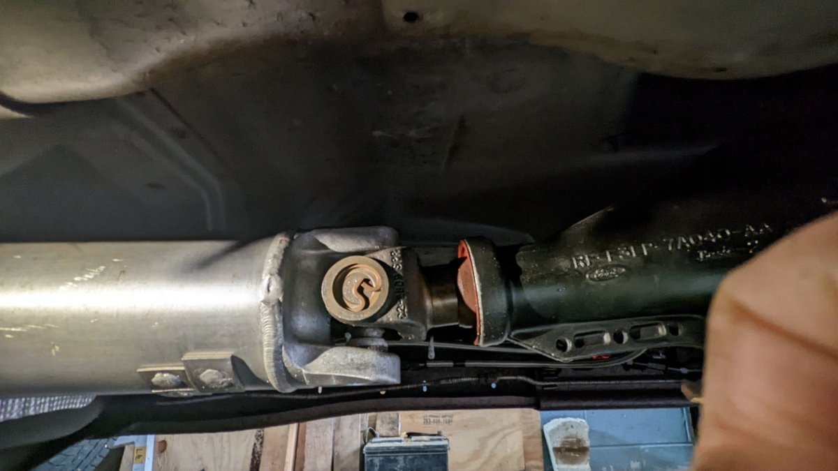

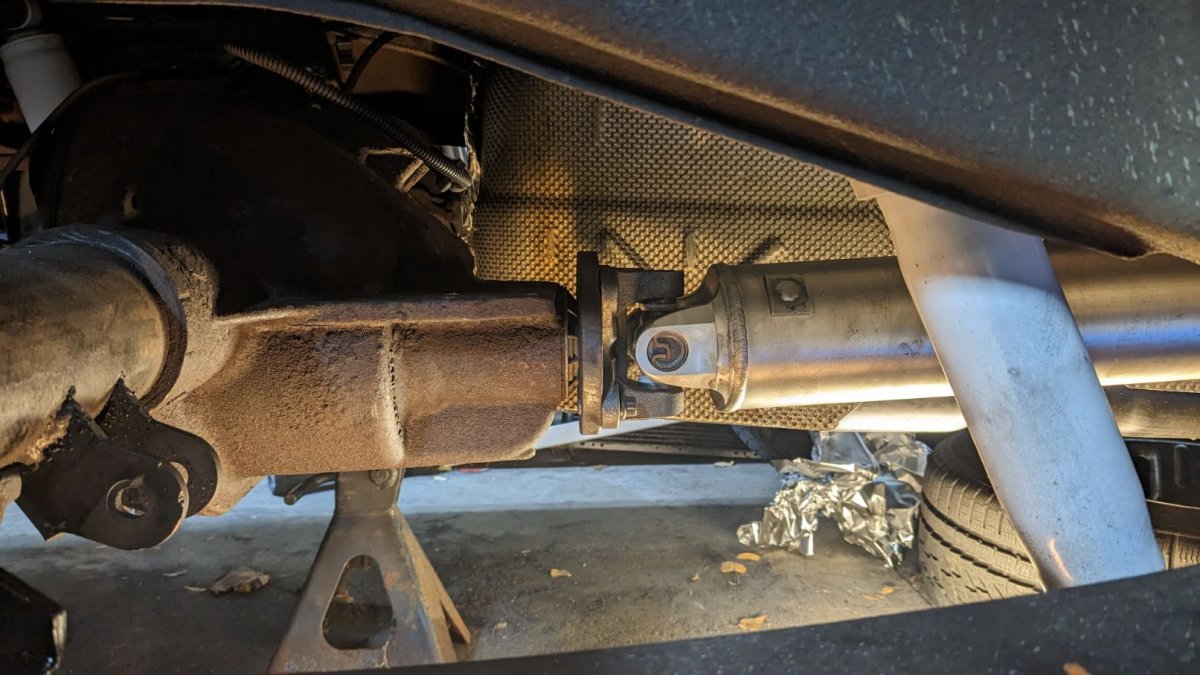

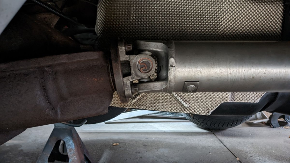

-driveline angles were GARBAGE. I broke the tailhousing off the trans once. I just didn't notice it in the mad dash to get it running.

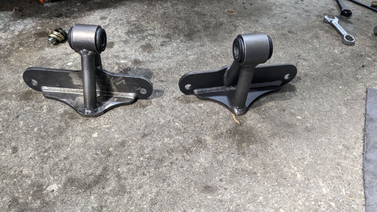

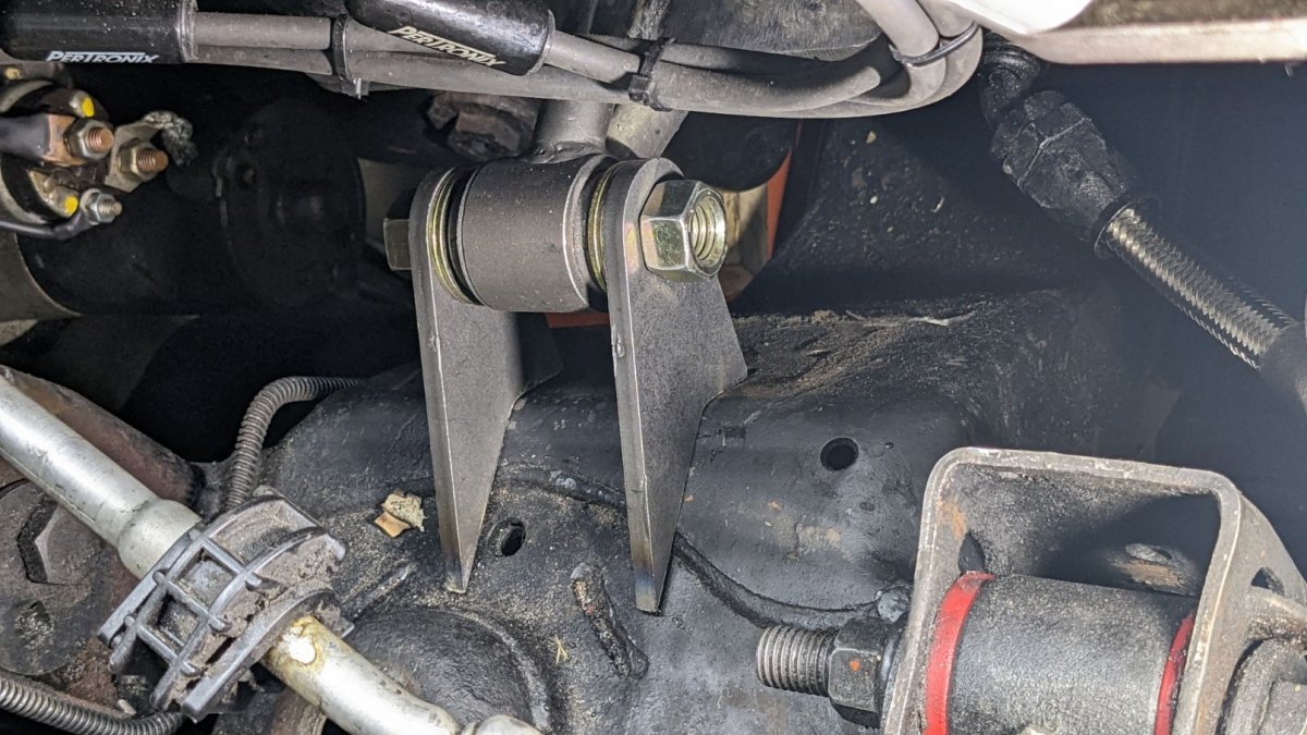

-removed the stock motor mounts and made custom mounts (poly)
-cut off the spring perches and welded on new ones to fix pinion angle
-this weekend i am making the new trans mount (poly)

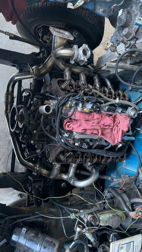

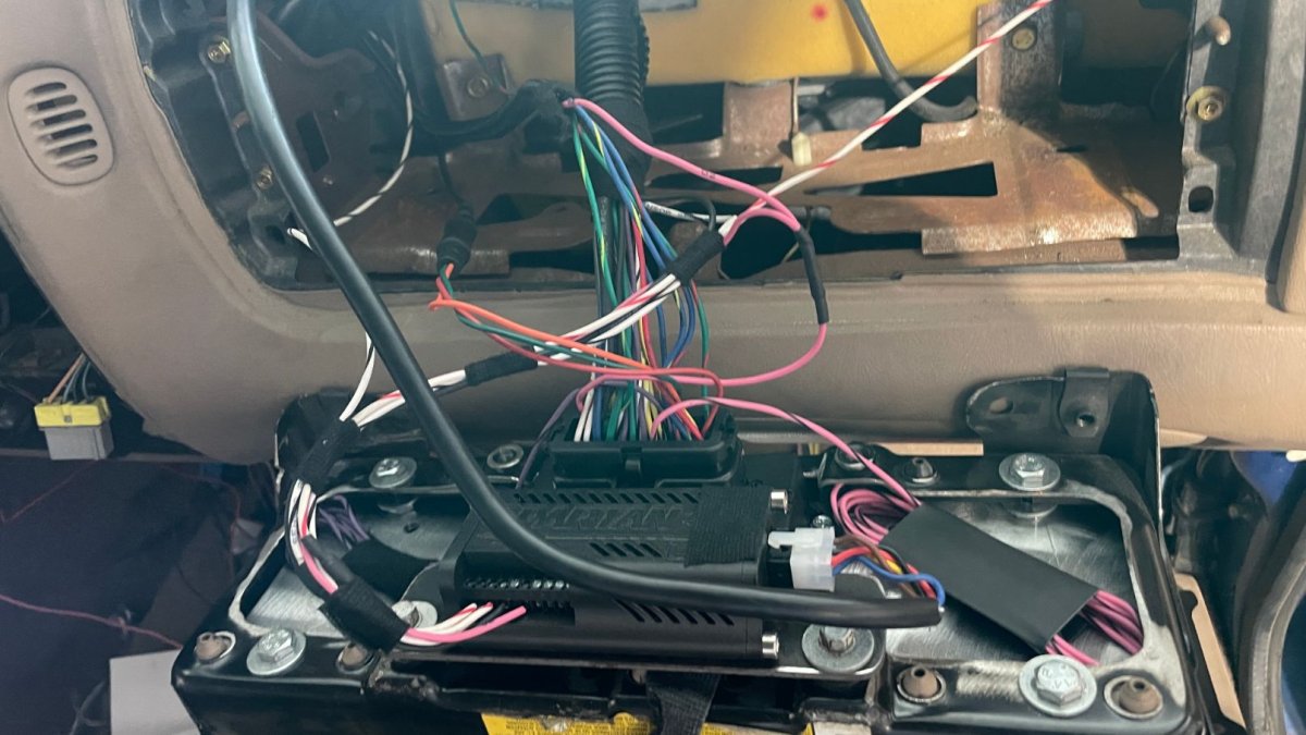

Couple more things:
-ABS deleted
-Airbags deleted
-engine microsquirt in the airbag hole in the dash
-trans microsquirt under the cupholders
I very much need to yank this apart and clean. There's no body rust but there is a good amount of surface rust on the frame. I do intend of cleaning/coating it. All of the engine AL stuff needs serious attention as well (those came out of a northern IL vehicle).

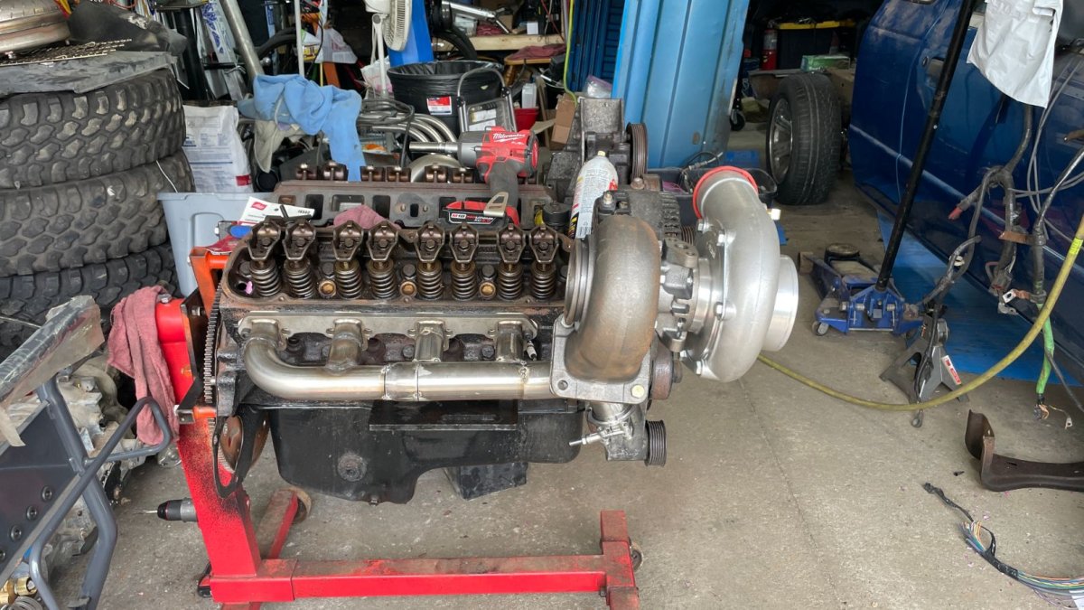

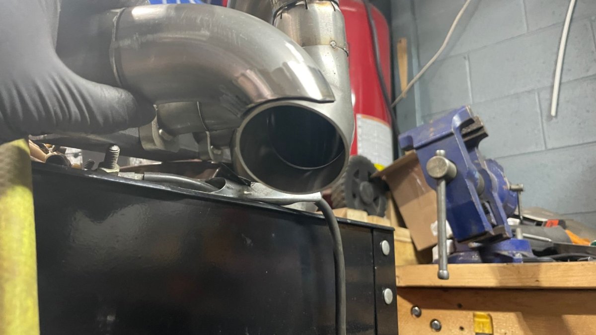

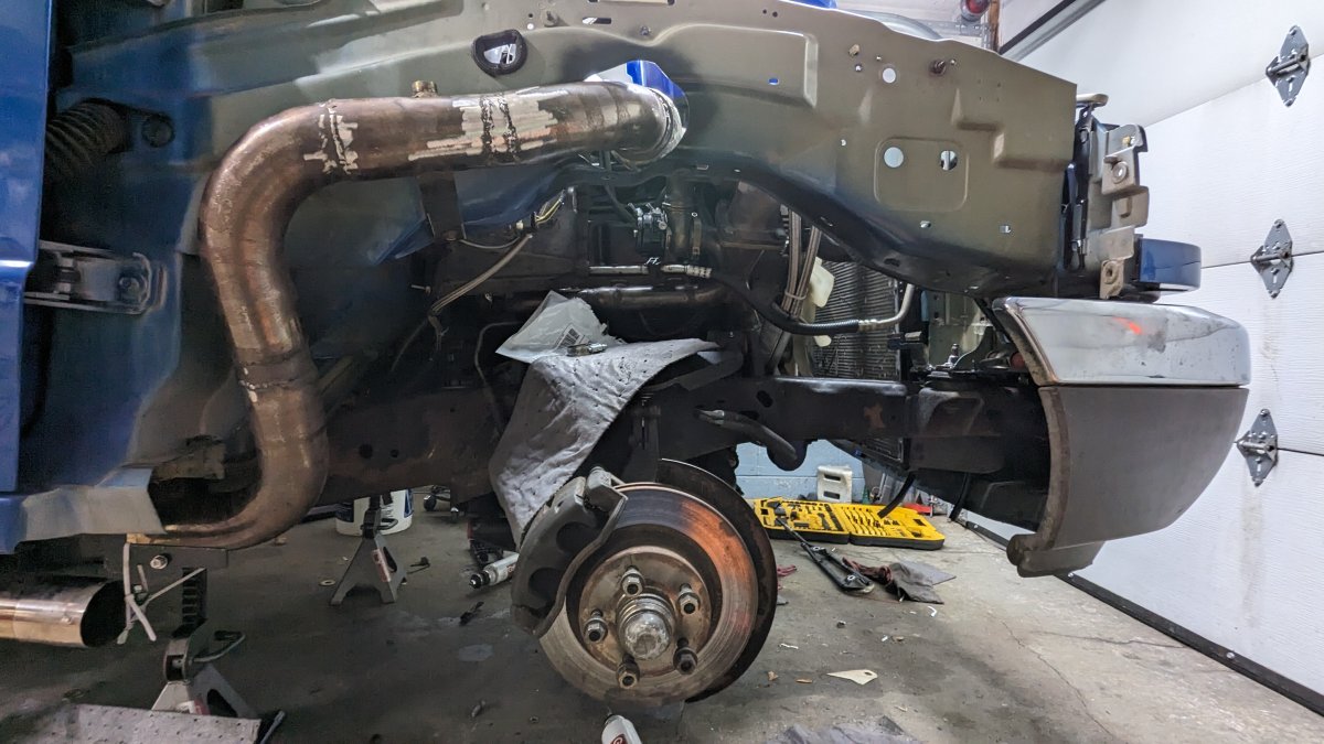

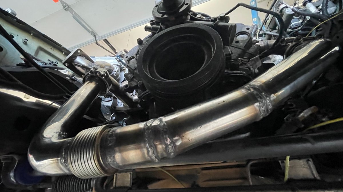

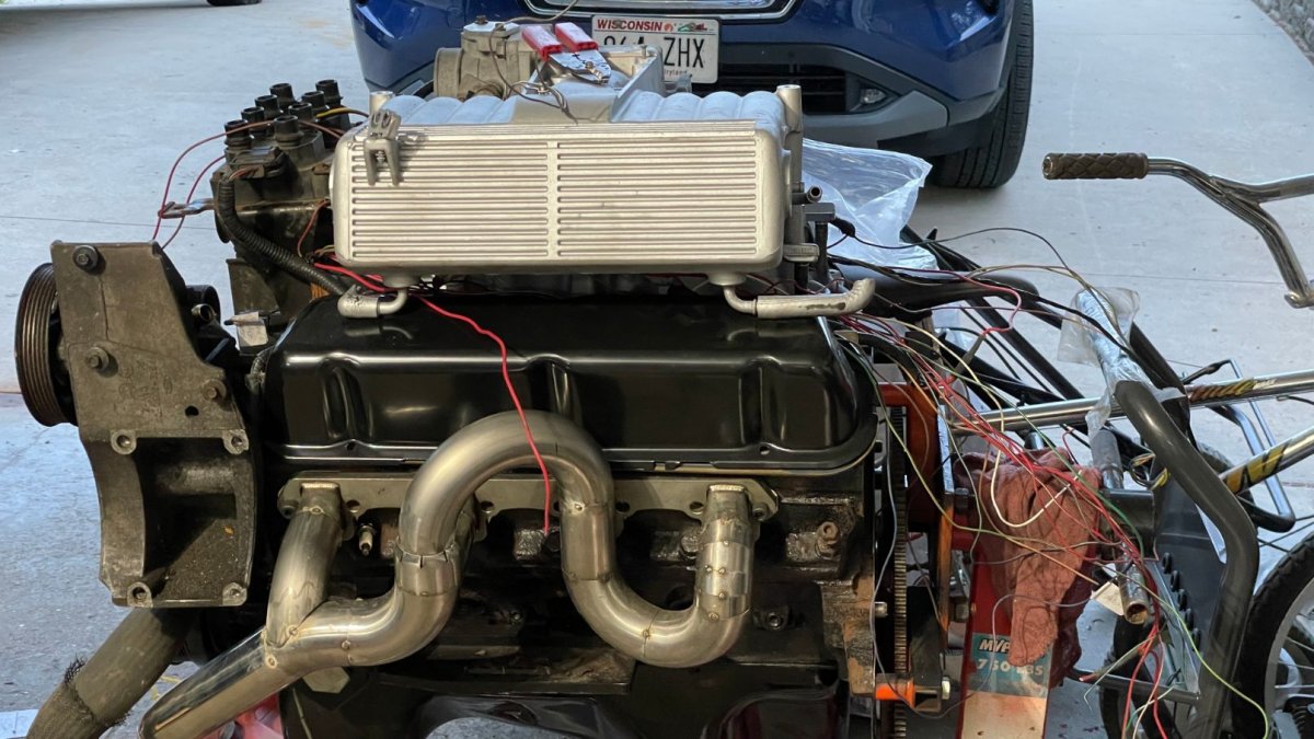

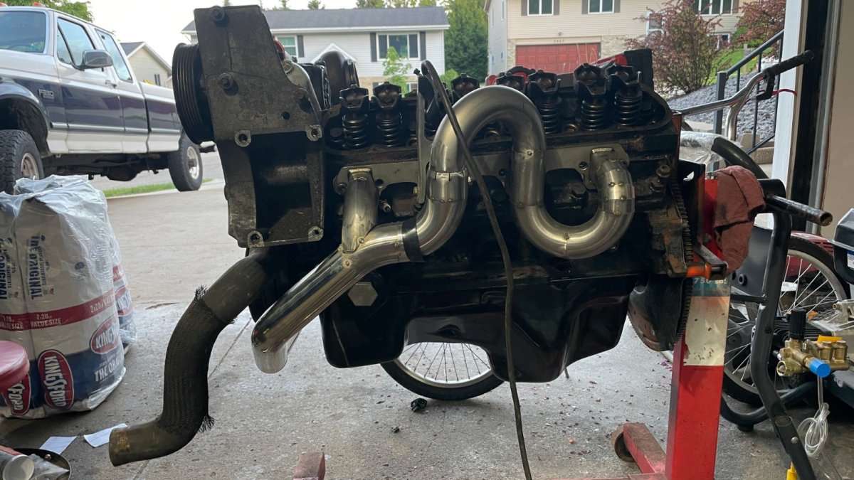

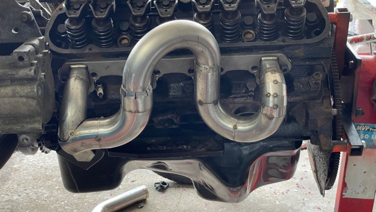

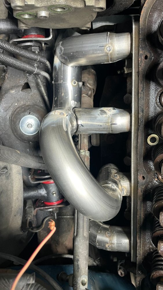

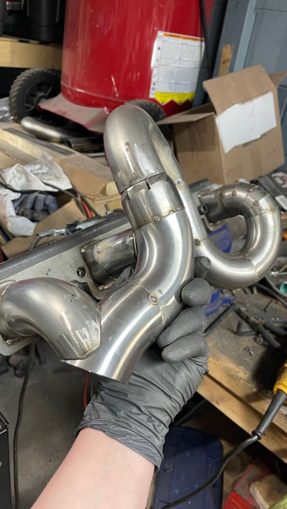

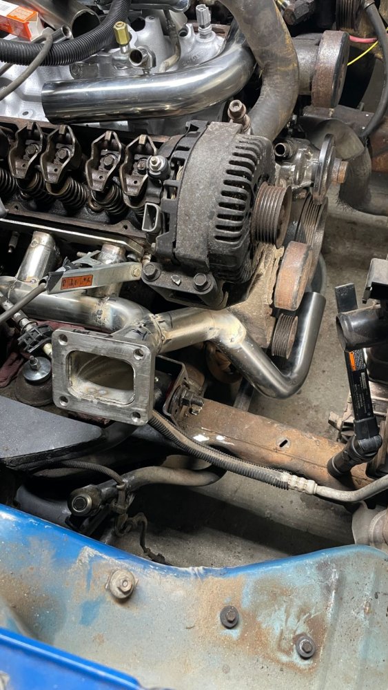

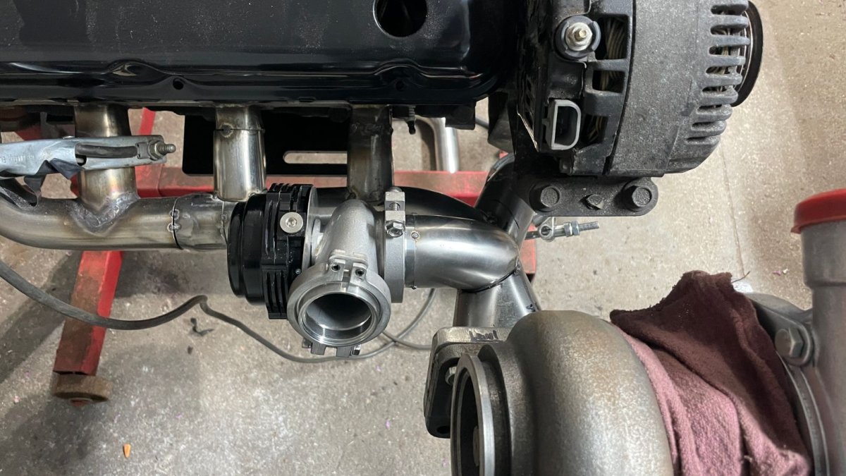

Headers started out as the SBF "Patriot" turbo headers, forward and down I believe. it was the cheapest way to get SS header flanges with pre-welded stub outs. I really didn't want to hassle with that part. Otherwise the headers are all SS, 1 3/4" stepped to 2", the crossover is 2" as well. That steering shaft is a serious MOFO to work around. Is there a better/cleaner way to do it? Probably. This is the way I did it.
Yes, my welding sucks. Yes, that was done with a TIG. No, I can't say that I improved. If anything I got worse at the end. I don't have a TIG at home, so I had to take them to work. That was some of the problems, not being able to do this in steps and stuff. I spent 10hrs straight welding these up at work.
The only thing I didn't weld myself was the blow off valve base. Try as I might (on scrap!) i couldn't do it without blasting holes everywhere. I paid a guy $40 to weld that part on for me, lol.

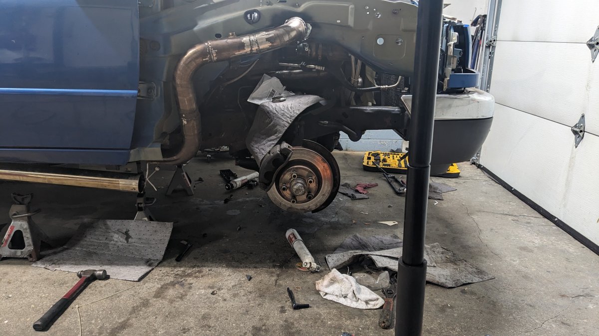

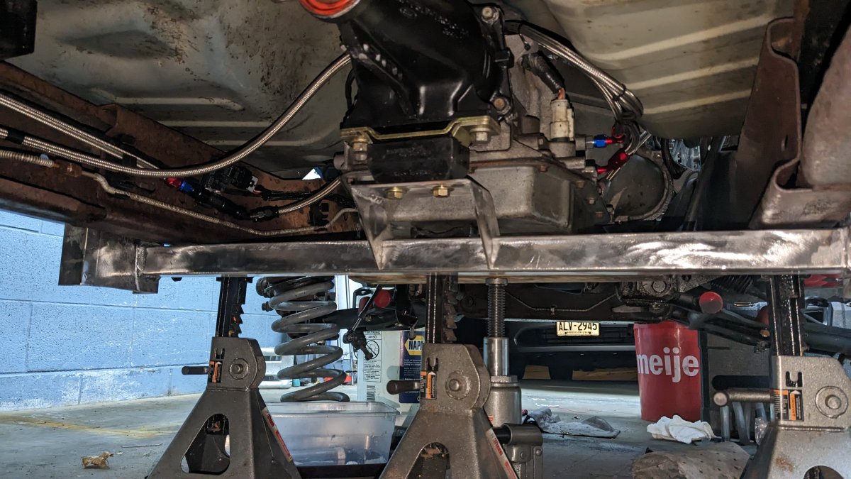

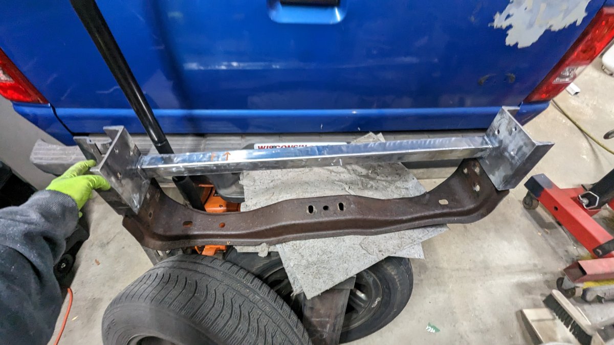

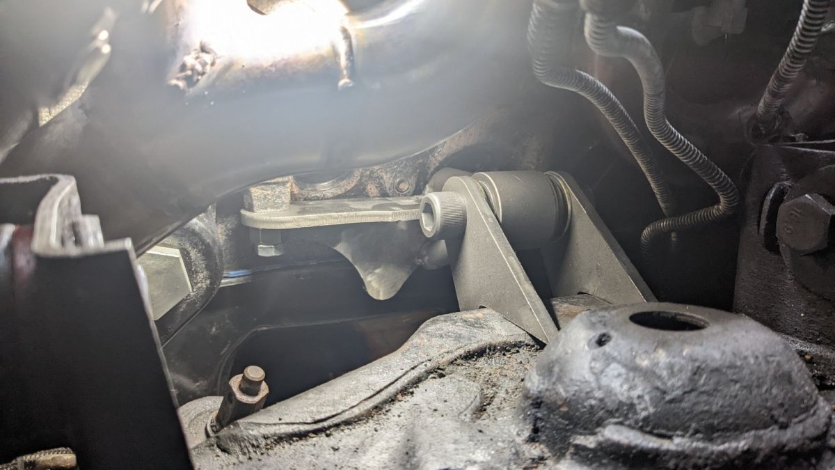

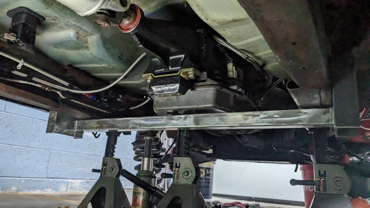

Getting to the trans mount. Done for the night, back at it tomorrow.
There's nowhere to buy steel locally. Didn't even think of it. So it's made out of whatever I have laying around. Obviously it's not done. I will cut down that c-channel, not going to leave it like that.
edit: everything on the chassis looks like garbage from when I broke the tailhousing. Everything is drenched in ATF. I was about 10 minutes from home (on the freeway) and drove it home that way. I don't know how it made it. The freeway offramp still bears the marks from my ATF lol.

Can you still drop the pan?
yo that is a bad ass build glad you decided to post it up finally
If I wanted to struggle with the bolts, yes. Otherwise not without dropping the crossmember.
All in all, not a huge hassle, as I can't get underneath it without it being in the air to begin with.
I am putting a drain plug in the pan still. I have to change the shift rod anyways, so the pan has to come off yet.

Quite a bit of it is on theturboforums as well. Between that sight and Richard Holdner on YT, they were the push I needed to just get things done. Richard's "turbo's dont really care, just get the exhaust to the turbo!" was a big help, lol.
And after reading your build thread, thanks for the compliment!
Yeap, restrictor pills are bad practice. Just need to make sure the drain is large enough and it's all good.
There's nothing wrong with the chingchong turbos either, especially for the price. Perhaps not the best choice for a daily driver... but for a racecar... they're fine.

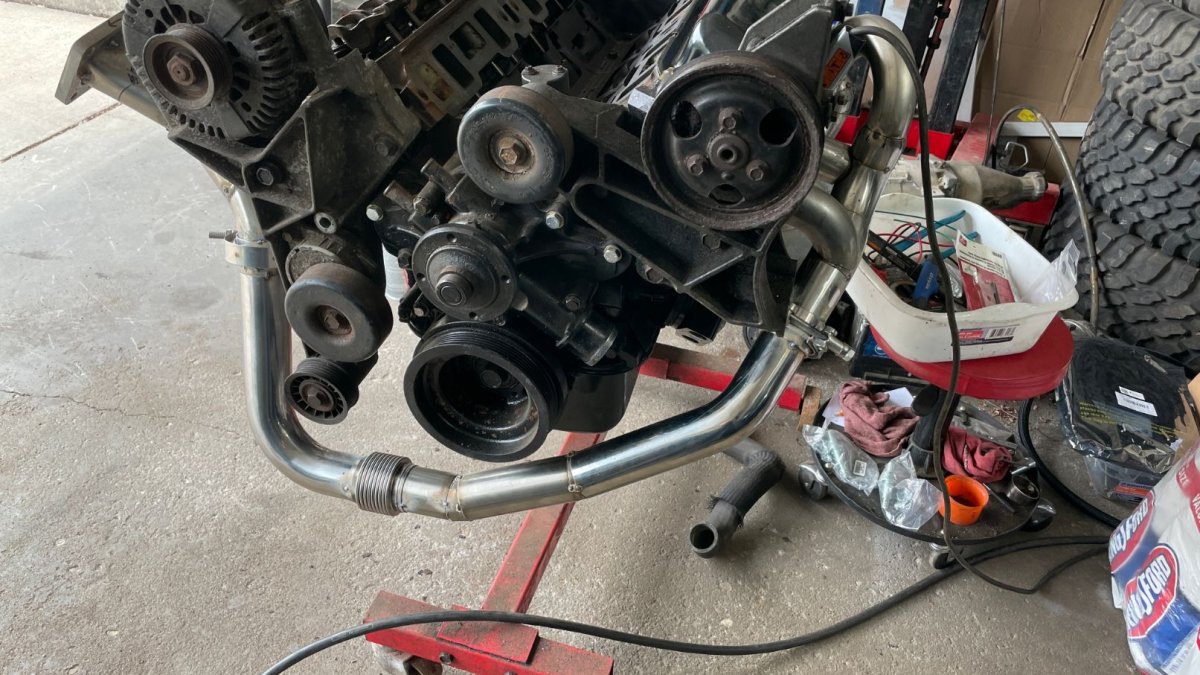

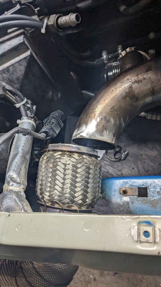

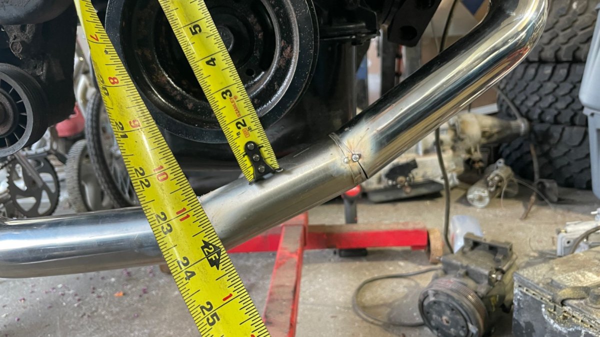

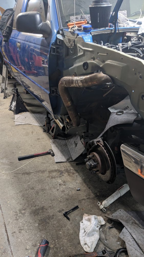

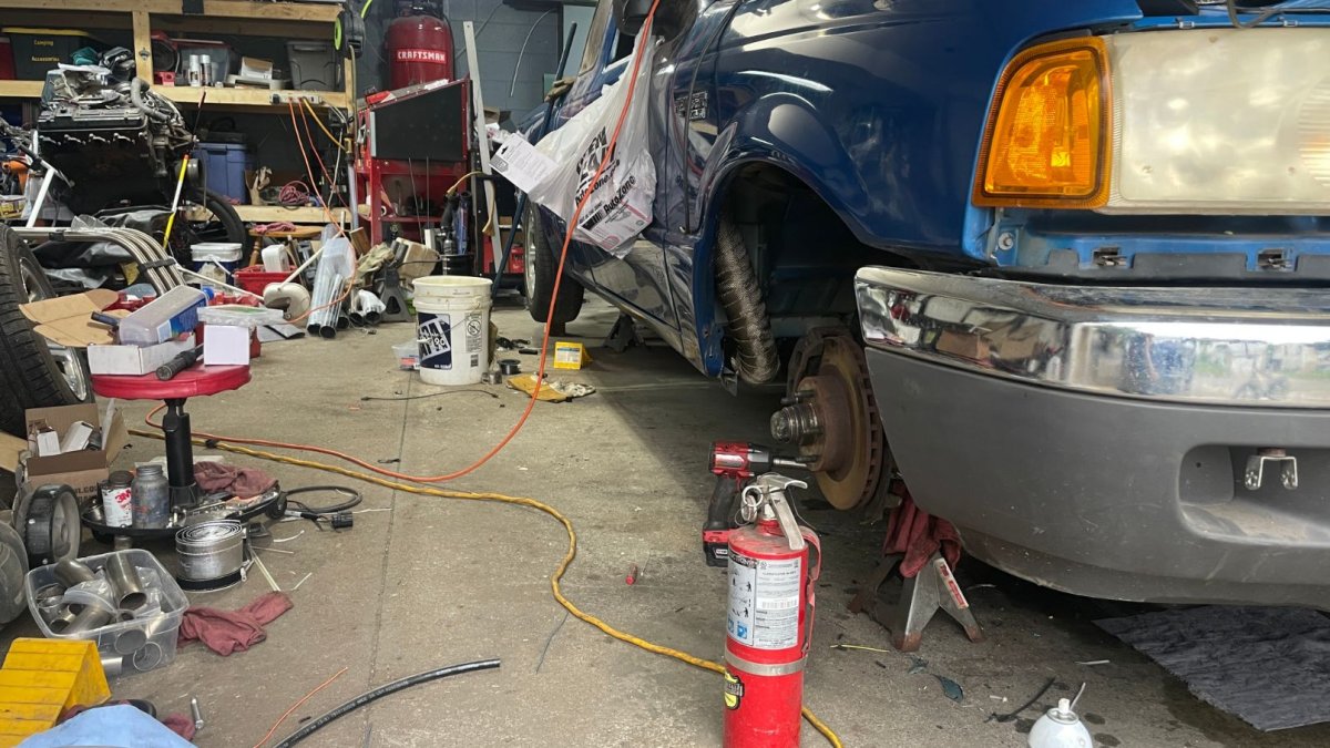

Put the exhaust back together. Engine moved a lot with the new mounts.
If you make fun of my welding I'll... I don't know. I'm booger blasting with a flux core 140 Lincoln.
