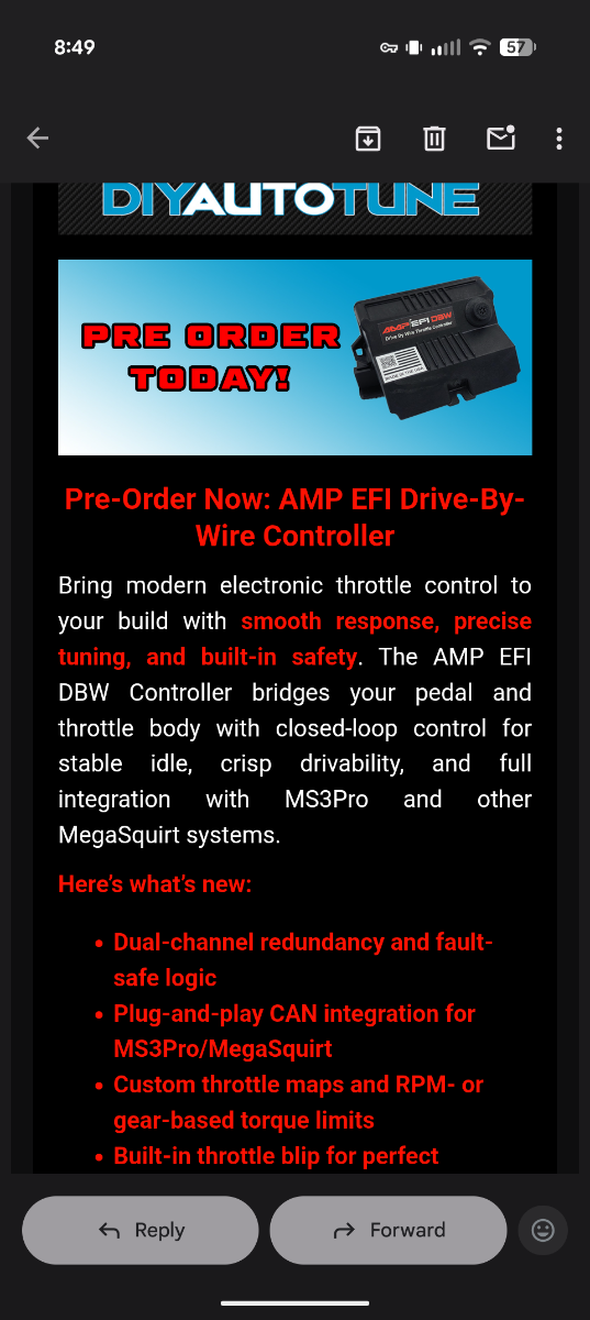

Megasquirt has some drawbacks, but it's under new ownership and it seems like they're trying to catch back up. A bunch of new products they were missing just came out. Dunno if they'll ever directly support dbw or direct injection, not a big deal for me as I don't want either of them.
Welp I was wrong, they just released their own dbw controller. They've always been very against it due to the liability.

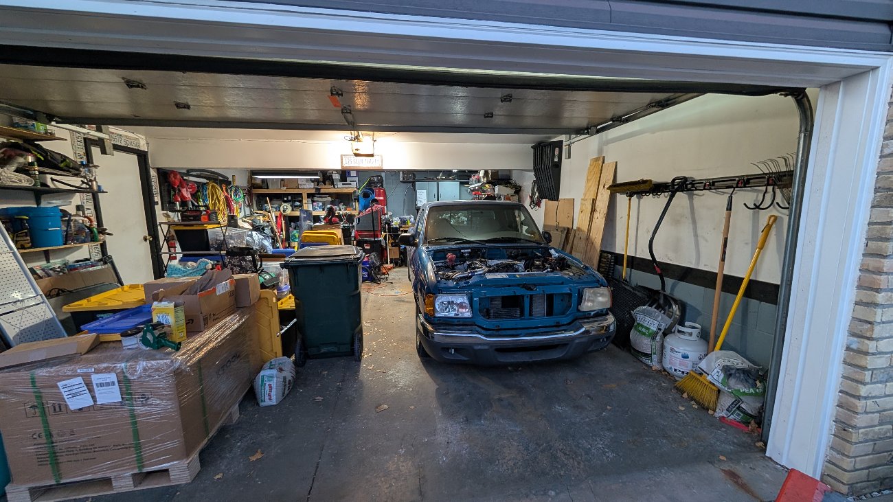

Got the ranger out of the garage the other day, since the cold it coming in. Really needed to burn out that year old e85. I did disable the boost controller, it's on gate only which is 8-9psi. Still ran pretty darn well!
Sorry it's a short, don't know how to fix that or if I even can. But good Lord I could listen to that noise forever.
Edit: just noticed that it actually shifted 1-2 right near the beginning of that vid, most of the wheel spin was in 2nd.
Anyways, hard parked for the winter. Fuel system and cal tracks this winter.

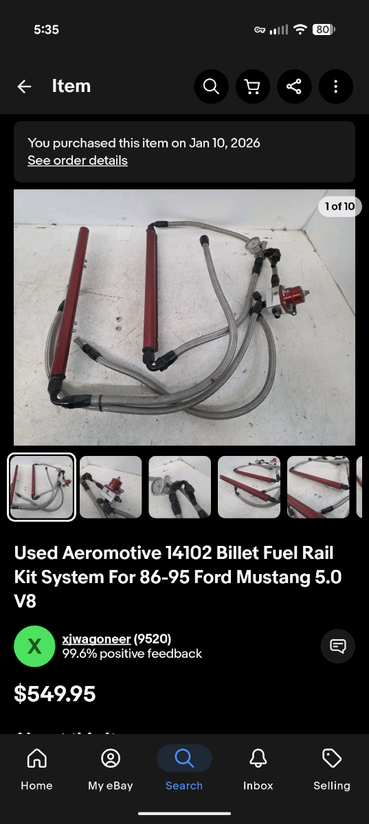

Well, got a little side tracked and spent too much on the fancy injector rails:
Found a used set on eBay, they want ~$1200+ for these new. A lot of the options that used to exist... Don't anymore. Some really really cheap options though. These are nice because they're the only ones left that are ORB, and are -8. Everything else I could thats still available are NPT 3/8ths. I don't need -8 on these, they come with -8 to -6 fittings which is what I'm running now. But it's nice to have the room to grow if I need to.

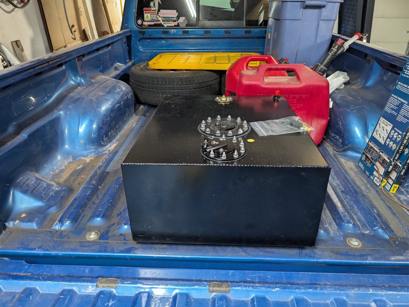

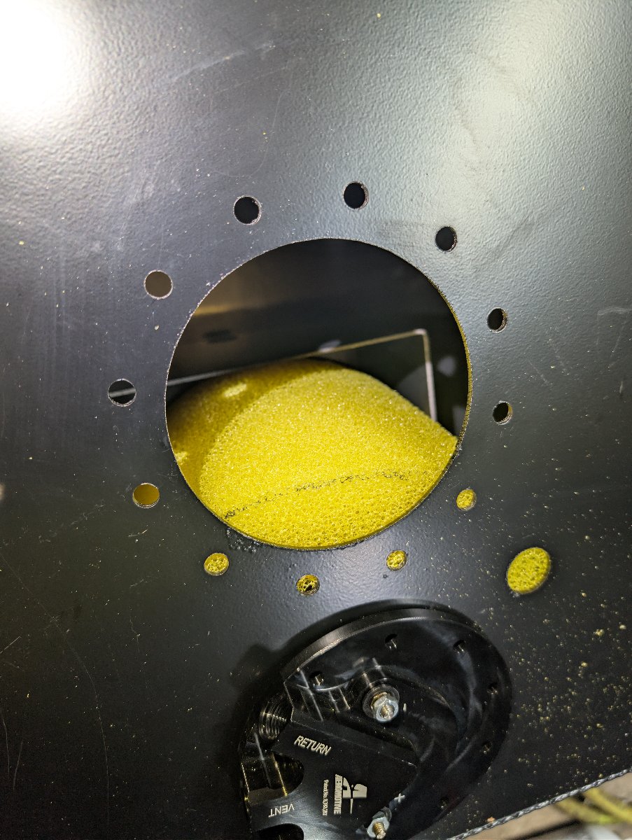

Now for the questions: wtf do I do with the vent/rollover valve? Front the port is vent/rollover. I'd read lot of things saying that needs to be x amount of inches above the tank. Still looking into that. Seems like it'd be in danger of being easily broken off.
Am I good to set this right on the ribs of the bed? Should I put like a AL sheet down first? I plan on adding a couple straps right over the top.
I would put some rubber under it fir cushion/silencing. An old big mud flap or find a friend who does industrial maintenance and get some used conveyor belt material.
That or a floor mat, chunk of tire innertube, carpet...
As for the vent I'm not sure, if the cap is vented (most are, 2psi and some amount of vacuum) then you shouldn't have to worry about it but you could also stick a hose to it and loop up to the top of the bed through the stake pocket hole and down a few inches, should work fine.
The cap does appear to be vented also.
I'll find something to put under the cell... I'm actually in industrial maintenance myself. At first I was thinking of making an aluminum kind of shell with a bottom and side plates, but not looking at spending that much right now.

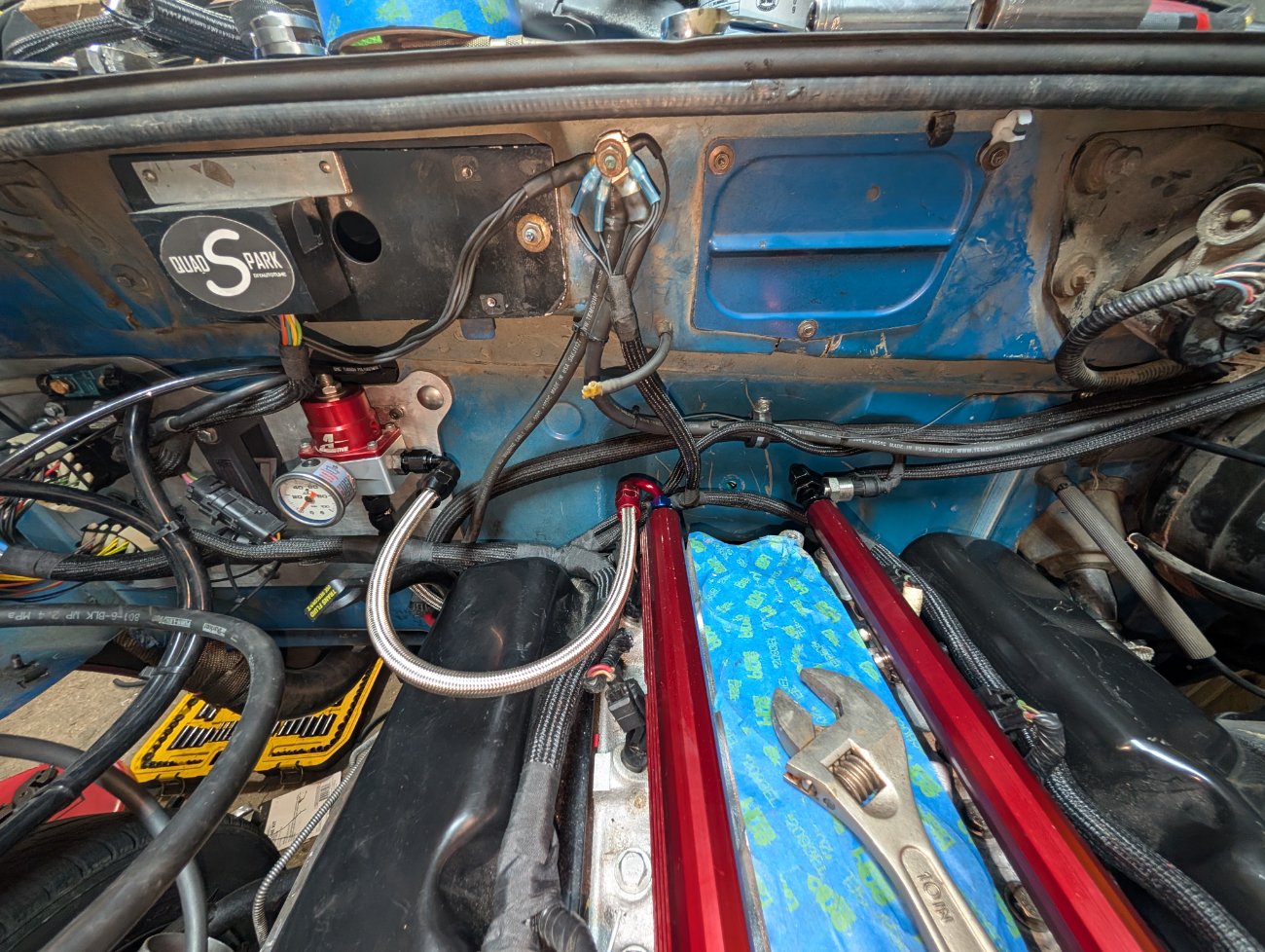

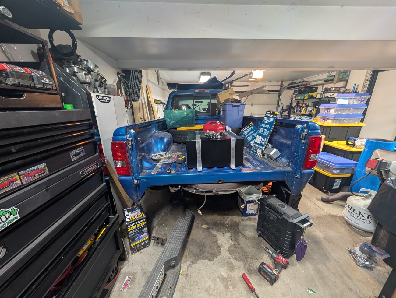

Slowly plugging away. Gas tank out, injector rails installed, regulator installed, front half of the truck plumbed
Still need to figure out how I'm mounting the cell, and run the 2 lines + electrical back to the cell. I grabbed a bunch of 1/8” x 1.5" aluminum bars, probably going to make some straps out of it.

Ah crap. I just learned if I ever go to any kind of sanctioned event that I can't have the fuel pressure regulator mounted to the firewall, has to be min 6" in front of the flywheel. Nevermind apparently that the fittings on the injector rails hang out over the flywheel area anyways.
So I really should redo all that. Awesome. And need to find a way to protect the lines as they pass across that area.
Never manage to figure this stuff out beforehand for some reason.
