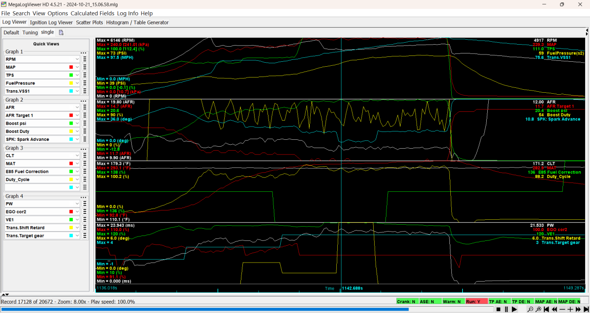

Slowly chipping away, my best 1/8th yet... But then look at the log. I just can't get out of the hole! Spinning from 40-60mph at only 55-60% tps and 12-14psi... There is a LOT of time left on the table here. I also cleaned up my timing table and was down ~2 degrees across the board (plus I forgot about my rather aggressive 6 degree shift retard), and the trans short shifted due to the low TPS.

at mid where is the timing....below 16 deg? i cant see a scale for it. you would think 15 psi 10 deg would be helping with the tires.....16 should be on target for max power at 20 psi though and be pretty safe.
If you had more traction, you’d have more load, which might result in 💥

I think I've got load under control, it hooks up and takes all of it sometimes.
I don't know that it would survive a 1/4 mile run though just due to my iat's..

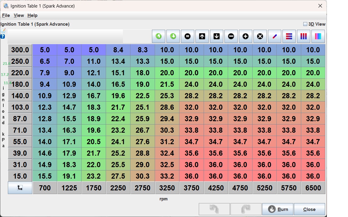

I'll post up my timing chart. I think I was drunk the last time I played with and and just went back and made it a lot safer, but some of my tweaks got lost in the mix. It sure ran good though! Mostly I'm just running n/a timing until 6psi or so, then pulling. Before the posted log I was at 19° at the same 20psi boost. Now it's about 17, sans shift retards.
I'm not pulling anything for IAT/clt.
Current table. Nothing fancy. I noted kPa to psi in green on the left.
Low RPM is a lot soft (it doesn't spend any real down low besides idling, cruising speed it around 3k currently) . I haven't put much effort into perfecting it.
This map makes it run very happy. 20psi gives me 17.5*.
