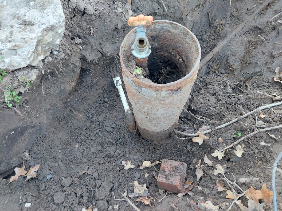

I found a check valve on the 3/8" line that goes to the shop where it connects to the 3/4" line. You can see the 3/4" check valve in the libe right before all if this. Do I really need to have a check valve on this line going to the shop if I plan to replace it with a manual valve?
I would say no on the check valve but I'm also not a professional plumber.
Almost looks more like a regular valve with the handle missing. But, to answer your question, no. You don't need a check valve there. I would tee off the main and install a shutoff valve to the shop, tee off the main for the yard spigot, if you still want it.then install a shutoff valve going to the house. That way you can shut off the shop and still have water to the house and you can shut off the house and still have water to the shop.

That 3/8" check valve was burried inside the bottom of that metal casing.
You can see I have two green valve boxes. The first one will have the check valve and then a T with a valve headed to the shop. The second one will have a T with the 45 degree fitting to connect to the white PEX line I already replaced going to the house, and then at the other end of the T will be a valve that goes to a spigot 4-5 feet past that. You can see where I dug out past the old spigot for the new one.
