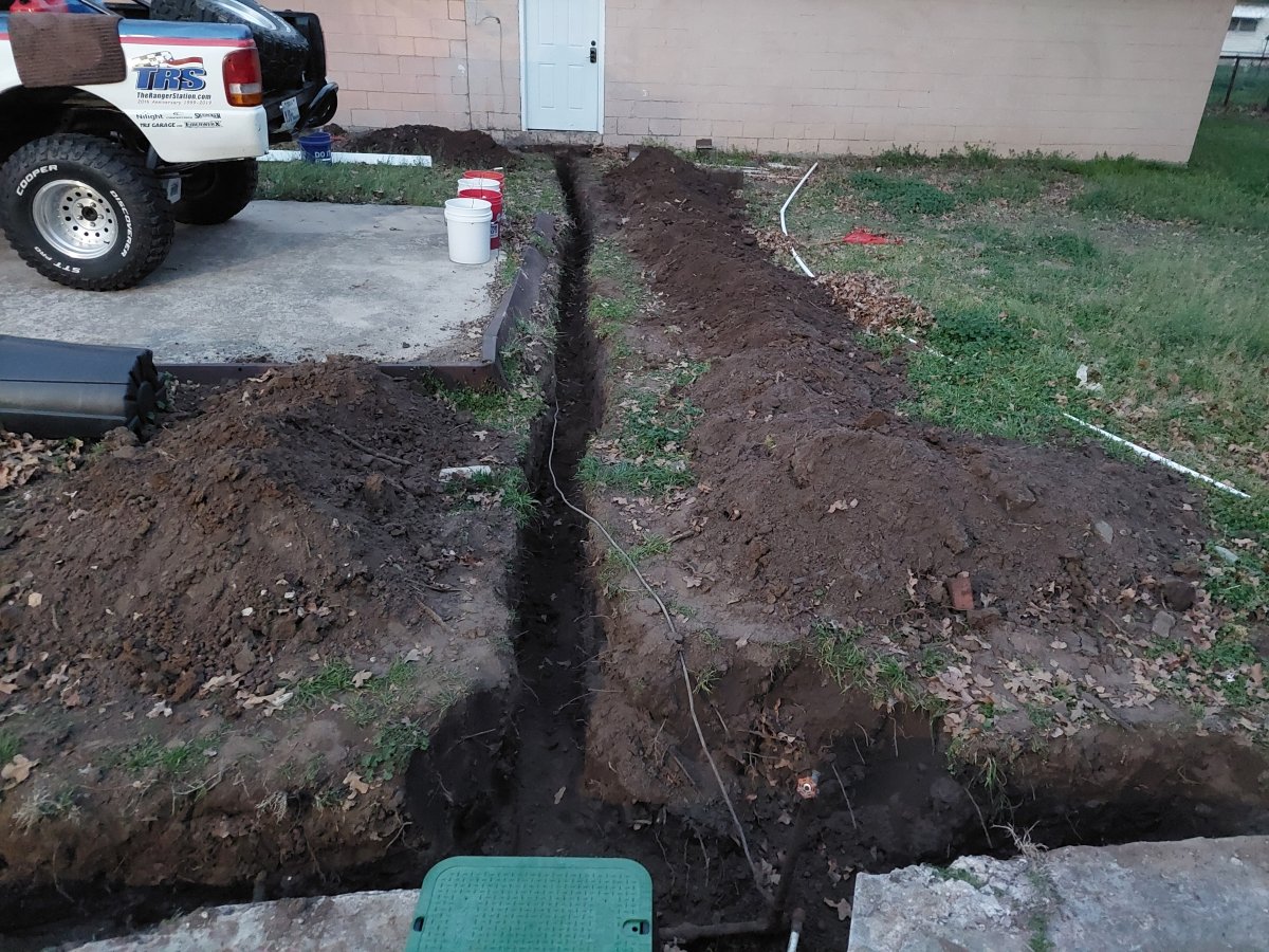

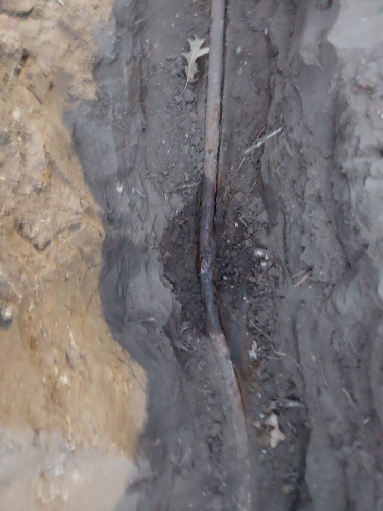

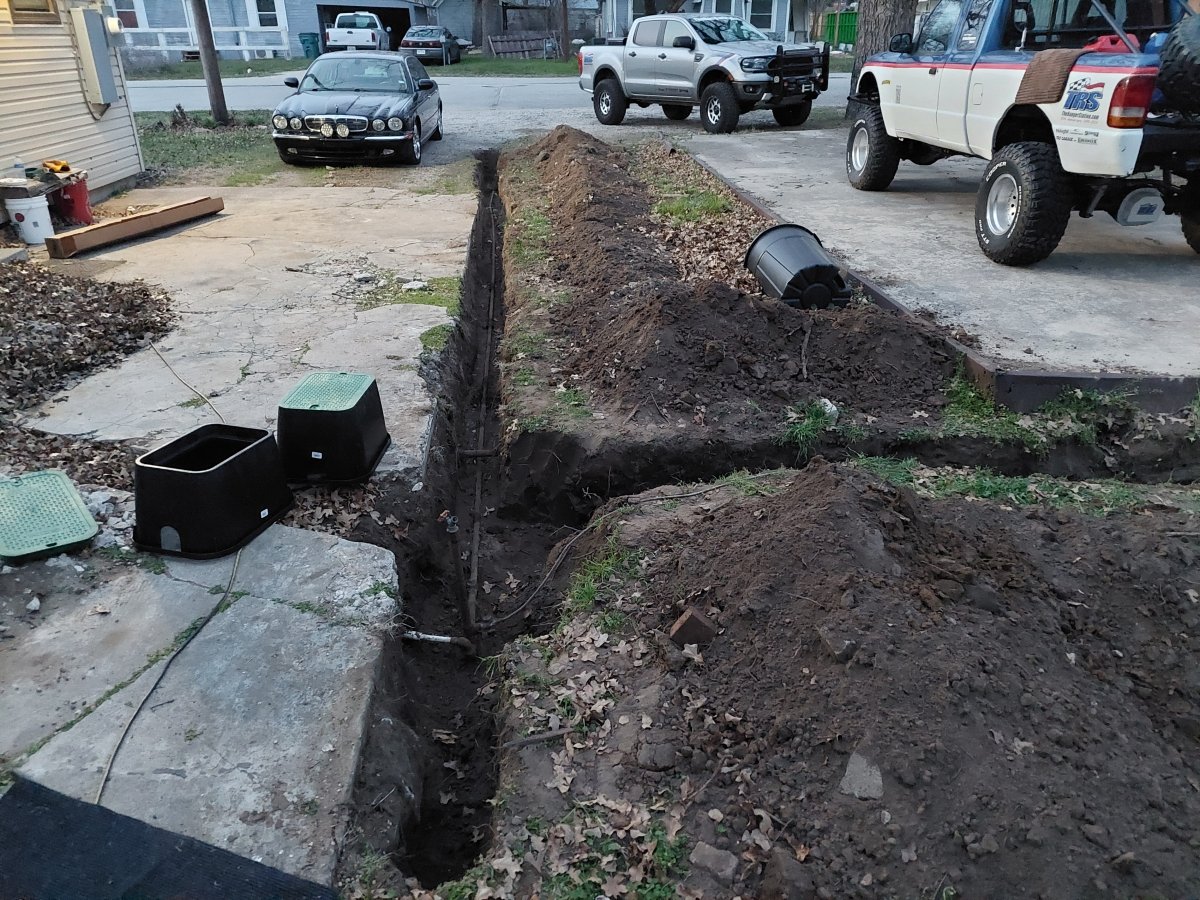

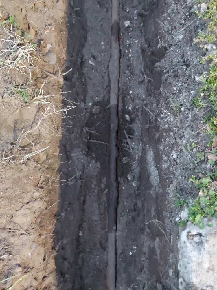

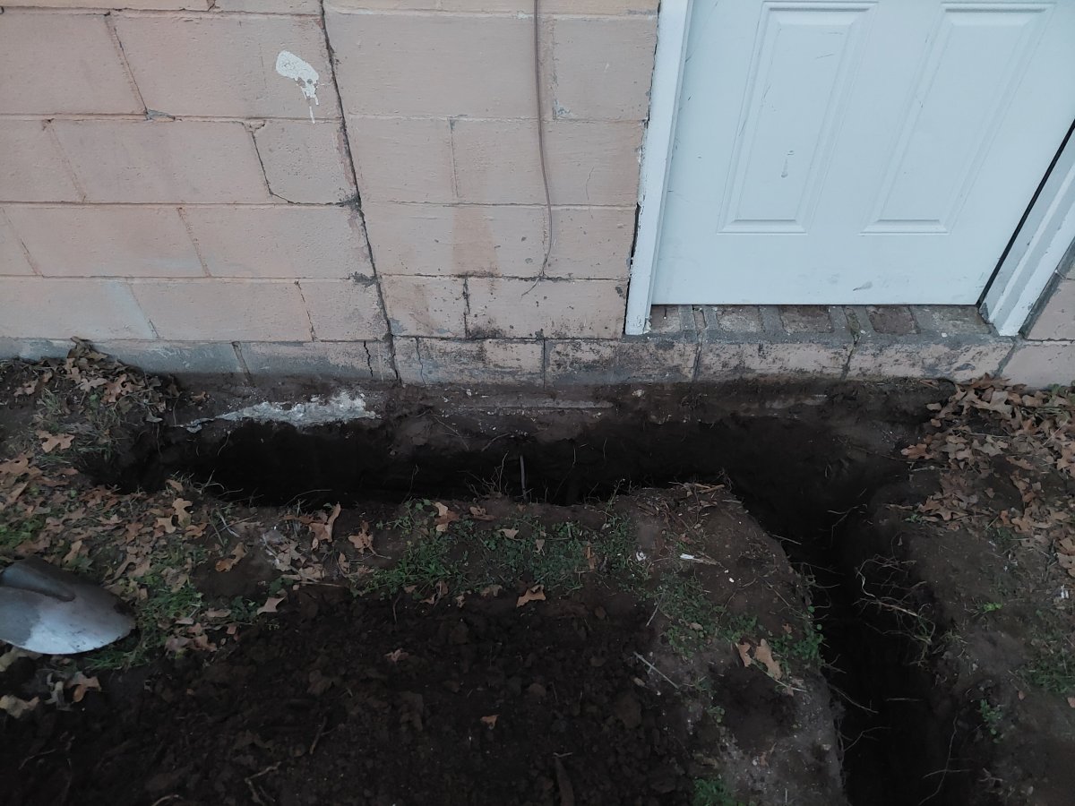

I finally finished digging out 75 feet of trench 20 inches deep.
I found (4) places in the old line where it's starting to leak.
Tomorrow I'll start installing the new waterline.

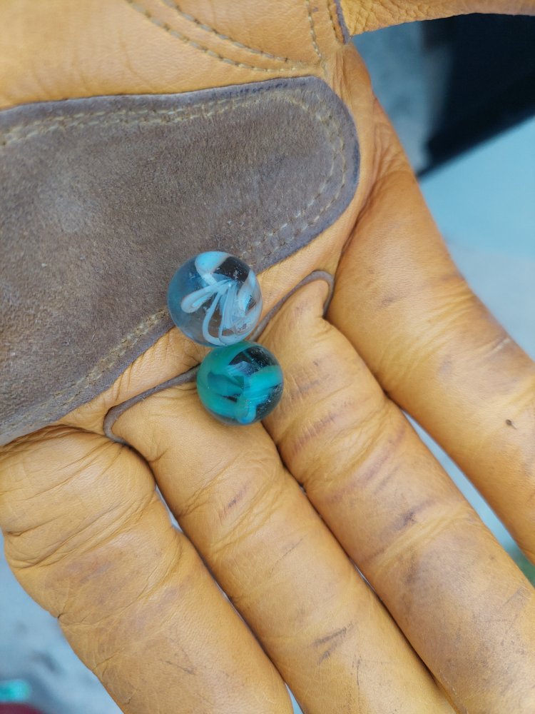

BTW, for those of you that know me and thought that I lost my marbles, I found them.
They somehow got burried in the back yard.
Who is the archaeologist in this group? How long does something like that have to be in the yard before it’s an “artifact.“

Might want to get a little display case for those marbles…
Hey if you guys see me post something that doesn't sound right, please feel free to let me know. If I had started ripping out this waterline and not caught that first, I'd probably be without water tonight.
OK. I don’t think those are your marbles. I think some kid left them there before you bought the house.

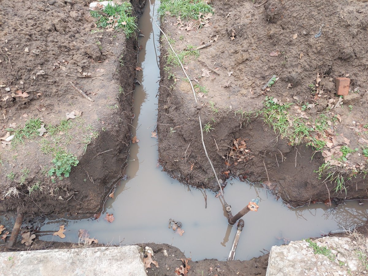

When it rains it pours.
It stormed yesterday and now my waterline is under water. I'm probably not going to be able to start replacing it until Monday. 😒
How do we know that’s really rainwater? How do we know you didn’t get it done, and open the valve, and end up with a trench full of water?

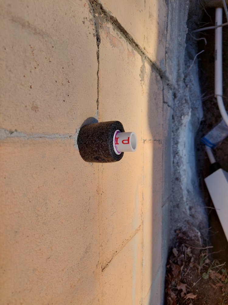

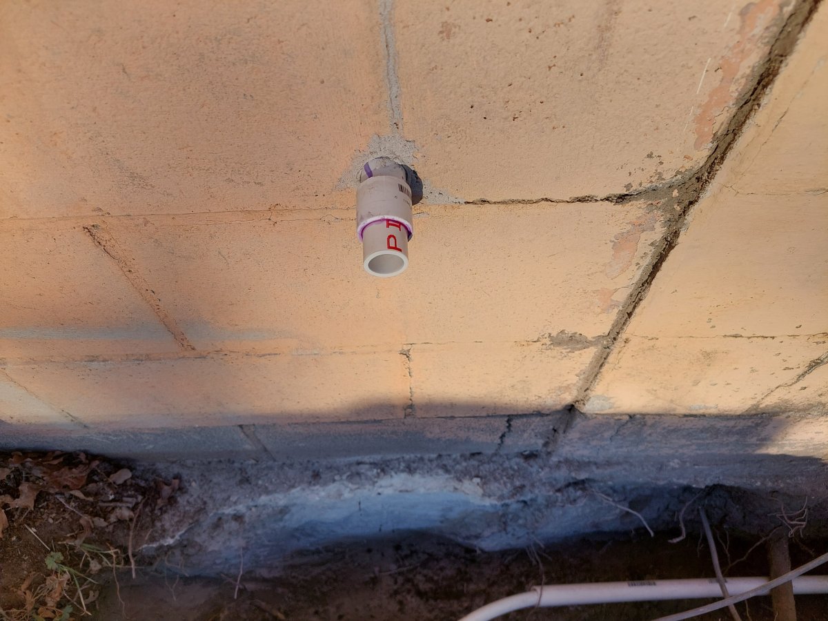

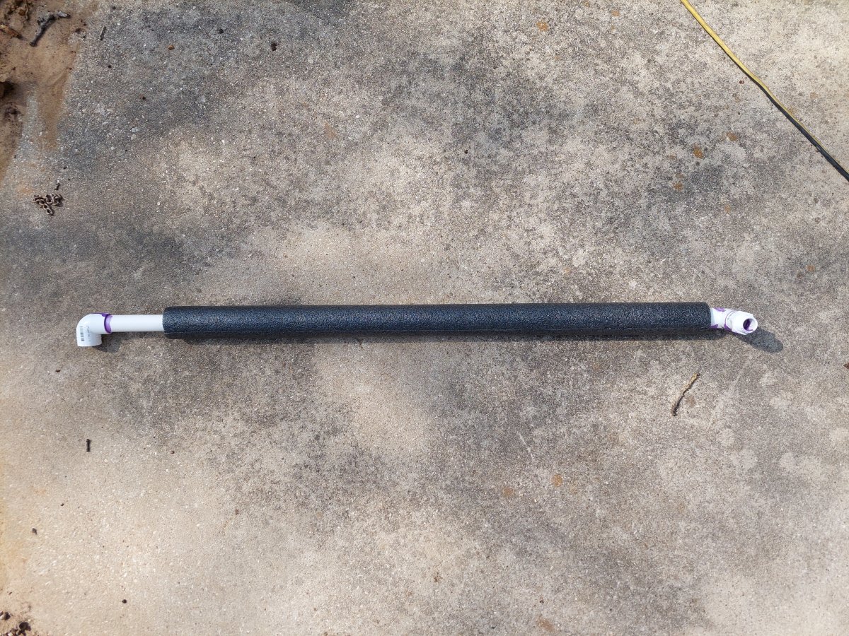

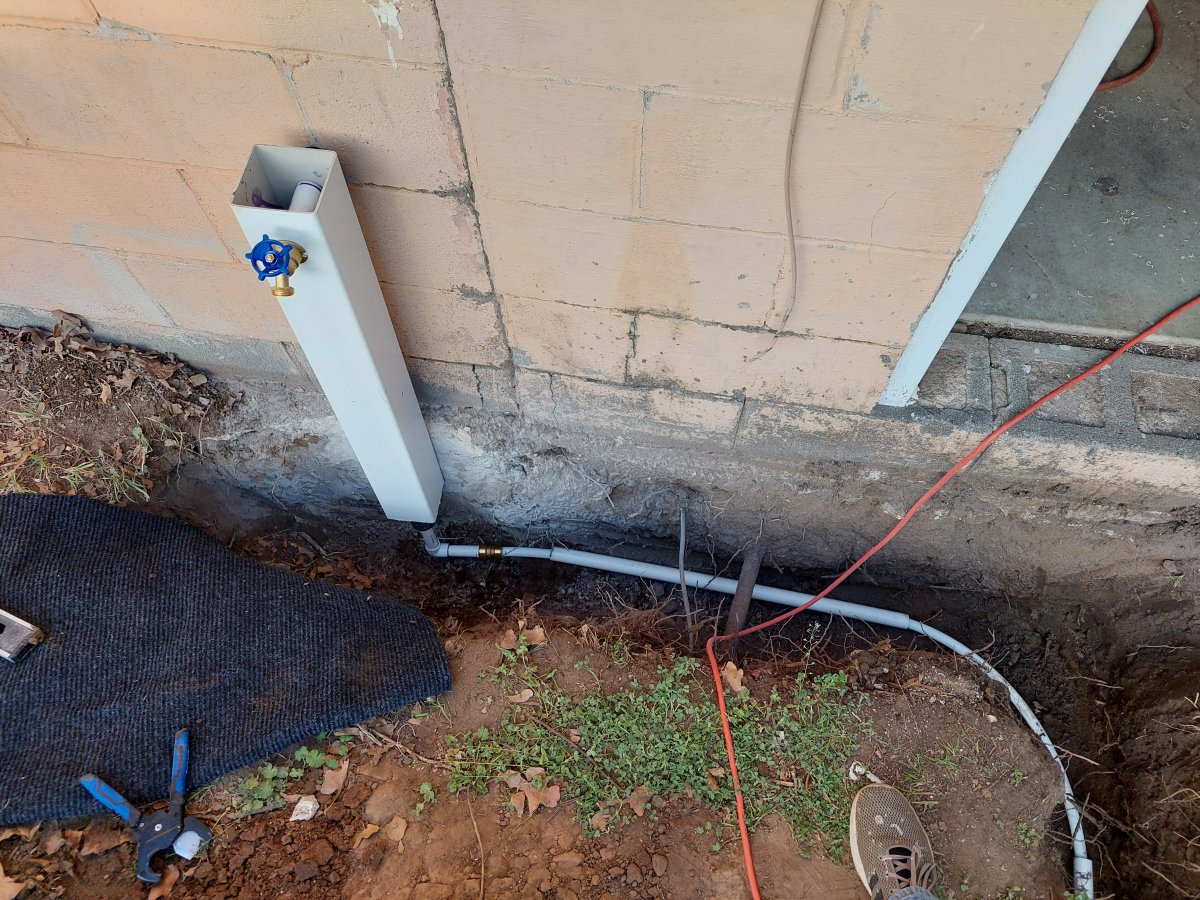

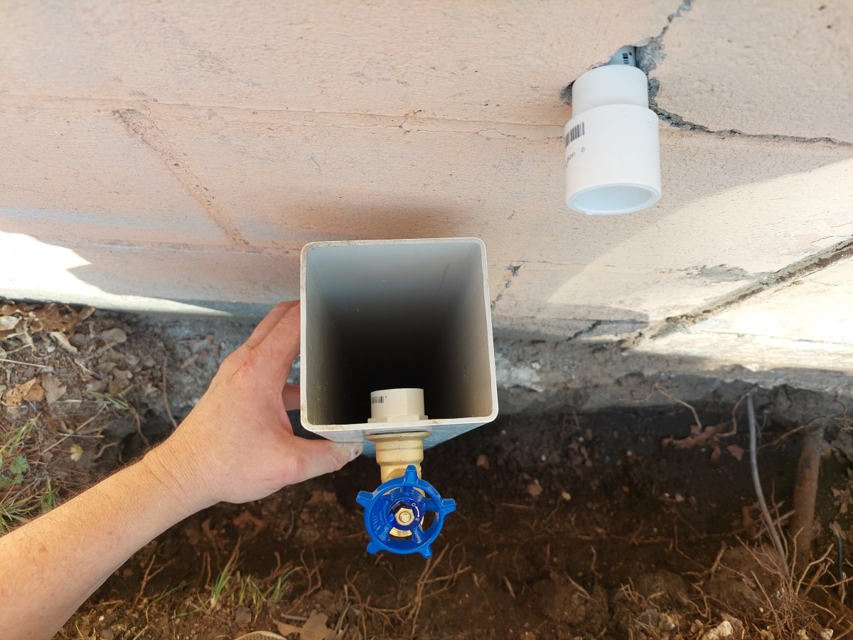

Drilled a hole in the side of the shop and brought the waterline up from the ground and into the building.

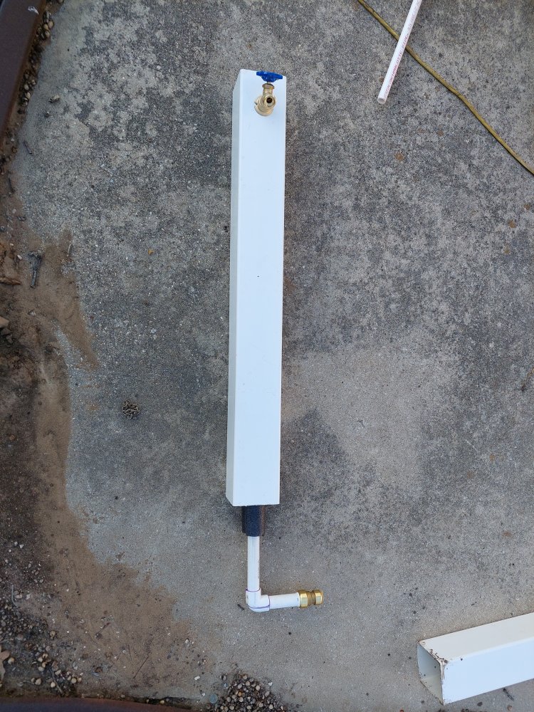

I used 3/4" PVC pipe from the 3/4" Pex in the ground and wrapped it in insulation and ran it up through a piece of 4x4 vinyl post to further protect it.
I wanted the post to be against the building, but there was to much concrete coming out into the yard from the slab / foundation.
For some reason I thought, hey I'll add a spigot here.
I am probably going to hate myself for using PVC instead of PEX at this point.
There's a T where it goes into the building, and the line into the building is 1/2". It runs to where the old line is and then transitions to the 1/2" PEX I already installed.
Now for the problems:
This spigot has a vert slight leak. I'm finding conflicting information online about how to seal it. It's a PVC male thread going in to a brass female thread and I used Teflon tape. I just read online not to use Teflon tape on PVC fittings.
I'm probably going to regret using a PVC threaded fitting on a brass spigot.

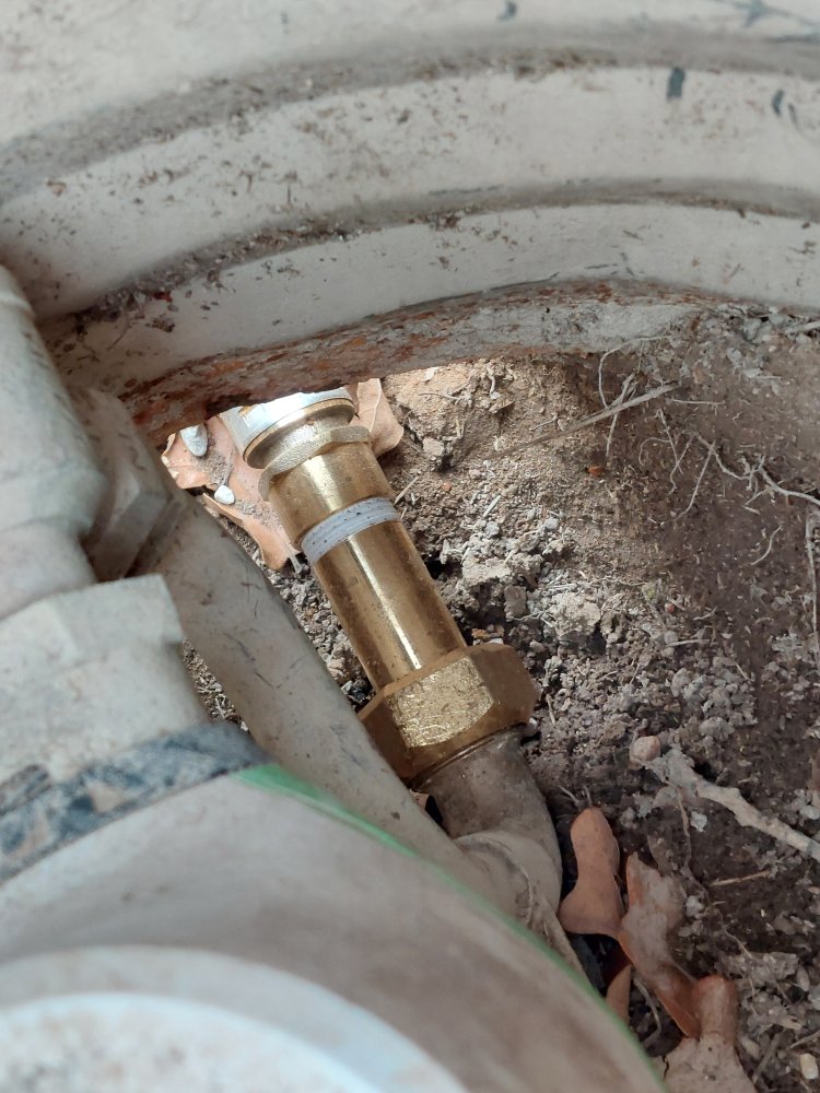

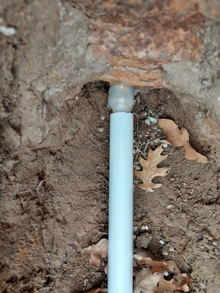

I turned on the water in the shop and found that the brass fittings on my water heater leak, and one of the brass filtings on the plastic water filter housing is leaking.
This is the water heater. It came with the first brass fitting because the fitting on the heater is an odd size (metric?). I added brass Sharkbite fittings to it. It’s leaking between the brass fitting and Sharbite.
In the meantime, I wrapped the sharbite fittings that will be in the ground with Sharkbite tape.
Here's the new water meter connection.
Here it is wrapped in tape before I fill it all back in with dirt.

Don't panic, leave the water on overnight and then check your leaks the next day. You may find most of them have really slowed and some may have stopped. It can take a little longer with plastic and brass than it does galvanized fittings, but the contaminates in the water usually eventually seals pesky drips.
When using threaded fittings, tighten them up, and then turn them some more. Plastic is difficult because it's easy to break the fitting.

I swear by rectoseal 5 for anything threaded or anything I suspect might not fit perfect.
It’s a fairly thick pipe dope, and I believe it actually has a fibrous content. I always put it on thick, on the male and on the female, and then snug it up pretty good. The hydraulic action on the pipe dope forces it into every nook and cranny on a microscopic scale, pushing the fibrous pieces into any possible gaps.
I’ve used it on virtually every piping material, I use it on flare fittings, etc., etc.
I know it’s a colossal pain in the ass to pull it apart and re-dope at all, but you’ll only have to do it once.
Hope it helps
