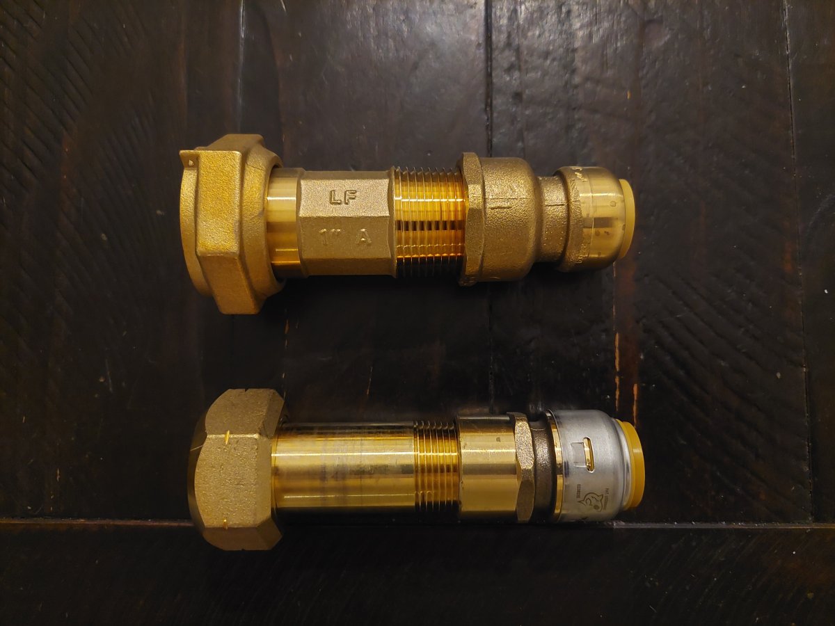

I took some last minutes measurements at the water meter before I took anything apart.
The threads just to that nut are 1-1/4", so I orded a 1-1/4" FIP fitting that had a 1" MIP end.
Wrong.
That new fitting has an inside nut diameter of 1-1/2".
Went to Ace Hardware and looked at fittings, and realized a 1" brass fitting has a 1-1/4" threaded FIP diameter.
Had to drive 45 minutes to Home Depot in Wichita Falls to get a 1" FIP X 3/4" MIP meter adapter, and then a 3/4" FIP to 3/4" PEX adapter.
This makes way more sense than the 1-1/4" to 1" fitting that I then had to reduce to 3/4".
The first fitting and adapter is at the top. The fitting and adapter I just bought is at the bottom.
I'm pretty confident that I have the right fitting now. I'm glad I re-checked thos before I took everything apart and started assembling the new line.

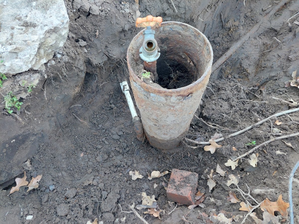

The part in the red circle does look like a valve without a handle like someone else mentioned. I suppose the check in the 3/4 line is to keep your water out of the city water system. Like a back flow preventer.

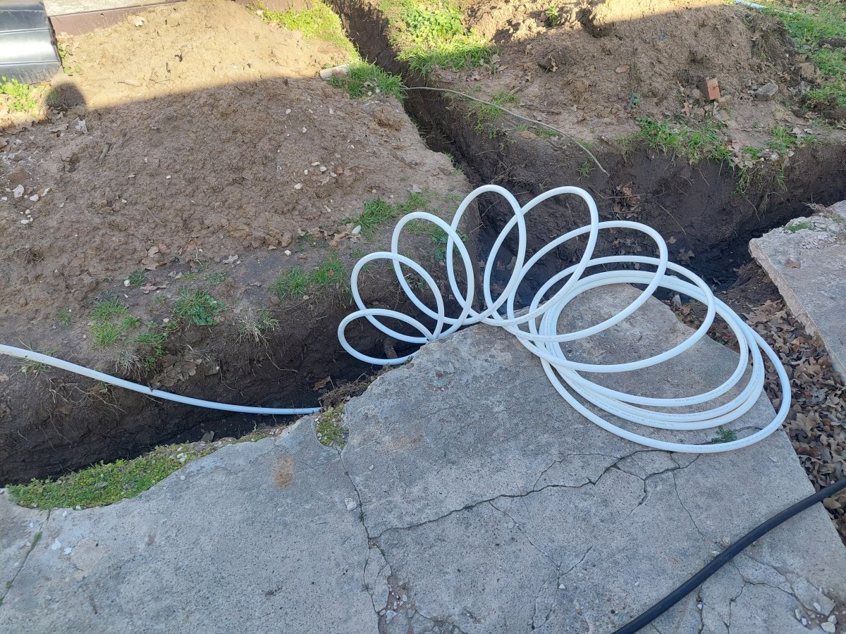

Started the day assembling this section. It's the flow check valve and shutoff valves for the shop and the house.
Trying to run this 3/4" PEX was a ton of laughs. There's an old gas line that crosses here and I had to run the PEX under it and then down to the meter. The PEX wanted to stay coiled up.
Once I got this section ran, I ran 1" PVC pipe over it to protect it.
The water is back on to the house. So far no leaks. Tomorrow I'll run the line to the shop. Then I need to add the spigot coming out of the ground to the right of that valve in the picture.
Still alot of work to go, but I'm happy I was able to get the old line out and the water back on to the house.

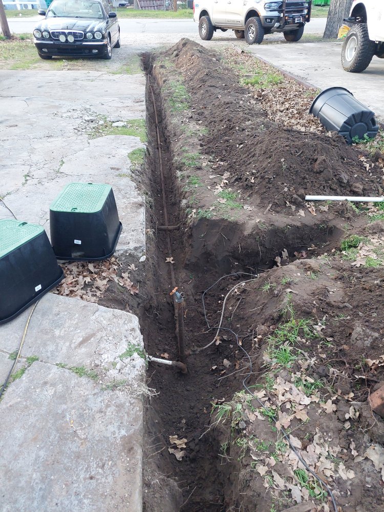

I've dug just over 40-feet with another 30 feet to go.

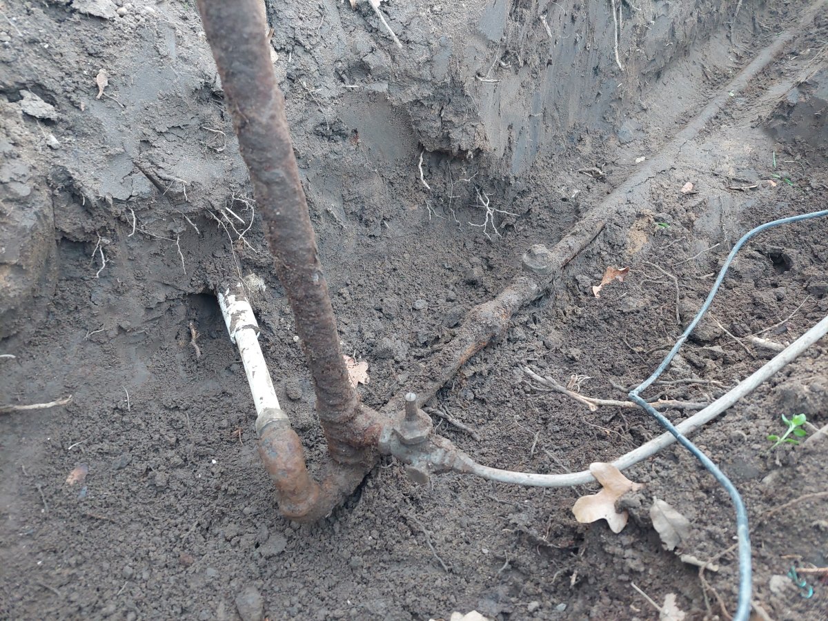

I found a check valve on the 3/8" line that goes to the shop where it connects to the 3/4" line. You can see the 3/4" check valve in the libe right before all if this. Do I really need to have a check valve on this line going to the shop if I plan to replace it with a manual valve?
Is it a check valve or is it a backflow preventer. Check valve usually works with flow or gravity, and the backflow preventer is a little fancier with a positive close to flow in the wrong direction.
The 3/8 inch copper line makes me doubt the previous owners were worried about following code and worrying about things like backflow preventers, but it might be advisable to put one in, just in case you’re cleaning something in the sink or whatever, so you don’t by accident drawback in some contaminated water to the system.
