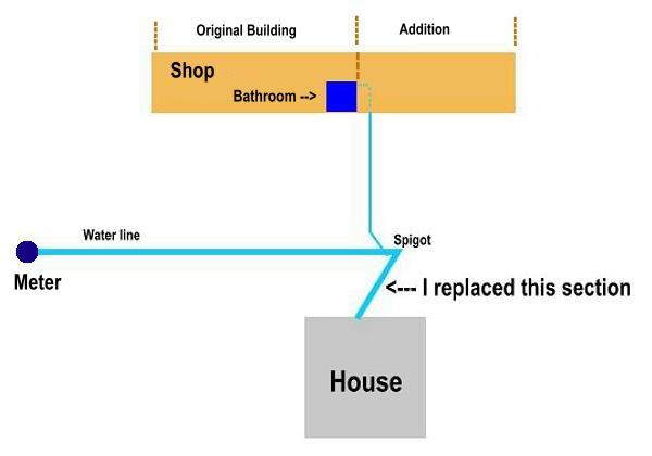

This kind of shows what I'm dealing with. The water line runs straight back from the meter to an outdoor spigot, and then runs at an angle to the house. At that same point is the 3/8" copper line that runs to the building.
The bathroom is in the rear corner of the original building, and the water line went behind the building and under the floor into the floor plate of the 2x4 wall. An addition was added later, so this area of copper line is now under the slab of the addition.
My thought was if I get the water going and there's good flow, I'll just connect the PEX to the copper line at the foundation of the building and save myself the work and expense of running line through (2) cinderblock walls and connecting to my new shutoff valve below.

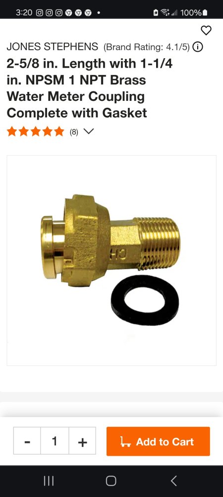

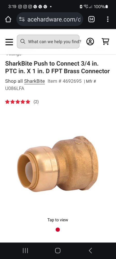

I looked earlier. I've yet to find one that goes from 1-1/4" to 3/4".
Wondering if I can piece these two together to attach my 3/4" PEX to the meter.
