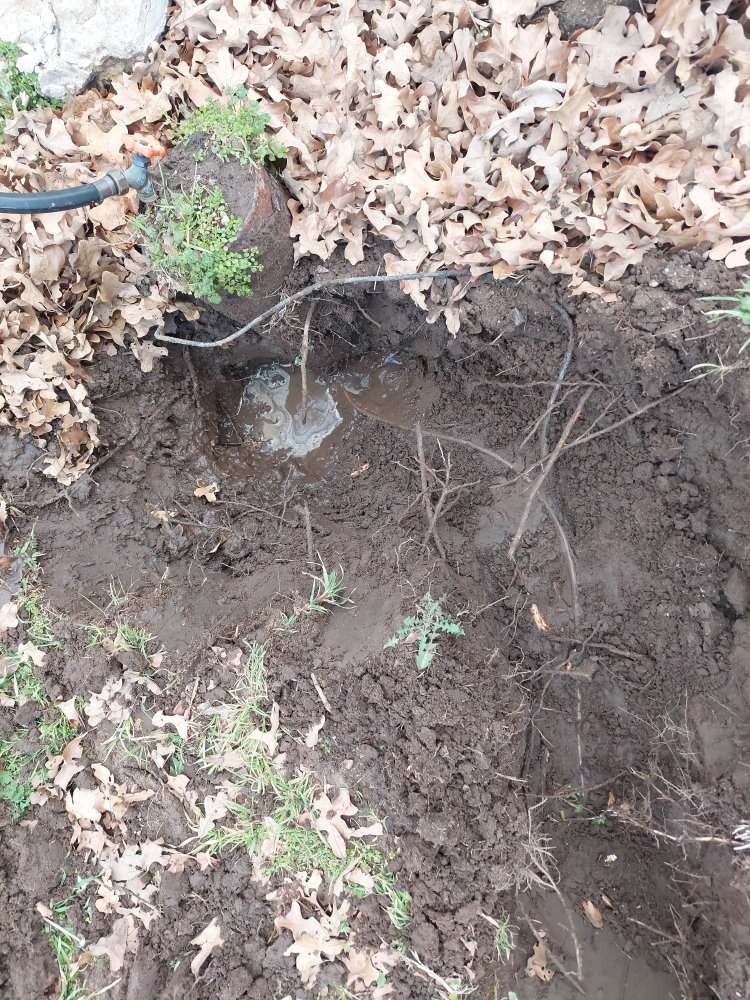

I dug on the backside of this spigot. I already know the there's a water line on the other side that runs to the house because I replaced it, and there isn't any line running off of the main between here and the meter.
As I was digging I discovered a 3/8-inch copper line running towards the shop.

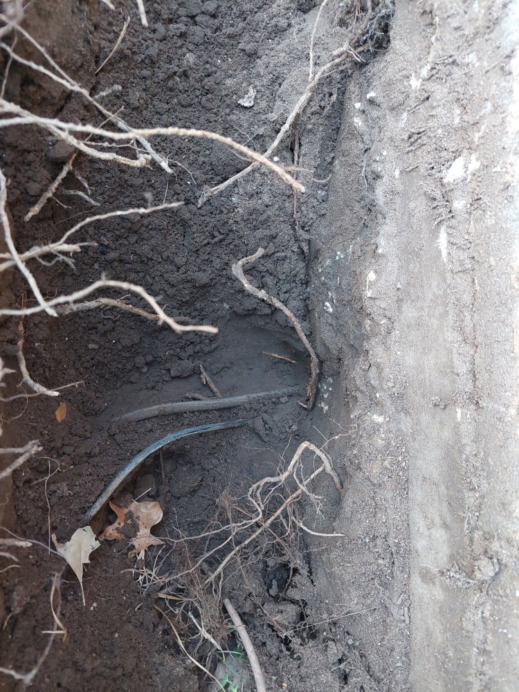

I dug outside the shop and found the 3/8-inch copper line running under my shop, and now understand why there was a cable buried near this spigot. Likely do a metal detector would detect it.
I didn't find any shut off for this line.
Who the F runs a 3/8-inch copper line 40 feet to a sink and toilet in another building. I figured it was 3/4-inch. Maybe even 1/2-inch. Not 3/8's. WTF.

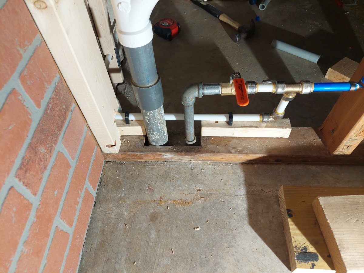

I still plan to replace the water line from this spigot to the water meter with PEX. I could also replaced this line with a larger PEX line, but I would have to run a new line inside the building. Instead of cutting up the floor I wonder if I could run it along the base of the wall at the floor??
A cabinet and sink goes here. The shop is on the other side of the wall where the brick panel is. I could run it through the wall and connect to my new plumbing. 🤷‍♂️

Sure, why not. Another possibility would be to run it up into the attic and then down into the wall where you need it. Give it some insulation in case the weather ever gets cold.

I’d pick an outside wall, dig down under the slab and drill a hole thru the cement from inside the building, in that wall and run your new pipe through the hole to the meter or whatever and bury it. Then run your new pex through the walls to your sink/pooper shutoff. Insulate any pipes that are on an outside wall,
I know it is popular to run water lines in attics down there but I would not do that. Way easier to fix a busted pipe near the ground and patch a wall than it is to fix it in the ceiling, plus the ceiling itself and the walls and whatever else it sprays onto.
