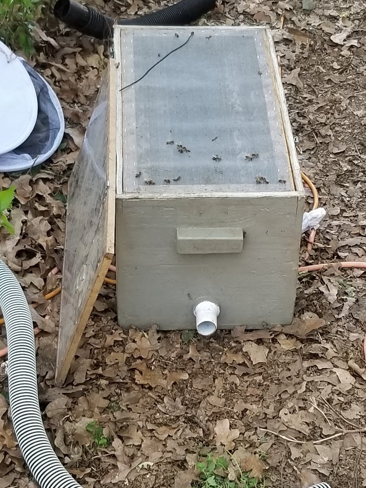

Friday I had the tenants evicted from my shop.
Honey bees had made a hive under the eave and roof in the back corner. I had a bee keeper come and extract the bees and honeycombs.
In this pic most of the bees and the queen are in that box. The bees on top of the screen are trying to get on because the queen is in there.

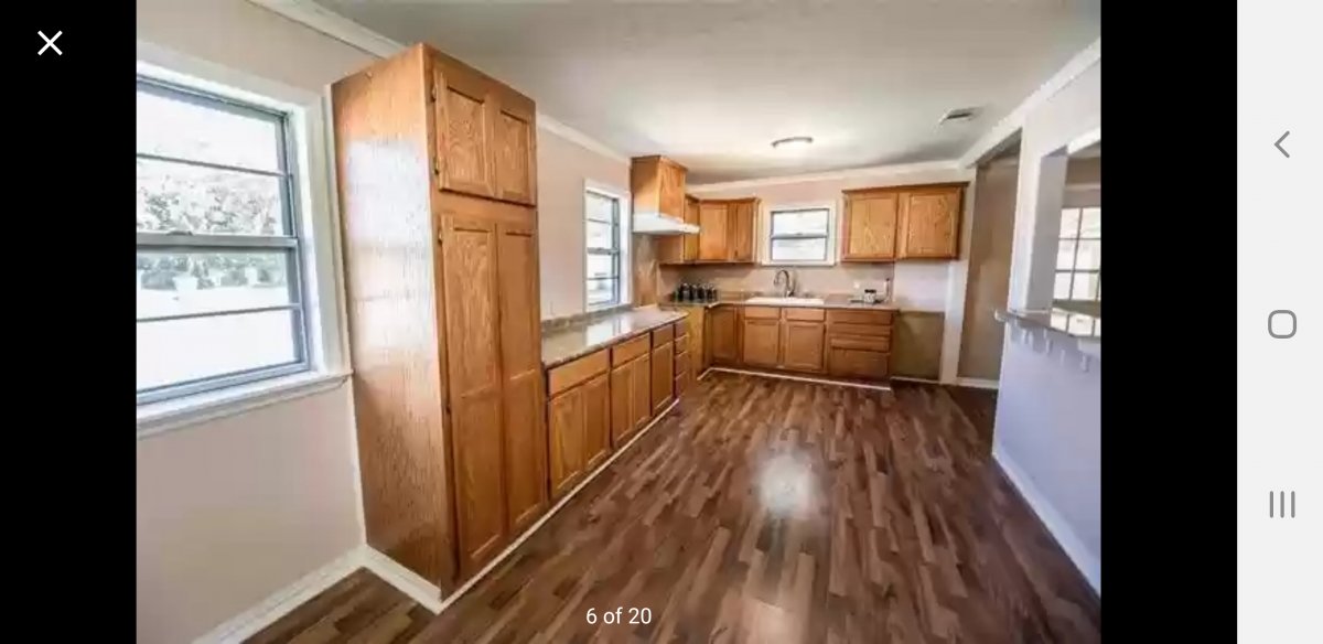

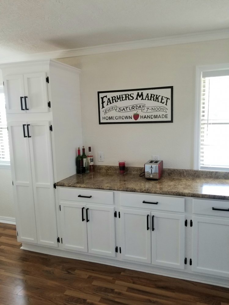

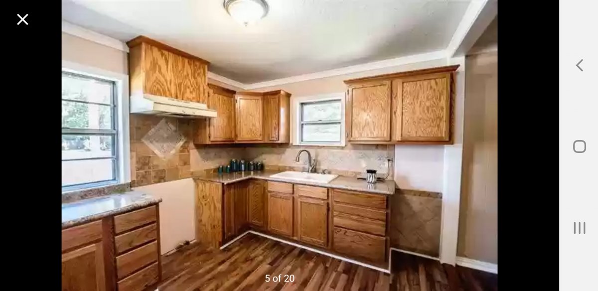

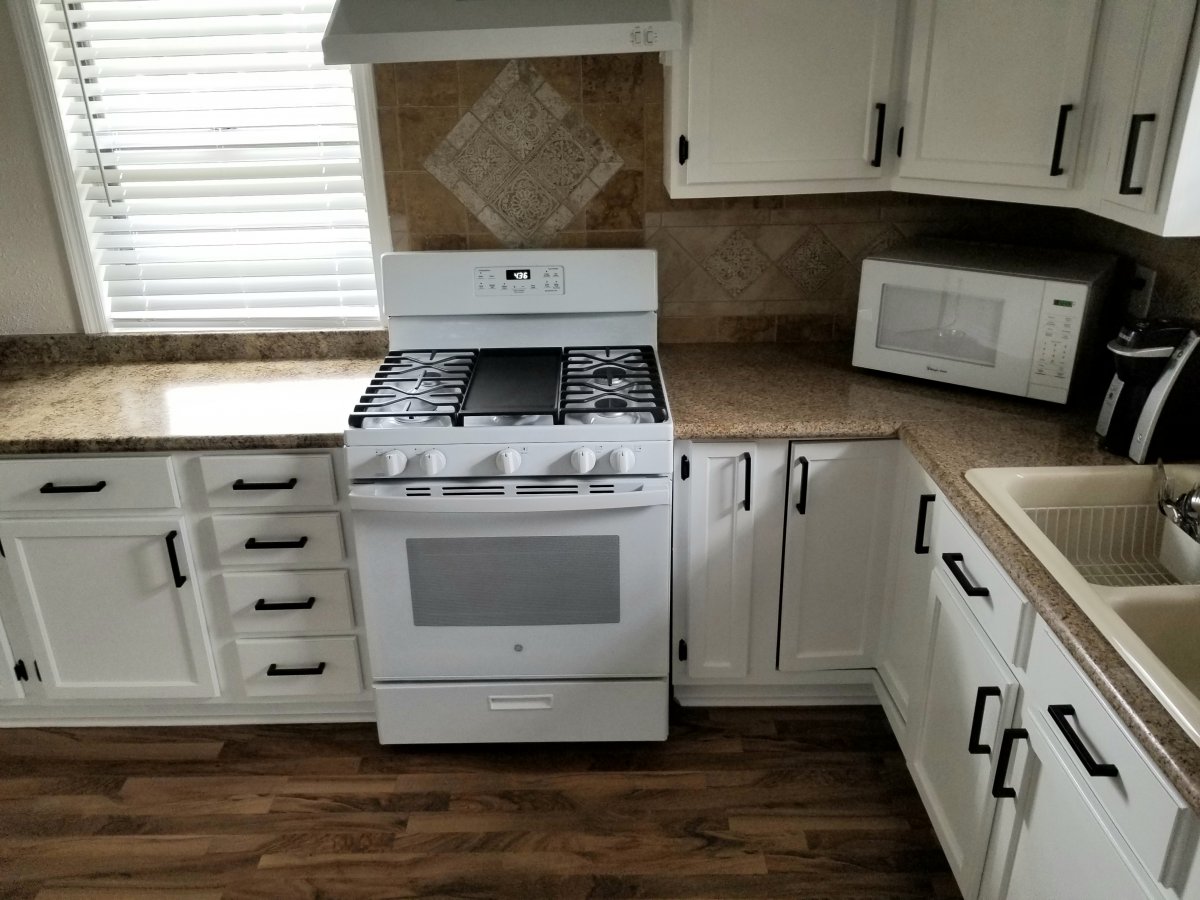

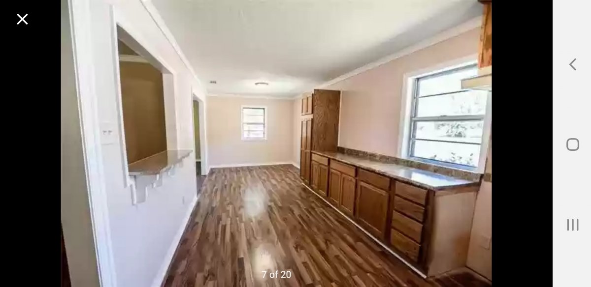

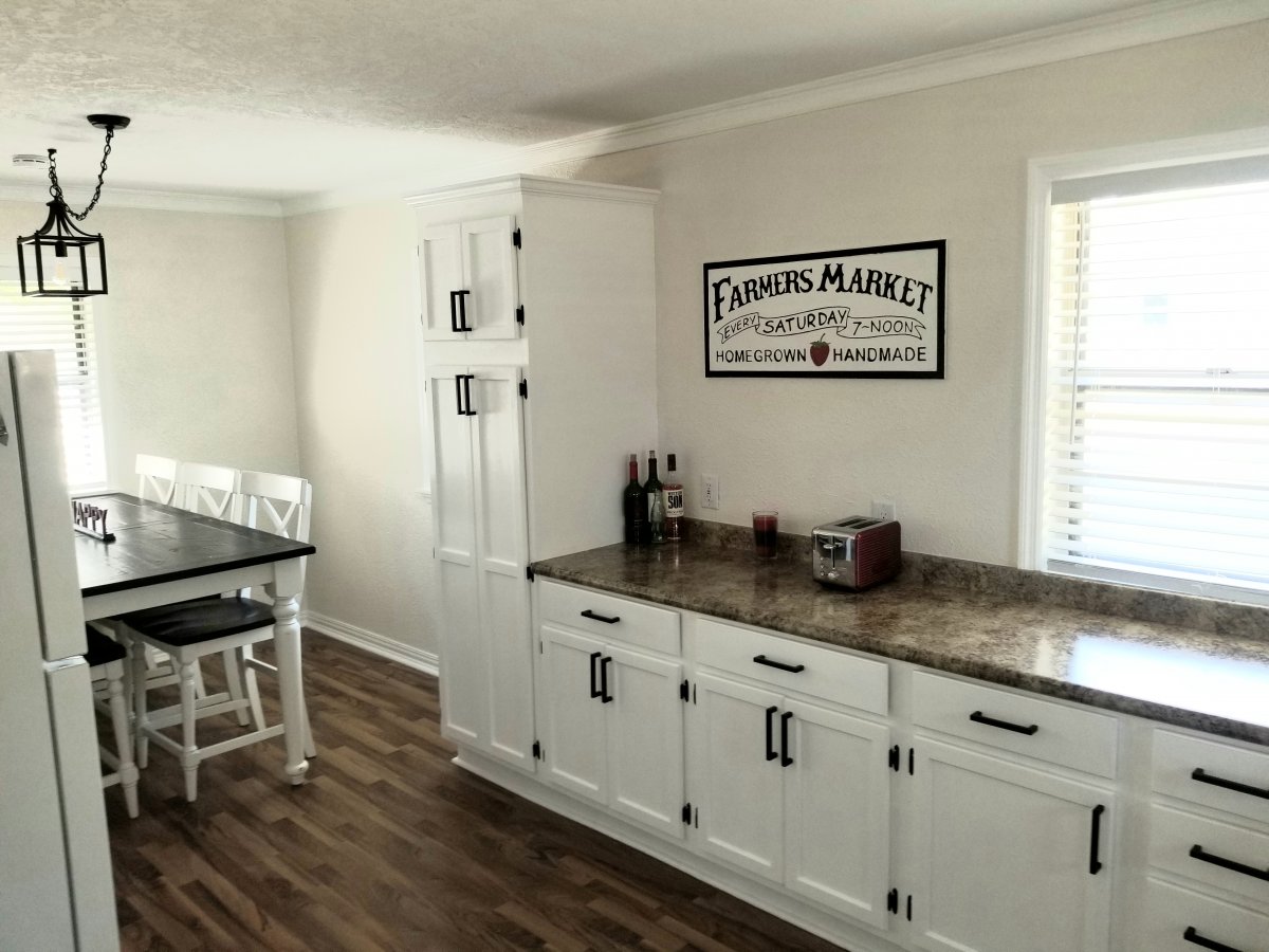

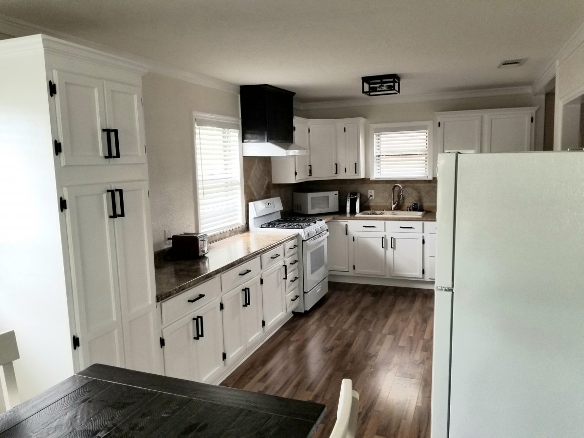

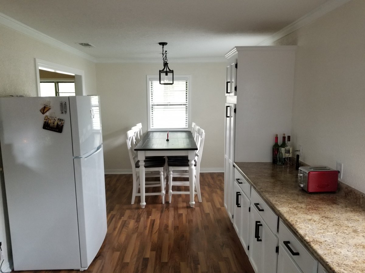

A little time and paint goes a long way towards improving the looks of the house. Here's some before and after pics of my kitchen. I painted the walls, trim, cabinets, added cabinets handles, and switched out the light fixtures, switches and outlets.

Your remodel looks awesome!! Nicely done.:headbang:👍
Kitchen (and dining room table) look great, Jim. Totally new look!
