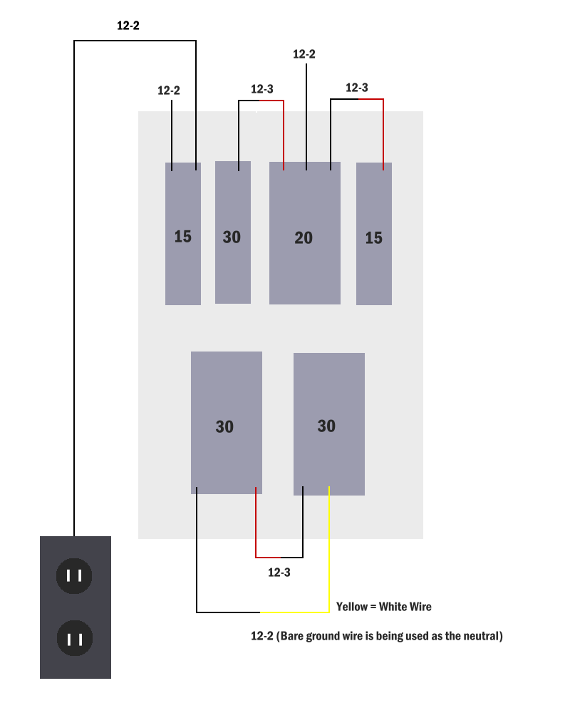

Welcome To My Breaker Box:
I made a diagram to better show how someone has wired this breaker box.
All of the Romex is either 12-2 or 12-3.
The red wire in the top right 15 AMP breaker is missing the screw that holds the wire in place.
As you'll see, an outlet was added to the top left 15 AMP breaker and is hanging below the breaker box.
Also note that the Romex that you can see running down the left side of the breaker box and going in to the bottom is being used like a 12-3 Romex. The bare ground wire is being used as the neutral.
So from what I can see, I have (4) Romex wired up to run 230. This is puzzling because I only have (2) 230 outlets. Why the hell are there some many Romex's wired up for 230???
Otherwise I have normal outlets and 8-foot fluorescent lights. I plan to convert those to LED tubes to reduce power consumption.
I might have to purchase a wire tracer to try and figure out where these Romex go, and what is on what circuit.

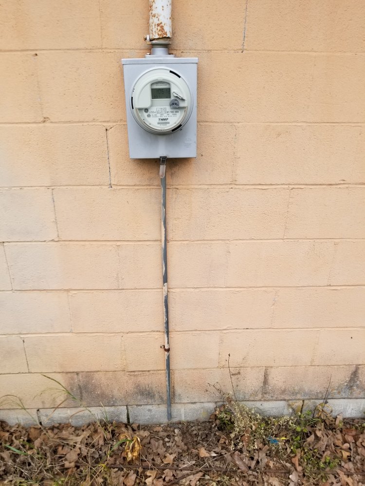

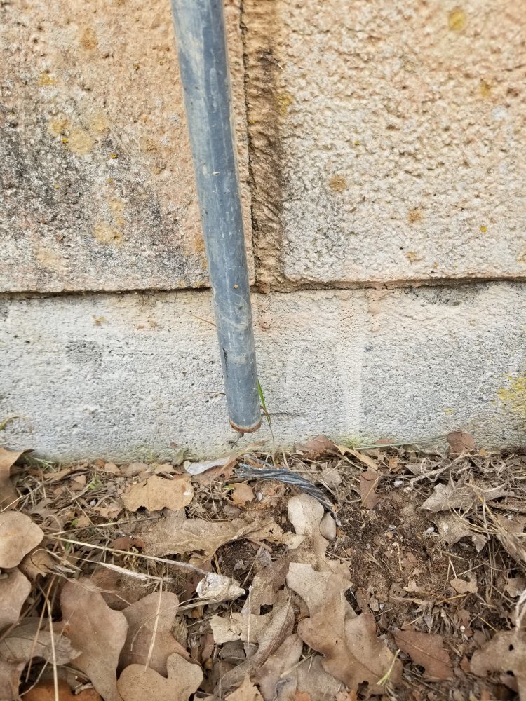

There's a ground strap coming down from the shops electric meter that's broke.
I'm going to have to pull some outlets and see if any have a red wire. I'm wondering if whoever did this wiring split the top and bottom outlet on to their own circuit?
That's a pretty good idea.
That system is dangerous to operate until that ground wire is replaced. You could end up with weird voltages. I really want to encourage you to replace the whole mess.
Define "whole mess".
Breaker panel, ground wire and connection (often supposed to be a solid wire for that purpose. Not stranded unless it’s the huge ones for big commercial or industrial buildings.) and make sure supply is big enough for the service. Might be wise to drive a new ground rod so that you know it is good.
We really can’t evaluate the rest of the wiring in the building without seeing all of it. From the condition of what we do see, there is reason to be suspicious.
To the inexperienced, this sounds like a lot. But the bulk of it can be done in one day by someone experienced. This is a small project. This is insurance. Bad wiring can ruin your day either through personal injury, death or loss of the building and contents due to fire.
I was wondering if I could just cut off some of the conduit for the ground and attach that ground strap to a rod.
I wouldn't mind rewiring the building. The wires run up through the ceiling but there isn't much space to crawl around up there. There's also insulation up there. The wiring comes out of the ceiling in conduit down the wall to the outlets.
All light fixtures are 8-foot fluorescent. I actually think I want to more a couple of them. The front section has a 12-2 wire sticking through the ceiling where a fluorescent light fixture was. The fixture is gone. There's another spot where I can tell there was a fixture and a hole for the wire to come through the ceiling, but the wire is gone.
Believe it or not, the power was on in there when I bought the place. None of the fluorescent lights worked, but the outlets did.
Probably not. Like I said, they will probably require a solid conductor now. Many places also specify the top of the ground rod needs to be below ground level. Some if these things vary by local codes or local interpretation of codes. There are places here that now require two ground rods. You need official advice from a good local electrician before you waste too much time and money guessing or rigging something that seems like it should work. Any of us who know this stuff can only tell you generally what the code requires and what works for us locally. We’ll get you close. But there could be weird little things in your area that we don’t know about.
Have I mentioned that there's no permits or inspections here?
