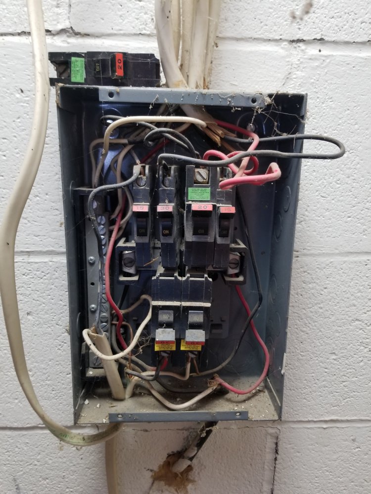

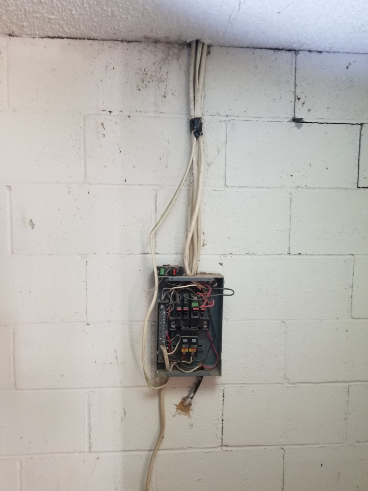

I should probably do something about this breaker box in my shop.
