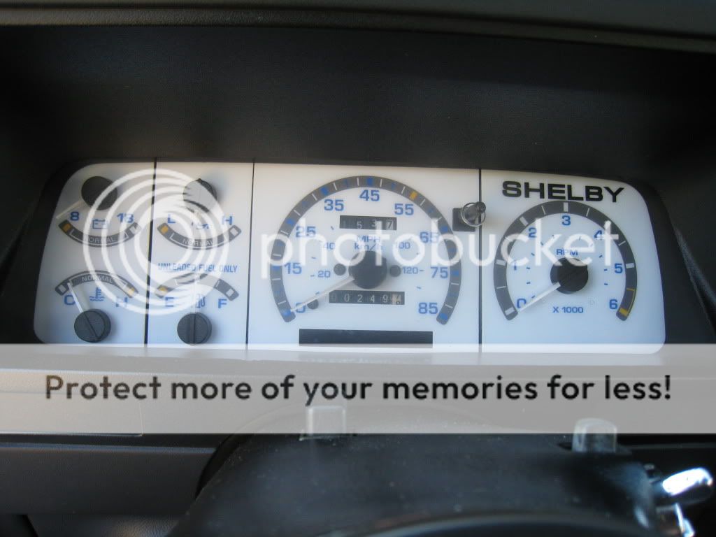

Updated "Shelby" cluster..

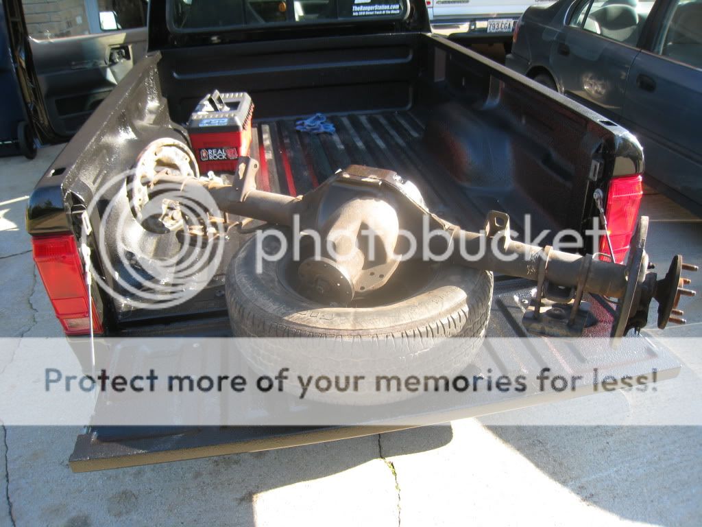

Finally found a 8.8 3.08!!!!!!:yahoo::yahoo:
