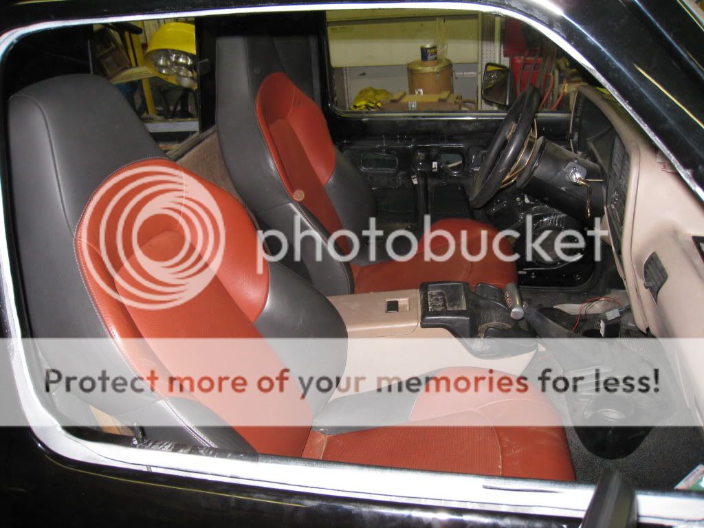

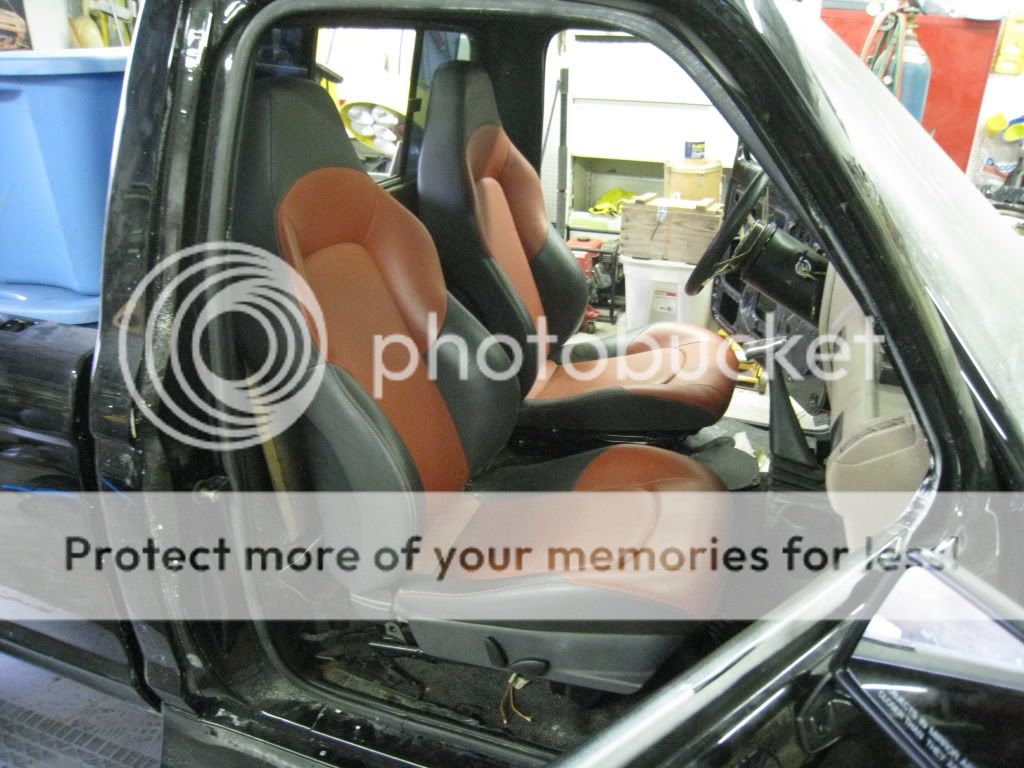

Multi, can you take a good picture of the seats, My Ranger is a super cab, and I'm either going to get the seats that I have (leather from a 91 Explorer) recovered, or find me another set of leather seats, just depends on whats cheaper.

Looking at that pic I think I might fit. It doesn't look that much worse than the bench seat. Those seats look really comfortable as well. Hell I drive a KIA Forte Koup every day, those seats in that cab still look roomier than the cabin of that car.

The seats aren't too bad they just don't work for me that well... Those weekends Sounds good I'll let you know as soon as I hear about the Dallas trip.. I have tools so we are good there... Just make up a list of what you want or need and I'll make sure I have the tools to remove the parts Let's look at April 2nd if that works for you,, That's pay weekend for me!!!

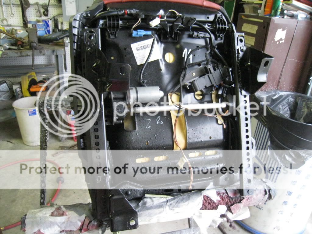

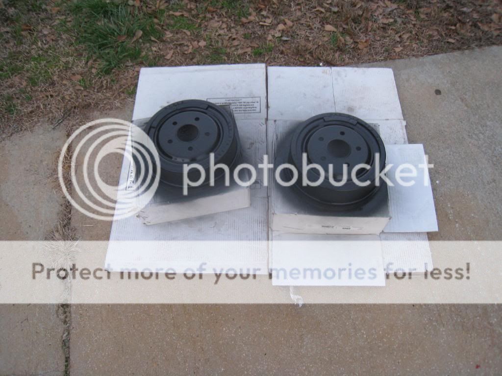

Spent the morning at Pull A part. Scored the mini spare tire from a Town Car that has never been used, new seat tracks for the new buckets, a new harness fir the ALT, some brake parts for the new 8.8 with 10". also stopped by the local parts store and picked up new drums, Shoes, Spring kit, and new adjuster kits. Axle seals. Spent some of the day painting the rear axle and drums.. Had to take seals back cause they were wrongand as usual cost some time... Got a few pictures I'll post up tomorrow.... Josh if you read this we have a ton of Rangers to pick parts from... Hope to see you the first weekend of April!!

I'll be making a list of parts I'd like to get that'll fit in the car. Only two things I can think of right now (aside from that bolt mentioned previously) are a brushed aluminum look instrument bezel, and a spare instrument cluster if any good ones are available. I'd really like to find the bezel from an 85 with the 4 indicator lights, and din style radio opening. I'll look over the truck and see what else I can come up with. Got a few other things I'd like to find but those will have to wait until I have a truck to move them.

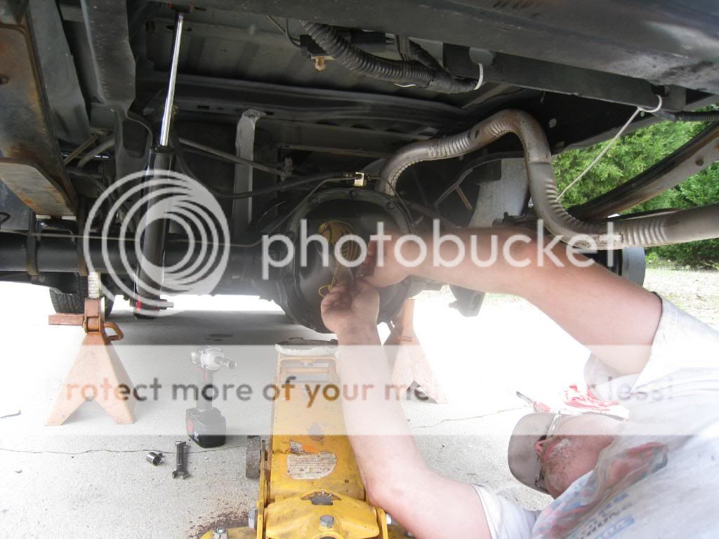

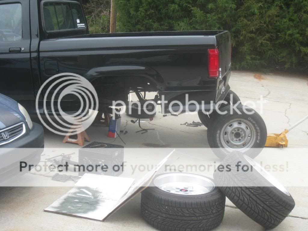

Pics from this weekend

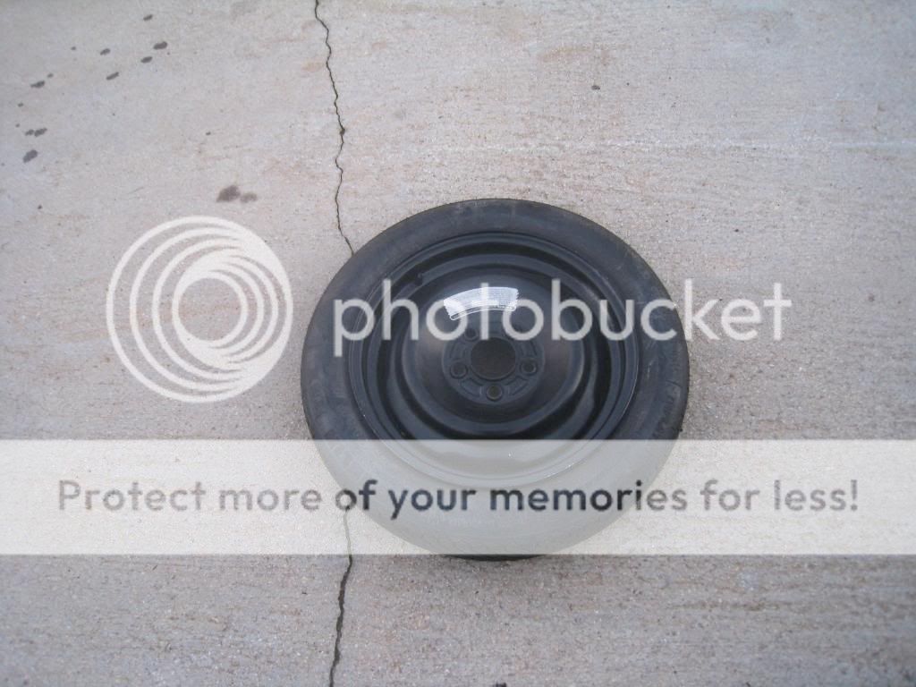

New spare:

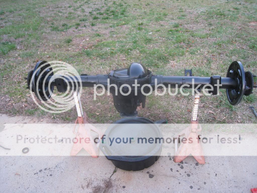

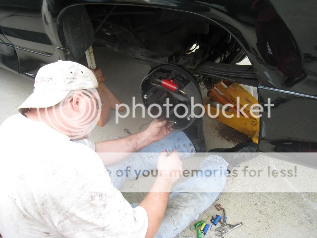

7.5 is out. The right brakes had parts fall out when I pulled the drum. The left side had fluid all in it from leaking wheel cylinder.. It was time for complete new brakes so Swapping the 8.8 is perfect time for the 10" brake upgrade since it needed brakes anyway!!
Painted everything up with rattle can
Painted the new wheel cylinders with caliper paint not thinking they don't show...
Laying down my Diff Cobra
Put the 2 degree wedges in between the spring and axles to fix the pinion angle offset.
She still feels pretty strong with the 3.08 under it.. The new brakes are stopping her on a dime... It's running 1800 RPM @ 55 MPH. Looking forward to getting it up to 70+... All in all this weekend was a great weekend... Girlfriend and I found everything we were looking for at the salvage yard and were able to get all the parts to get the axle installed.
It took me and her about 2 hours to get it setup!!

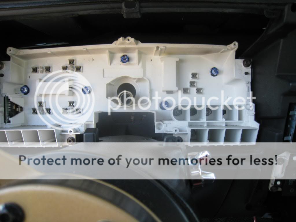

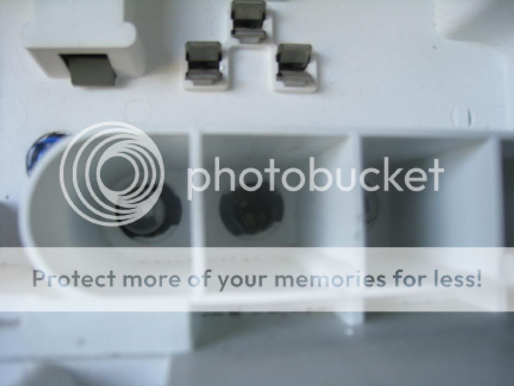

Here is a quick write up for all the dash and such lights.. Instead of pulling the whole cluster out just pull the guages.. start with the tach then the guage left of the spedo then the one left of it and then the speedo...

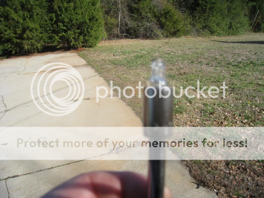

For the bulbs you can't reach in to pull out use a hook style pick to get the bulb out:
To put the bulb in use a 3\8 socket and extention
Reverse the proceedure to install.. It's that simple!!!!
