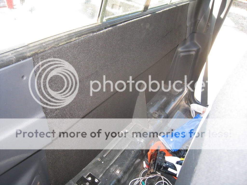

Well it's finally warm in Ga again so it's back to work on the ole girl.
went from this
To this
Aslo put carpet on the door panels
And installed the new white faces on the gauges but forgot to snap a shot of them
I also had to make the speaker holes bigger in the doors Still need to black felt the grills and get the panels to my interior guy.
